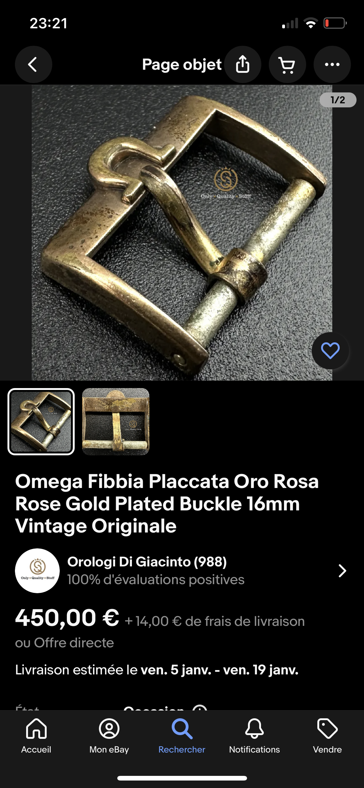

Any recommendations about where to search for or source an 18k 18mm rose gold buckle? Thanks in advance.
As @SOG53 already stated 18k buckles in any size are uncommon, rose gold even more uncommon and in 18mm at least vintage one I dont even know if they exist at all?
I would settle for a plated buckle in 16mm, what watch is it for? Do you even need 18mm that would mean a 20mm or bigger lug width?

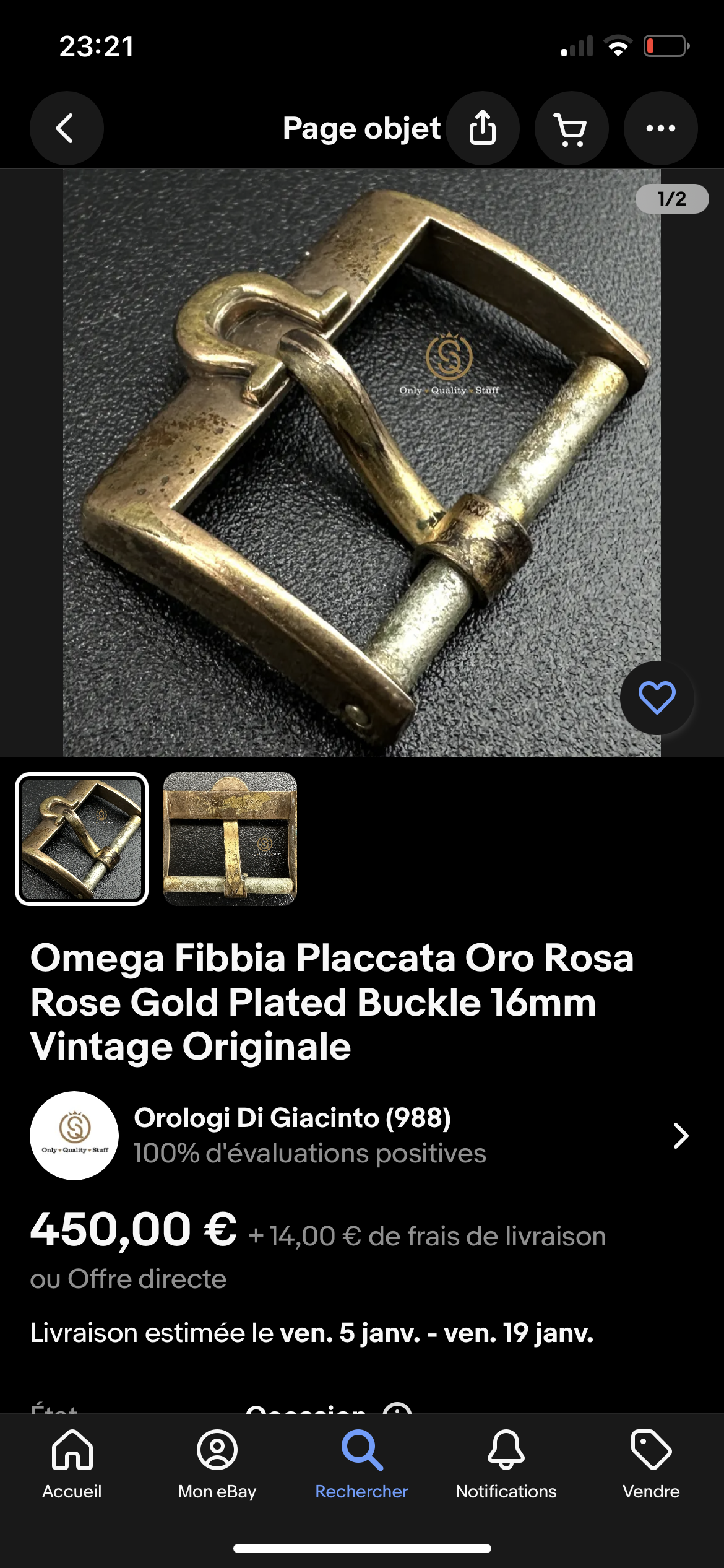

"Set up EB search. You need 200 meaningful posts here before you can set up WTB post- but you can certainly follow the parts and accessories thread here and DM a seller and buy there as well. 18K much rarer than gold plated- I would include that in search as well. Heres an example of rose gold plated (16mm) looks ok with 18K watch to me."

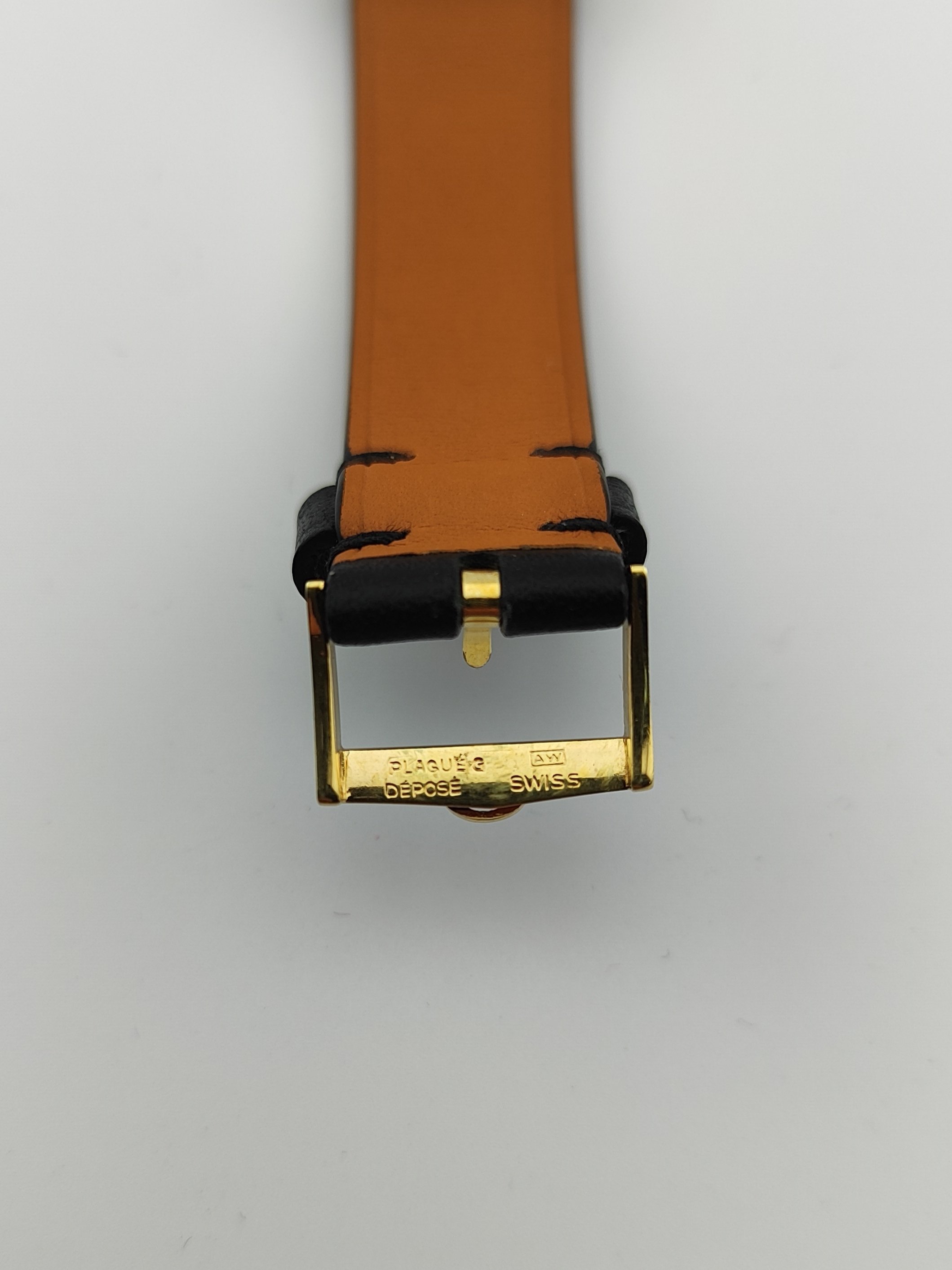

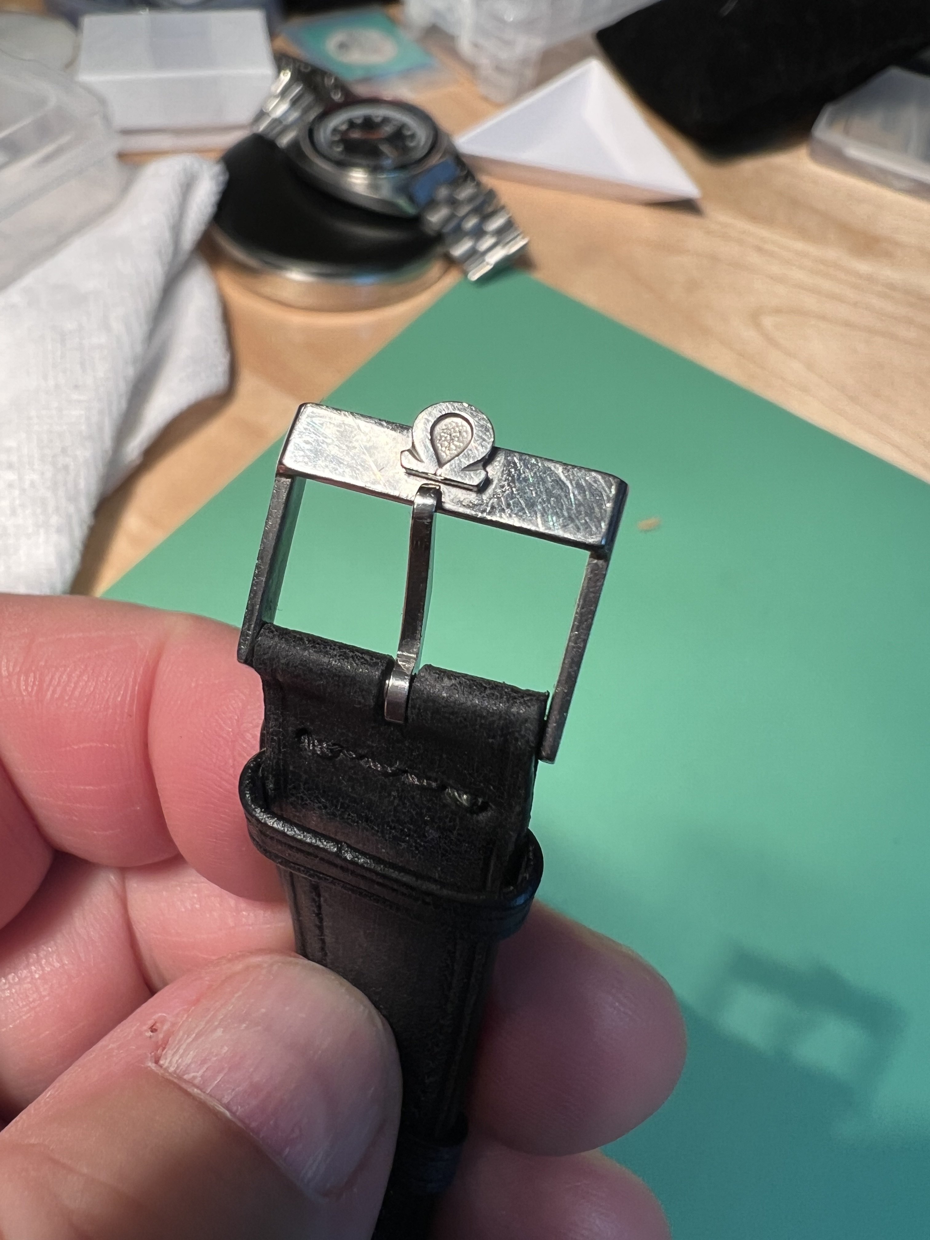

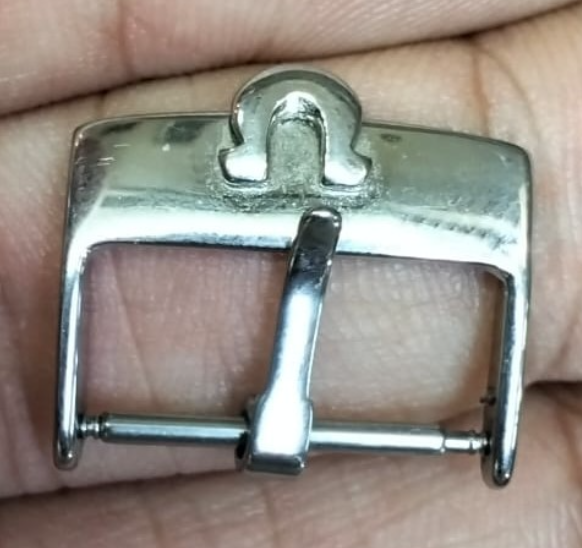

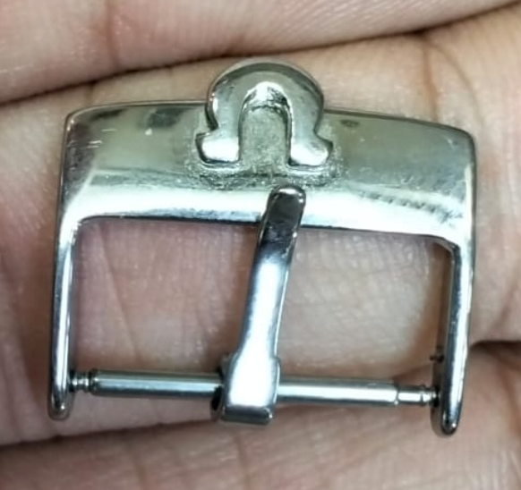

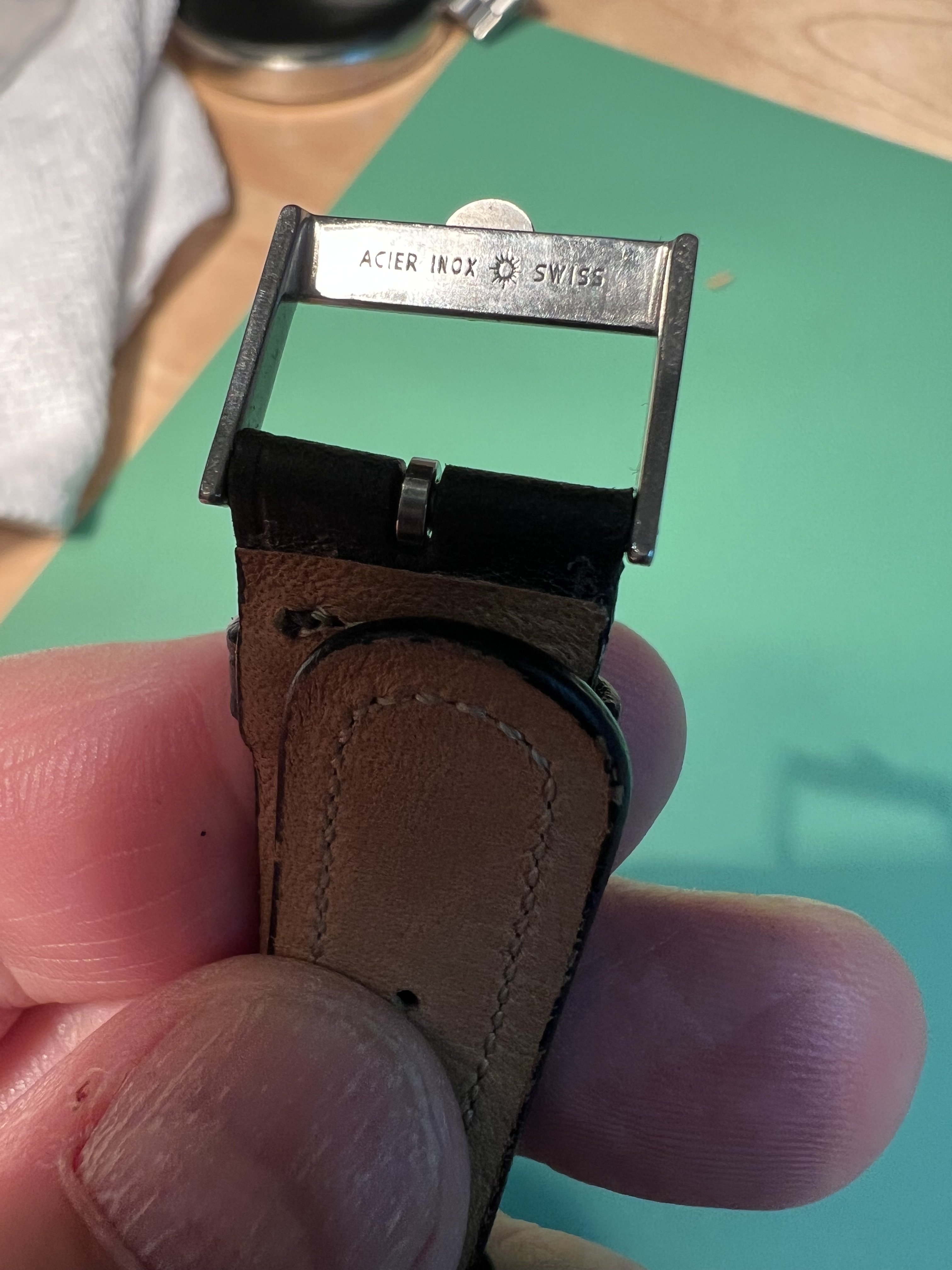

Hi Fellow Omega Expert,,
May i ask for your opinion on whether this buckle is original? If yes, is it from the 70's?
Not loving this one.

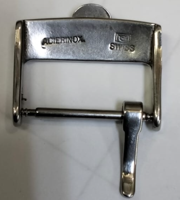

Agree w @gatorcpa logo is iffy, ACIERINOX has no space between words, and SWISS font not good for SS
Also has skinny non vintage springbar, I like to see the big fat ones for original vintage
