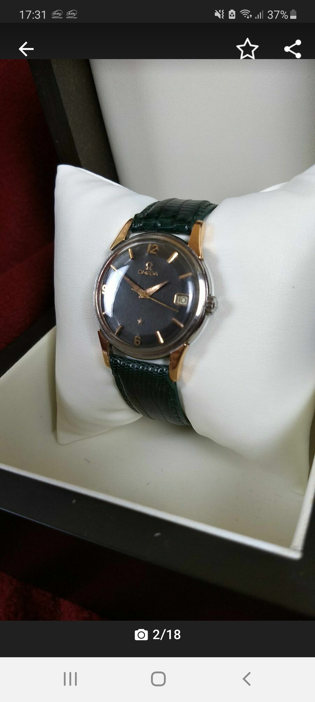

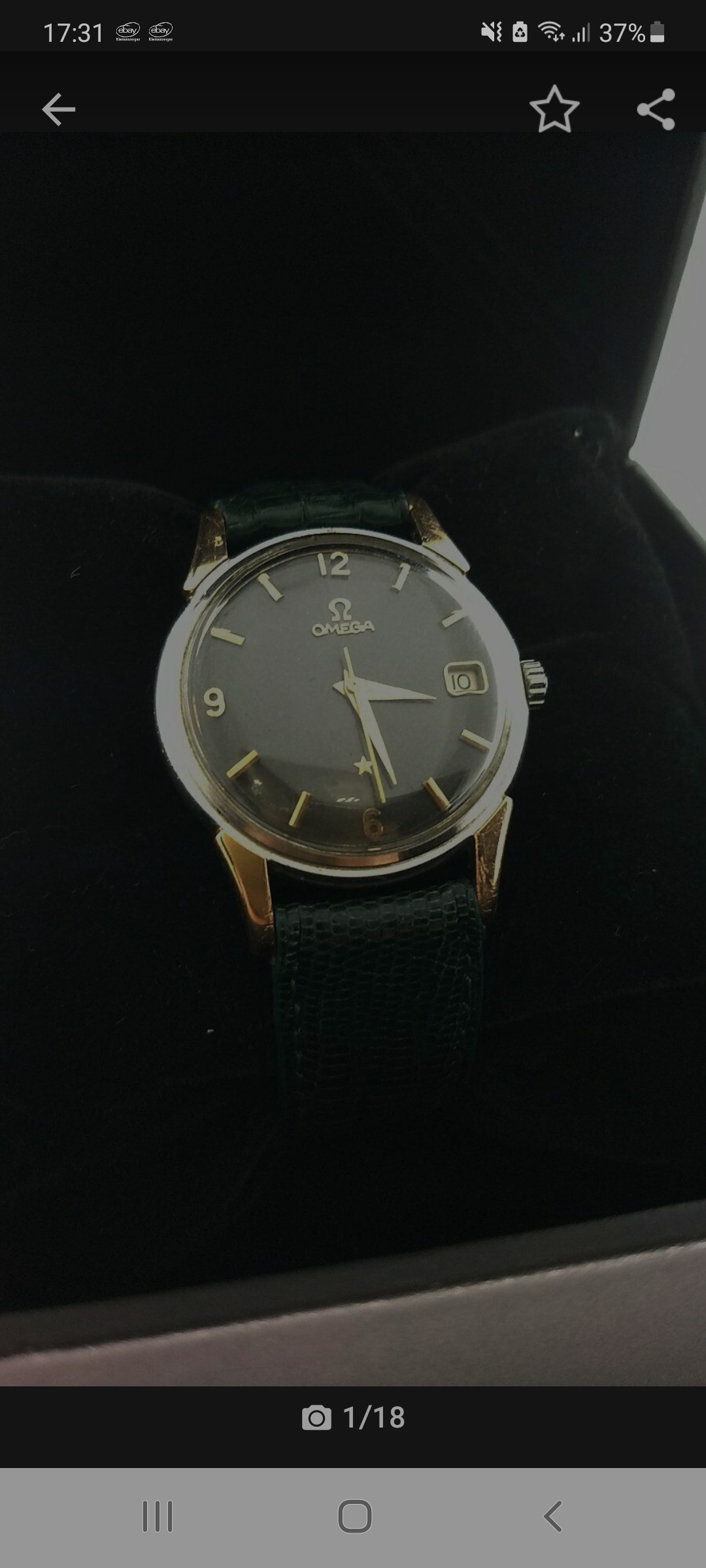

What do you think? Second markers missing?Just a poor redial? And what would be a fair price? Thinking of buying it....

Bad redial and it's missing it's bezel. 😲
Thanks, you are right, I didn't notice the bezel yet👍

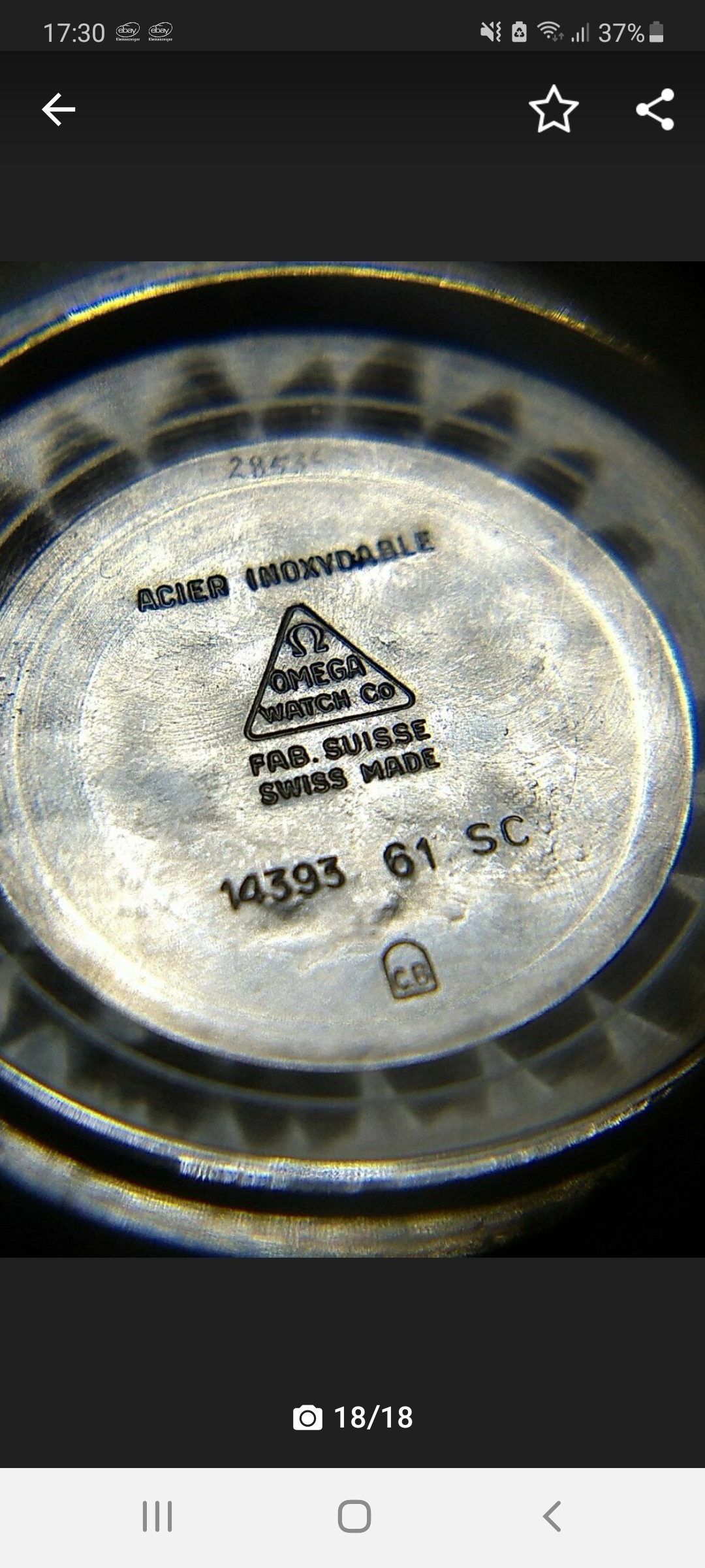

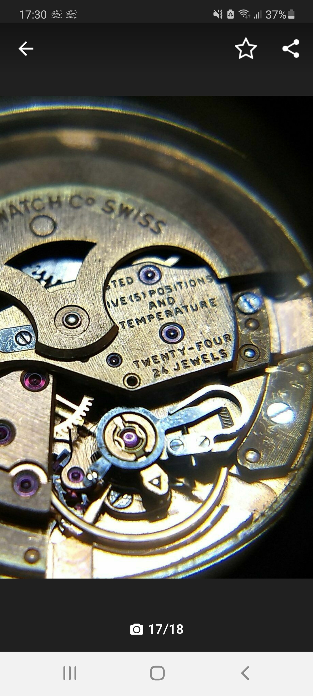

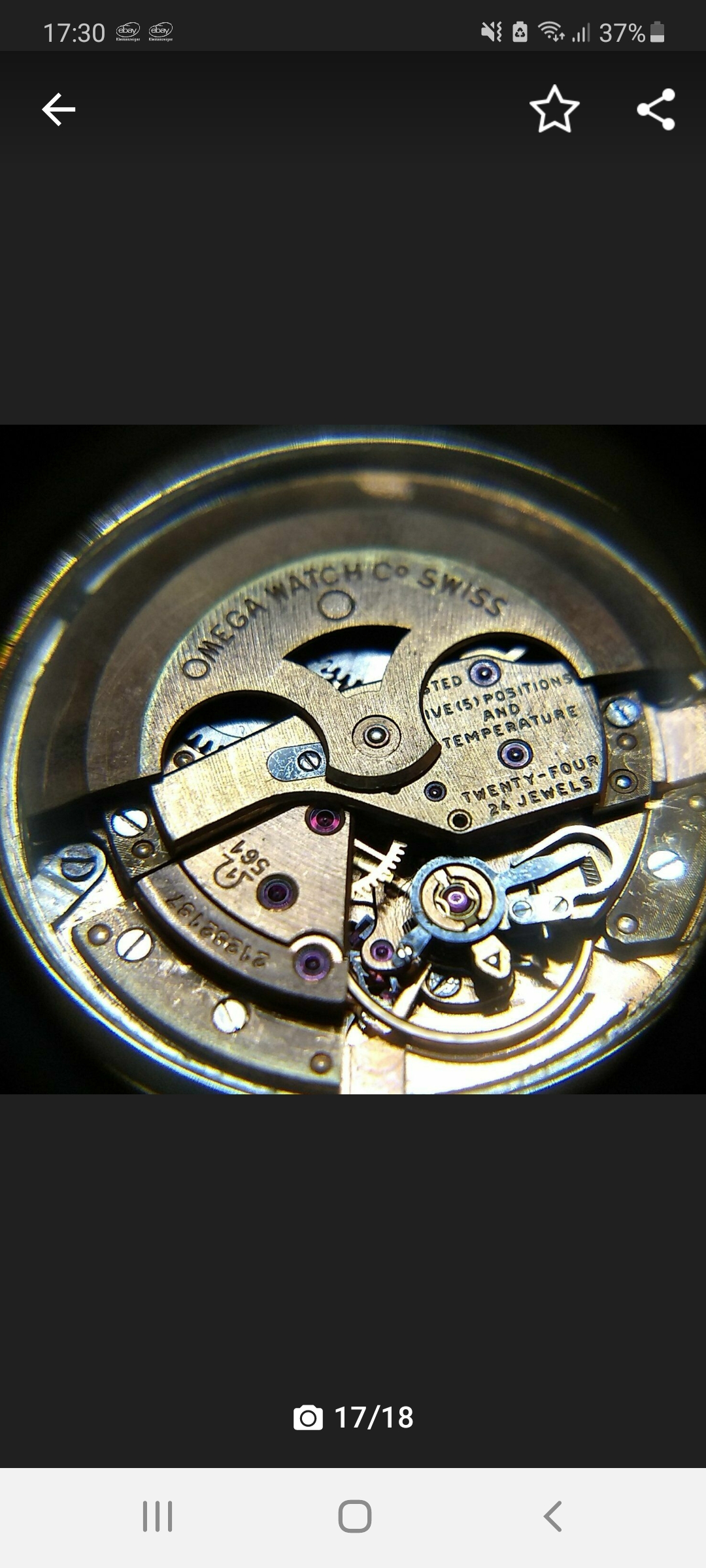

Plus, heavily patinated movt - who’s serial number is too late for this reference.

It appears to be completely missing all the text too! If you were considering buying this awful watch that I'd respectfully suggest you slow down and first learn to identify a correct watch. As I mentioned in another thread most black dialled Constellations for sale are redials or bodge jobs. I think I was looking for three or four years before I found one that I wanted to spend my cash on ( but I'm very tight with my money 😉 )

This watch is wrong on so many different levels. 🙁🙁🙁
