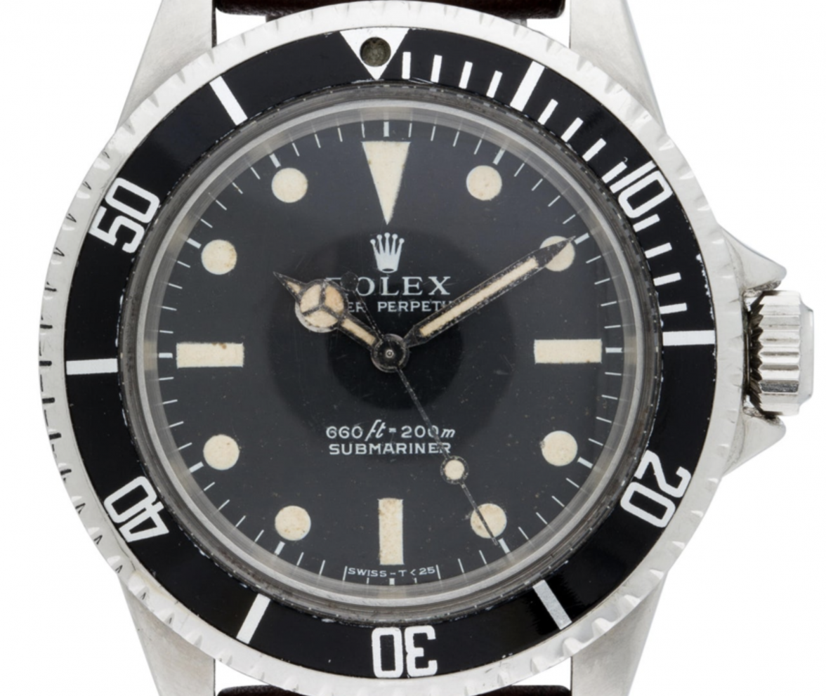

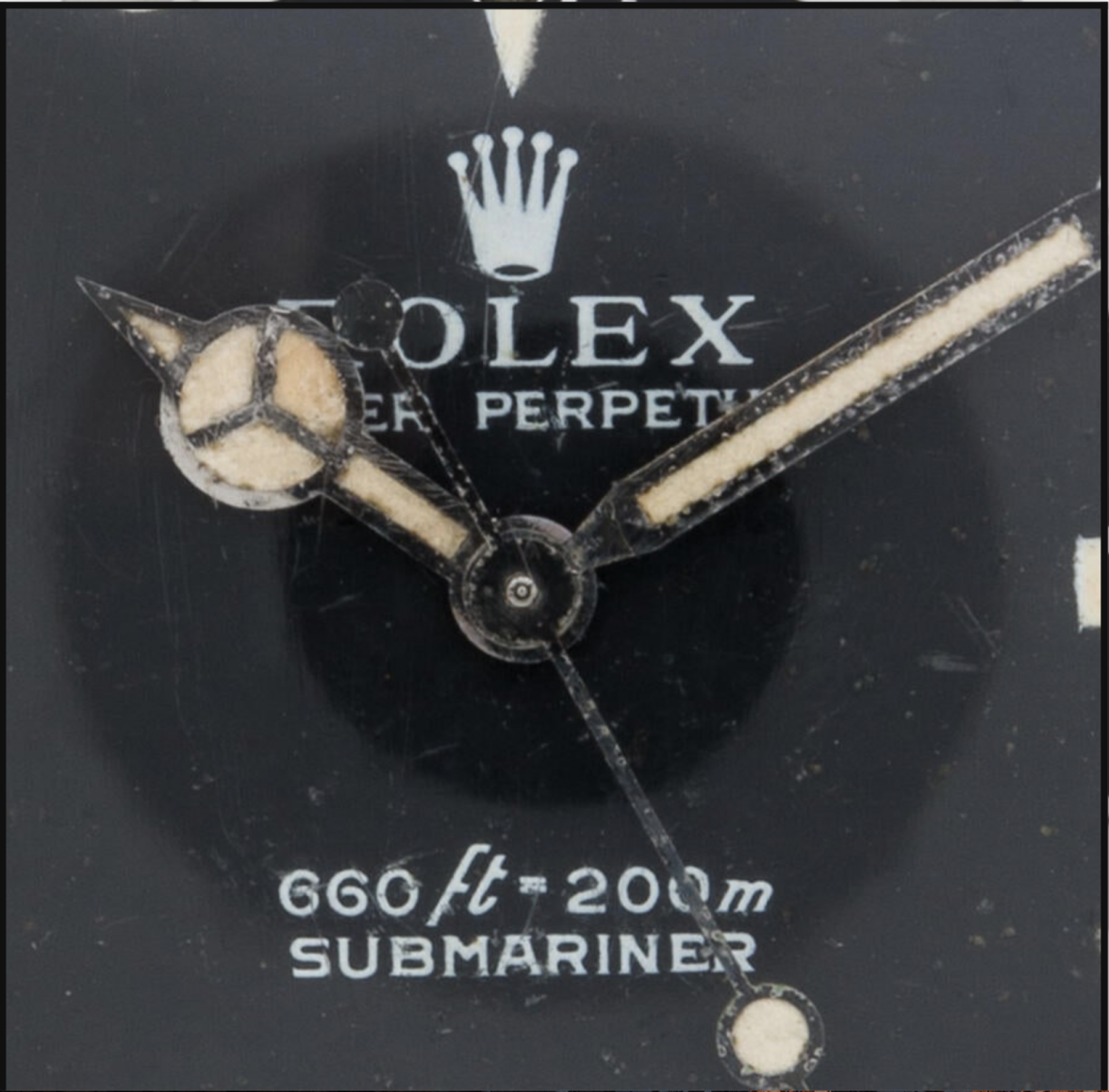

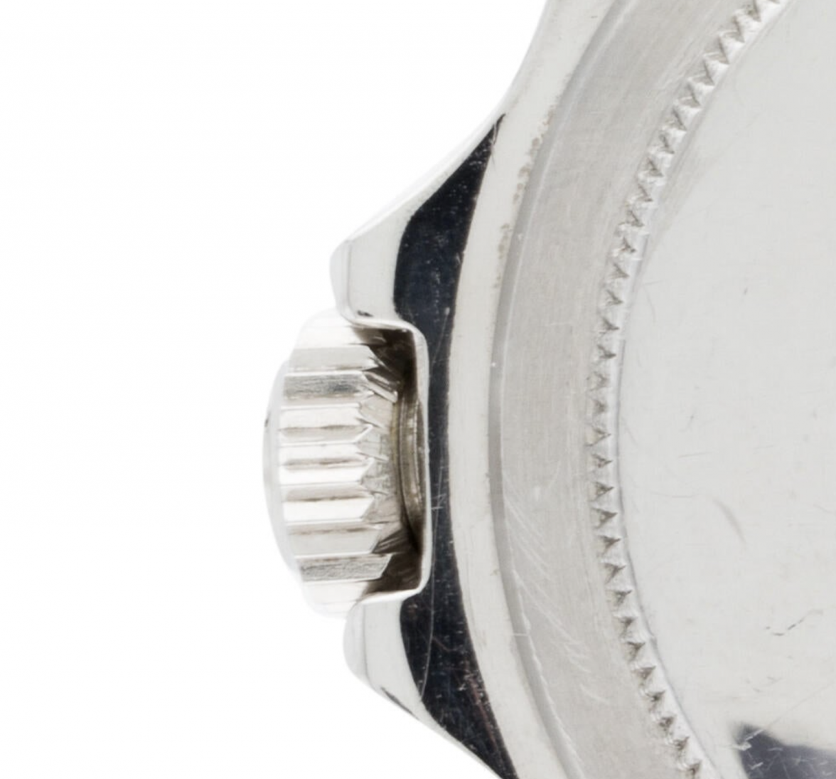

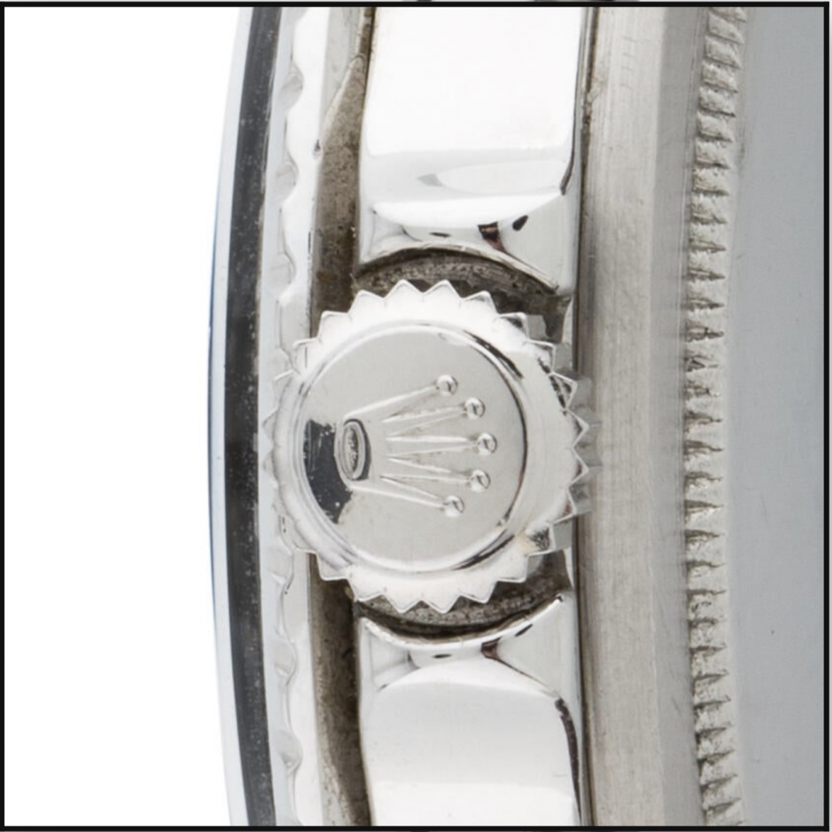

can 5513 gurus comment on these hands please. They seem to deteriorate faster than the rest.
This will be my first vintage Rolex. I appreciate your thoughts.
24,801
55,084

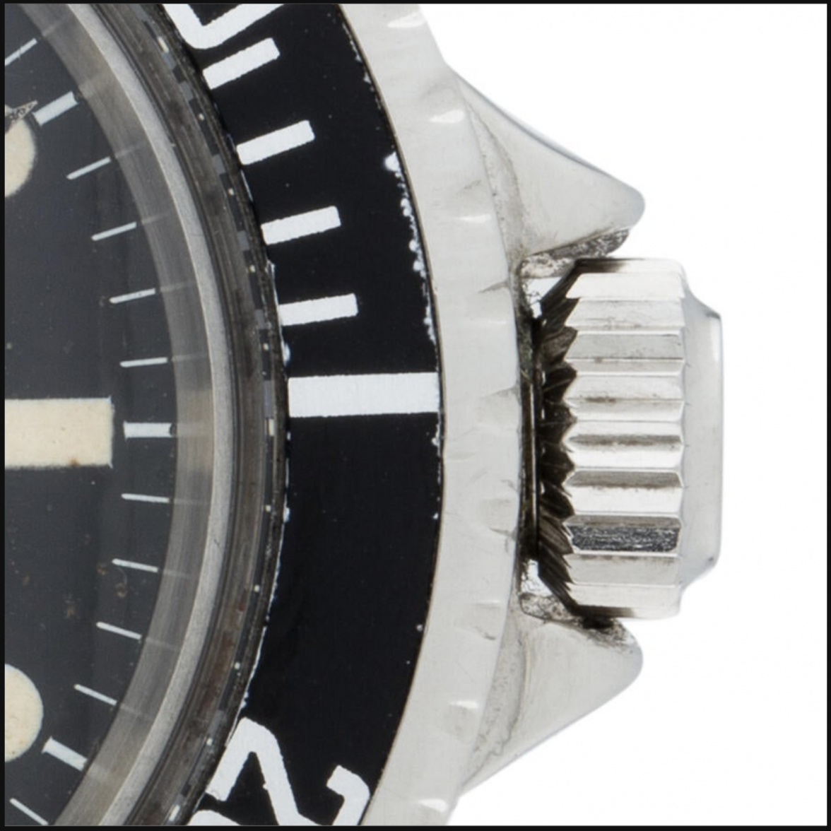

I don't have any concerns with the hands based on those photos. The crown guards are a different story.

Looks pretty normal to me.

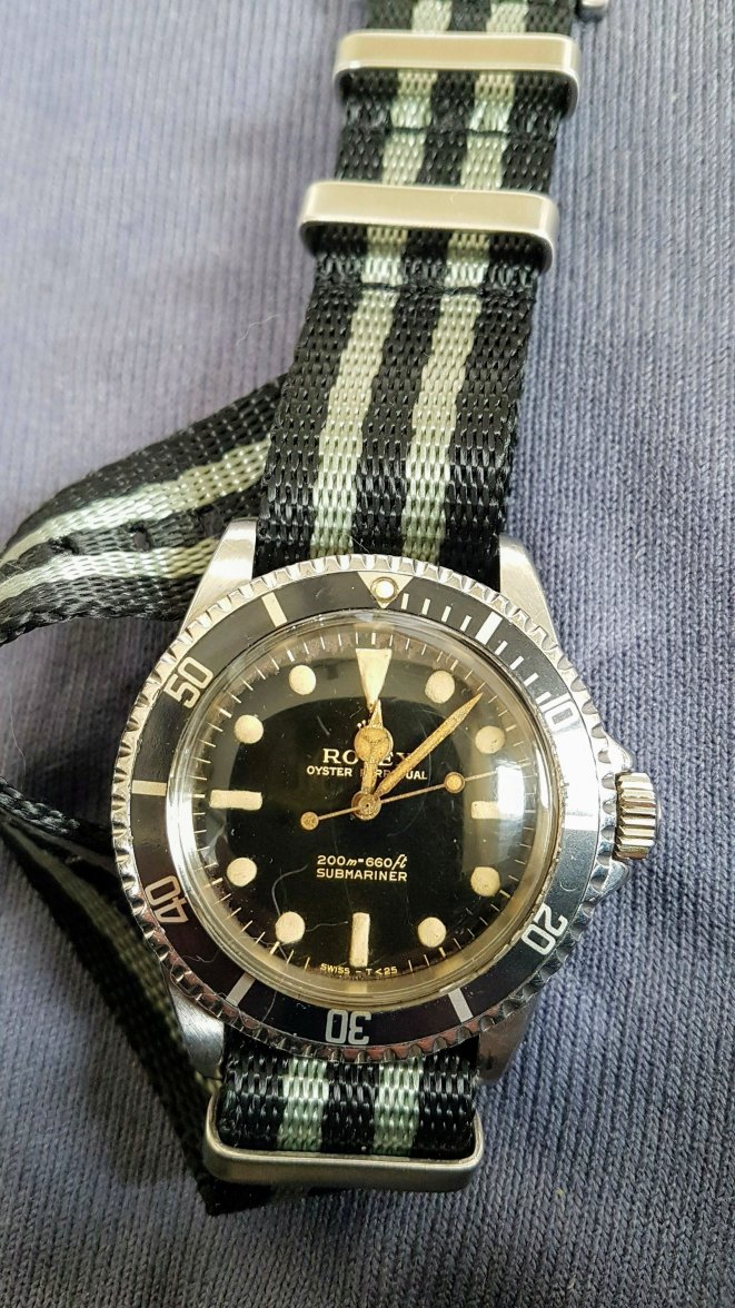

These older hands often pit and flake. Unusual to find as usually they have been changed out at service. This is a gilt 5513 with attractive "frosted" hands.
Note the degradation of the gloss laquer at most of the minute track. Fortunately this doesn't notice when wearing and has not progessed since I have owned it.
What's the dealio with the crown guard do you see?
24,801
55,084
The crown guards are badly overpolished. I can't see the rest of the case, but you might want to take a close look at the lugs.

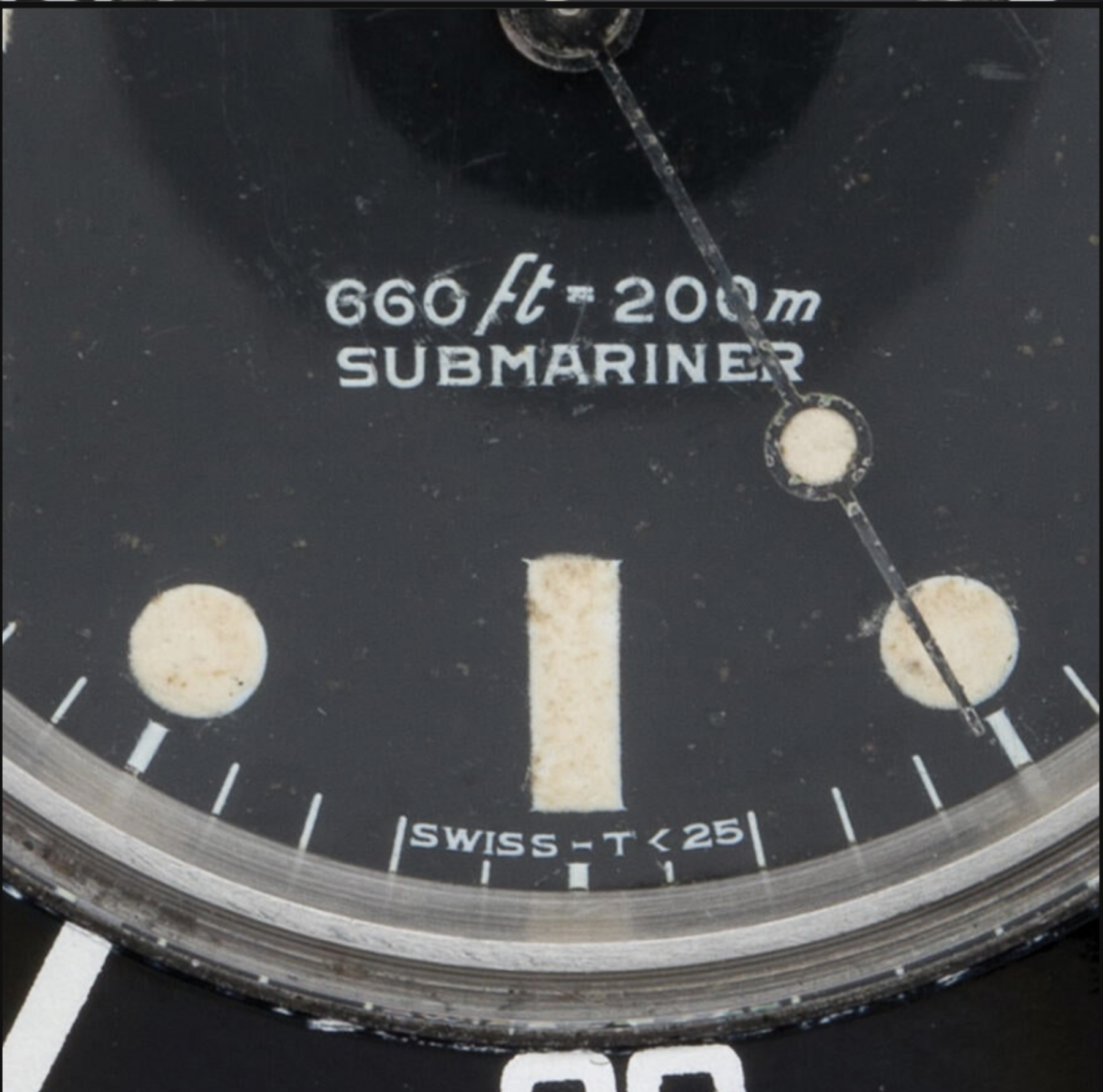

Insert isn’t correct either. Add another $2k.

What’s the give away for the insert?
Asking is 12k
It should be one of these two, depending on serial:

It should be one of these two, depending on serial:]
lovely pair
25 million serial number
