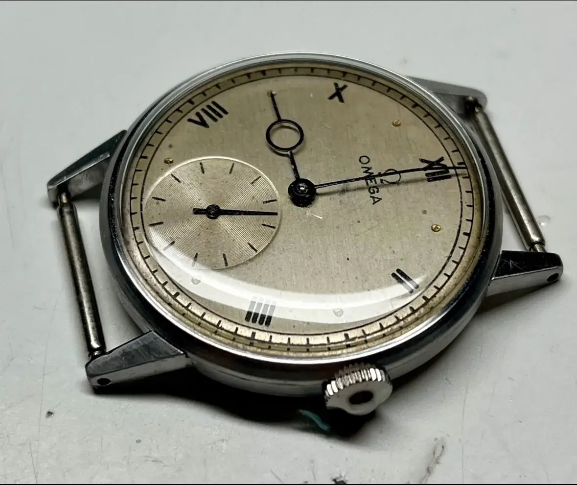

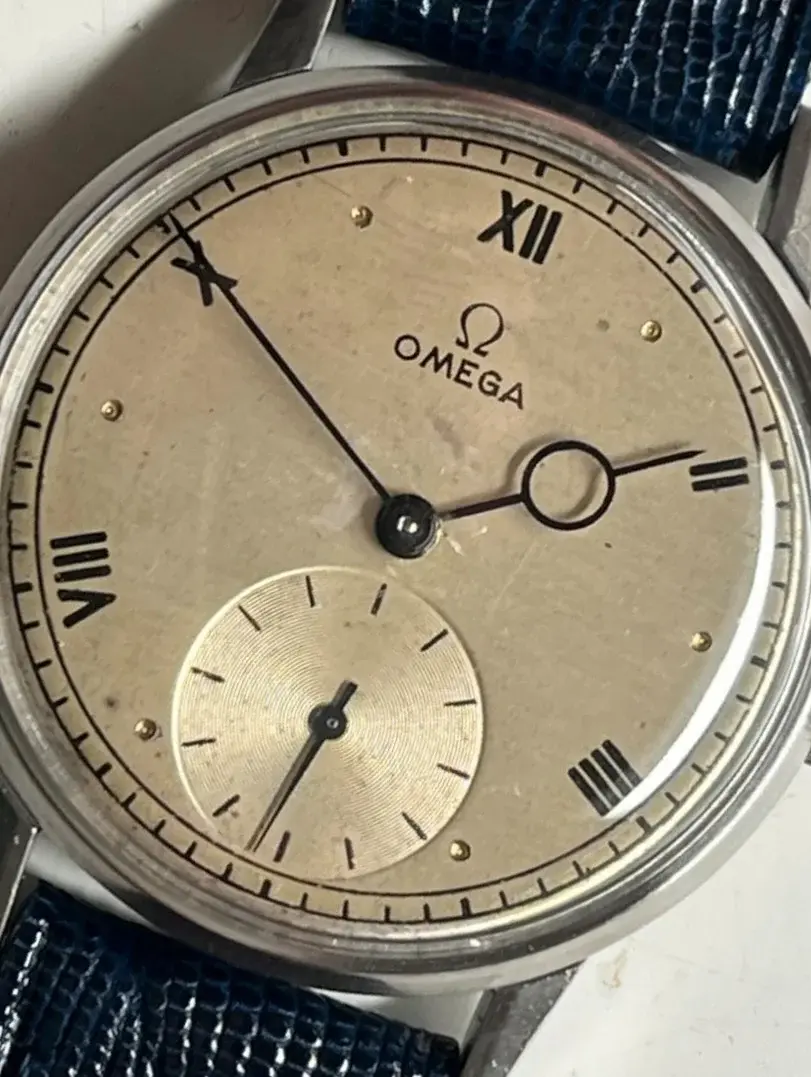

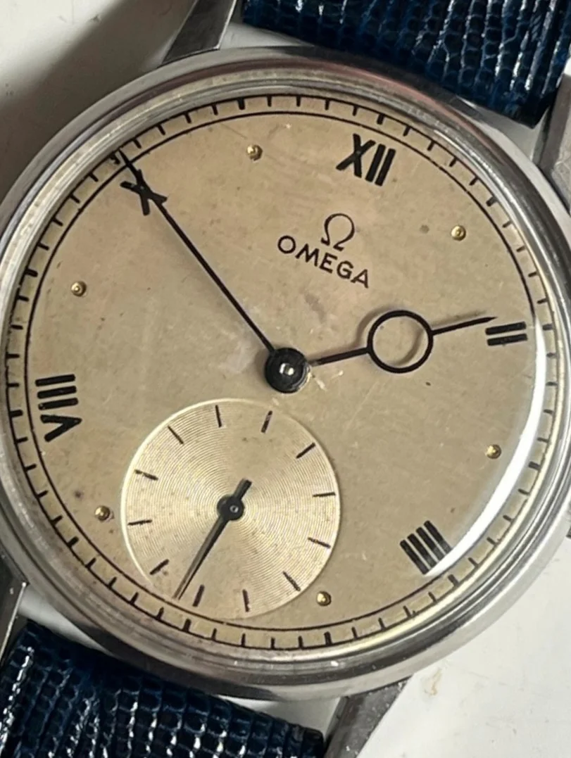

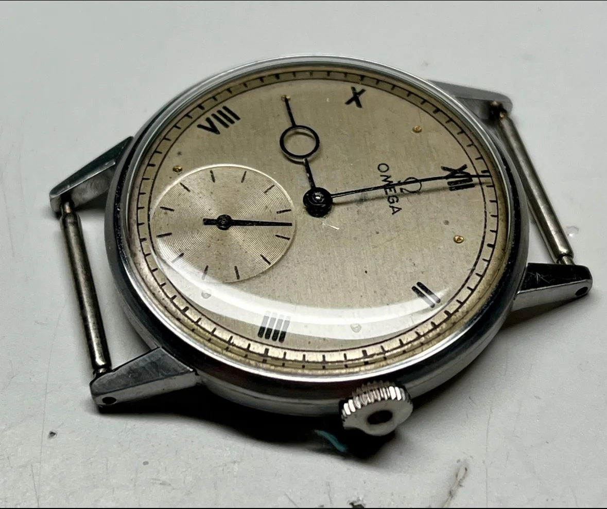

Hi guys! Can anyone help me verifying if this dial is original or repainted?
Would appreciate your help! 馃榾
Best regards,
Jon
18,867
39,252
My immediate reaction is that the dial has been re-painted.
The markings are wonky/irregular and ill defined.
The Omega text is blobby and I can see no Swiss Made.
The sub-dial still has a nice clean pattern and the Pontife hands are quite nice.
While we expect perfection these days, at the time this dial was made, printing equipment and techniques were not as sophisticated as they are now, even though, I still think it's re done.
44
27
Thank you very much for taking the time to write such detailed answer 馃榾! I am no expert in 30s and 40s Omegas and thus have a hard time evaluating this watch. The indexes especially in the outer part of the dial are quite uneven, and that was my reason for posting, as I would like a few other opinions.
9,418
78,815
Nice looking watch in many respects and although doubt may eat at you, 99% of watch wearers would neither know nor care
44
27
Thanks, I know. But it is prices as original, so I woule prefer to be quite sure before buying.
9,418
78,815
I hadn鈥檛 appreciated that you didn鈥檛 own the watch.
Although photos, particularly through crystals, can distort if you look at your photos, the minute markers appear to vary and lack the consistency that you might have expected.
44
27
I am not sure I understand your answer. My only wish is to get other collectors opinion on whether the dial is original or a redial.
211
188
I am not an expert, but one of the tells that I look for is alignment of the dial print. Where you have a subdial with concentric rings as we do here, it's incredibly easy to spot mis-alignment. Here the 20 second marker overshoots the outer ring, whilst the 25 second marker appears to undershoot. It's fractional, the rest of the markers look OK.
The other thind that looks off is the drill marks at 1,3,5,7,9 & 11 o'clock. I've never seen them quite like that before. Could this be left over marks where there were once hour markers? Would anyone go to that much effort?
216
151
There also appears to be a thickness to the print which is greater than one sees with original factory printing.
