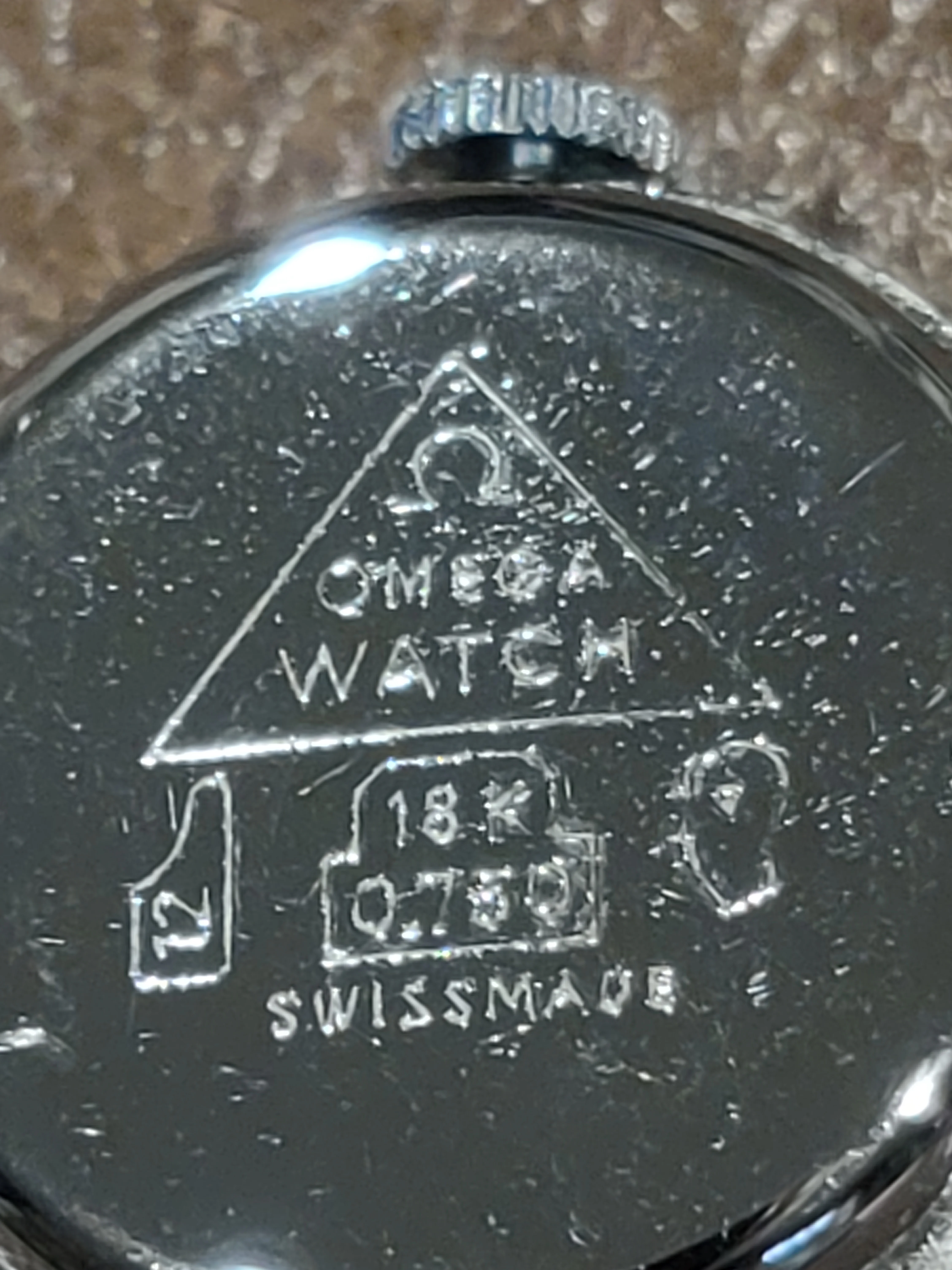

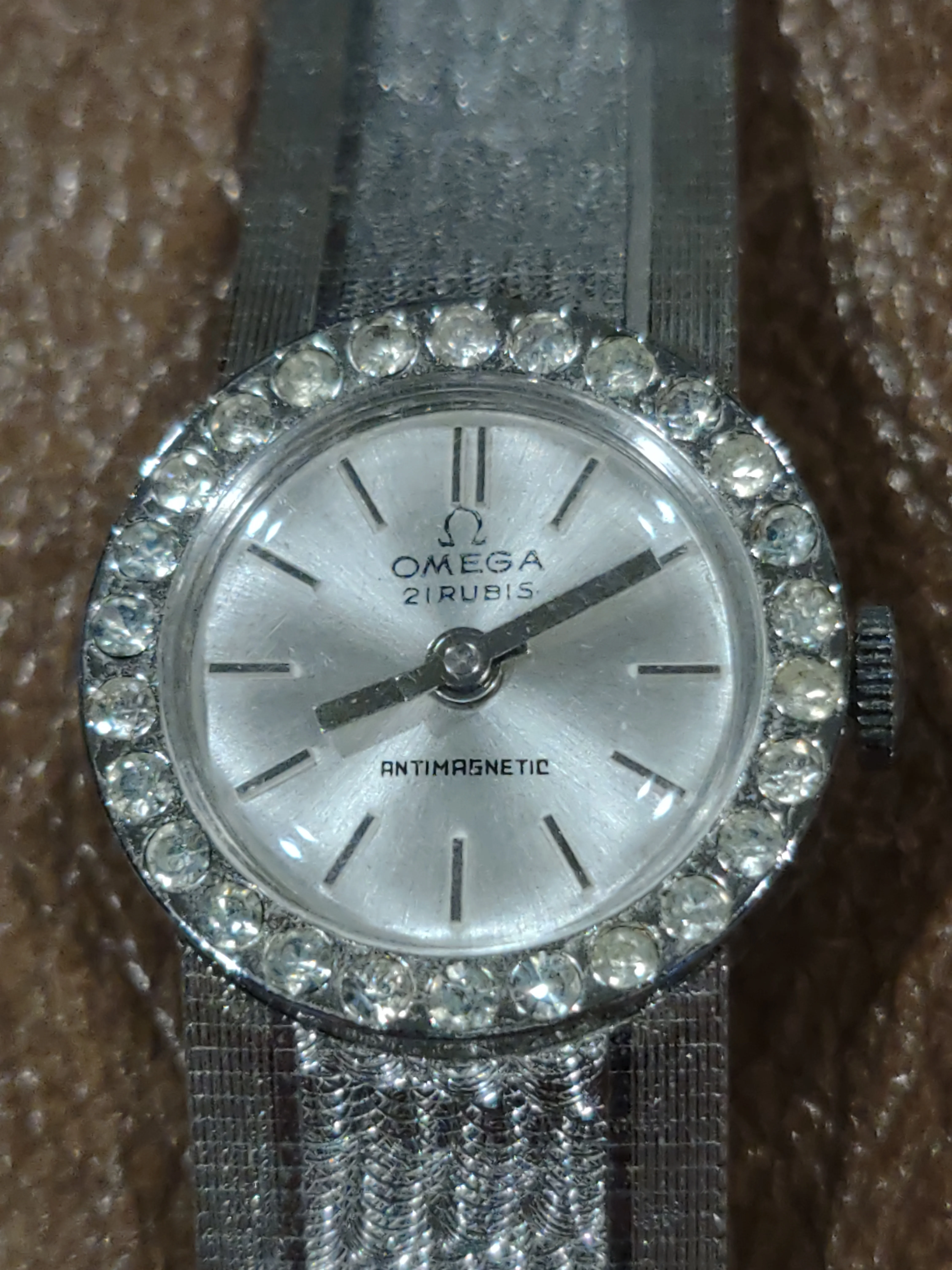

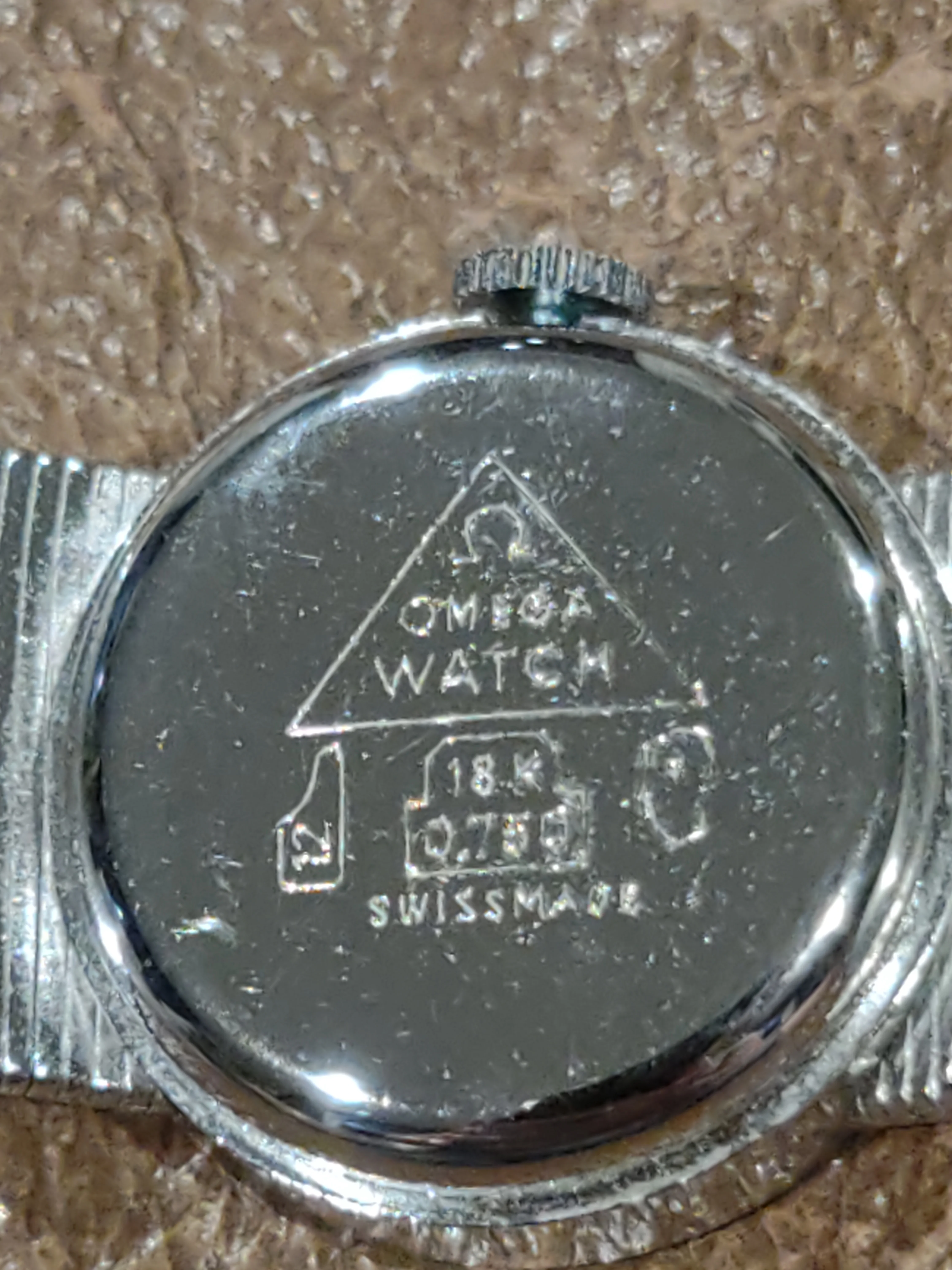

I inherited this watch and know nothing about this brand. It's a beautiful watch. Can you fine folks help me learn about what I have? Thank you. Any assistance with where to go to search for more information would be appreciated.

Basics.
Omega never indicates the number of jewels (Rubis) on the dial.
Never used the word antimagnetic on the dial.
Never marked the exterior of the caseback with their logo and hallmark stamps.
There are other indicators that jump out when you've been looking at Omegas for many years, but the basics are enough.

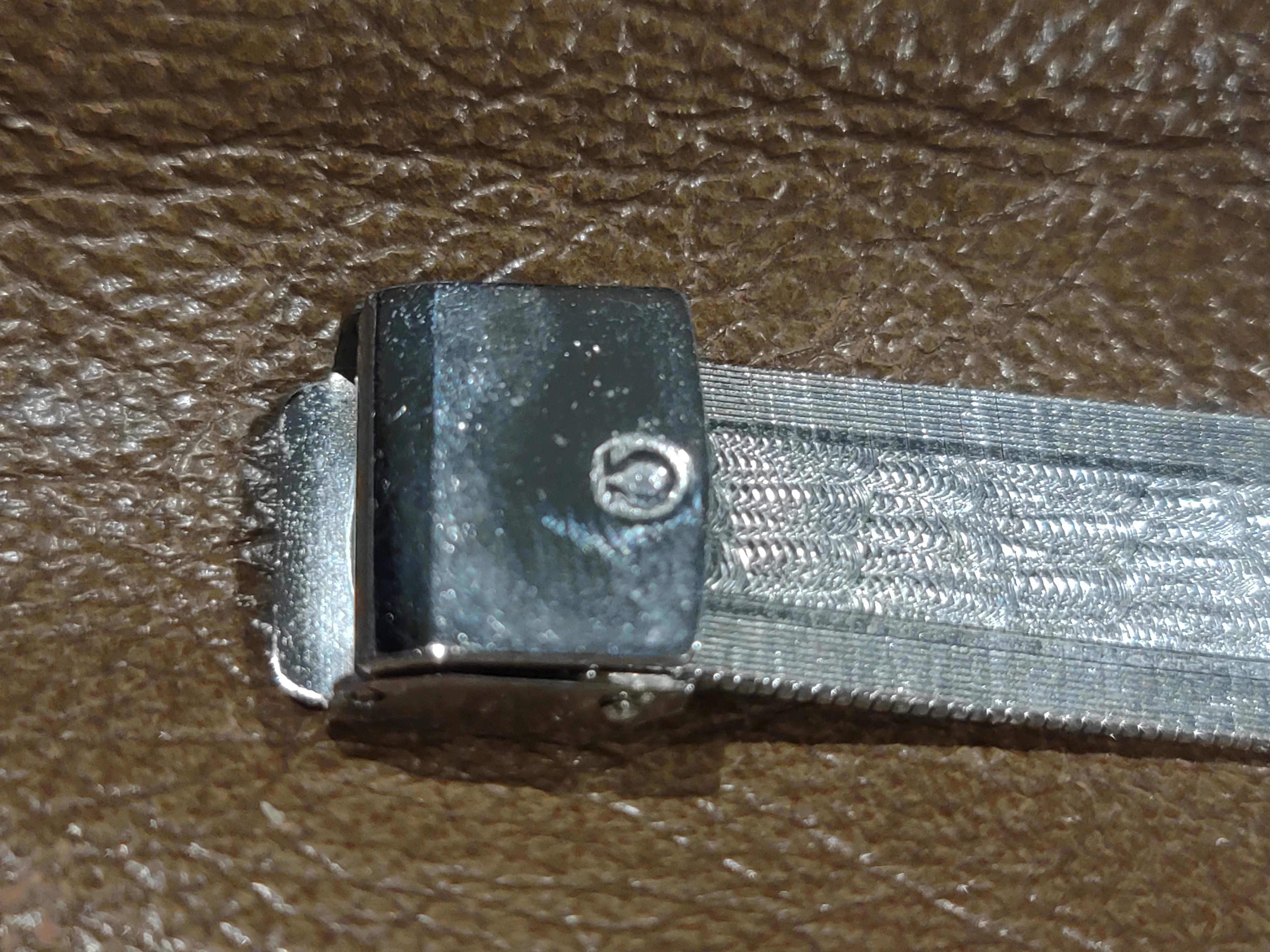

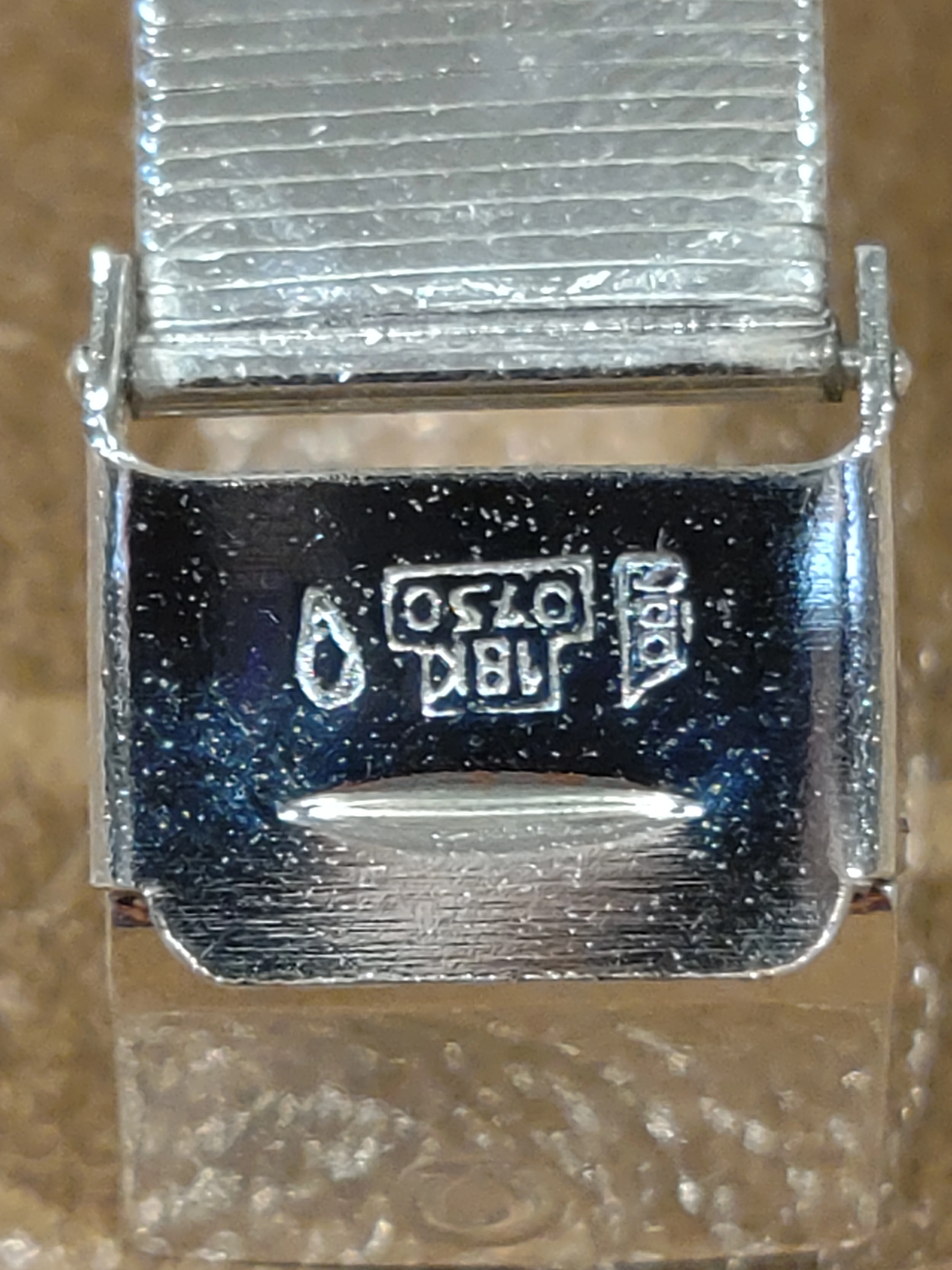

Rhinestones (fake diamonds) are a dead giveaway! Cheap bracelet clasp would never had been put on a real Omega. Poorly placed Omega logo on the dial is off centre.
