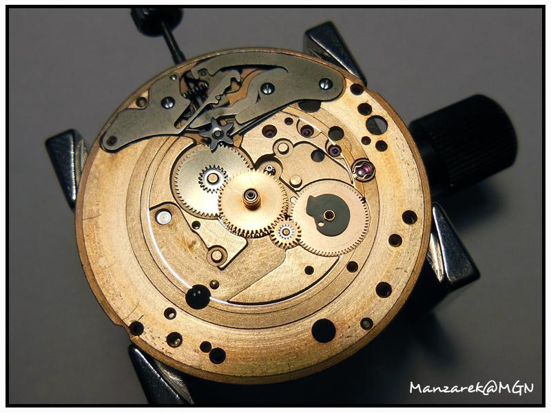

well, in short, when you try to set the date between 11 and 1 the date finger is about to make the disc jump. before (circa) the mid 60's, this device had no security that allowed the "disengagement" of date finger.
I'll try to find some picture to explain. It'as almost 1 in Paris, time to go to bed 😀
See the date finger on this photo (neer the incabloc) the steel part on the brass wheel moves onto this wheel. it has a little pin underneath stucked into a slit So when you set the hour it can moves freely from the brass wheel (about 1/5th of a 360 rotation). but when the movement work it turns clockwise so it goes its way.
