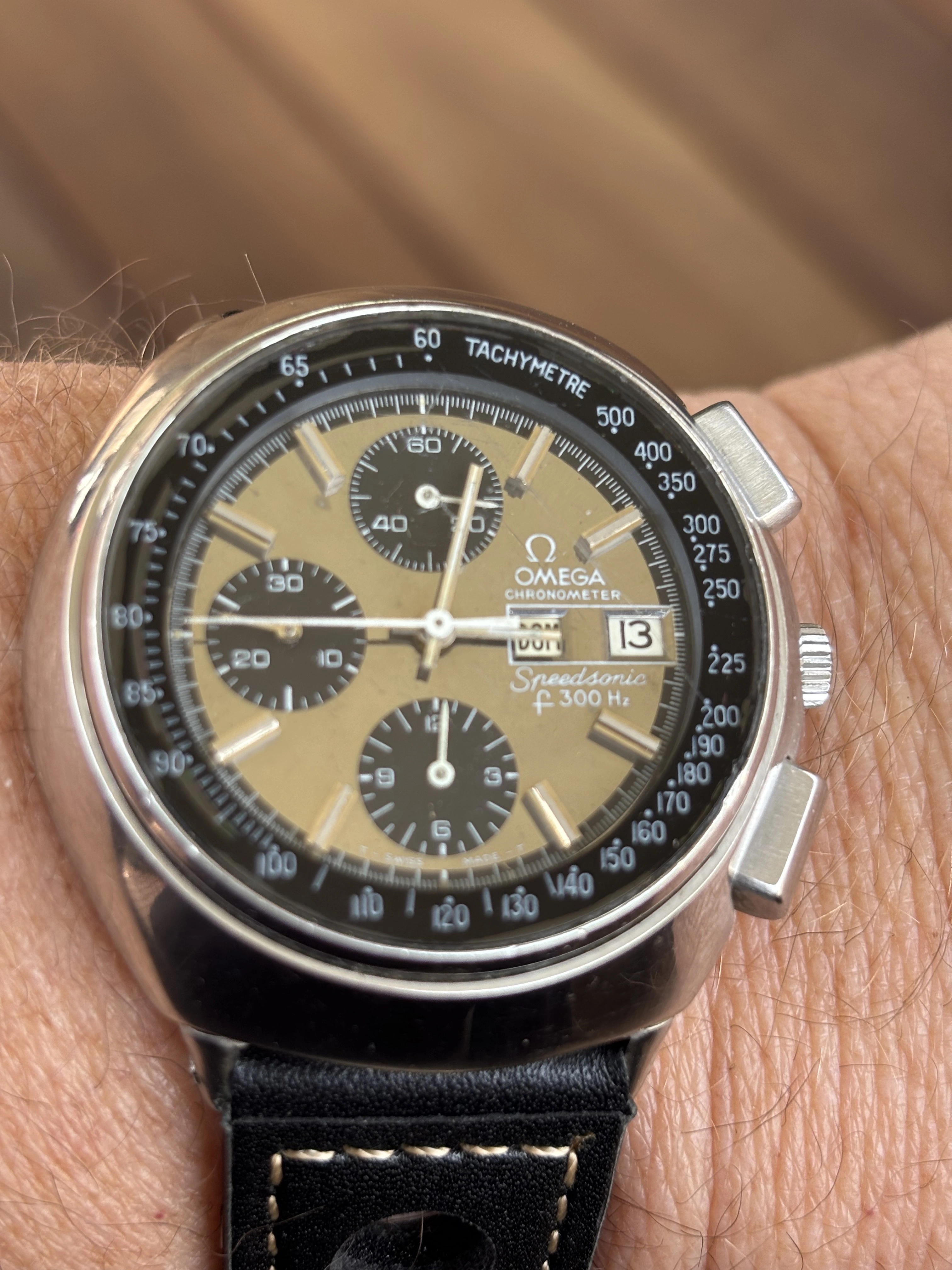

Well after a cooling off period in customs the speedsonic has arrived.
Glad it made it through after inspection by customs - came from Venezuela so that might explain a lot.

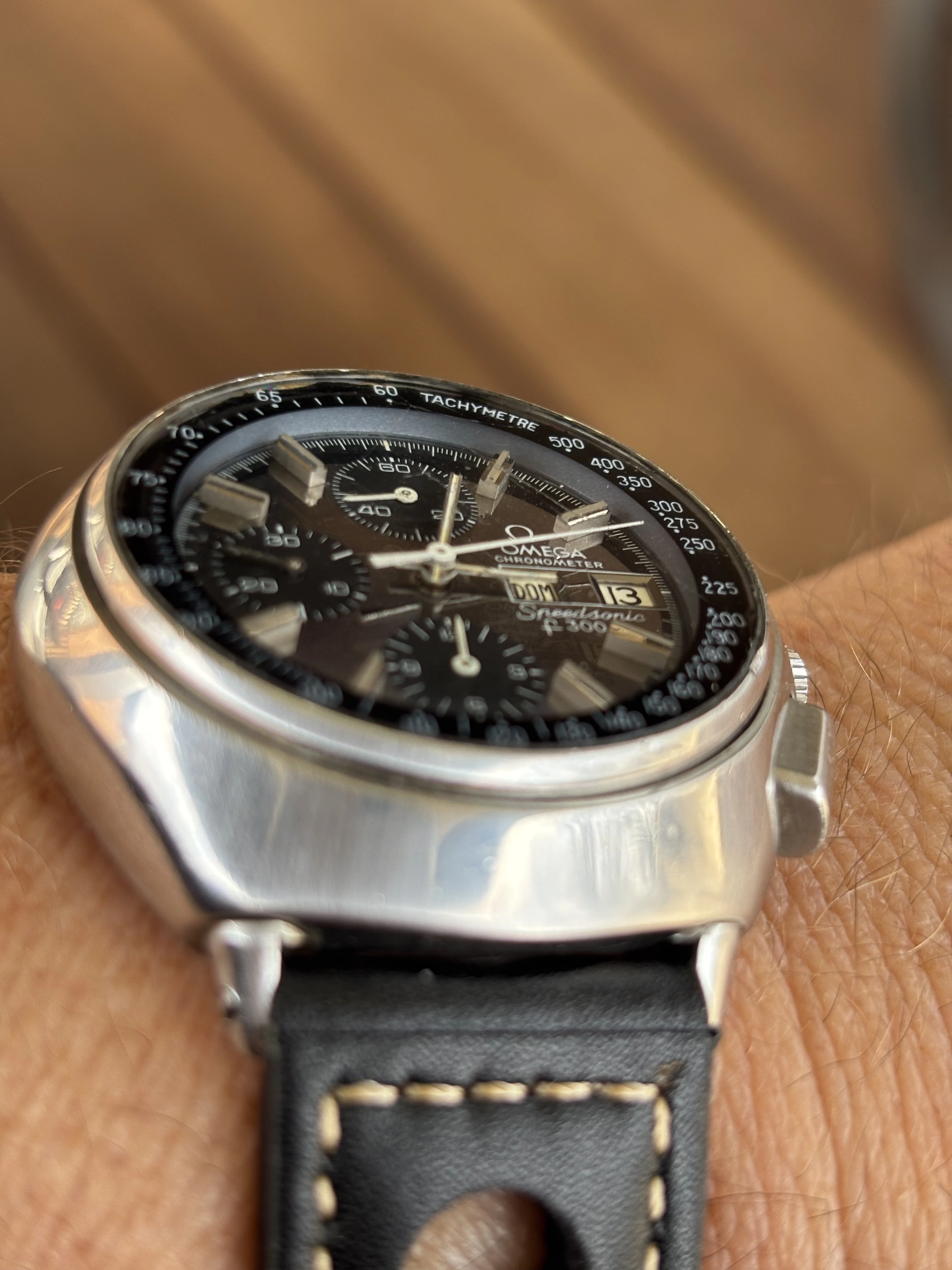

A few observations- the crystal looks fine from some angles and from others, well it’s a disaster. Still on the hunt for the gasket although other projects have jumped in and I’m waiting for responses from a few supply houses.
I didn’t realize that if you don’t have the lobster band 1) you really need to use the OG pins as standard pins are too skinny. Glad mine came with the pins. 2) 22mm bands are tight because, well, it’s really a 21 mm opening. For now I have a cheap Chinese leather band with the original pins. Will look at other straps later.
Overall still pleased w the watch and will enjoy it more once the crystal is scratch free.

There is a bit of a ding at 4 which might impinge on a replacement glass without a touch of metal work. I may try some of the various pastes to improve the glass a bit and let Rob do the work when he services the watch. Pressing the glass into that dent could be tricky.
