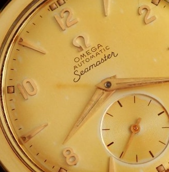

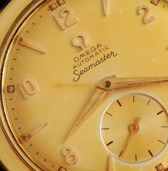

Here's a watch that sat in one position for a few weeks 馃槻 馃う:
It's fine if you like that kinda thing...

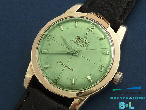

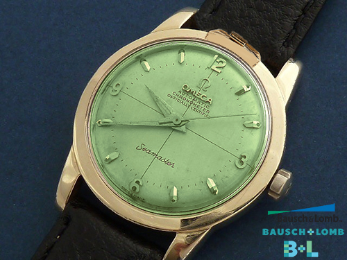

For those that are worried about such things, At one time Bausch and Lomb made a sun screen in several sizes that you can attach to the bezel of many brands. My wife makes fun of me and calls them my "Watch sunglasses" 馃槨
Nice.
It would be groovy if you could get your hands on a bunch of these...馃グ
Do I see a hugely successful 'Group Buy' in the future?
After all, it is nearly summer, the sun is ready to wreak havoc 馃槻, and we need to protect our investments every way possible..馃憤
390
439
Your wife is exactly correct. But ignore her on this issue. ;-)

Wishful thinking, these came out during the Norman Morris era. I picked up about a 1/2 doz 10 years ago from an old Omega AD in the D.C. area. I've seen them pop up on eBay once in a while, but they are hard to find as sellers don't know what to call them. 馃檨
