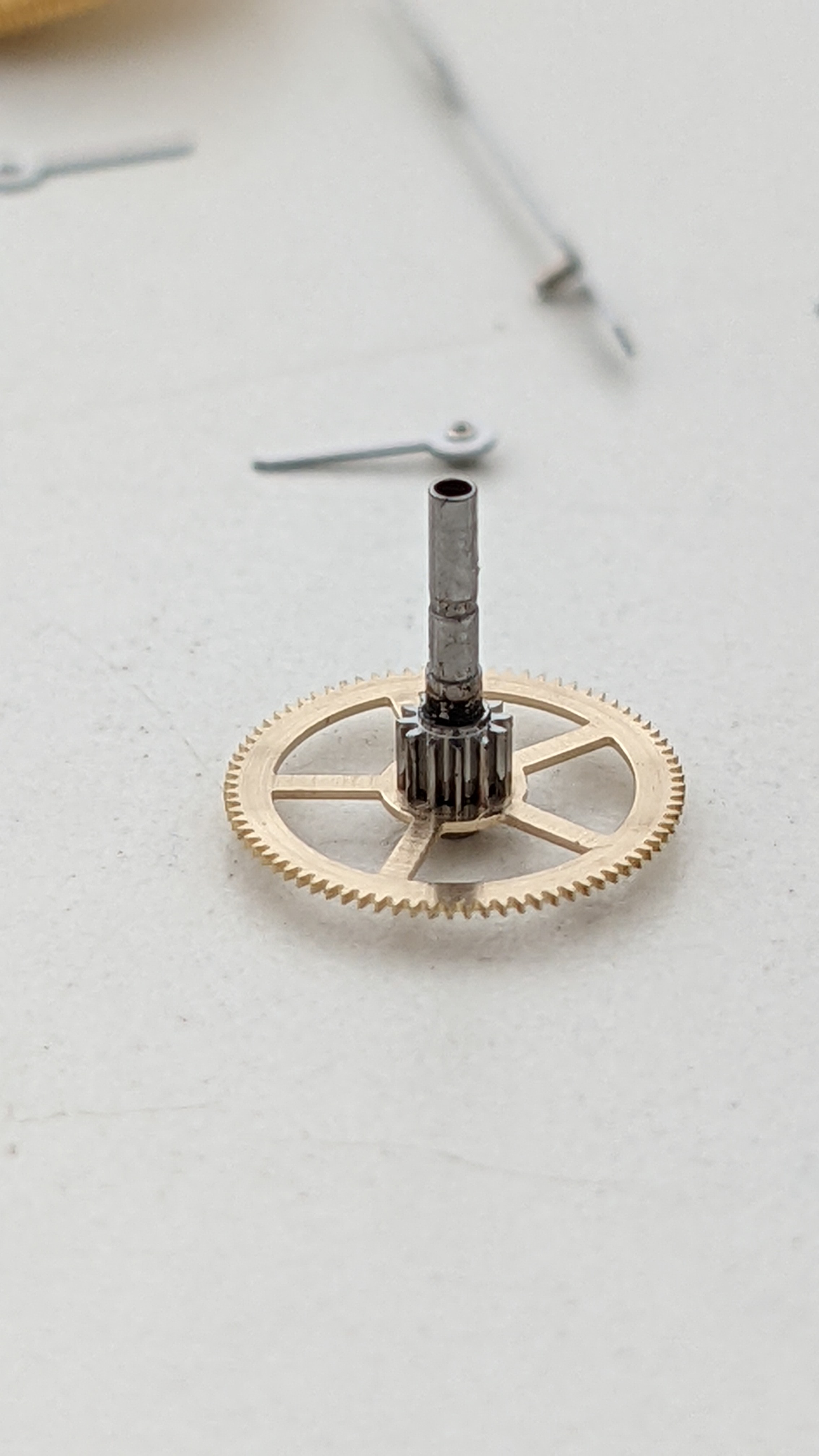

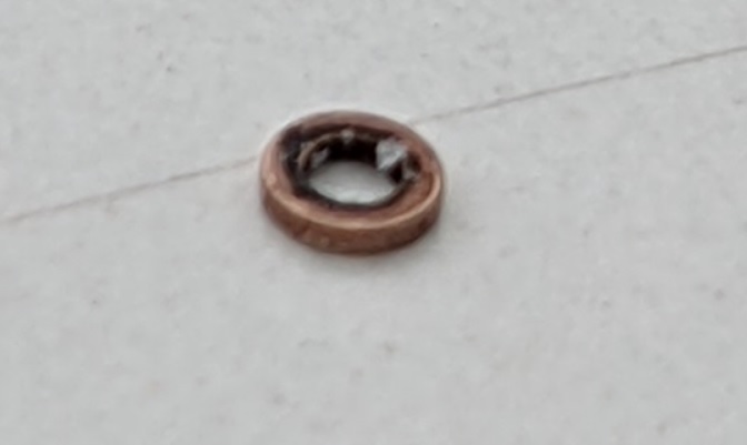

This is the problem bushing...
The redesigned bushing is silver coloured.

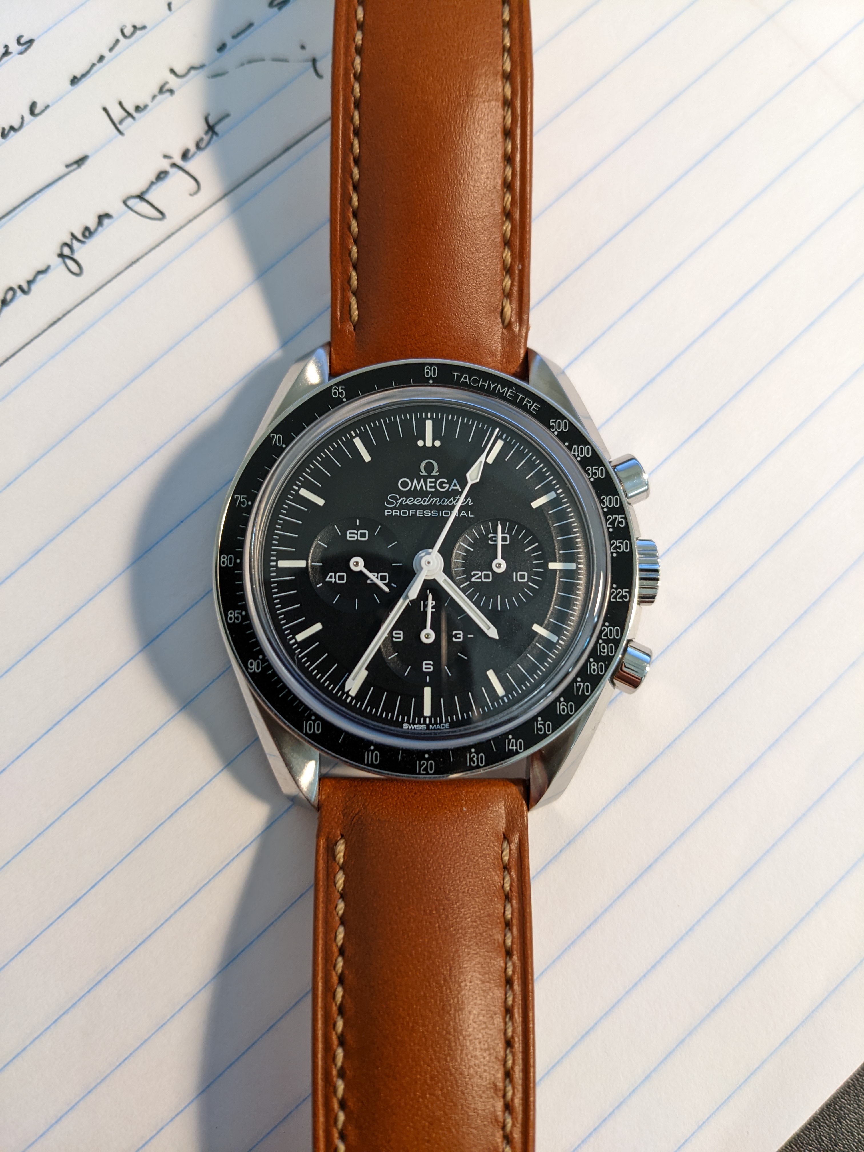

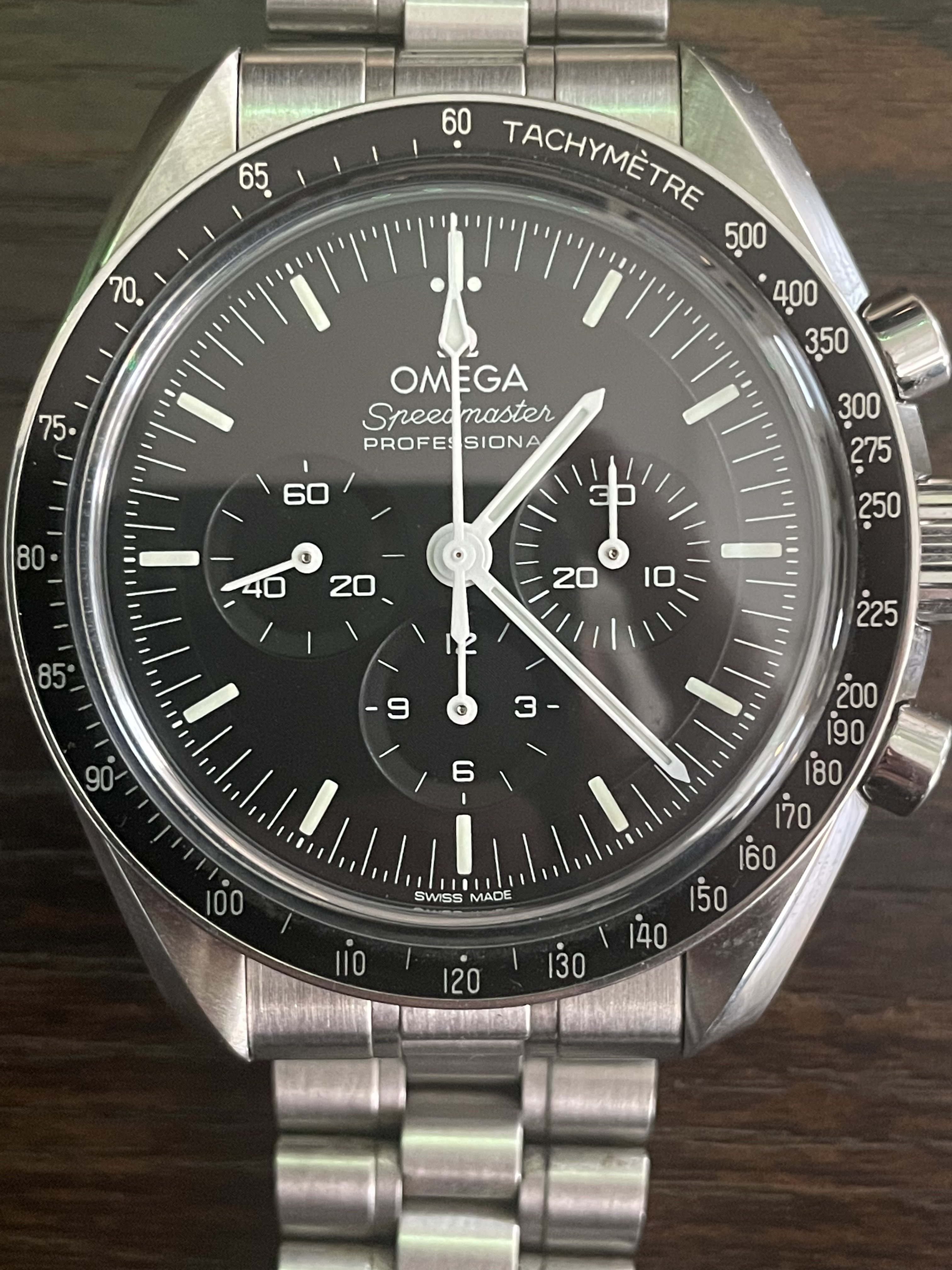

Just received my 3861 back from the service center. We’ll see if the issue is fixed, but my chrono seconds hand is still misaligned slightly to the left. Very frustrating to find this after waiting 2 months for the service.
3
I just picked up my watch yesterday (after a 4 month wait) and it also came back with a misaligned hand -- the hand on the hours sub dial is slightly off center to the right. I don't know if my heart can take another multi-month service trip.
84
243
Is the hour hand sub-dial mis-aligned when the chronograph is reset? it looks to me to be normal since you’re running the chronograph.
63
196
Mine also had this same misalignment prior to sending it in for the chronograph stopping issue (see pics here), as well as the chrono seconds being slightly misaligned to the left of 12. They fixed the chrono hours but the seconds remain misaligned. Really disappointed in their quality control... for the amount of money that these watches cost, it should be perfect.
And yeah I feel the same about sending it back... the service has a two year warranty so I think I'm just going to deal with it until that time is almost up and then send it back in. Such a shame because it puts a damper on my enjoyment of an otherwise perfect watch.
3
Yes, same with reset. Ran the chronograph for just a few seconds in the original photo so you can see the misalignment better.
84
243
Got it.
