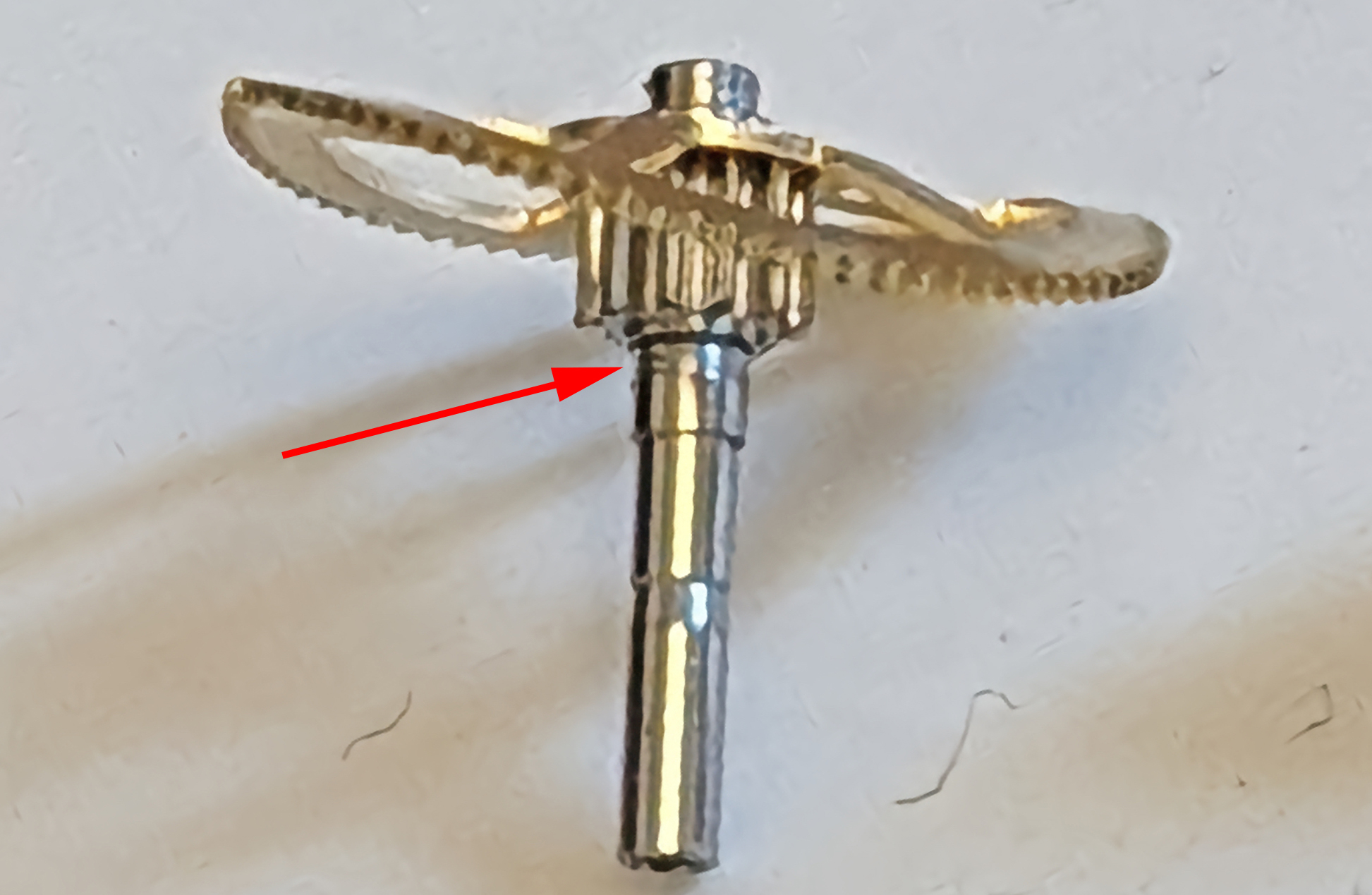

The bent wheel is damage done after it was removed, and not the problem that caused your watch to stop. No watch would run at all with a wheel that looked like that. Possible it was dropped on the floor and stepped on or something.
The real issue here in this cropped photo I've made from yours:
You can see where the red arrow is, that a section of the wheel has worn and is quite a bit smaller than the section directly below the arrow. This whole section should be the same diameter, and should be a polished cylindrical shape. The wear here is obvious, so this is the problem that is addressed during the service, not the bent portion of the wheel.
This is a large amount of wear for just 4 months. I would typically see this sort of wear only after many years of service, running in a watch where the oils have long dried up. I suspect there is some wear on the upper part of the picot as well, above the bent wheel, but the angle of the wheel prevents me from seeing it.
Cheers, Al

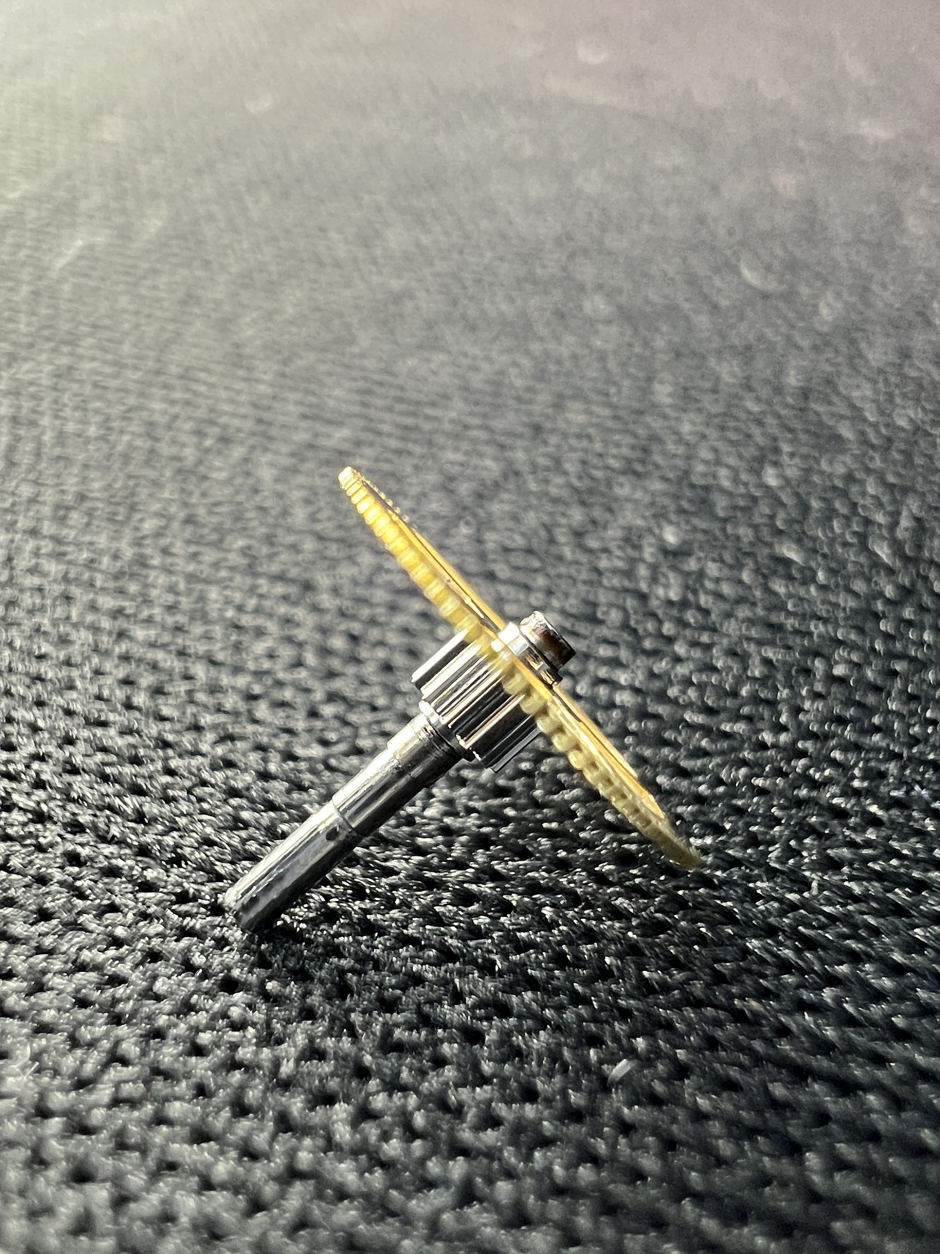

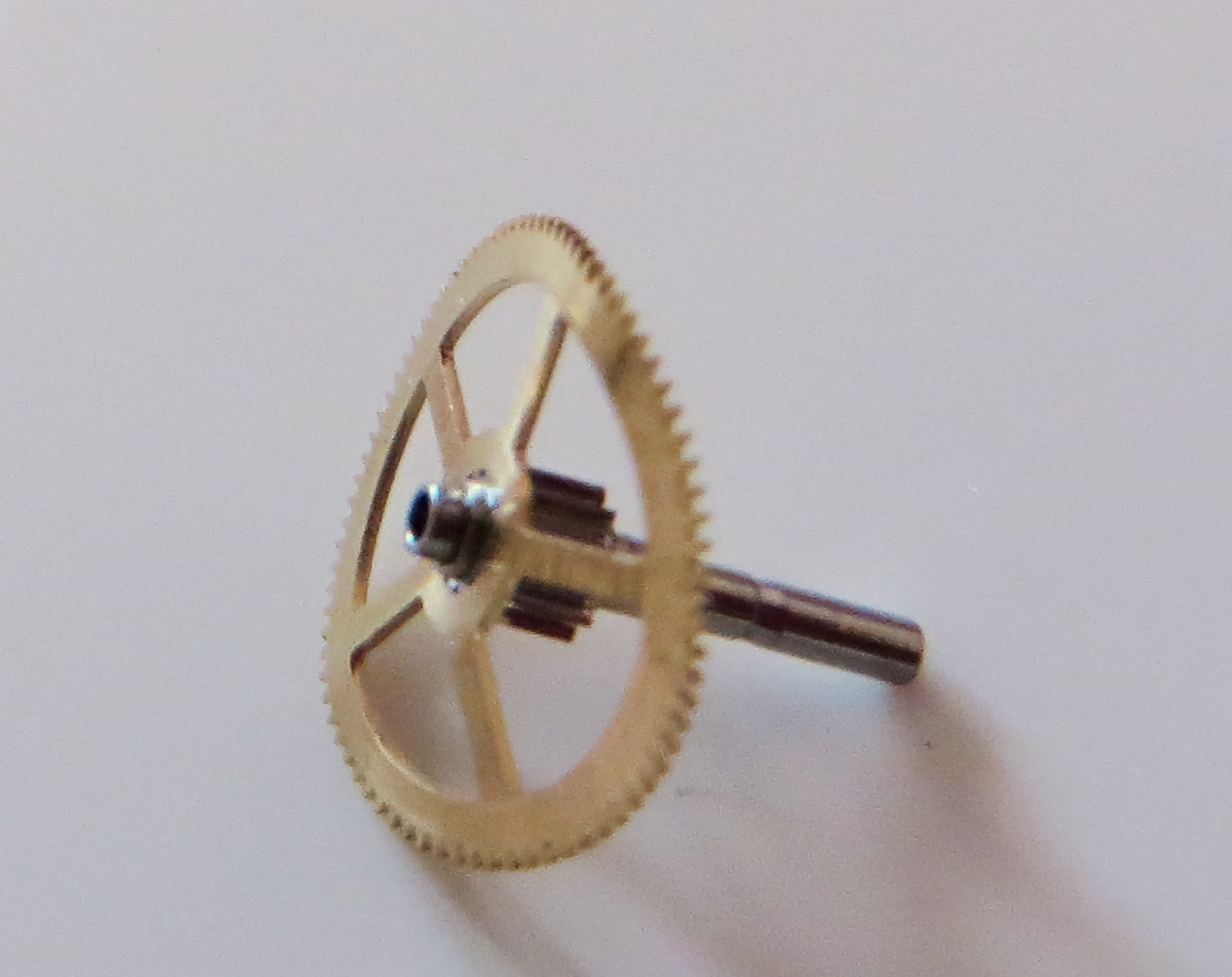

Thanks for your detailed explanation! I was also surprised that the watch failed after only 4 months (so only 120 days of wearing). I only used the chronograph once or twice (for a few minutes) so that does not play a role in increasing this defect. Iam surprised that not all watches fail after a few months, since basically they all contain the same parts, made from the same material, and gone through the same quality control.. Since you were curious about the upper part of the wheel I attached another picture showing the other side of the wheel..

If it's helpful to add another data point, I just got my sapphire sandwich (received from Omega in July 2021) back from service today. I had the watch for 4 months before it started to exhibit the same symptoms described here. I dropped if off at the NJ service center late October, so they had it for 3 months. Here's a picture of my center wheel:

Excellent photo - you can see the wear on the main plate side to the left, and the wear/discoluration on the bridge side to the right...
Excellent photo indeed.. Since I am not an expert but just an interested amateur: is the issue caused by an inferior center wheel, or by a lack of lubrication, or maybe something else? Thanks in advance for your explanation..

It鈥檚 the material used for the respective bushings.
