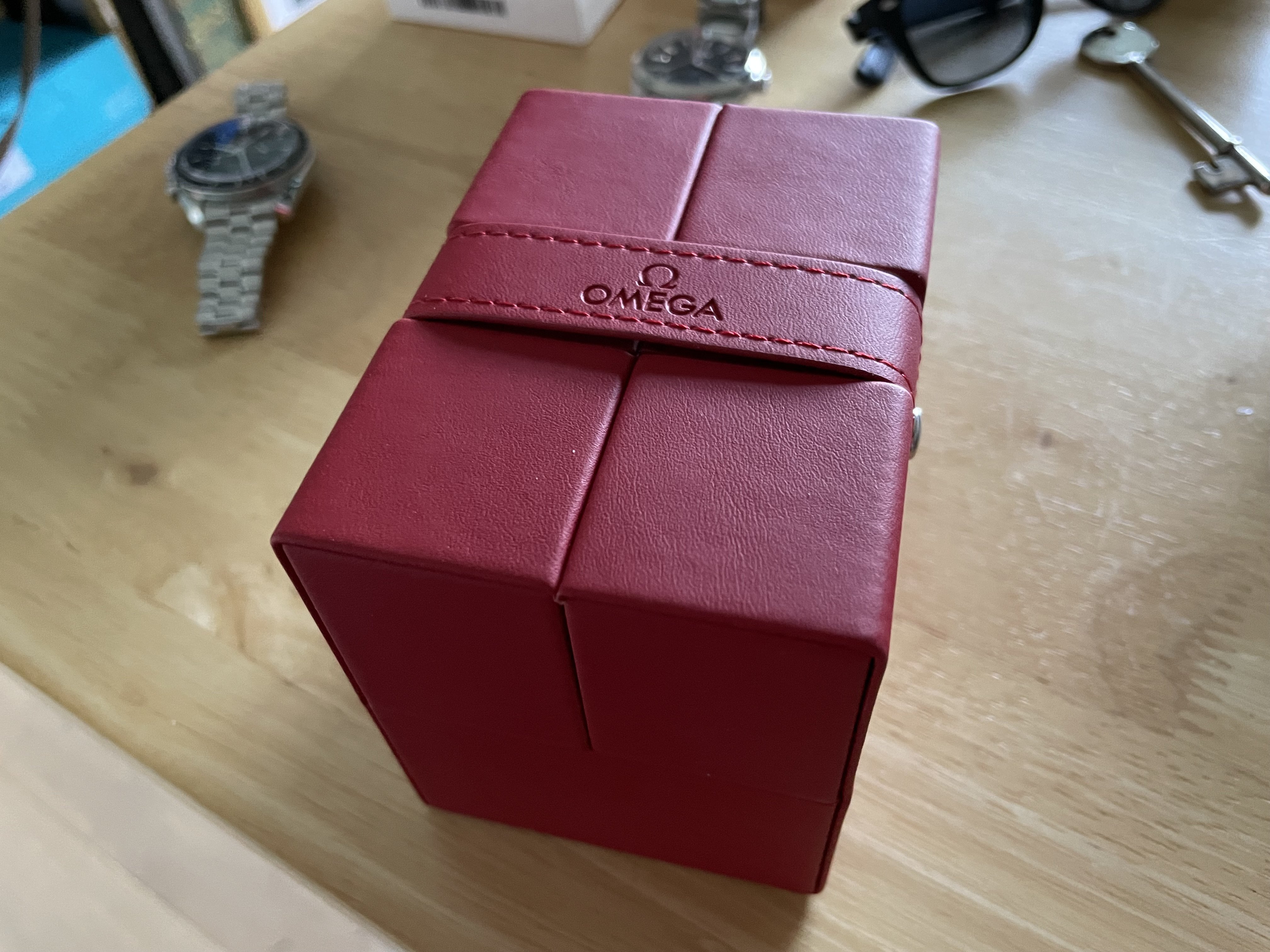

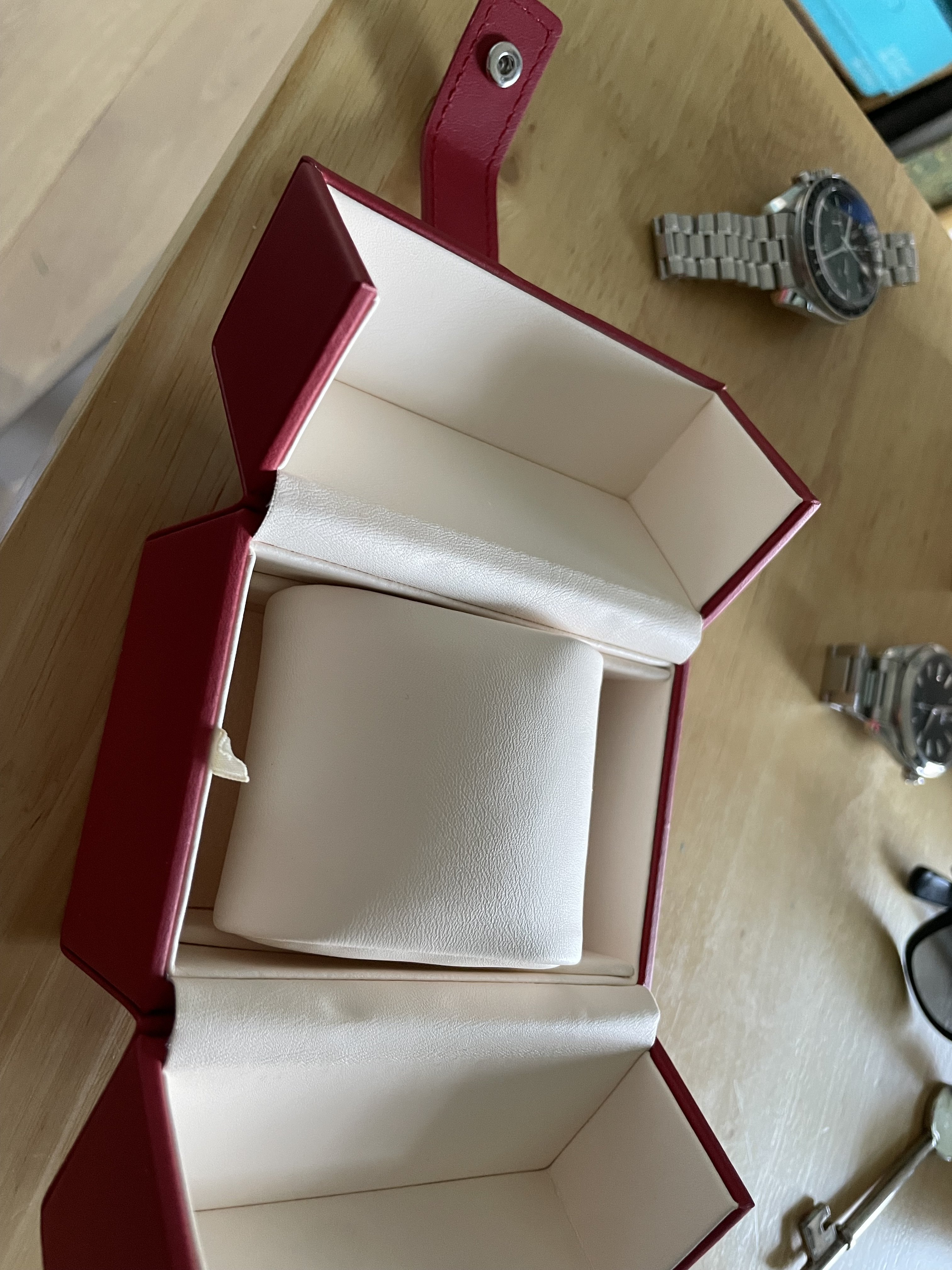

I had the same issue as described above, bought watch in early 2021 and recently it just stopped. I took it to the boutique and the guy told me I had probably ‘overwound it’ whatever that means. I have always wound the watch once per day, in the morning. I waited while he filled in some forms but he was taking too long and I didn’t like the cut of his jib so I took the watch home and asked Omega to send me a return box. This they did, and told me it would take 12 weeks. They have just returned the watch after about 2 weeks indicating that it has had a full service. They also included a cool red box, did anyone else get one of these?

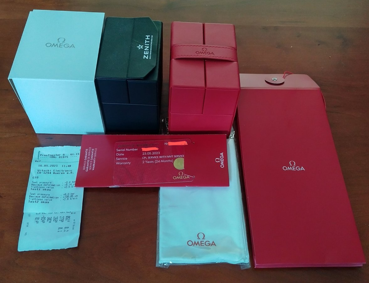

Yep, got it with my A11 50SS which got the issue 3.5 years in:
Yes, I got the same red box, when picking mine up from the OB.

Good call on handling the service yourself, anyone who says you "overwound" it deserves no further contact with your watch.
I am surprised at the quick tunraround, but hey as long as they gave you the service card and 2yr warranty I'd just call that part a lucky win.
