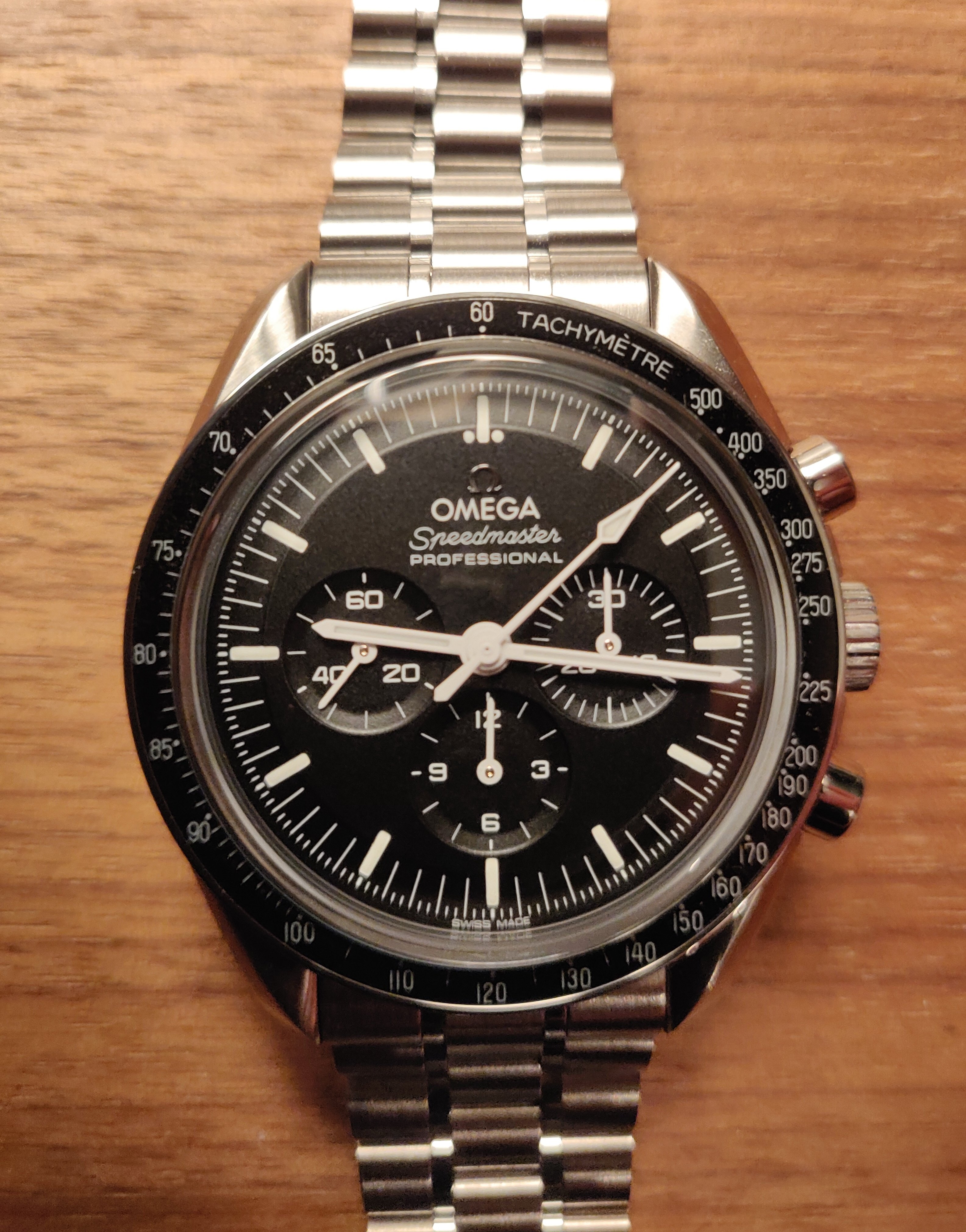

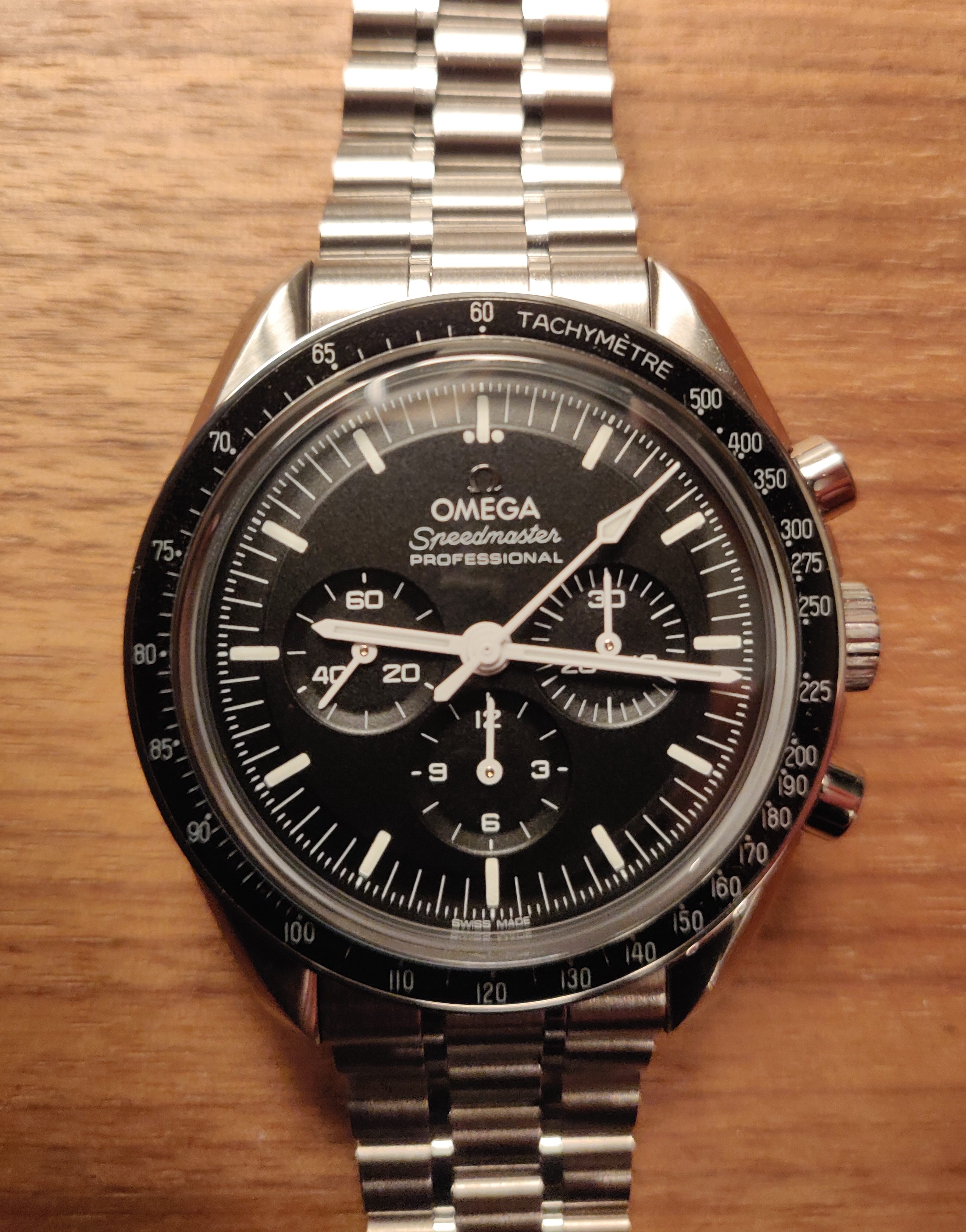

I managed to buy long waited Speedmaster 3861 sapphire case version on week ago from local AD. Watch performing extremely well and I'm very happy for it. When I started to look very precisely chronograph hour hand, it's very little on rightside. Hour hand pointer still fit the zero marker on the dial. I can easily live with this tiny nyance, but is such small alligment error normal on chronograph's?

I wanted run second hand a bit, that hour hand can see better. Hour hand operating in generally well and I kept chrono on running whole night. I noticed only this very small alligment error on it after zeroing the chronograph.

Yes I reset it and run 8 second that I managed to see the hour hand?

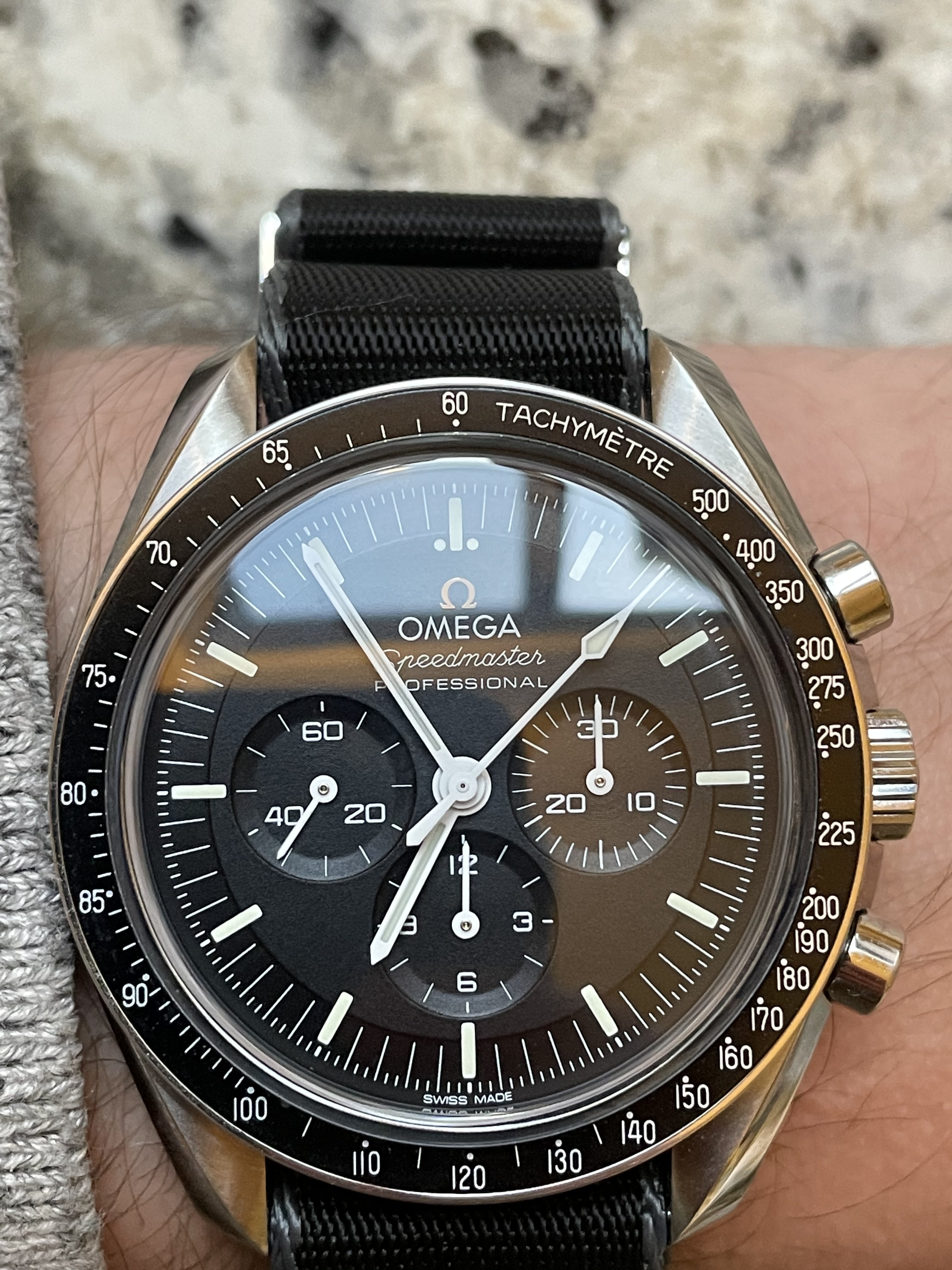

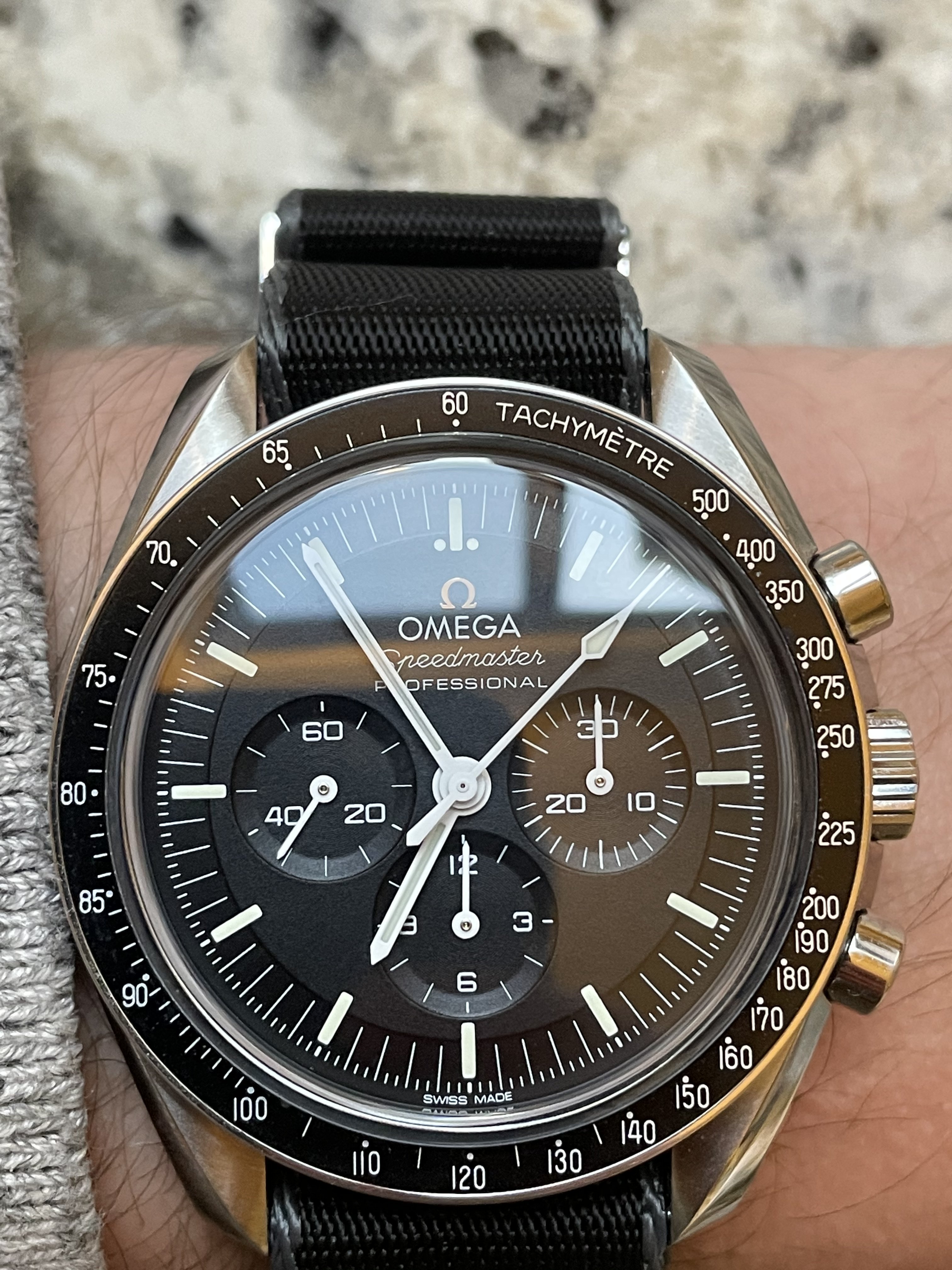

Same issue here! Bought the new sapphire sandwich a few weeks ago and immediately noticed that the hour counter hand was off. Incredibly frustrating to have that on a watch of this caliber/price. Just tried the suggestion from @jjjones but no luck 🙁

Excatly the same thing as mine too. This price level watch it must be spot on. I decided to bring my watch back to AD to warranty repair. AD saw the same without any arguing and put it on service. Very pitty indeed, because watch in generally is very cool.
