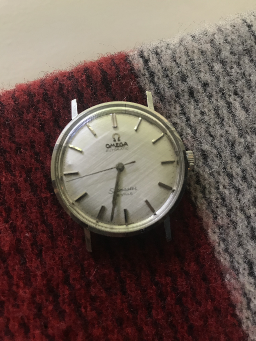

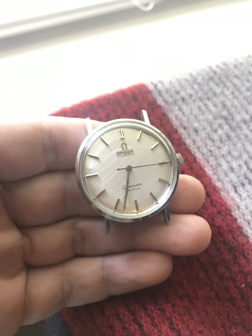

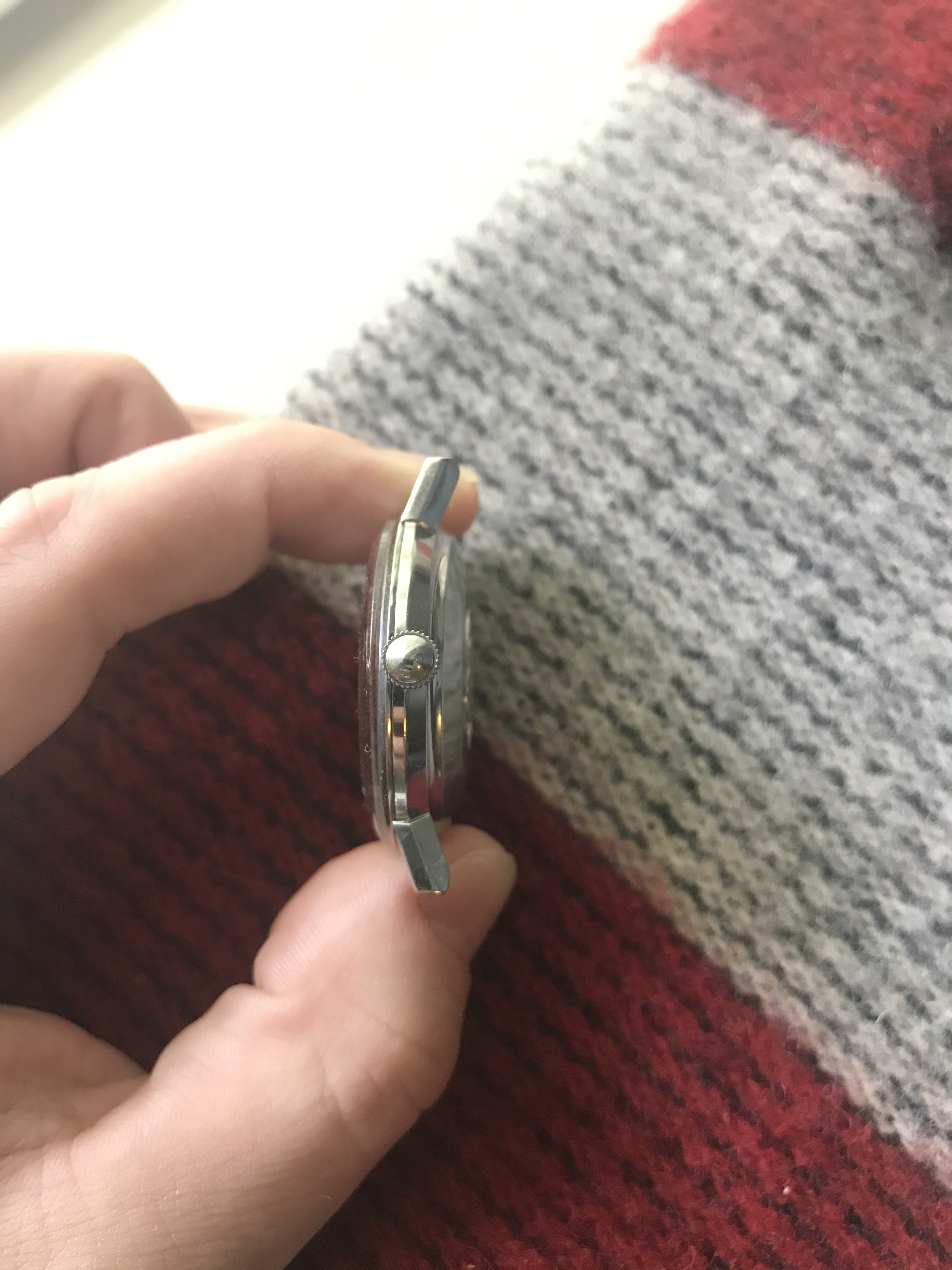

I recently bought a Silver Omega Seamaster Deville that runs great, but I didn't inspect the photos close enough and the dial is a little dinged up, so I want to make sure I am doing better due diligence on the pieces I buy. That said, the movement was recently serviced and as soon as I can get a new strap that fits I am really excited to wear it. Bought it for $400.00. The seller used valuemystuff.com to have it appraised at aroud ~$1000. The appraisal below along with some pictures from the seller:

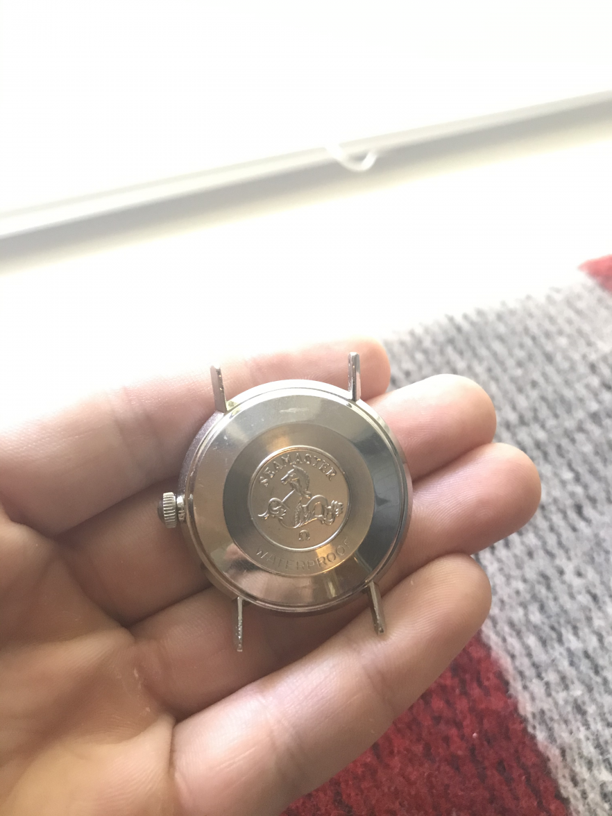

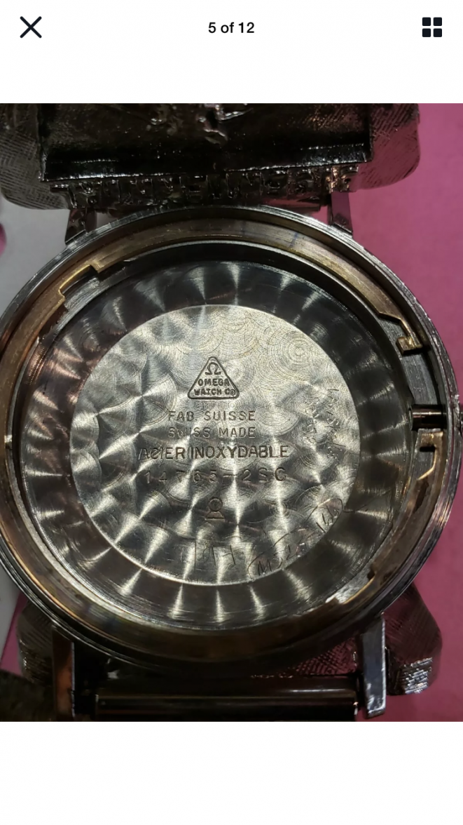

Case: 34/35 mm (you mention 1 inch which is 25 mm which is too small for this watch) diameter, two body, polished and brushed stainless steel, inclined bezel, straight lapidated lugs, case back with embossed Seamaster logo and the words, "Water Proof". The interior of the back cover has the logo of the Omega watch co., made in Switzerland, ref. 14765-2SC and Stainless steel in French.

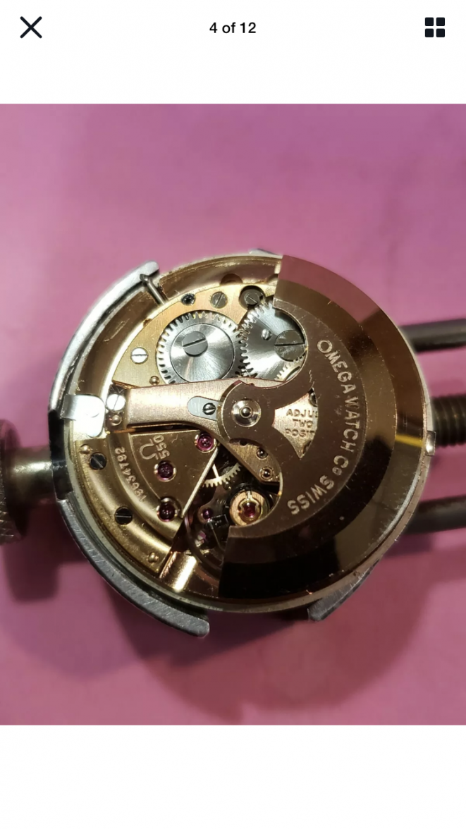

Movement: Omega Cal 550, coppercolored, automatic, sweep seconds, 17 jewel, straight line lever escapement, monometallic balance, shock absorber, selfcompensating fat balance spring, vibrating @19800 bph with a power reserve of 50 hours. This movement was made by Omega between 1958 and 1969 in a volume of just over 5.5 million movements. Dial, case and movement triple signed.

(Updated some photos, kept the ones of the movement and inside caseback because I think those are fine).

Welcome to the forum! I went to valuemystuff.com, and determined that the photos of the dial are worth less than $0.01 馃槈 Can you provide better pics?

Post some better photos of the dial. Almost all of your photos are focused on the t-shirt underneath instead of the watch. Use good natural lighting. Keep practicing until you can take good photos. Just delete the crappy ones, no need to post them. And crop out all of the excess, we only need to see the watch.

As already mentioned better pictures are needed.

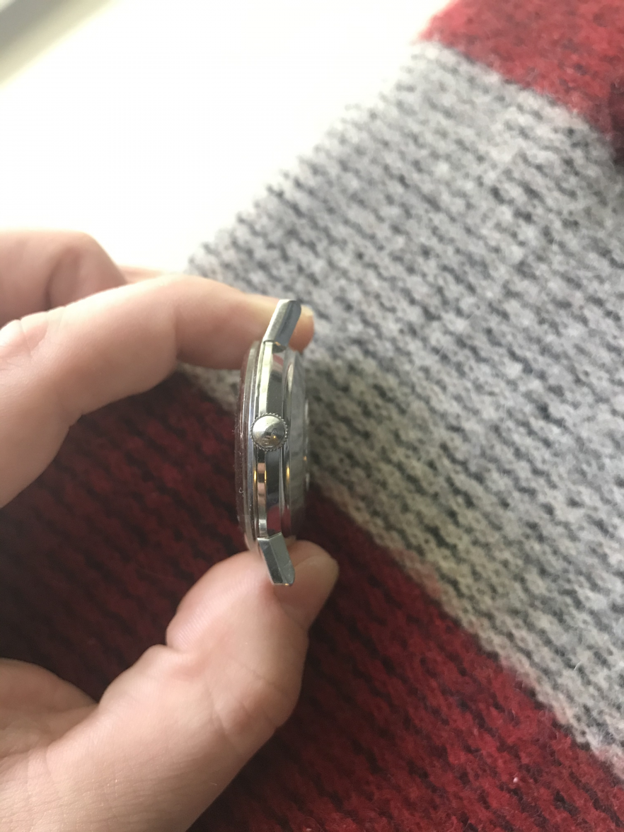

One thing is already clear: the crown is neither original nor a correct replacement part
