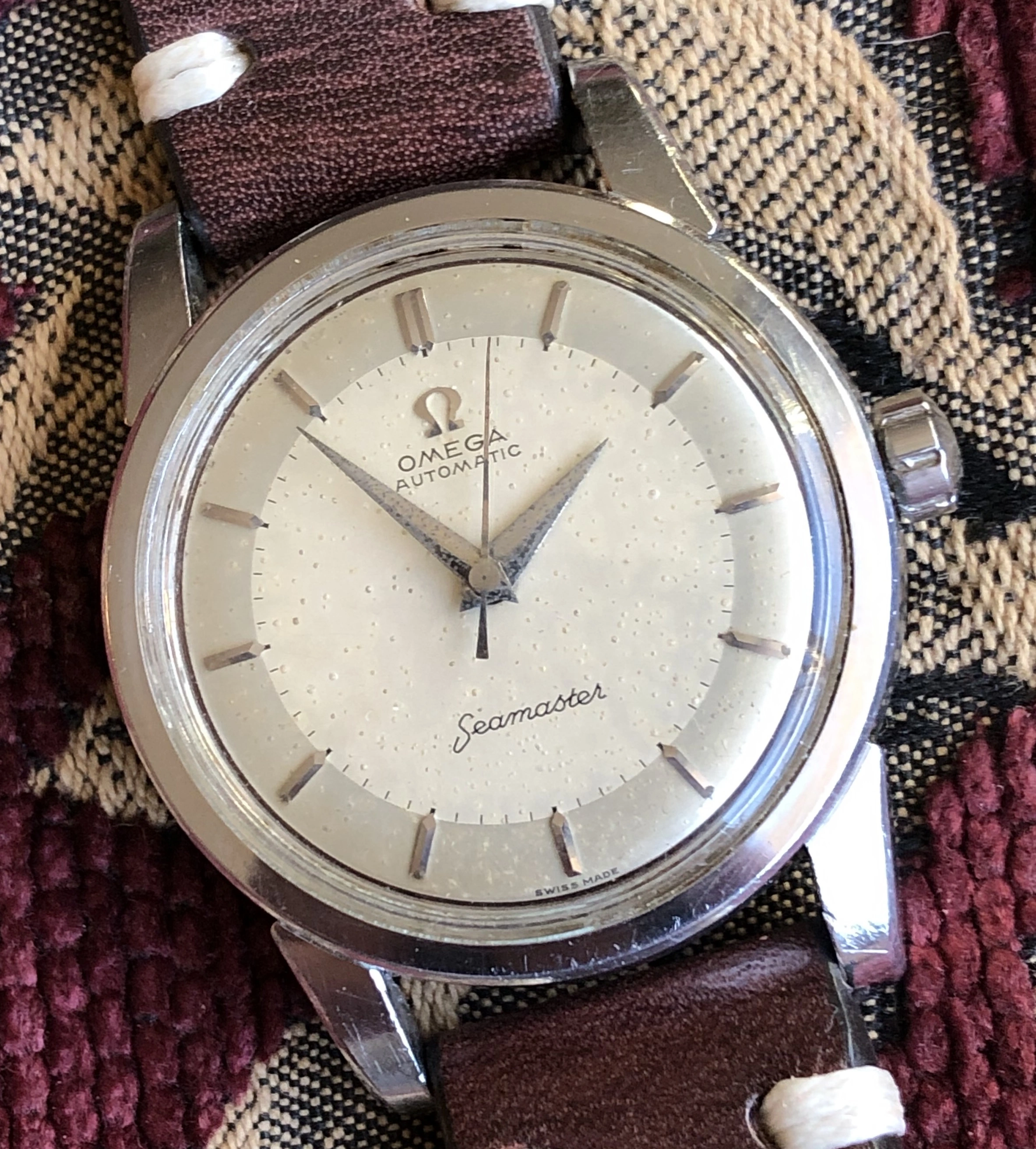

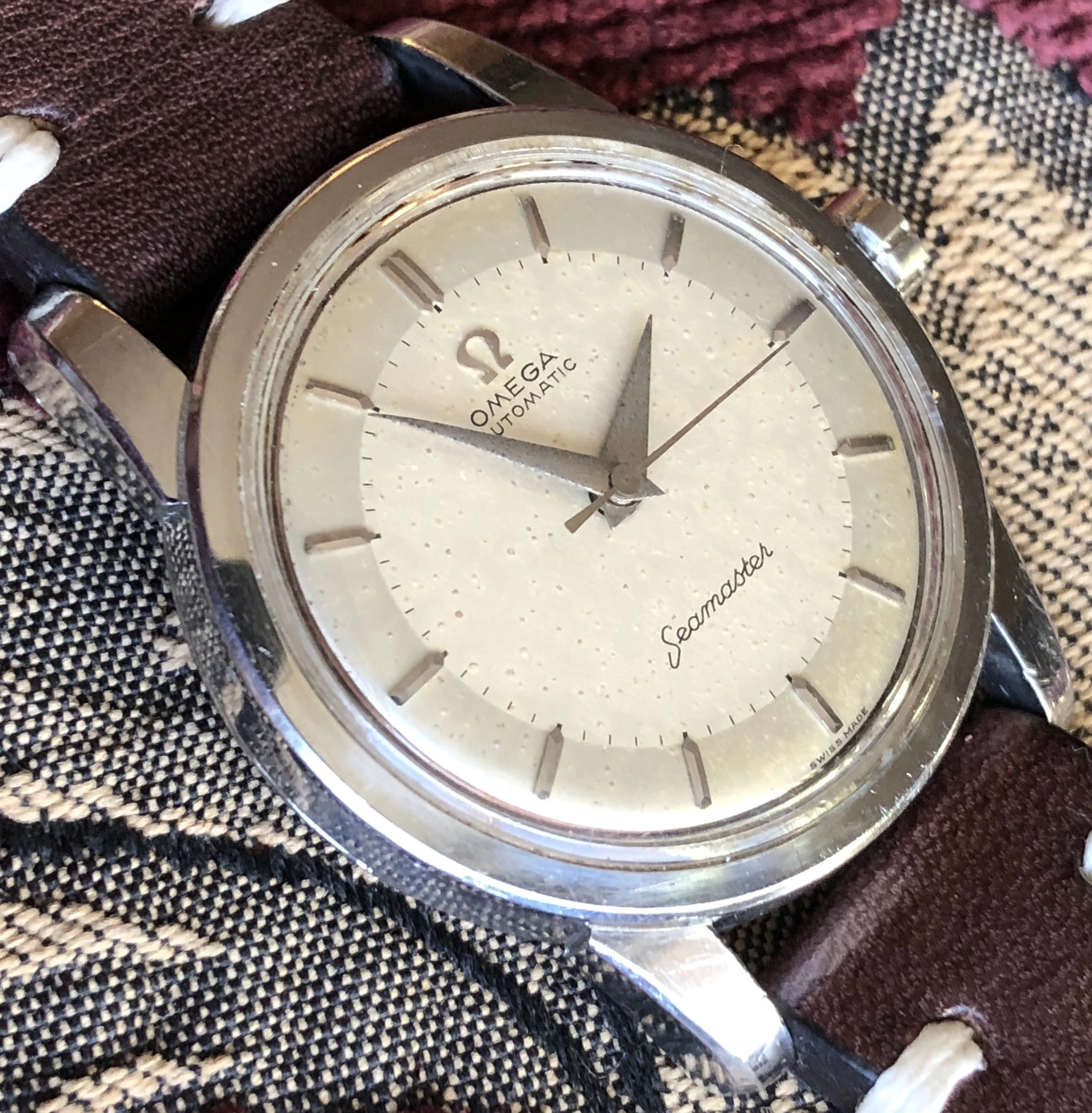

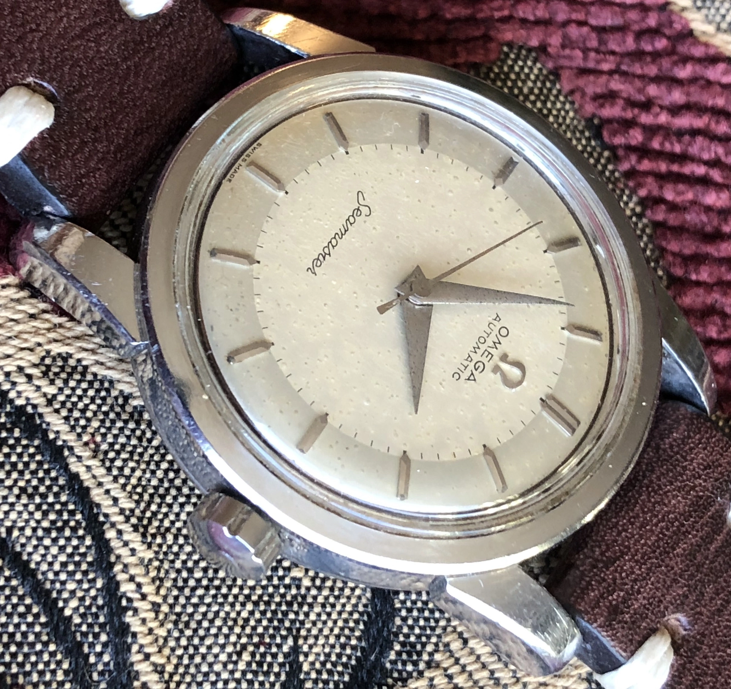

Hi, I wonder if you can help, o' hive mind! I've become slightly obsessed with vintage Omegas and need a steer.

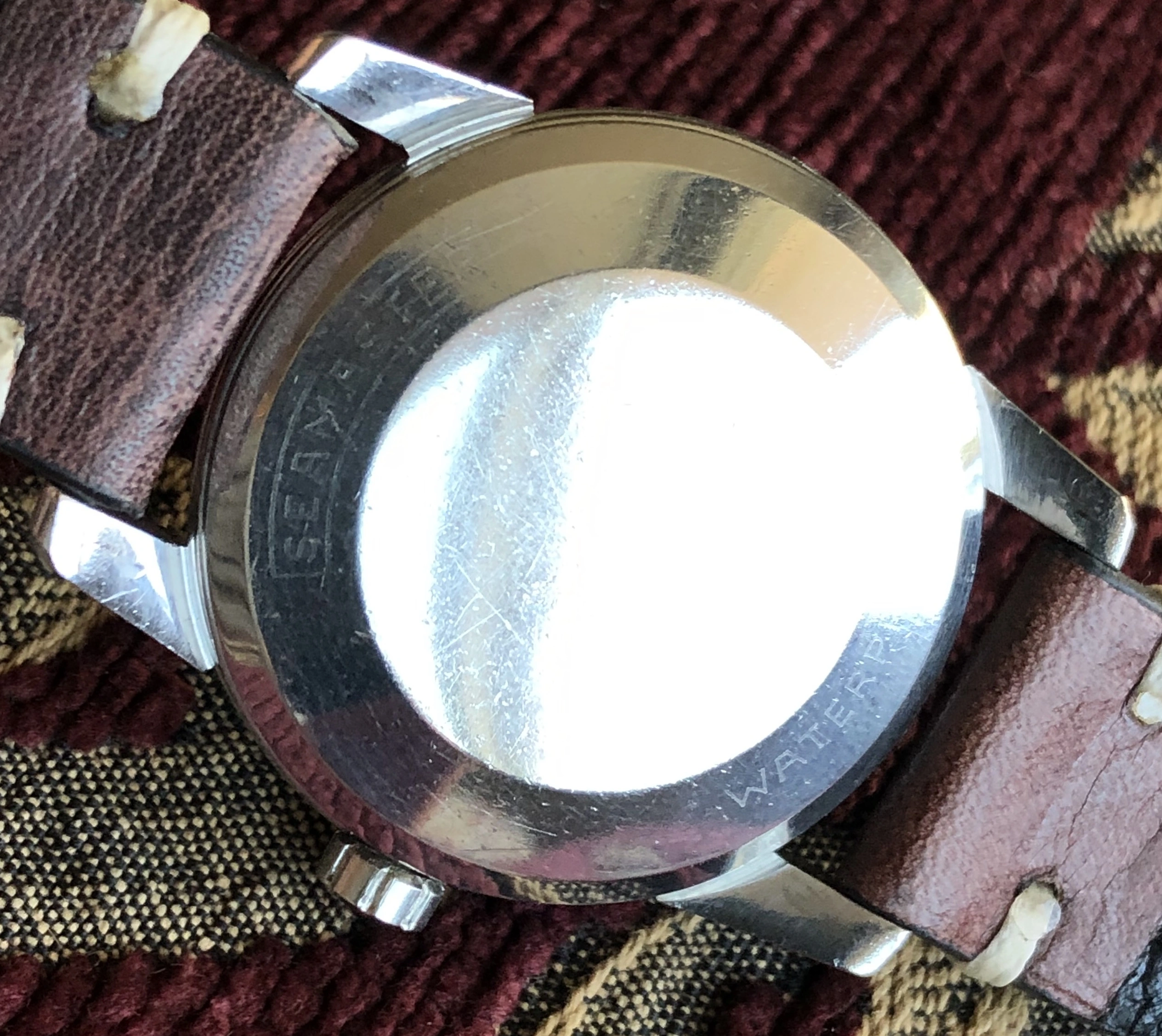

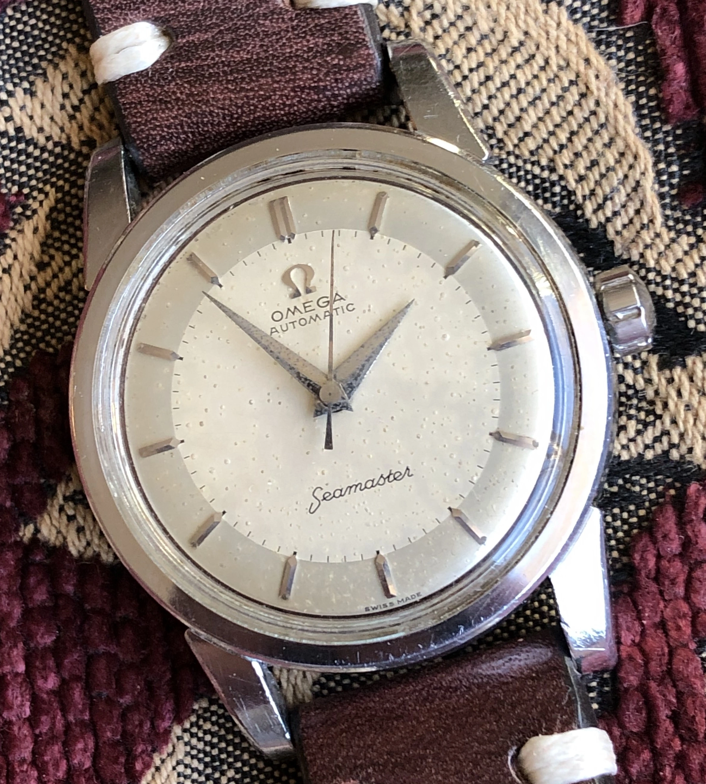

I'm looking at buying a Seamaster on eBay, but the photos of the movement and case are a bit blurred. The seller has excellent feedback (100% since 2017 with 2.4k sales), so I have no reason to doubt he is a genuine seller, and all my dealings with him have been very pleasant and professional.
It's a linen dial Seamaster De Ville advertised to be from the 60s. The patina on the lume looks fine to my untrained eye.

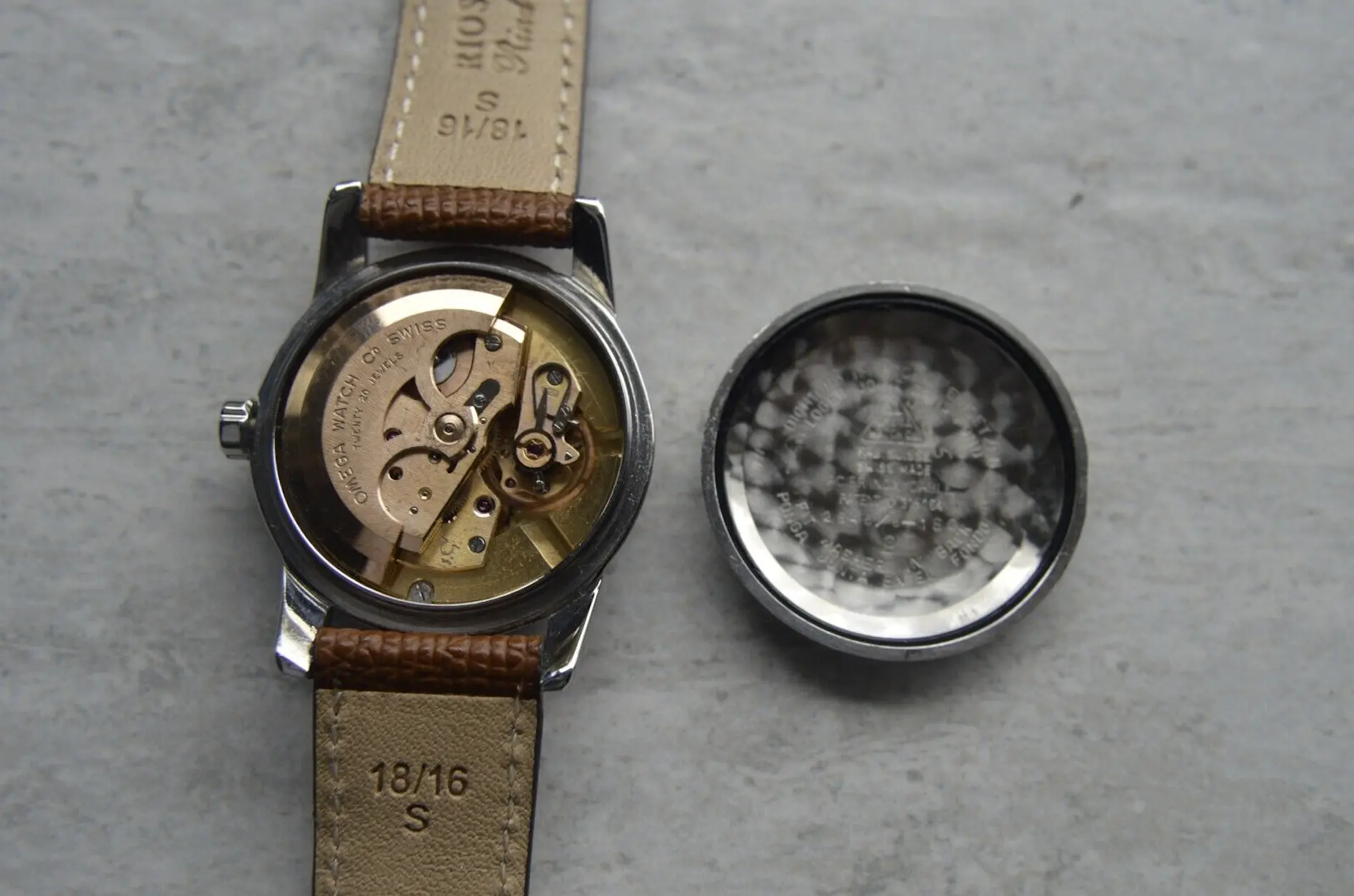

I've looked on the Omega vintage database, and I'm slightly nervous that the movement doesn't seem to be stamped with much - no number - just Omega Watch Co Swiss and 20 Twenty Jewels (see photos) unless it's underneath the auto mechanism (which, looking at other similar movements, it probably is) . The stamp on the inside of the back case looks like it says 2846/8-1SC? Again, a bit blurred.
Questions before I commit - I love the look of it:
  • thoughts on authenticity? What are your observations?
  • what's the model / date? I'm a bit stumped!
  • thoughts on condition / anything else that's a red flag?
Thanks so much for any insights and advice you can give,
Best wishes,
Mat.

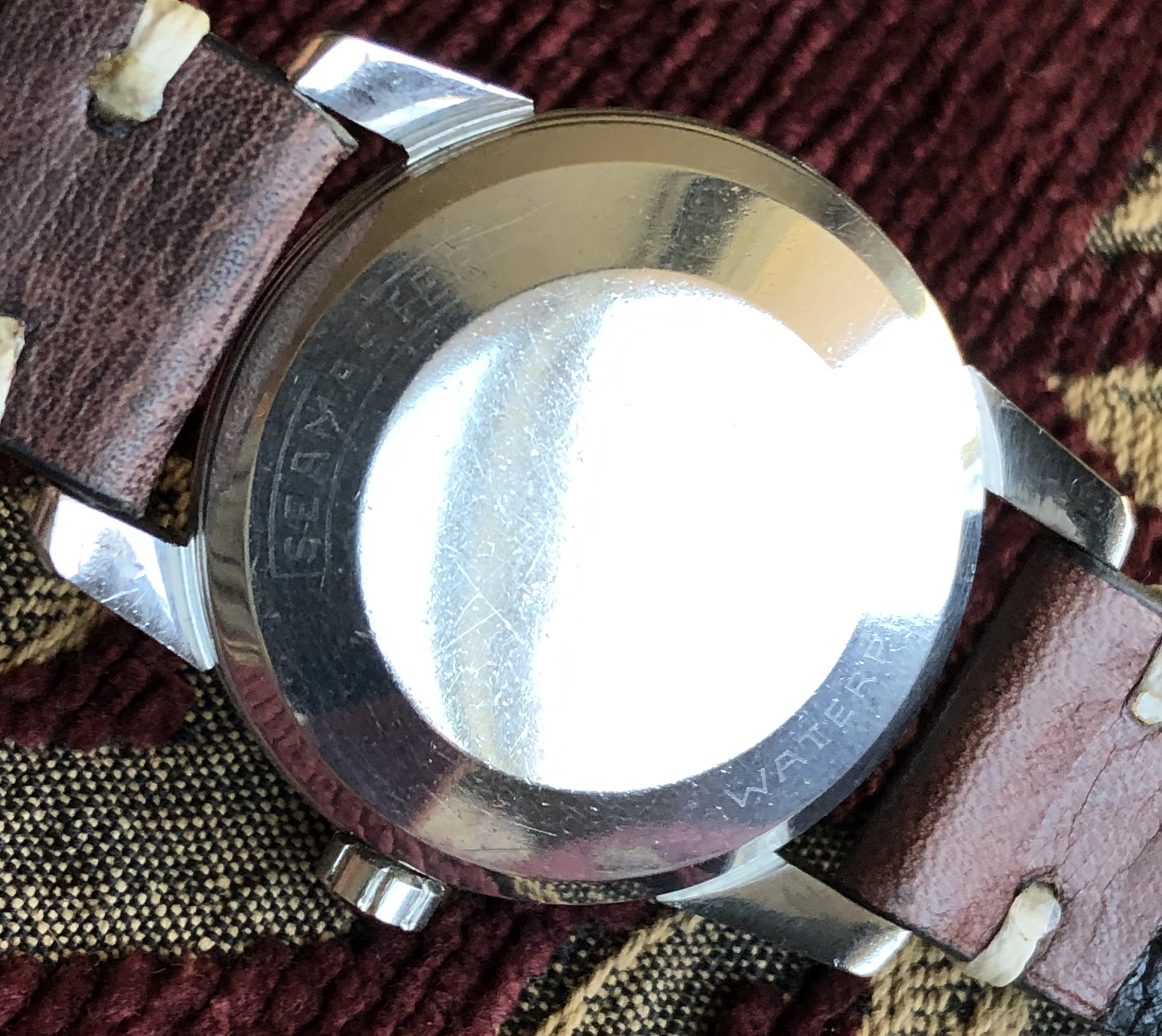

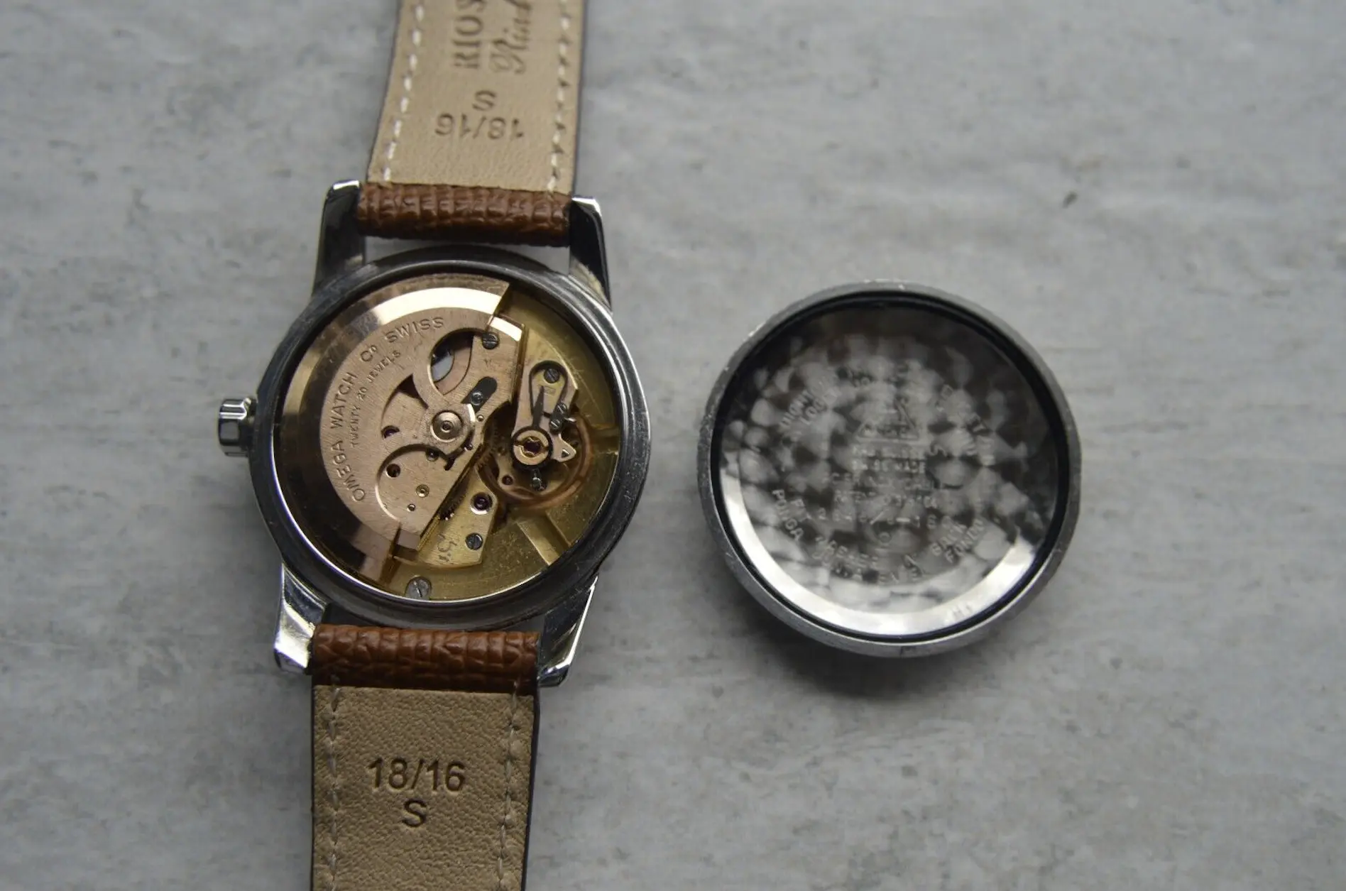

Not a DeVille but 2846 is a nice reference. Unfortunately, the condition of the case would be a no-go for me on that particular example. Also, just as an FYI, the movement appears to have a mix of gold and copper colored parts, which suggests a lot of replacement.

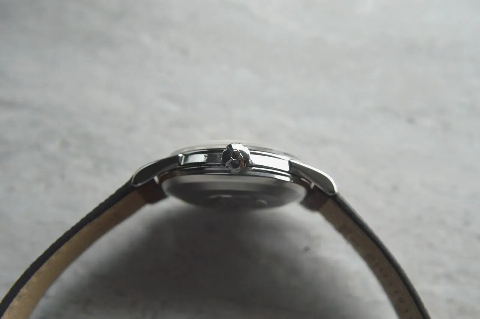

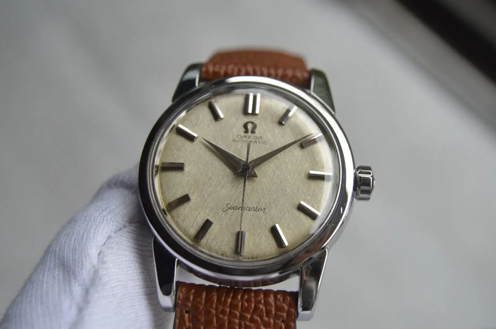

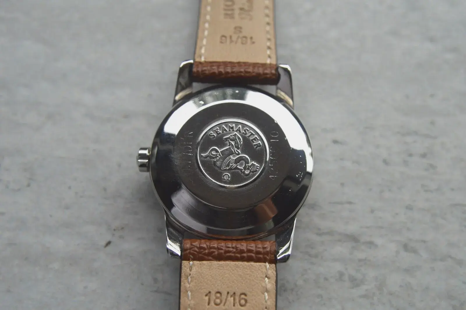

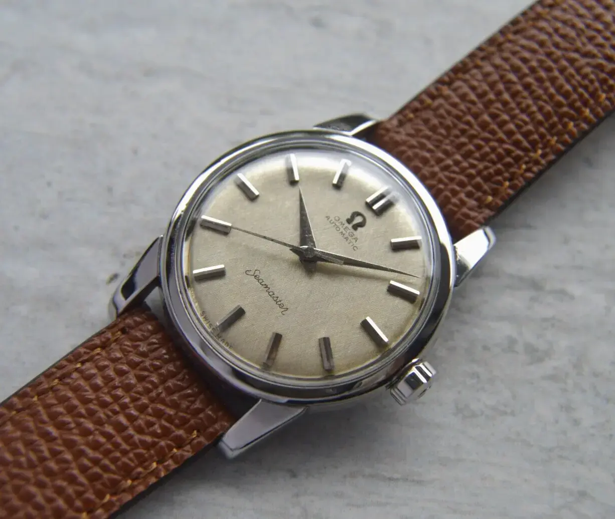

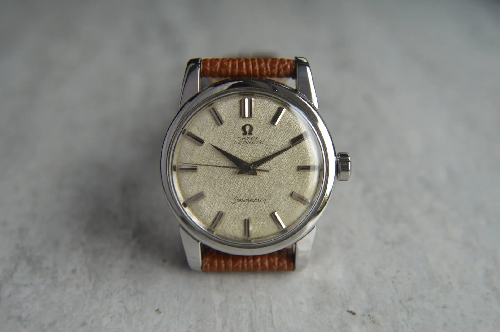

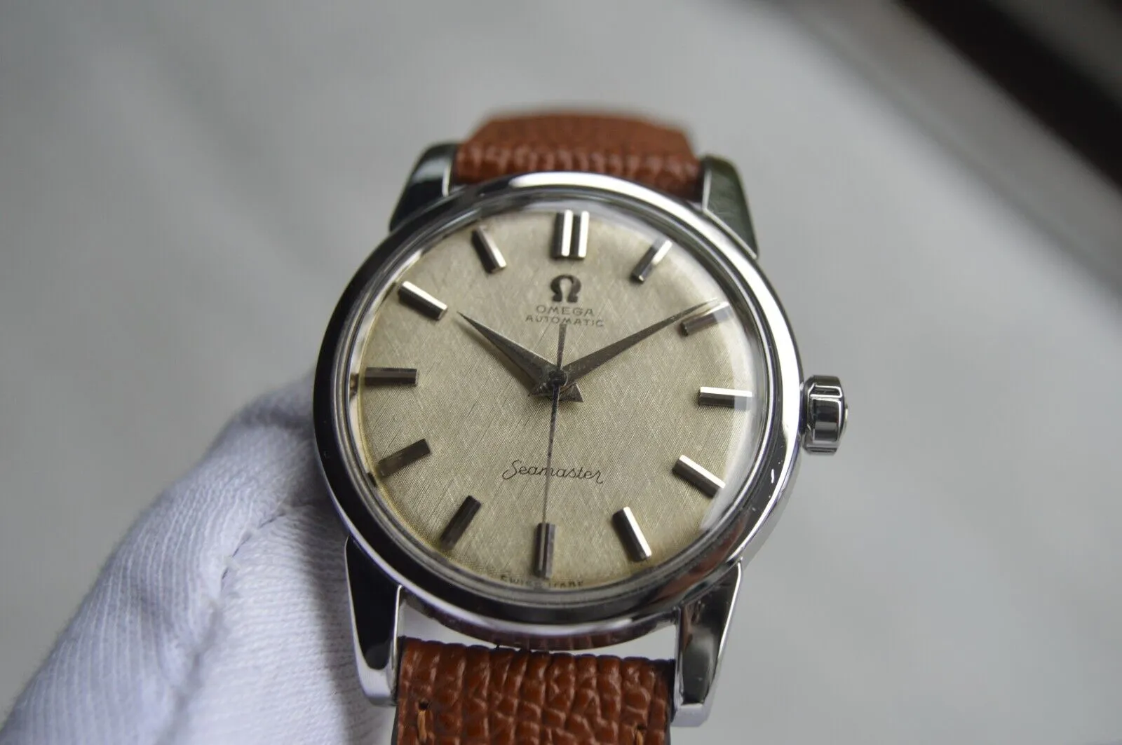

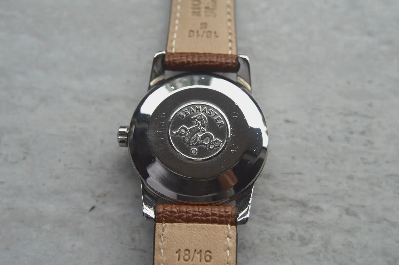

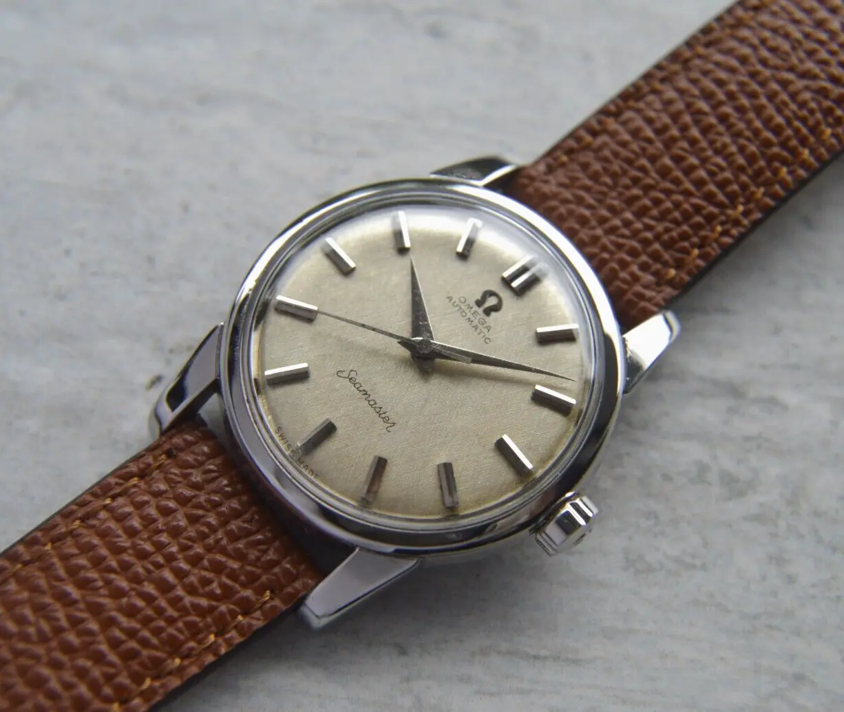

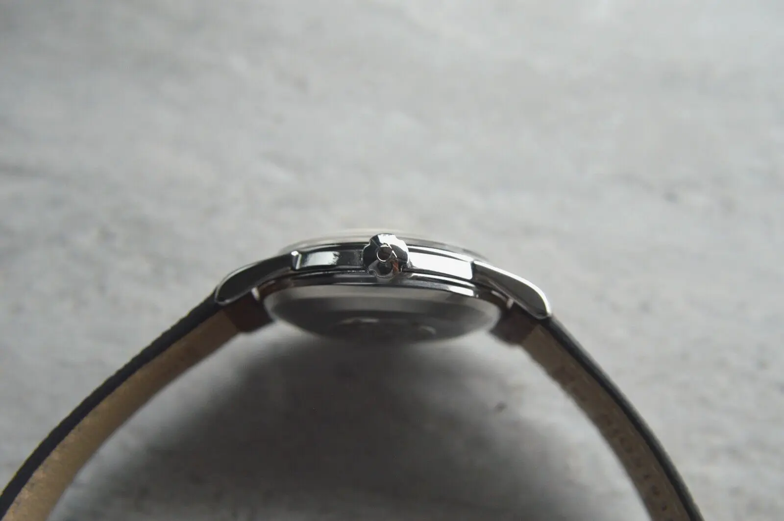

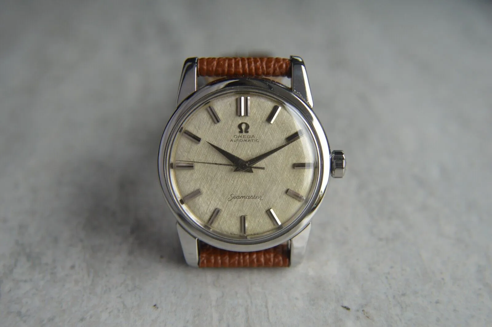

Ideally, you would see sharp chamfers on the bezel and lugs, and visible engraving on the case-back. Here is one I sold a while back.
Thank you so much for your insights. In terms of the case, do you mean the engraving / inscription? I wondered about that, but I'm not after a perfect example to be fair (more a wearable timepiece). Interesting about the movement and replacement parts... Do you have any idea of date for this one? Or is that something you can only tell from the serial number (which I can't see)? At first sight, would it appear 'legitimate' to you (based on what you can see!). Thanks again.

I would pass on the watch as it's overpolished and overpriced, and the seller. Nowhere in the listing he mentions the engraving that someone tried to remove by overpolishing it. He's not showing that photo in the listing either.

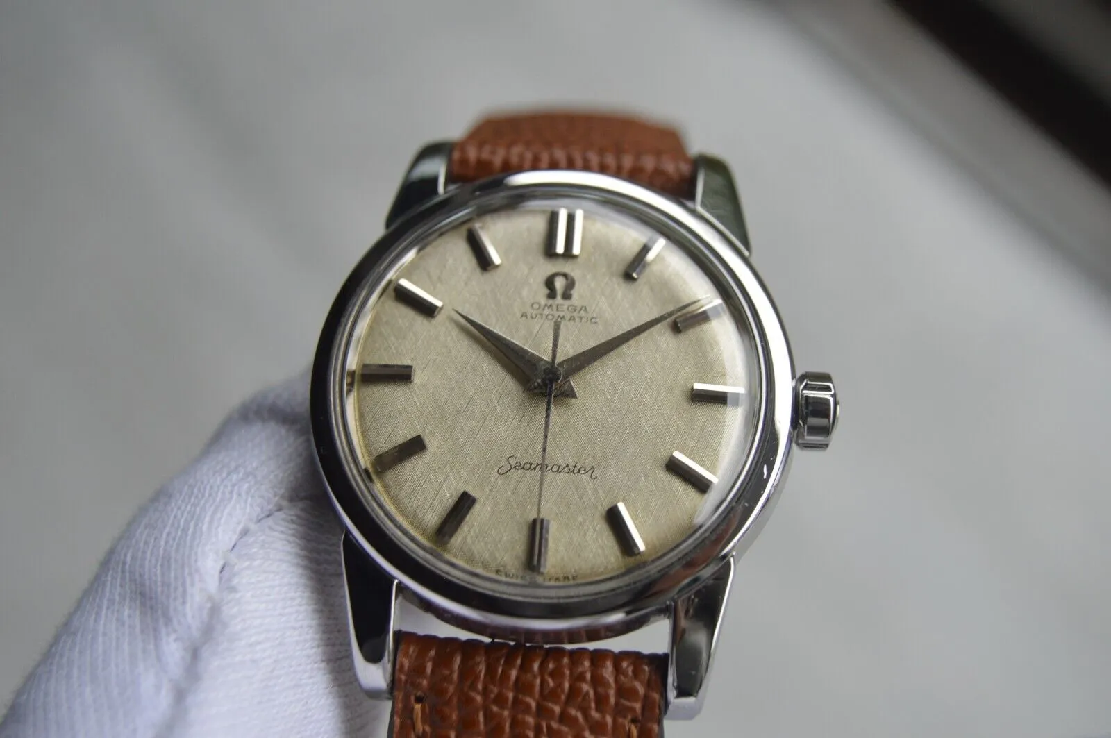

I added some photos of a 2846 I sold in the past. If you compare the photos, you will see dramatic differences. You can, of course, choose to ignore the polishing, but there is no doubt that the OP watch is badly over-polished, IMO. There is no reason to compromise on the case, which is such an important part of condition.
The serial number is probably hidden underneath the rotor, so you don't have that information.
I just got an answer from the seller (and a video he helpfully just took of the movement): "I’ve got an answer for you! Here is a video of the movement for you. If you compare it to other photos of the 501 movement (not 503 which I made the mistake of earlier!) you can see this one is spot on. Where the serial number usually is (I’ve pointed at it in the video with a screwdriver) has R 17937 printed instead. After some research, a replacement plate by Omega will have a reference number but no serial number, as the serial number is for the watch not the part. This means this part will have been replaced with another Omega part as expected for a watch of this age and so the reference number of the part is visible but the serial number is not as the part is new. I hope that makes sense but the long story short is it’s a genuine Omega part that has been replaced in a service."

The replacement bridge in the movement (therefore, no serial number) reduces the collectible value, on top of the over-polishing, the poorly removed custom engraving, etc. I would put the value of this watch below $500 USD. For the asking price, you could get a really nice Seamaster with BoR bracelet.

I don't know the current market on these, so eBay sold listings would be a better gauge for the price. Without looking anything up, my ballpark estimate would be $500 - $600 depending on condition + $150 premium for a linen dial = $650 - $750. This is not for this watch, but for an identical watch in better condition.
Ouch. Thank you so much for the heads up too - good to know. Even in my profound ignorance of vintage Omegas, the lack of a serial number must be a big no-no. Sigh.

I am sensing that you don't realize how much the poor condition of the case affects the value.
