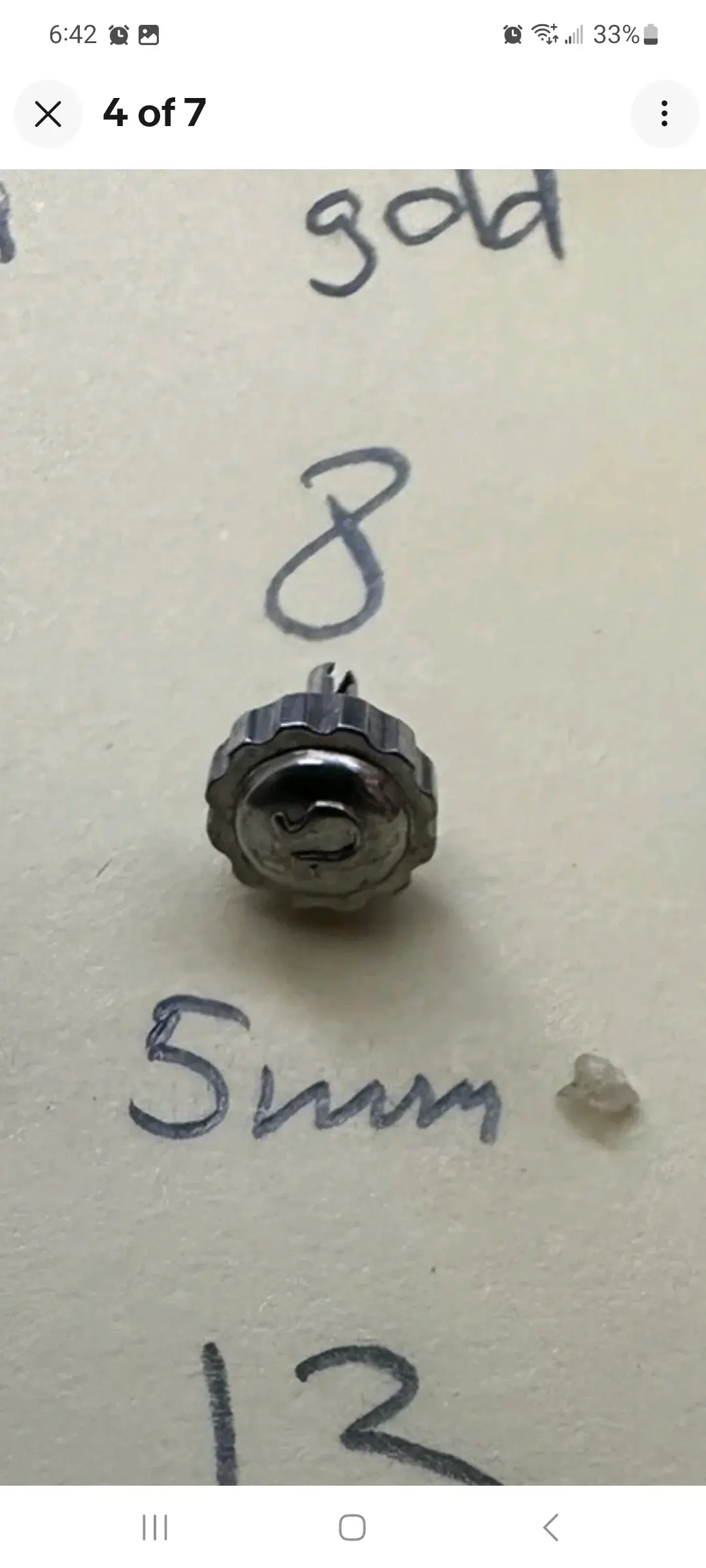

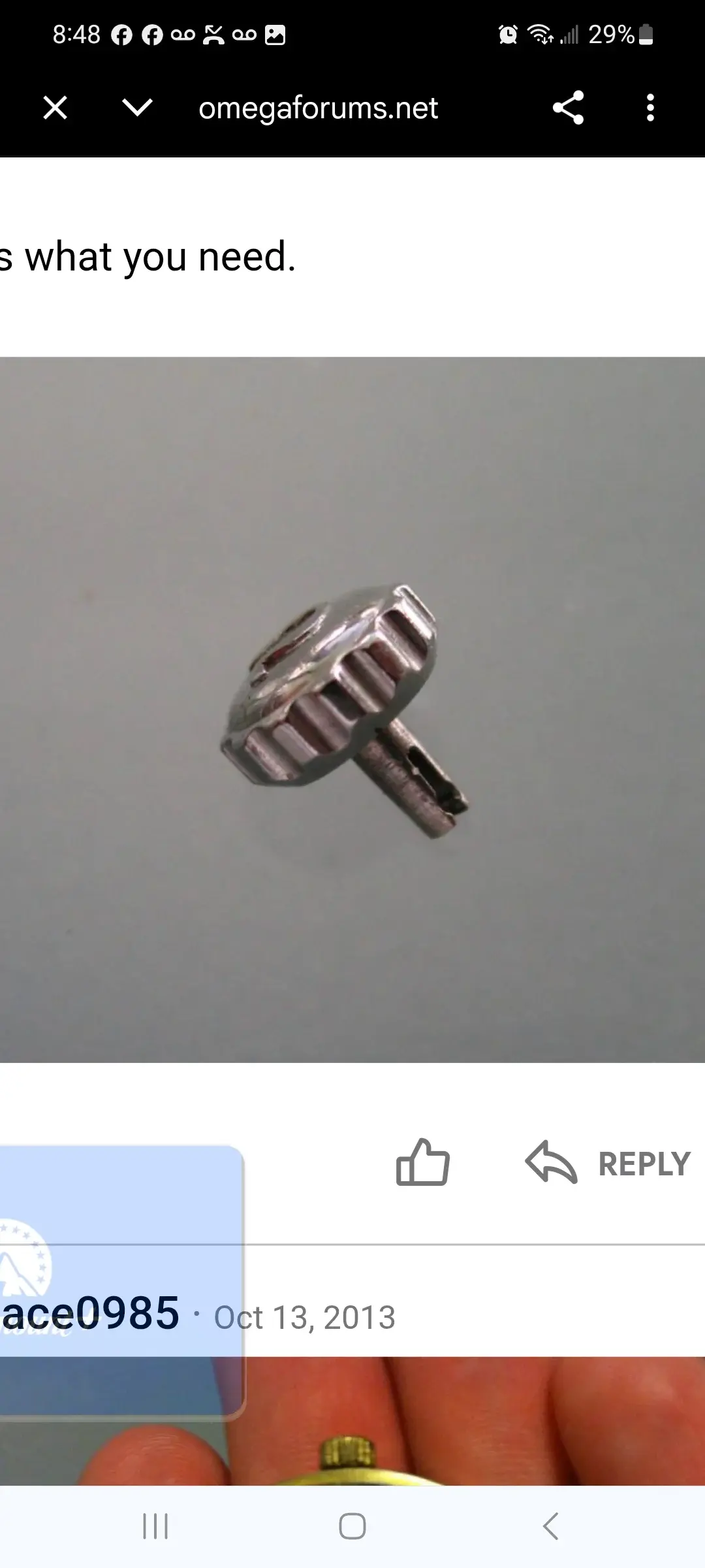

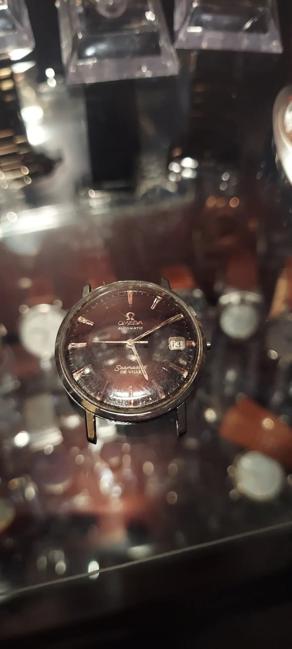

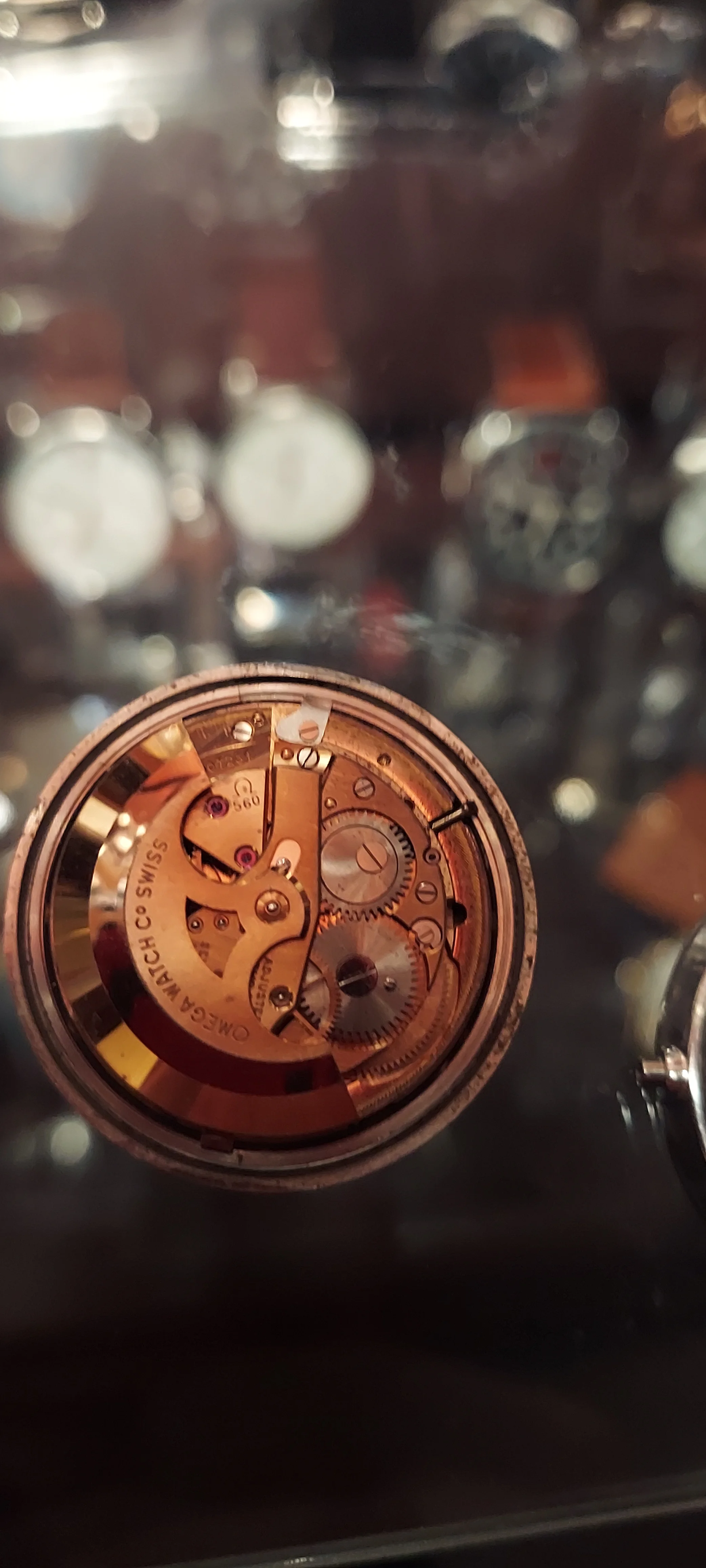

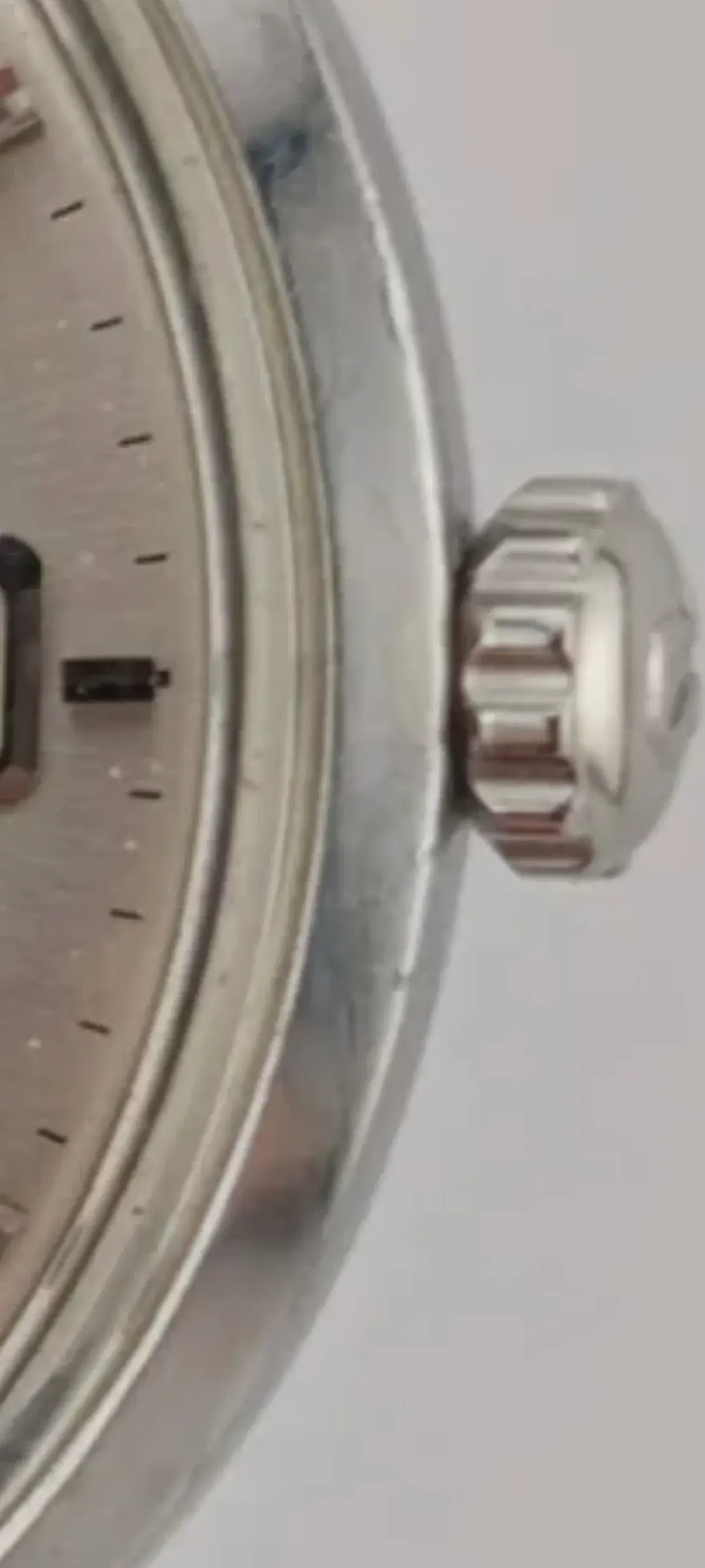

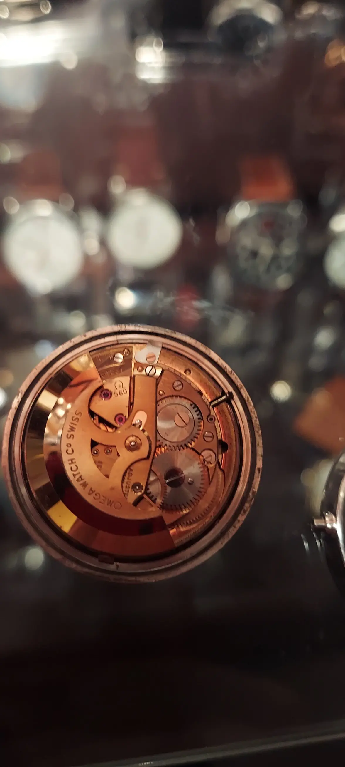

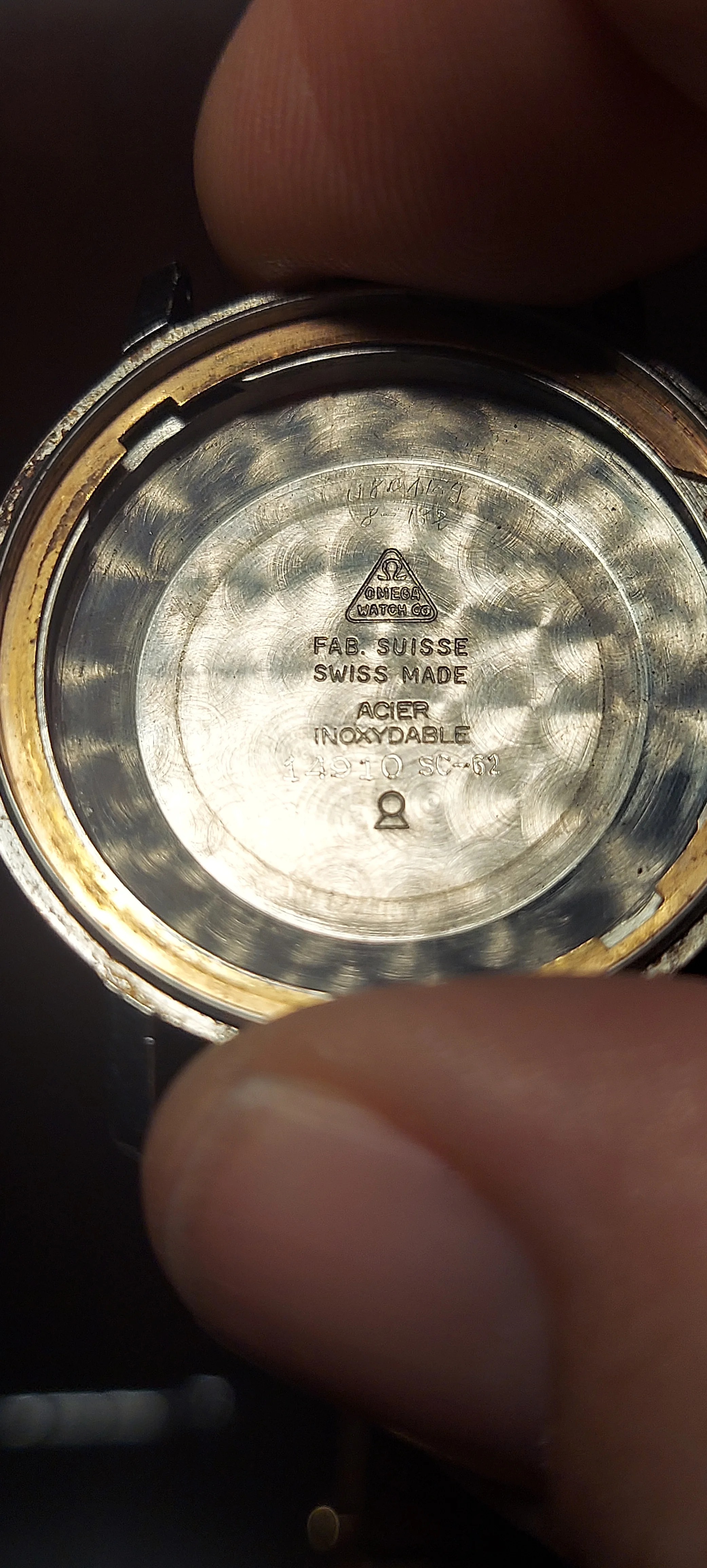

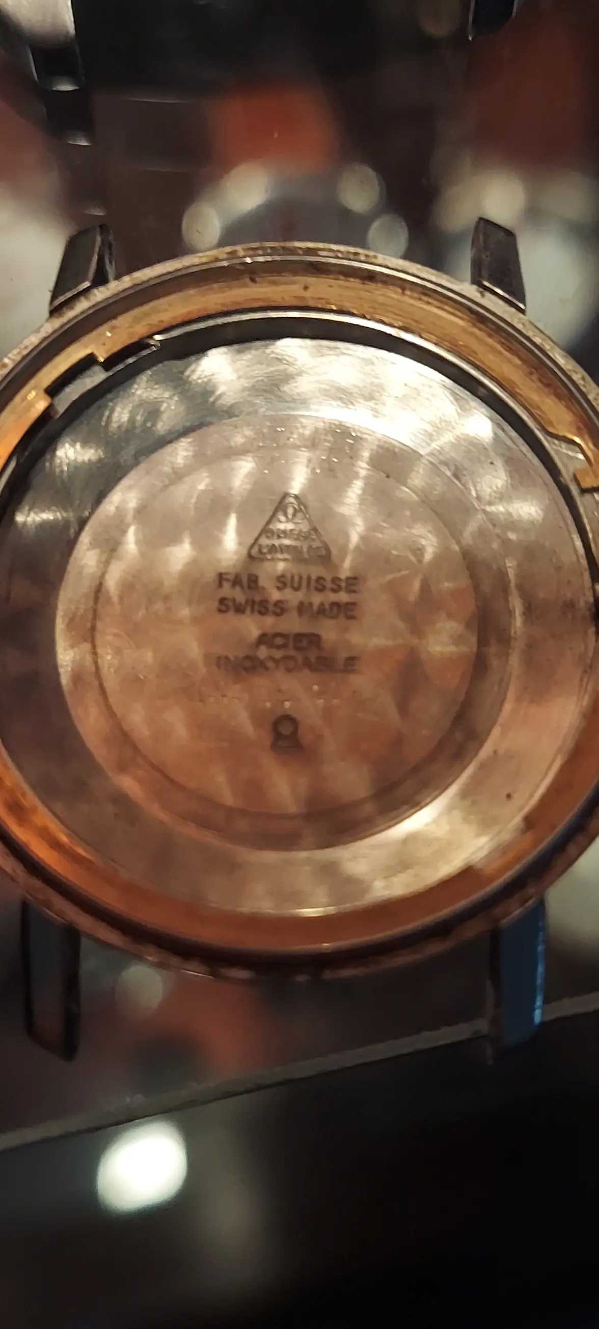

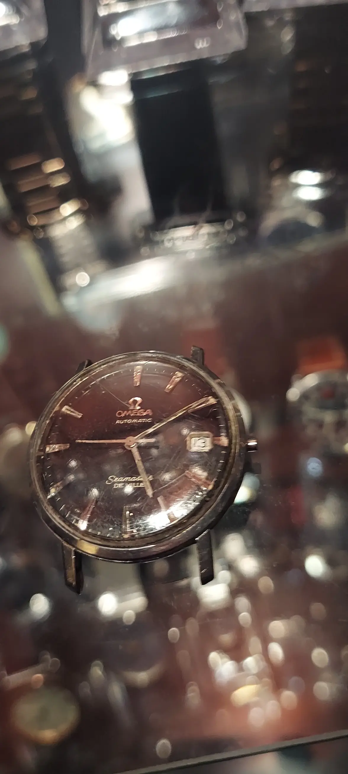

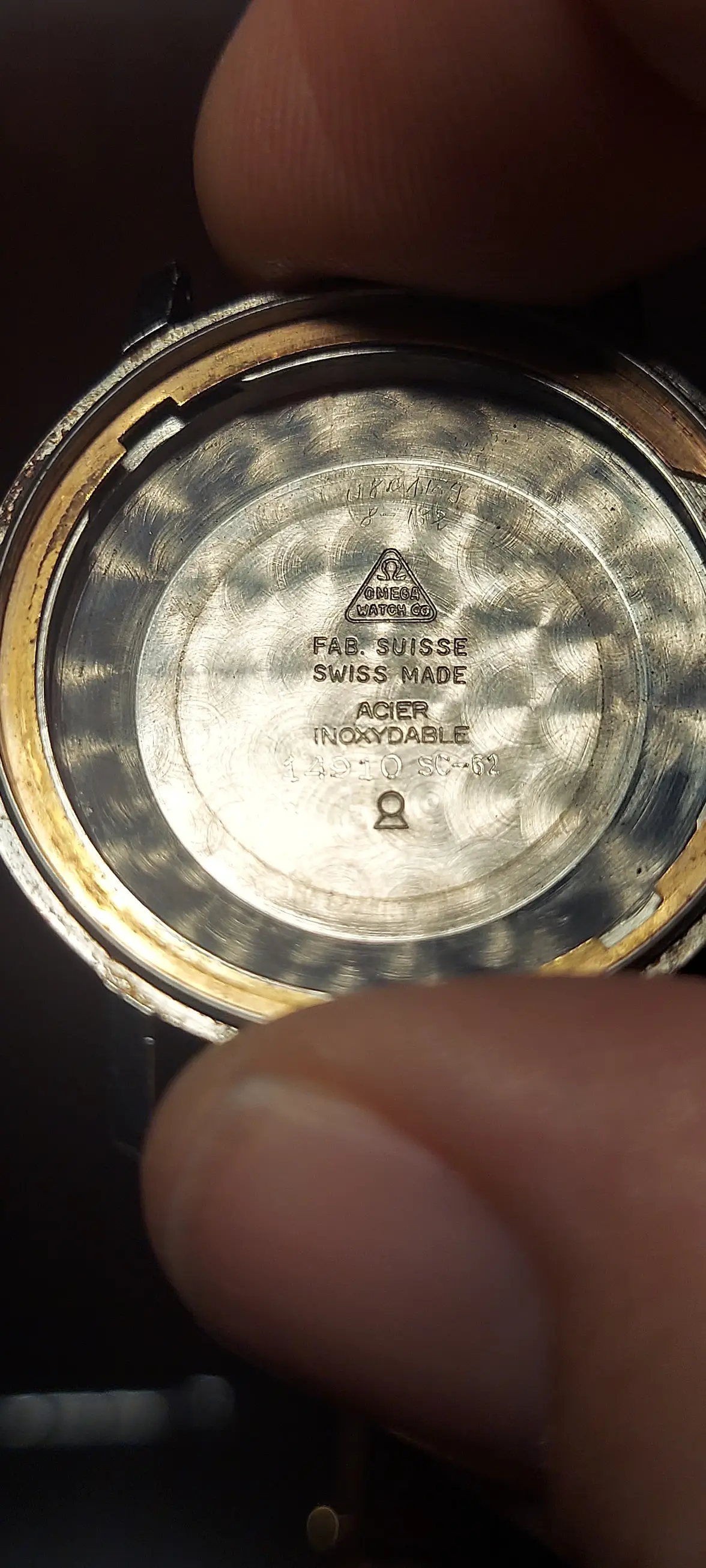

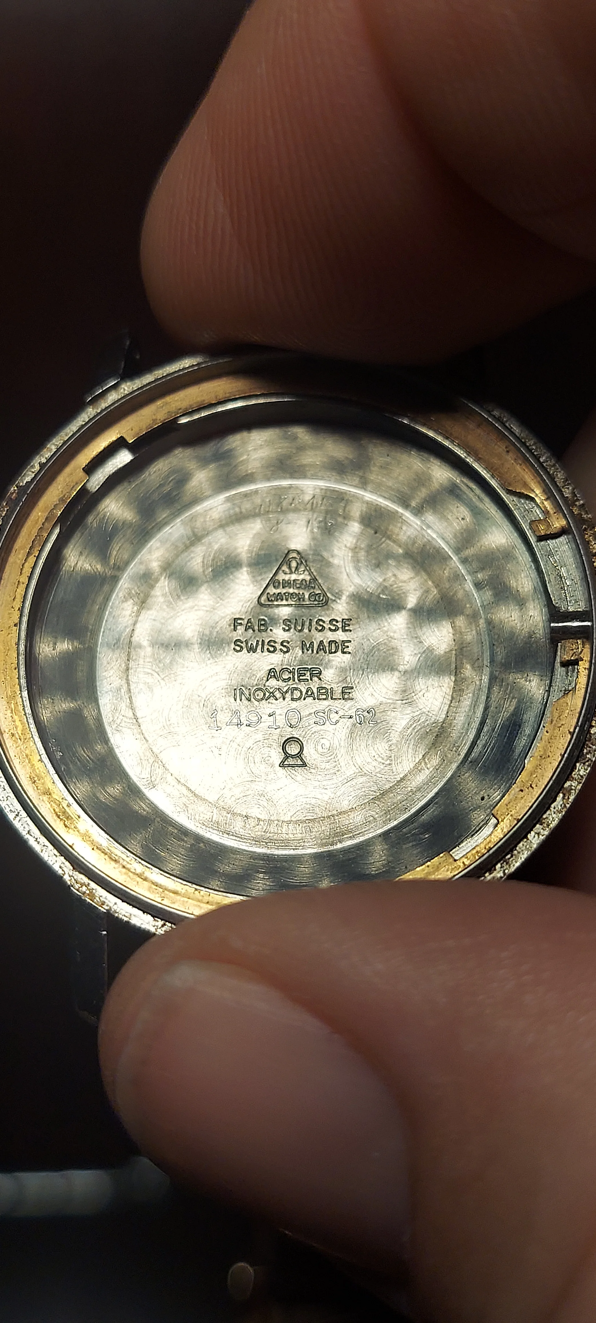

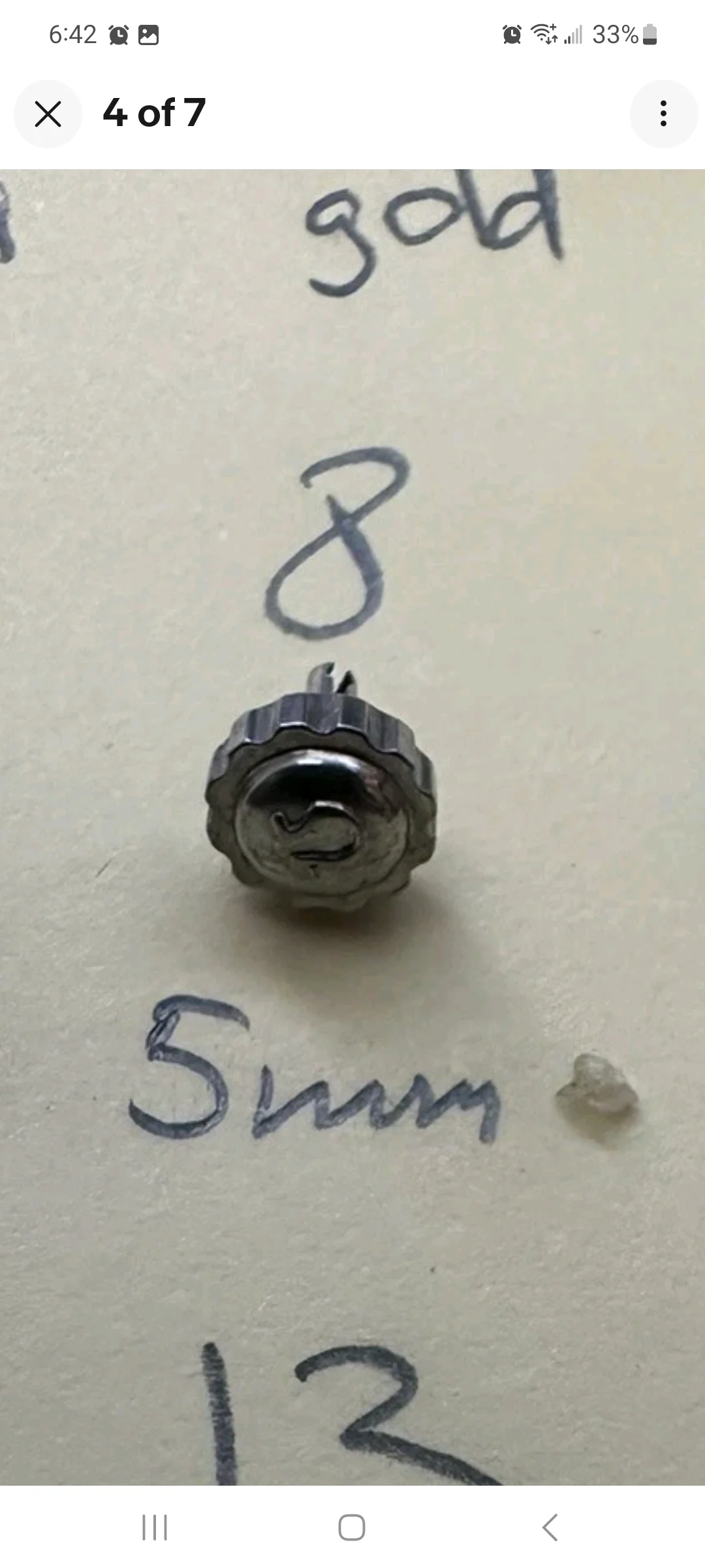

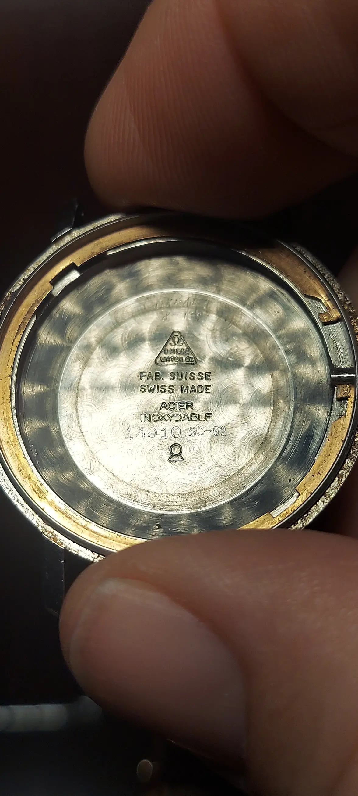

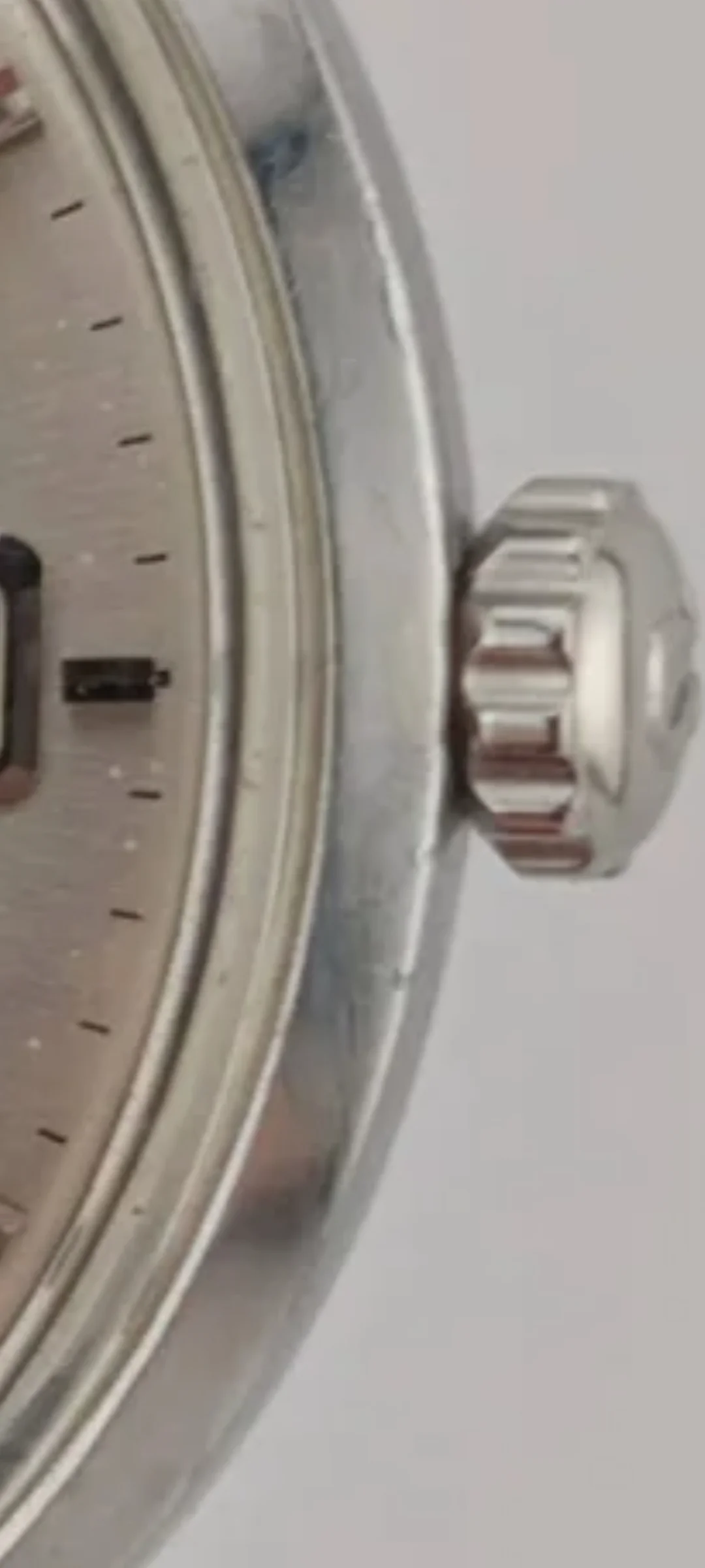

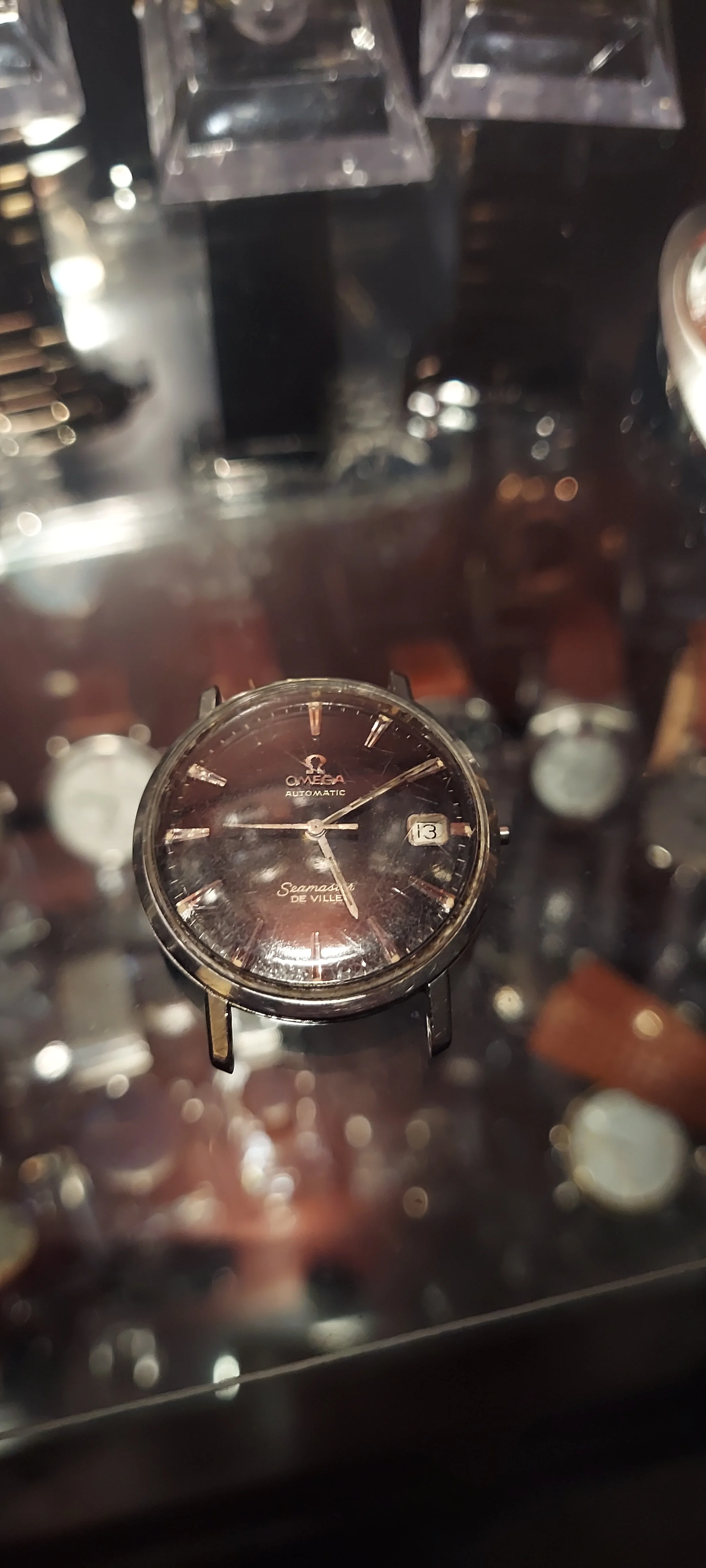

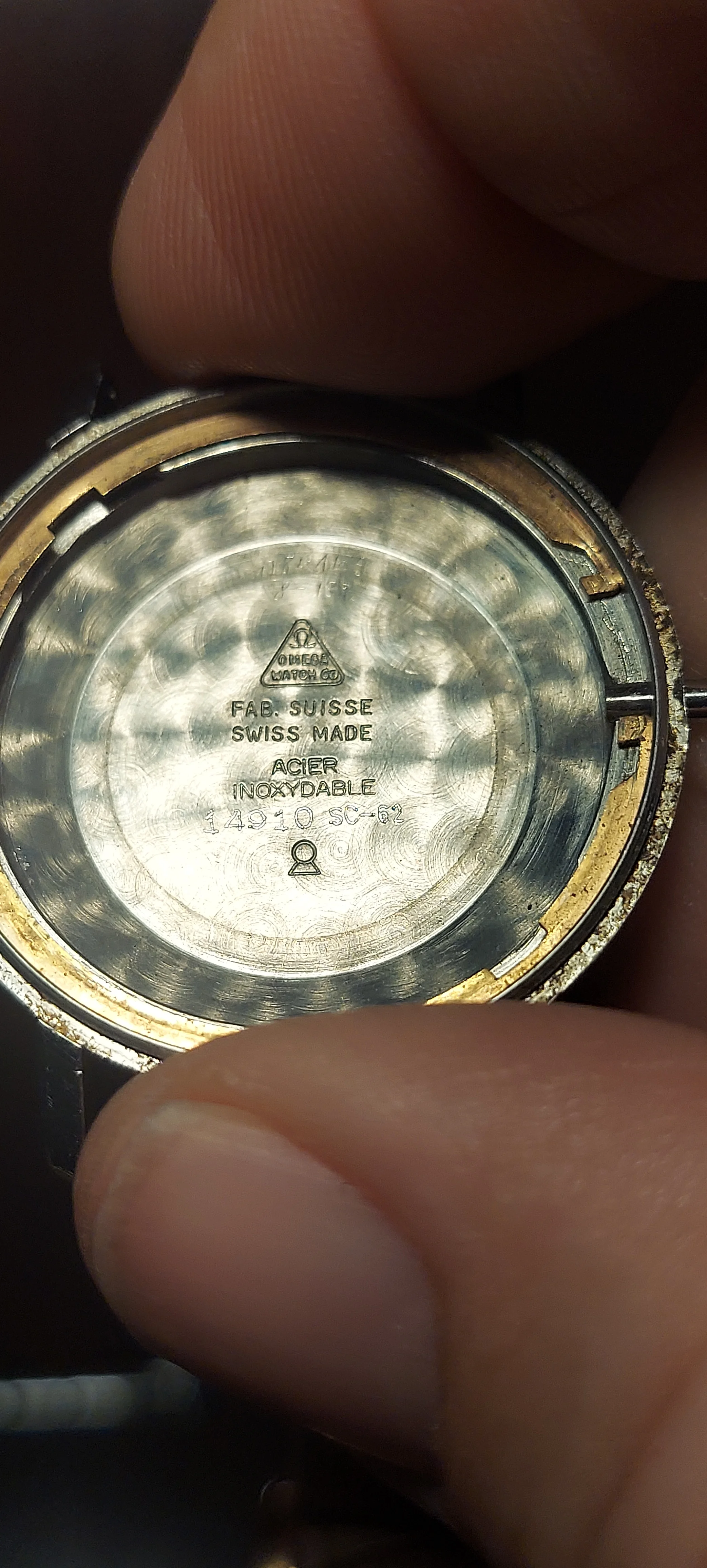

Hello, I have an Omega Seamaster Deville fronload with 560 cal movement. I am trying to source a second hand, or hand set and female split stem crown. I have attached photos of the crown that I think goes with this model. I can't find either of these items with deep searches. Wondering if someone could help me source? I have the missing marker on the dial. Thanks much!
30,205
77,993
The current crown Omega calls for this is 069ST42531. The crown does not care what kind of stem is used - it is the same crown for a regular full length stem or a split stem.
The female split stem is another part - 081ST9992.
The seconds hand is part number 066UZ1377.

Thanks much. Extremely helpful!
