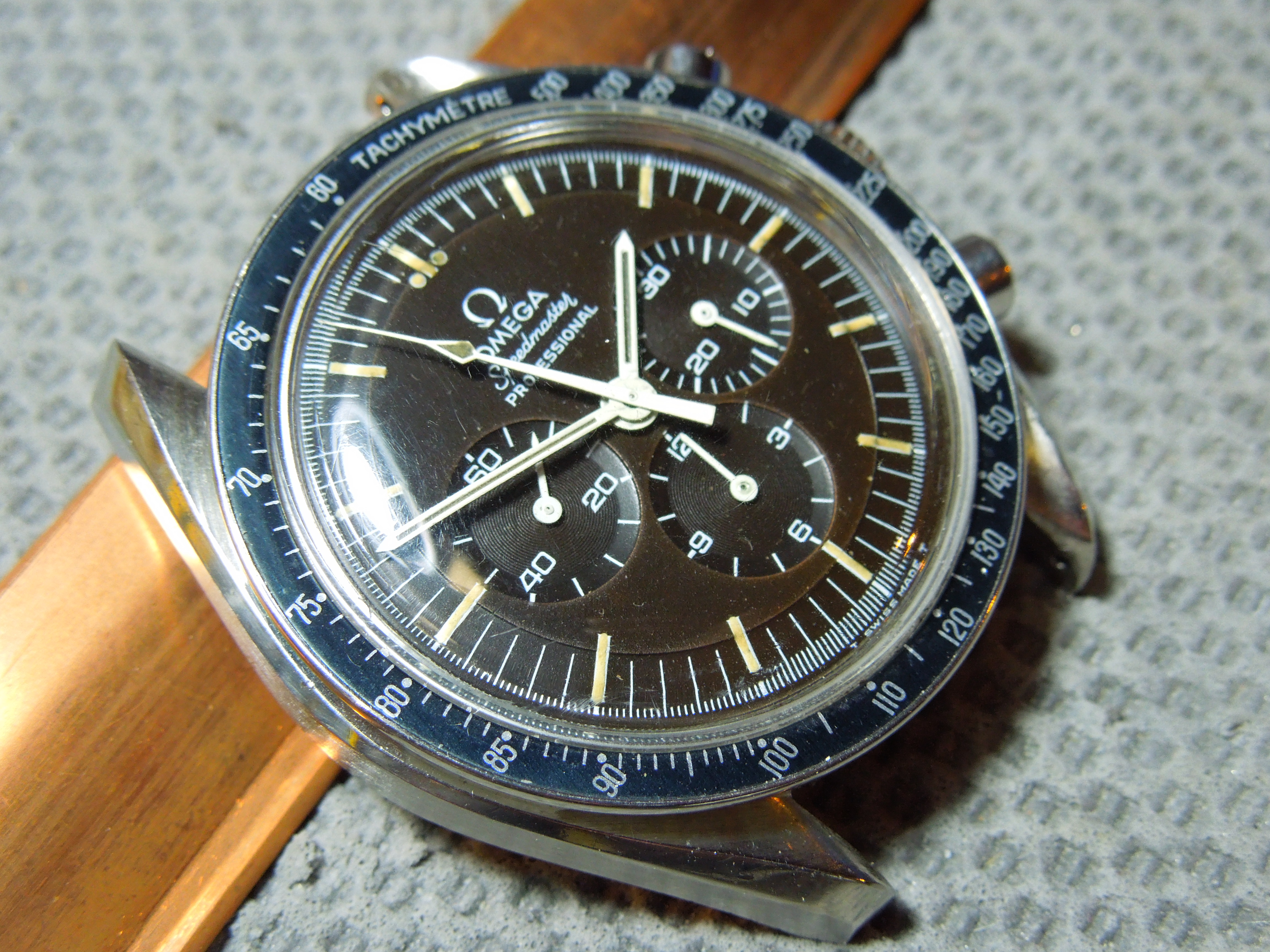

So it looks like the watch I'm looking at... could be legit?
By all appearances so far pending the serial number, this is a legit watch with a wrong but earlier and more valuable bezel.
5,861
16,791

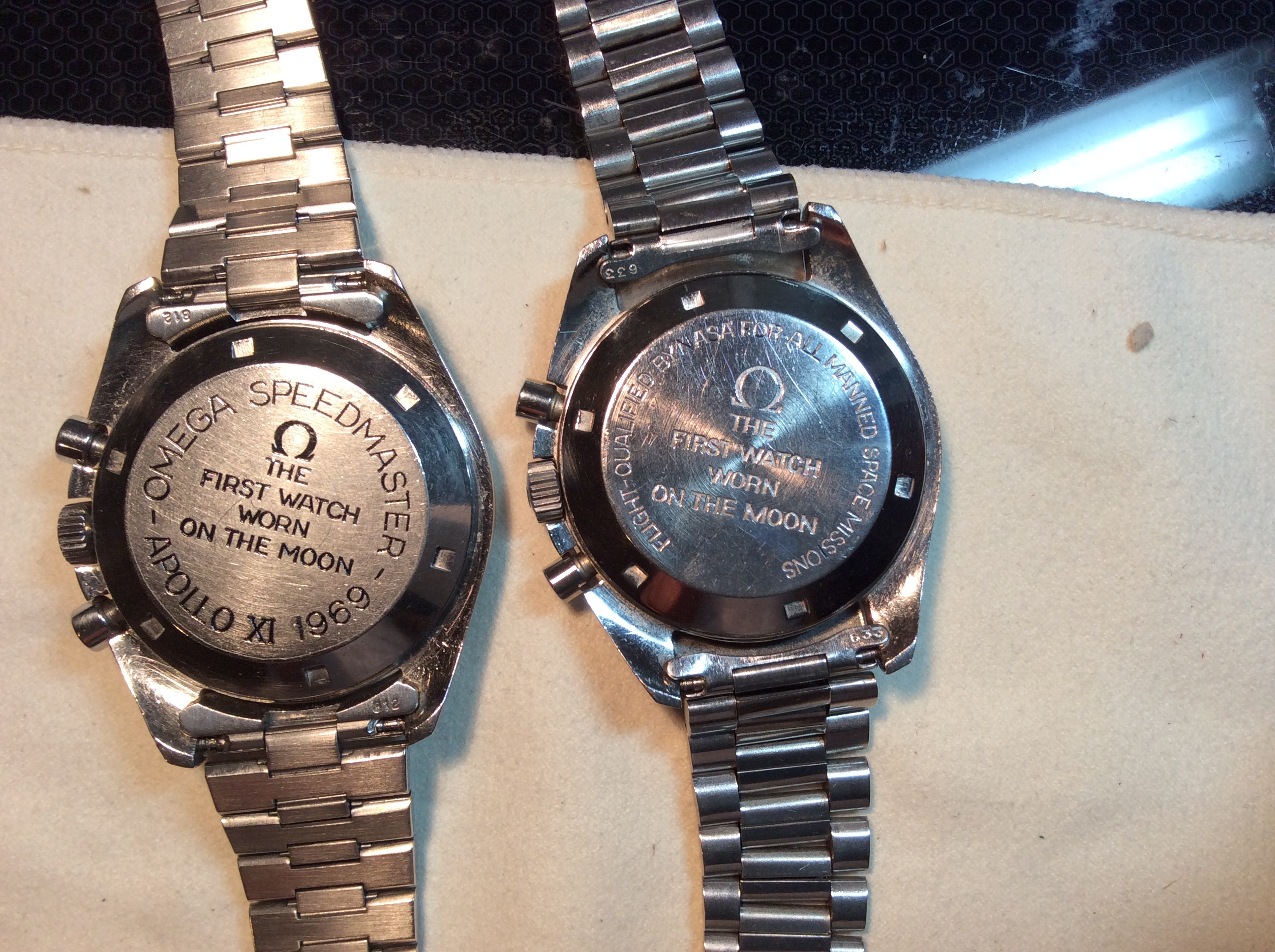

Other than the BA 18K model, these are the 2 different 145.022-69 straight writing casebacks. I don't believe any of these had a DON bezel or a 220 bezel either. These had DNN bezels.
12,124
40,343
speedy4ever's statement about the pointed A's is here: https://omegaforums.net/threads/spe...e-numbered-version-or-fake.31245/#post-352233.
Would be interesting what the serial number is.
In that statement he says that none of the straight-writing Apollo XI casebacks had pointed As and (diplomatically) that it's very unlikely to be genuine - I think this watch and the one from Japan may have come from the same, let's say, "modification shop"

296XXXXX is all I have....
29,6m would be right for the bezel but then would be wrong for the case back. Started to smell like a fish now, expensive fish.

Something like he probably misspoke since his two statements contradicted each other? One of them was obviously not true since all the straight writings non-Apollo have exactly that same pointed A and high W.
Also there are dozens of them, not just two.

I've linked both of them above, but below are his two posts in their entirety. Edit: His statement did not apply to the non-Apollo backs, but since the non-Apollo backs all have the pointed A and the high W, just like those Apollo's in question, I think this is a legit variant.
https://omegaforums.net/threads/speedmaster-profesional-1969-transitional.30480/#post-342695
"It seems indeed that there are 2 different writings for this apollo XI caseback. No idea of the production volume because nothing at Omega archives. Only observed about ten of them. Possibly specific for delivery to Japan, but difficult to be sure as a caseback can be easily swapped with another one"
"There are 2 fonts (we missed it in the book) for the Apollo XI 1969 STEEL caseback, but none with pointed A and none is numbered. I would be curious to see the inside.
Stating that it's a fake becomes very usual here and without proof I would not state it, because there are probably still many things to discover. But here let's say it is very unlikely..."

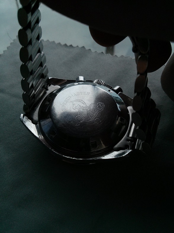

IMHO, the caseback is wrong and added for $$ value.
I have a Blue bezel, DON, Brown dial, 145.022
that's only 113 serial numbers away from this one, and
it has Hippocamus caseback. Which should be correct
for 29636xx
edit:{sorry 113 serial away, not 4}

I also have a 145.022-69 PREMOON, DON, 29636xxx

I also have a 145.022-69 with DON, (hippocampus tho) 29114xxx
