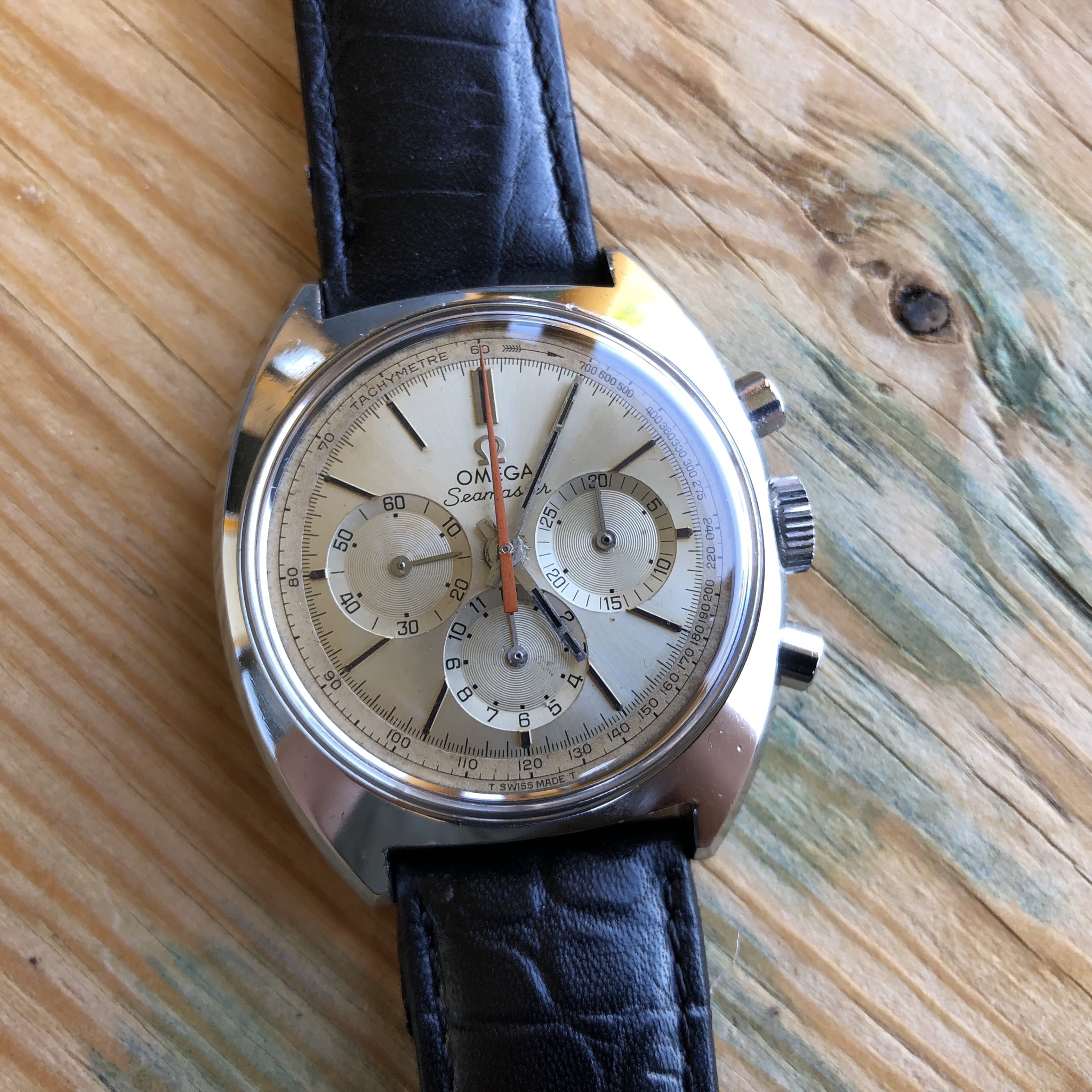

So I managed to source a 145.006-66 with what I called a Silver radial dial with thin indexes :
- Soleil Silver dial
- Applied logo
- Radial sub counters
- Long thin applied indexes with tritium dots at outside edges
- Integrated tachymètre scale
- Chrome hour and minute hands with a tritium track and a black track
- Orange chrono hand (18.20mm)
- Chrome sub counter hands
That case was polished but the rest is good, especially the cal 321 is in a perfect shape. I will make better photographs of this wonderful soleil dial asap.
--> First reference post updated accordingly.

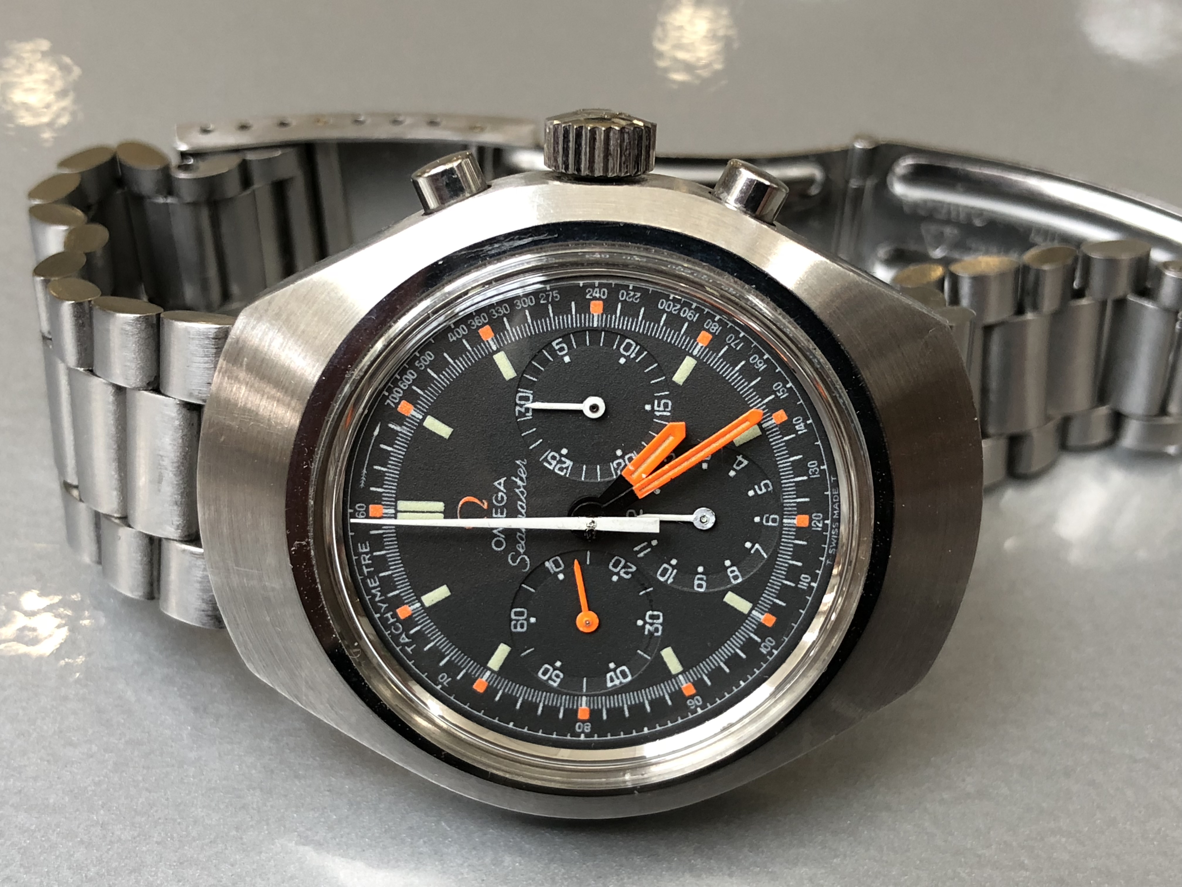

Interesting. That's probably the first Omega I've seen where the hands have lume, but the dial hasn't.
Thoughts, anyone?
It's actually not uncommonly seen for an Omega dial to say T but has no lume on it. Majority of them are in pristine condition like this one.
9,588
27,706
But the lumed hands? Any photos of these?
2,876
1,963
The lume hands are to match with the T. There sure are photos of quite a few examples around, even here on OF, I'll look them up.

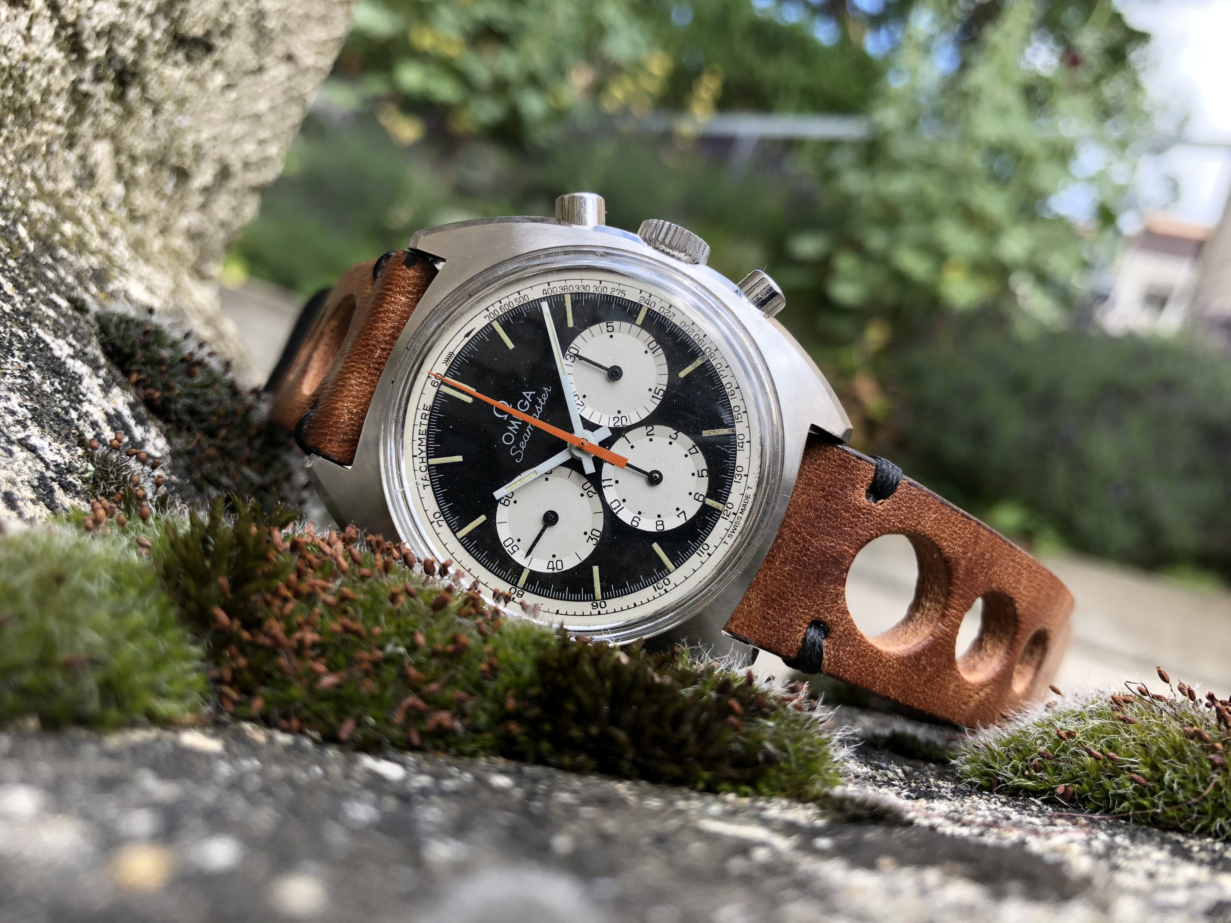

Another interesting variation of the very early 321 reverse panda radial dial observed.
For future reference.

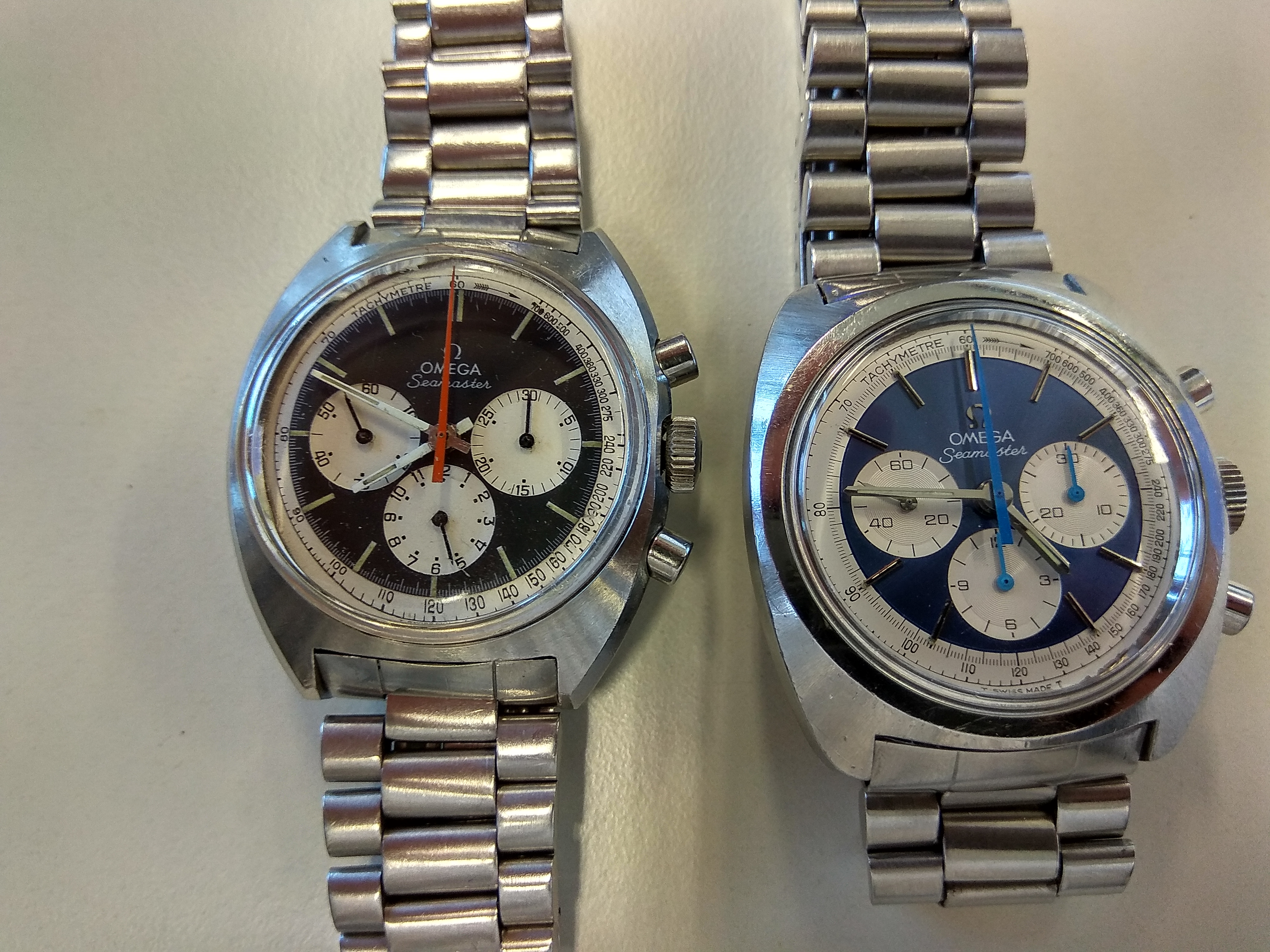

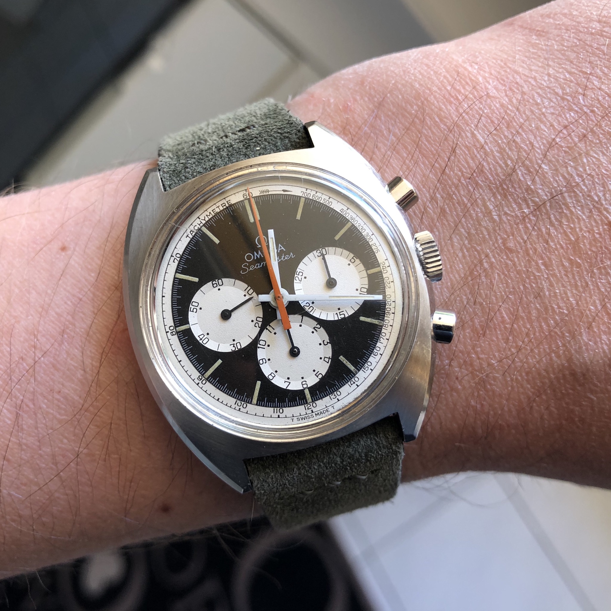

Here is my black panda 145.016 on the left. It has a circular case finish. On the right a 145.029 blue panda.

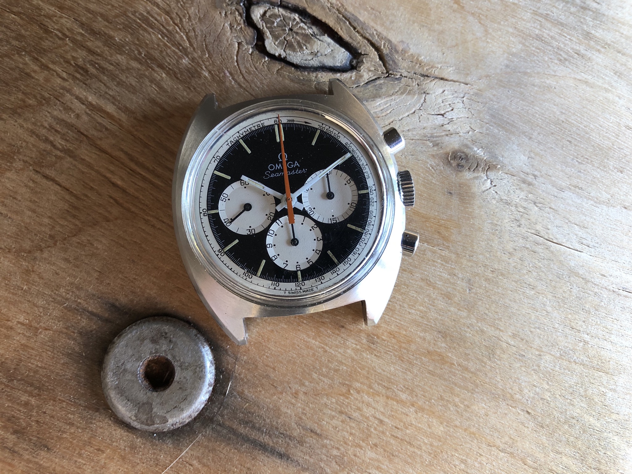

Another 145.016 variation is what I am calling a Reverse Panda radial dial :
- Black dial with white sub-counters (R)
- Printed logo
- Long tritium indexes
- Integrated tachymètre scale on a white background
- White hour and minute hands with a tritium track
- Black sub counter hands
It seems this dial was also fitted on the 145.006 references with cal. 321 but I haven't seen any, yet. Does anybody have one?
Think I like this one the most. Somebody trade for my Mint Soccer Timer ?

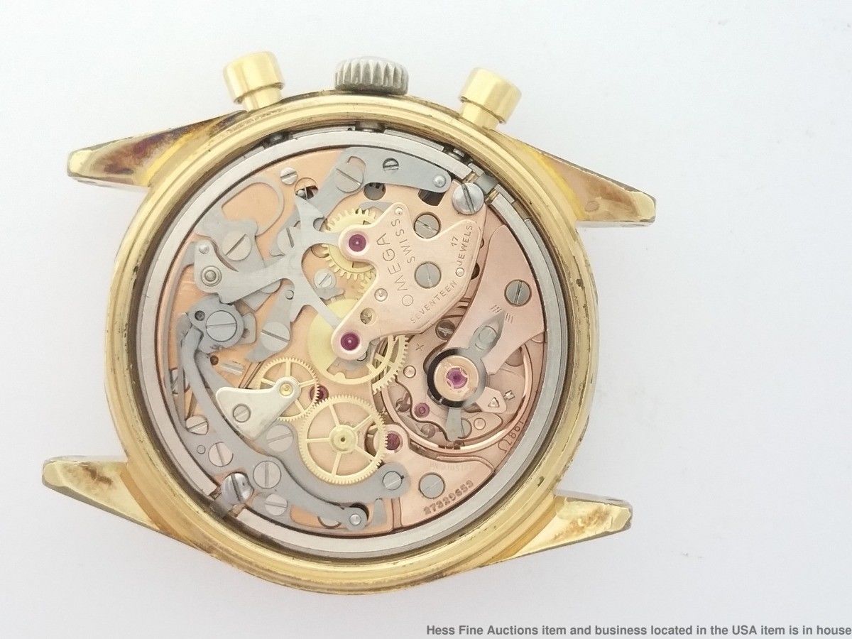

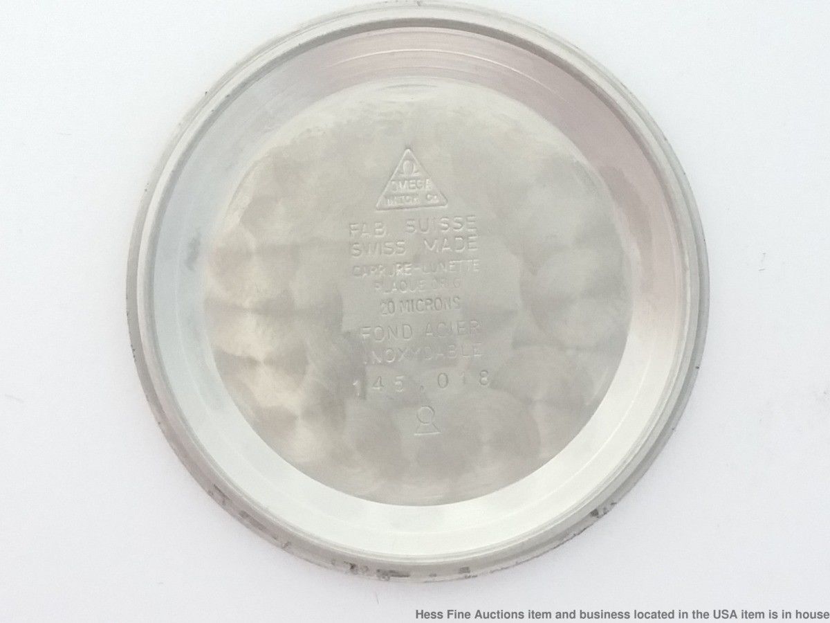

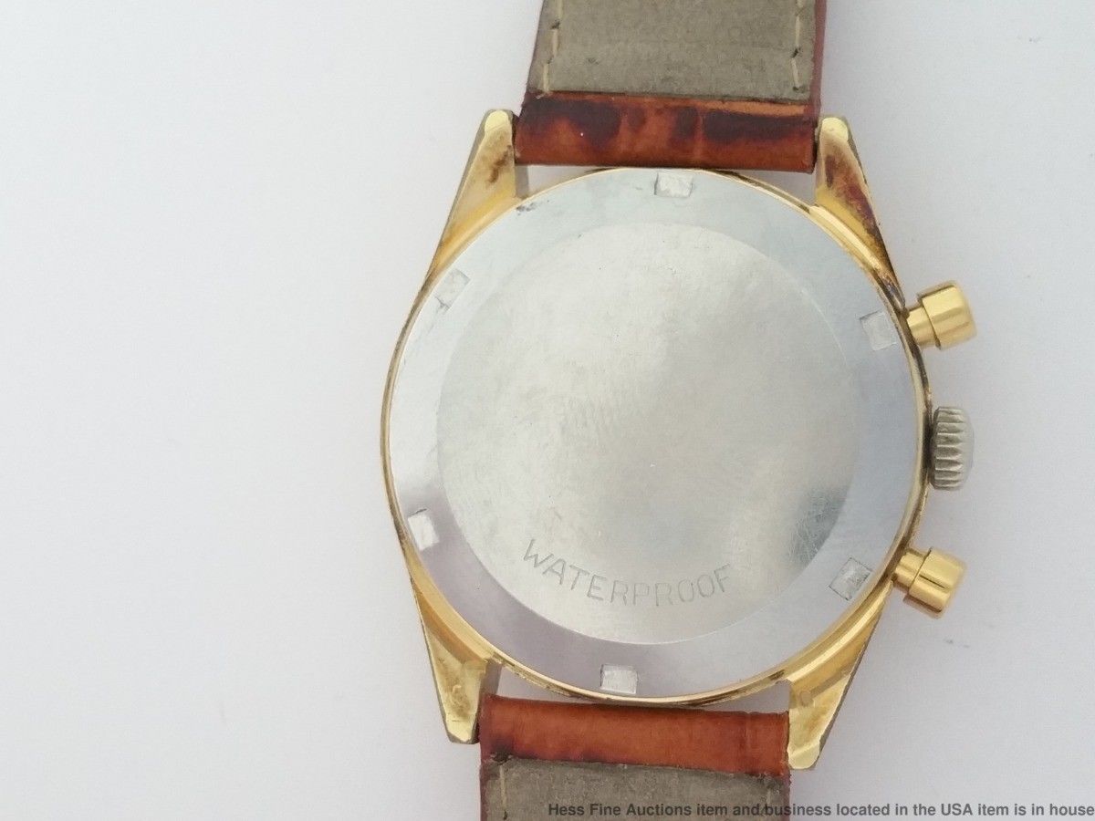

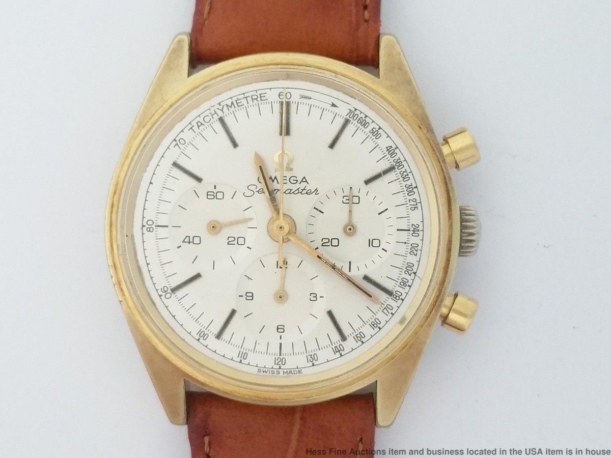

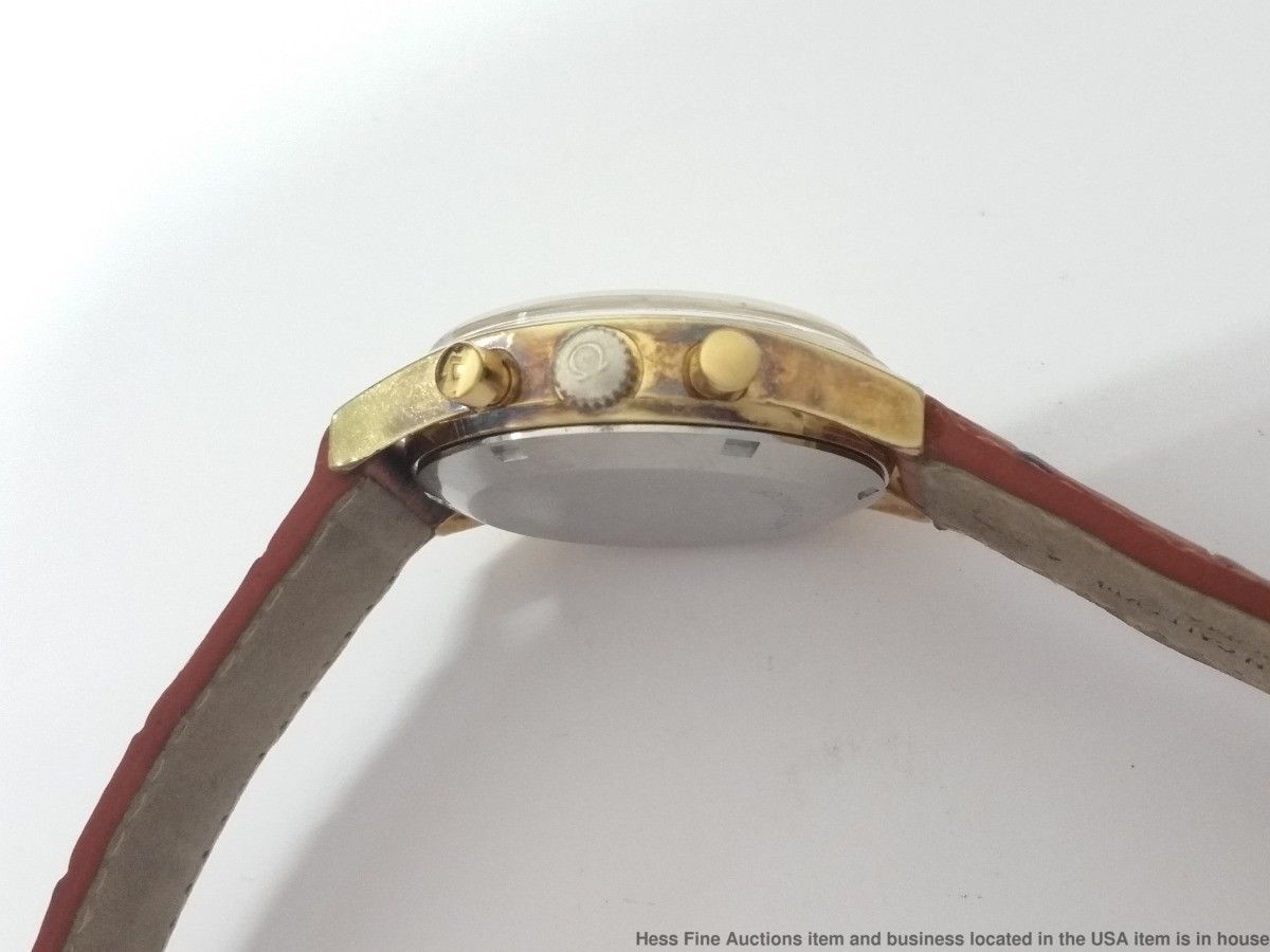

Looks pretty good overall - dial looks nice, movement looks clean. I tend to be skeptical of the 20 micron plating, but no obvious cracks or worn areas. What’s the size of the case?
10
3
The case is 34mm. I thought the crown is supposed to be the same colour as the case?
