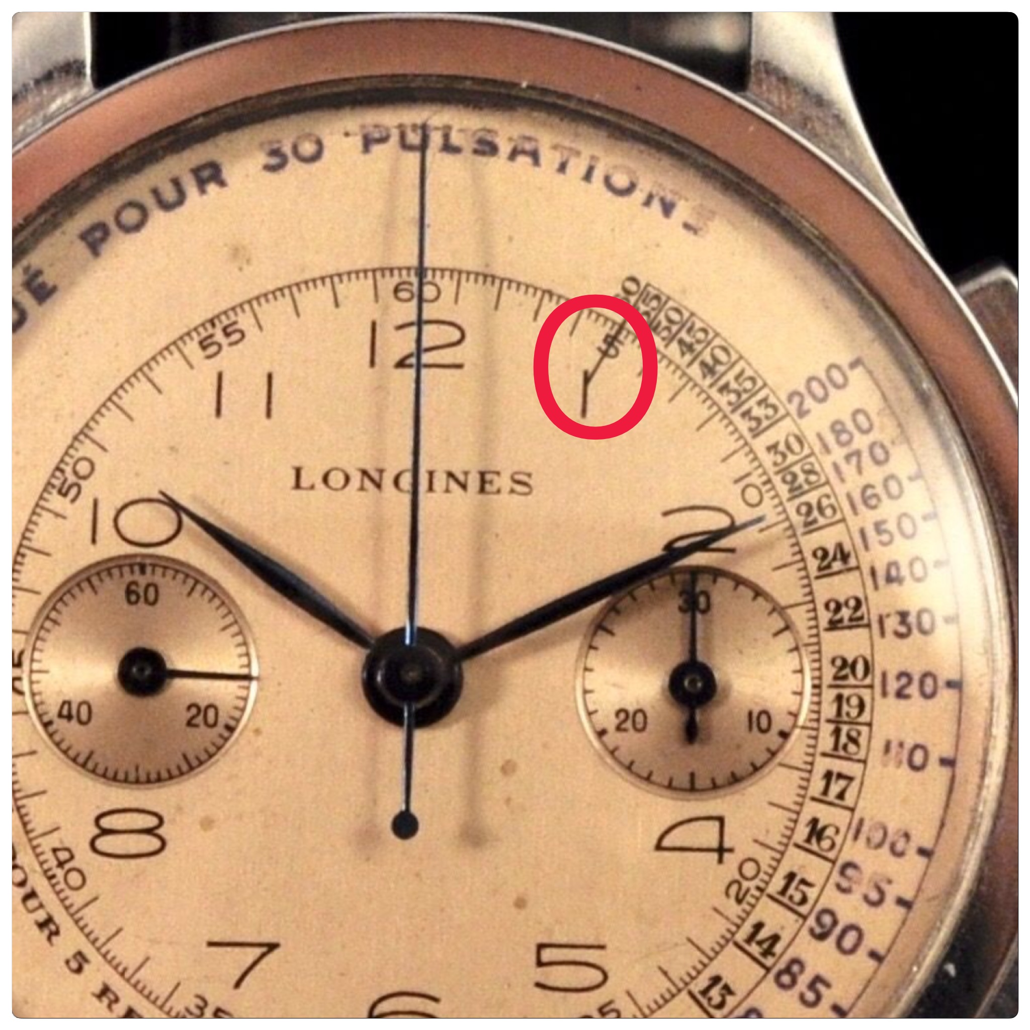

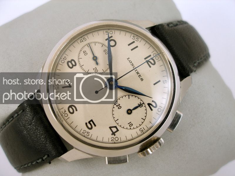

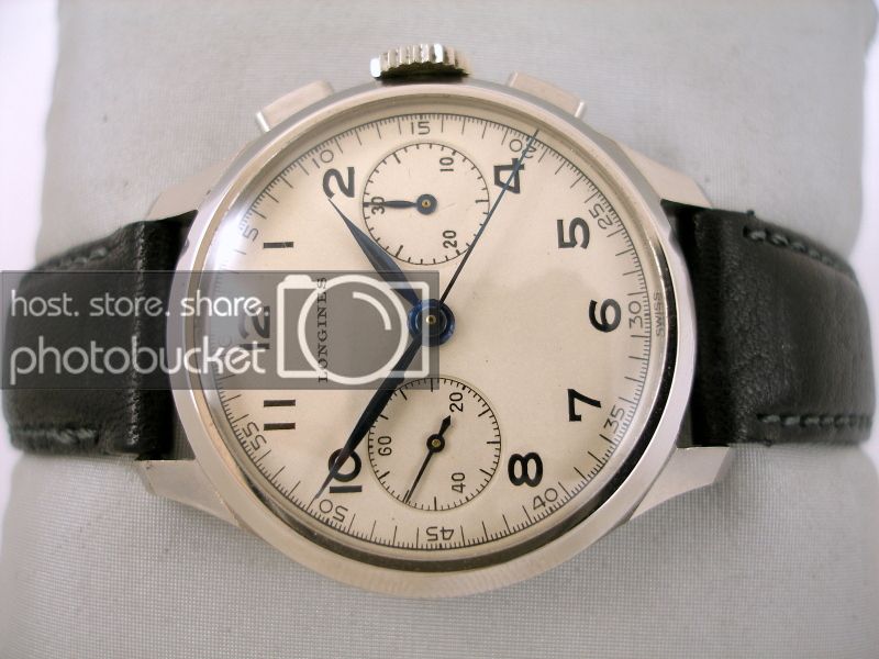

This watch has some little problems, but the dial is amazing, it came from the ZioPapa’s collection, an old italian Longines collector.
But please, pay attention, it’s a Suiza dial.

1st I thought that it looks like a redial (but deleted my post 5
minutes later). Dial seems a bit strange but too many details are ok.
Asked DirtyDozen12 and he wrote that he also thinks that the dial is
original.

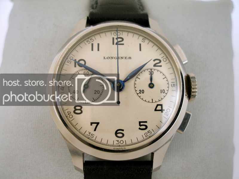

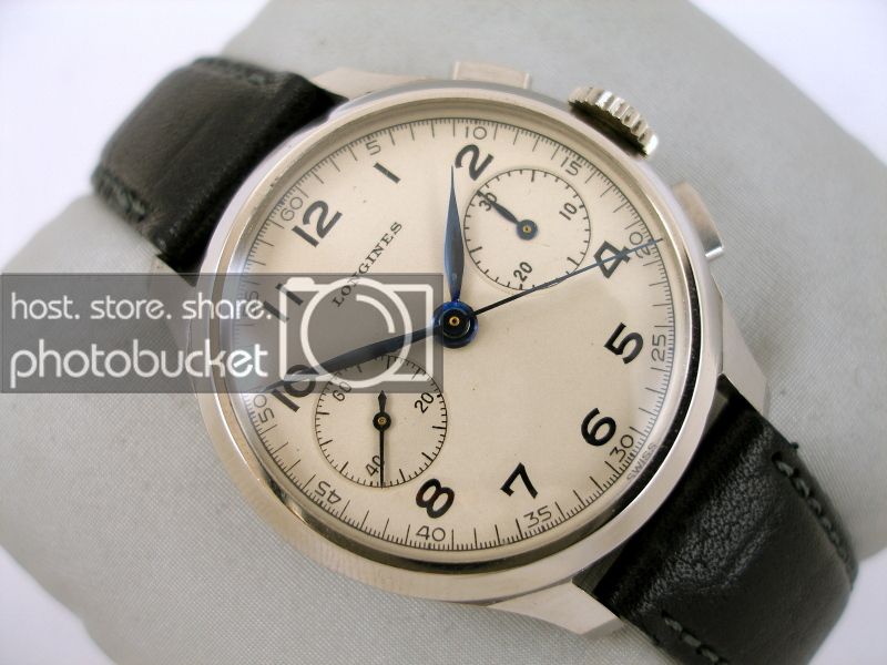

Hi guys,
I was reading about 13ZN Chronograph from Longines and came across this one on Ebay:
https://www.ebay.com/itm/LONGINES-1...942270?hash=item5675b45dfe:g:~v0AAOSwr81UTh45
I have several questions / confirmations about the watch:

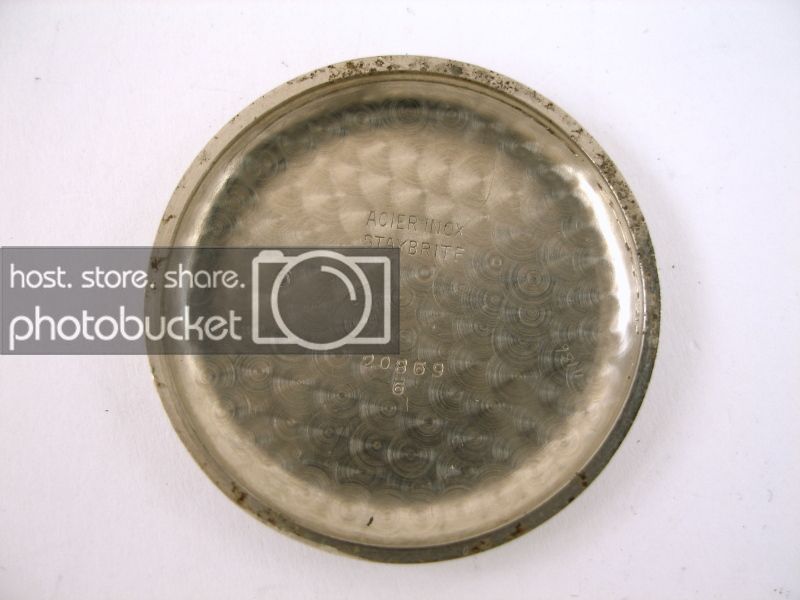

- What is the model number? I saw 20869 engraved on the back case, but I couldn't find any information when I googled it.
- The dial looks in good condition for something that is near to 70 years, so I was wondering whether it is a replacement dial.
- The asking price for the watch is EUR 10,900. Is it a fair market price?
No model numbers exist. There are reference numbers associated with cases but most collectors would simply refer to this watch as a steel 13ZN.
The dial was probably not replaced but has certainly been refinished.
No. The refinished dial renders this watch far less valuable than the asking price.

Unless you know for sure the dial was refinished then it is only an assumption.
Ask anyone who knows about Longines 13ZN dials and they will tell you, in a heartbeat, that the dial above has been refinished.
As for a watch being refinished, it all depends on the rarity and value of an object that is either common or uber scarce. Of course there may be a drop in price but depends of the quality and authentic likeness of the original. 20 percent difference as one other member mentioned. But again depends on the importance and impossible finding of a watch that is rare and possibly incredibly valuable. If I had an offer to buy a 1970 hemi Cuda in rust free unmolested condition with the black paint faded I would not think twice to repaint to "Factory specifications" and get a much higher value.

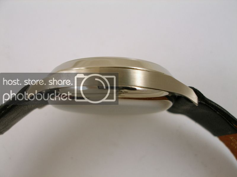

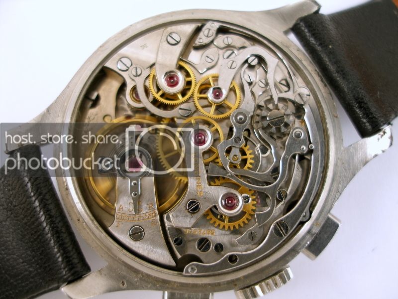

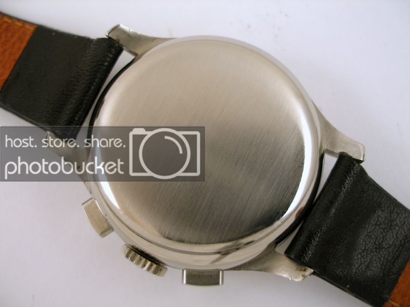

Coming back to 13ZN: I looked upon "ebay/watchmeisterin/see other items". All offers far too expensive, even if compared with chrono 24. In other words: This seller makes no gifts and will not offer a steel 13ZN with original and untouched dial for a reasonable (even low? I believe original and untouched 13ZN dials are the Koh-i-Noors of the Longines universe*) price. Furthermore the dialfoot looks too bright/not copper-colored and the 5,800 000 movement number points to an earlier example (1938/39) that should have rail tracks on both subsidiary dials and the typical 13ZN subsidiary hands; not these 30CH styled ones. The case is polished.
*Analogy
5.900 000 movement number

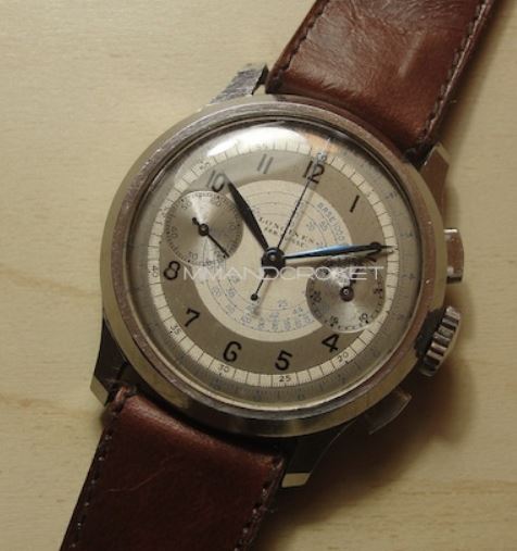

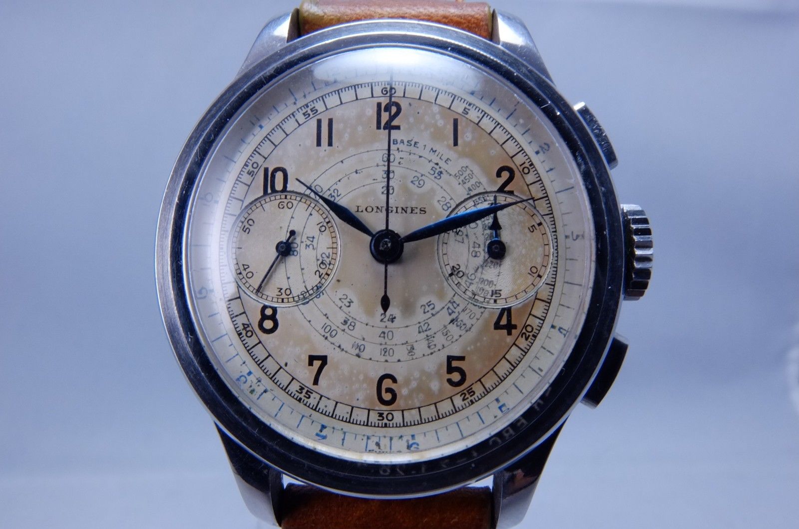

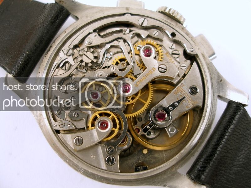

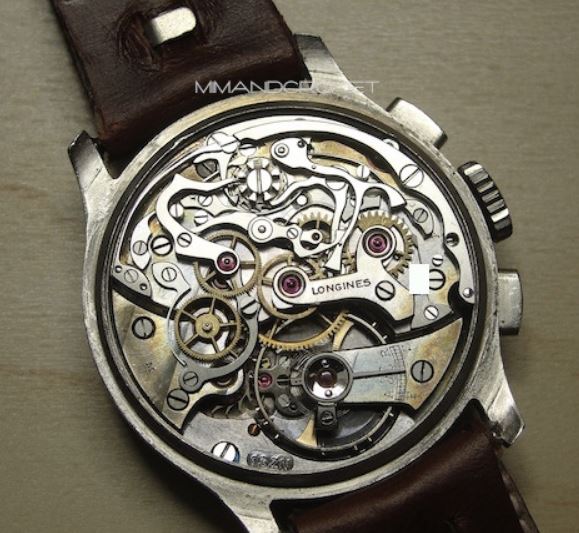

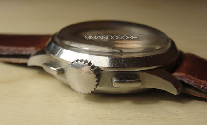

Back to the watch again, note the "M" by the driving wheel. This indicates that the watch originally went to France. Here is another 13ZN with the same case design and "M" marking. As expected, "Fab. Suisse" is printed on the dial. I would expect to find it on the dial above too. However, just comparing the dial to original examples from the period should be more than sufficient to convince any discerning observer.
2,057
25,237
...good thoughts about that watch. Now we know what the clock might have looked like.
