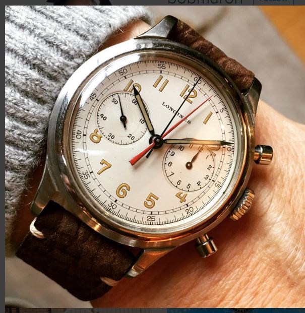

Considering the plethora of variations, rampant redials, and widespread fascination, I feel that a sticky thread, dedicated to 13ZN inquiries, may be in order. There have been quite a few threads about 13ZNs of late. A centralized (sticky) thread may become a valuable resource if this trend continues. However, I do not know what the creation of a sticky thread entails and therefore respect your judgement on the matter.

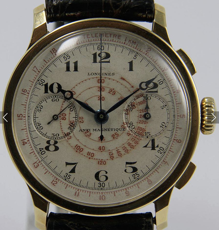

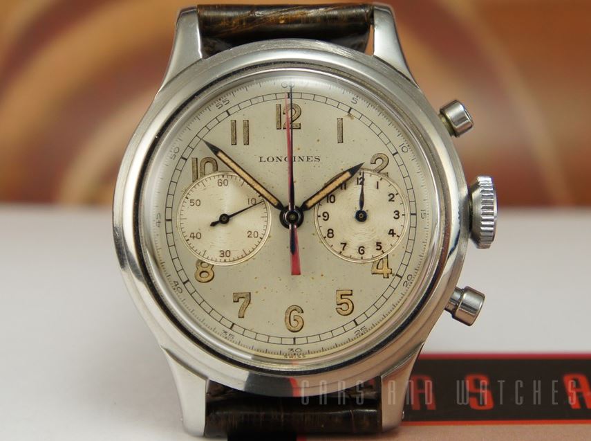

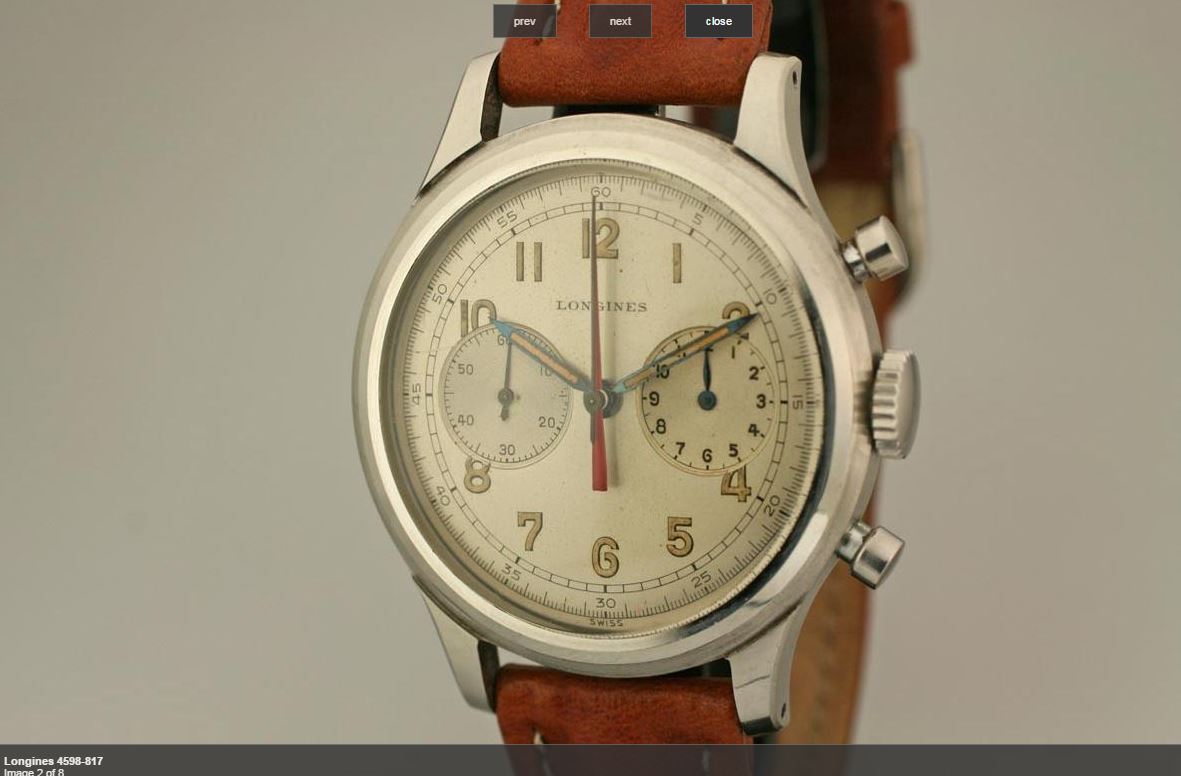

The first is surely a redial with a very poor signature. The second looks suspicious to me as well. The large numerals are in a font that is usually found in much older watches and the open minute track, with round 3s and a closed 6, seems odd too.
1,973
24,874
I agree, the first dial is a fake and the second one probably too - never saw round 3s and a closed 6 on such an old dial. But it should be mentioned, that the second one is not a 13zn but a 15" (valjoux movement). The price is absurd, because nobody pays that much for a valjoux type...
rgds - h.u.
2,801
4,864
Thank you for the correction. I was unaware that Longines used Valjoux movements at that time.
1,973
24,874
I phoned to Mr. Meertz, seller of the two watches above, and he said that he will research a bit. In my Longines text collection is only one passage about the cal. 15": "...during the the 20ties and 30ties Longines equipped chronographs with a cal 15" based on the Valjoux 22 GH" **. It was a movement with a pusher at "2", terminated by Longines. From it´s precision watch manufacturing Longines took he screwed stud. The caliber 15" has been gilt by Longines and had a column wheel + clutch, a monometallic balance with four regulating screws + breguet spiral. The levers had been decorated with "Genfer matt" and were beveled."
Nothing about a Two pusher version...
**has in fact 15" instead of 14" (as the common Valjoux 22) and, sometimes, two pushers
rgds - h.u.

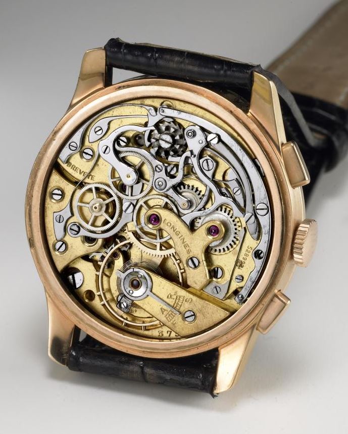

2,801
4,864
It would be interesting to see an image of the movement...

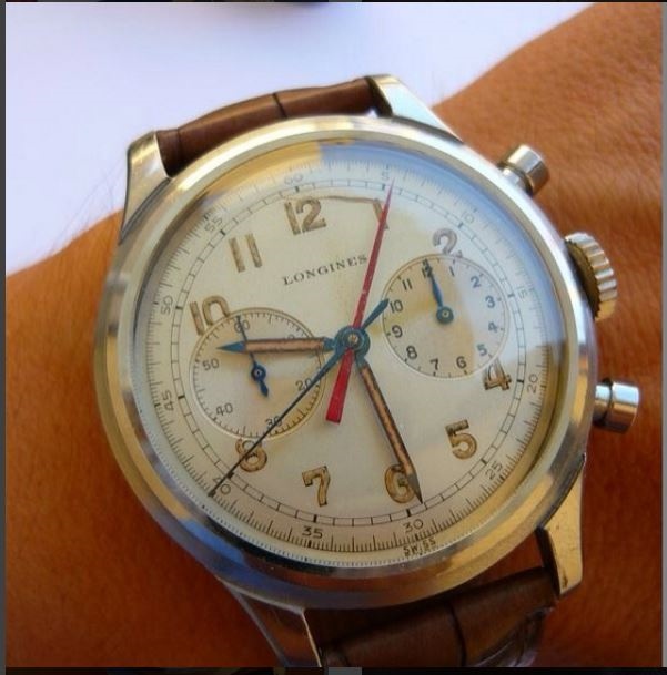

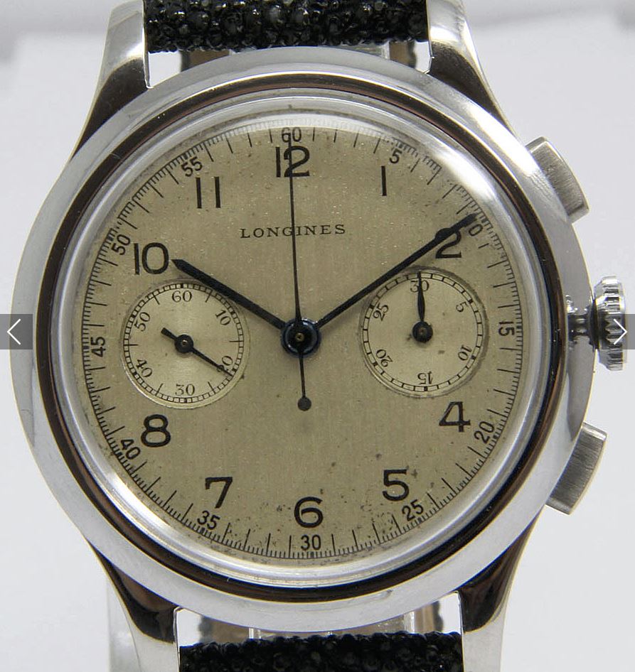

Encountered this image recently and wondered if anyone has any thoughts. I find the subdial printing imperfect, especially the closed 6 on the hour counter. The outer minute track numbers do not look correct either. The "Longines" font is difficult to assess but the overall look and even color of the dial (it appears too white) rubs me the wrong way. Below the watch in question is an original example for reference.
2,801
4,864

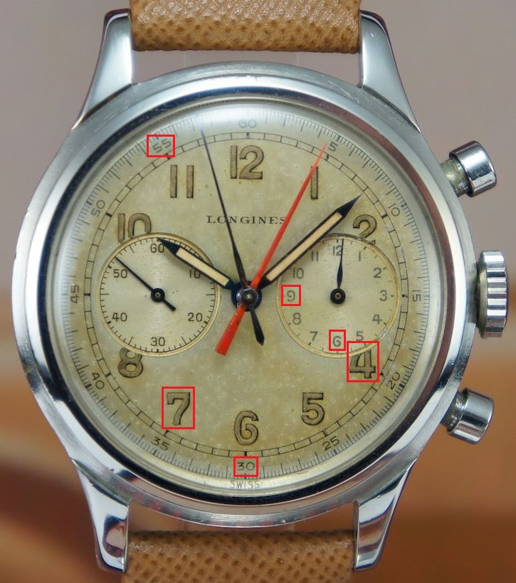

Also, the 9 on the hour counter should be open. The entire 'inside' of the luminous 4 should be visible. And the back part of the luminous 7 that is perpendicular to the flat top, should be longer.
2,801
4,864
I would like to reiterate certain points of concern in a more explicit manner.
1. The bottom part of the 3's and 5's in the outer minute track should be essentially straight (not curved) and parallel to the top part.
2. The 6's and 9's in the hour counter subdial should be open (not closed).
3. The straight part of the back of the luminous 7 should be as long as the straight part of the front.
4. The entire cutout in the luminous 4 should be visible (not cut off by the hour counter subdial).

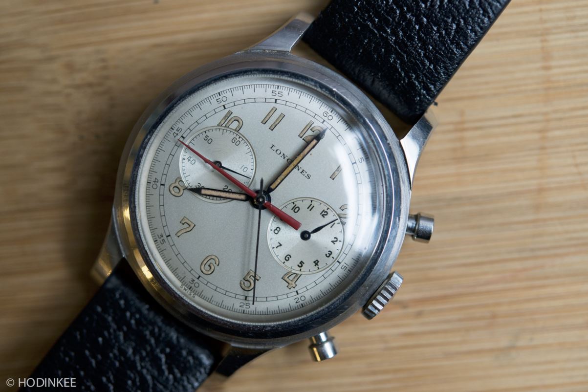

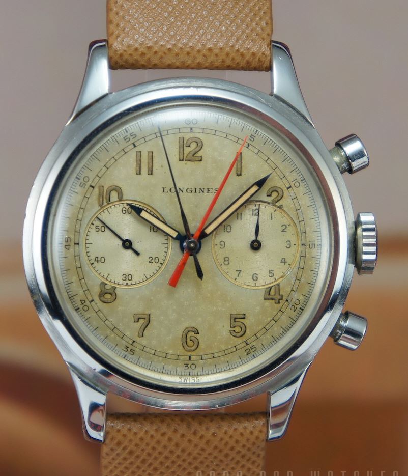

Here are other examples to compare.
