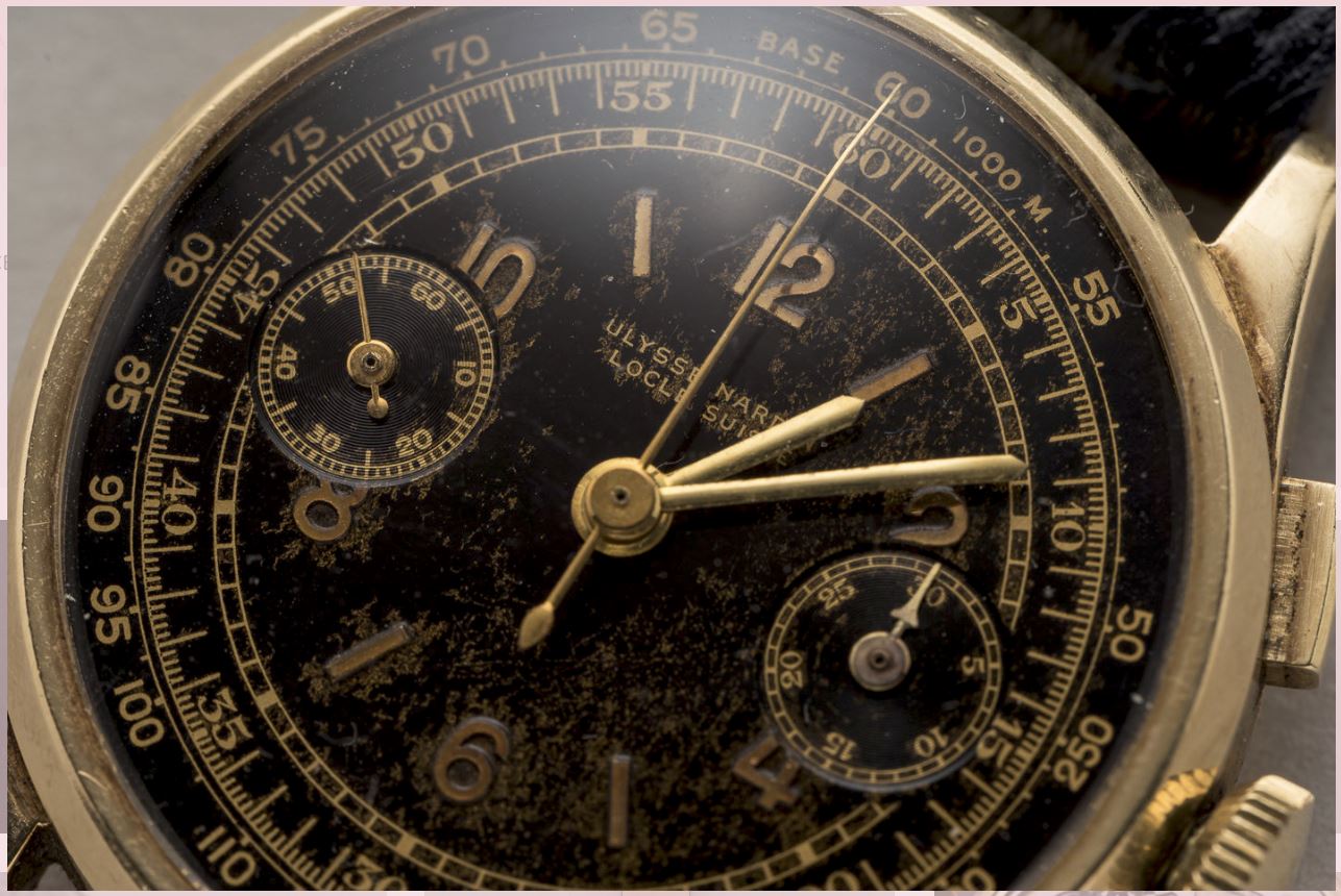

As a side note, I believe that there are 13ZN dials with upside-down numerals in the minute counter. Among others, UN used dials like this too (see below). Longines examples found here: https://omegaforums.net/threads/13zn-chronographs-inquiries-and-information.32929/page-9#post-711368
It’s not hard to find 13.33Zs with this configuration on the left and right subdials, but they are from an earlier period. The black dial watch that was linked has an obscenely low serial number. We can check with Longines if that’s a 13.33Z dial or a 13ZN dial on the watch Dr Crott had. They sold a questionable R. Marina 13ZN a few years ago with an enamel dial and inverted numbers. Same watch James Dowling tried to peddle also. For that watch the Longines archive clearly showed it wasn’t delivered to the Institute. Seiji’s watch is much newer and has a much newer dial type
The Dr. Crott example is a very early 13ZN. I am quite confident that the dial is original but it differs from Seiji's radium dial in a number of significant ways. Just an aside.

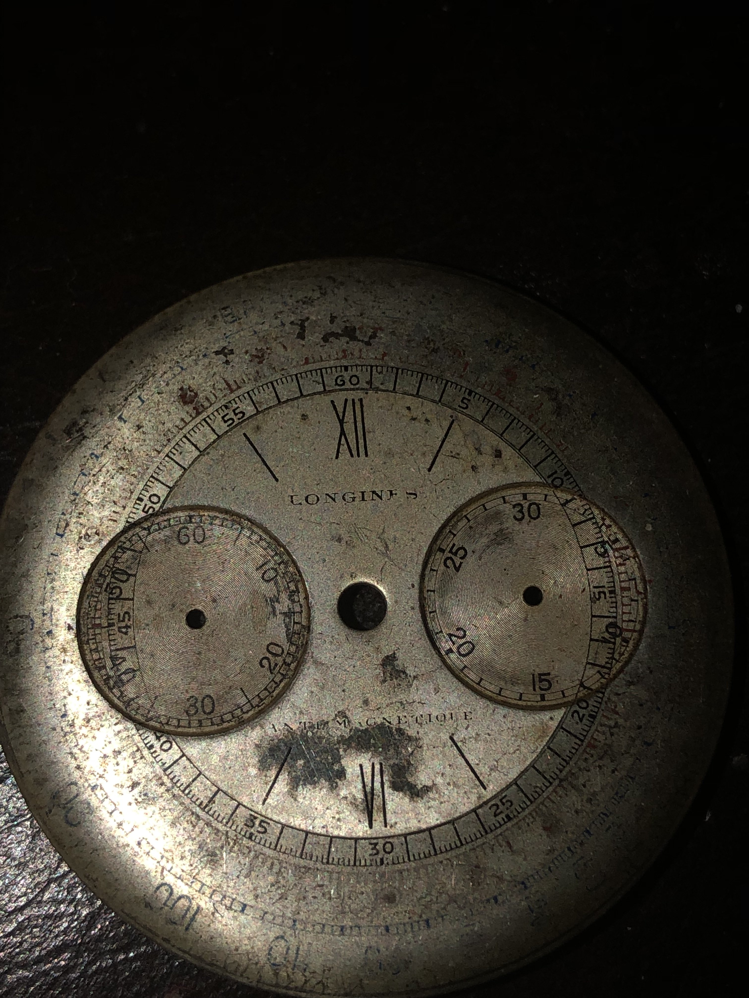

I have an old dial “Anti-Magnetique" Chronograph.

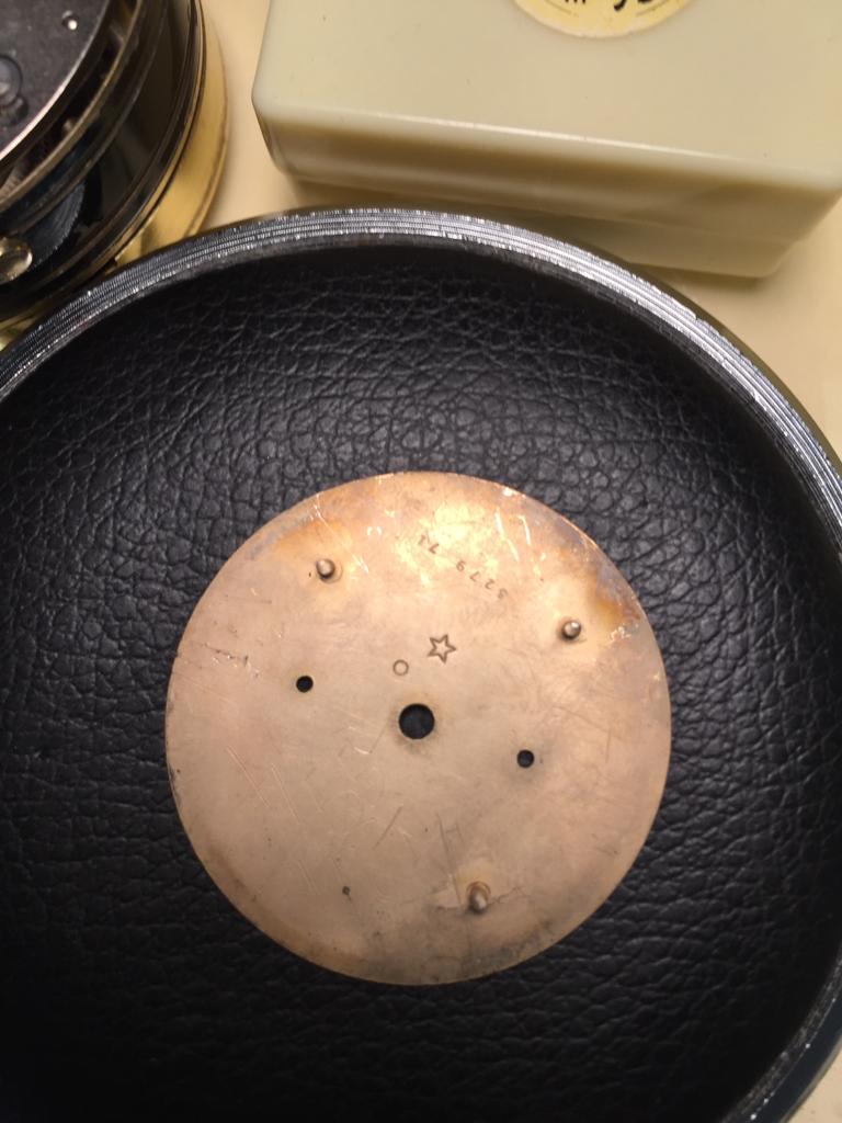

As photos get blown-up and their resolution decreases, everything begins to look the same since detail is lost. Anyway, I have given my opinion on your radium dial's signature before and I still feel that it does not look correct when compared with dozens of original signatures.
If you want other collectors to properly assess your dial, make sure they are aware of the two other examples that I have found with the same fonts. I believe that all three of these dials should be considered together as they likely come from the same source. All three are visible in this thread: https://omegaforums.net/threads/speculate-on-value-of-this-early-13zn.47028/page-2
P.S. And address the silver foot, which is a glaring issue in conjunction with the other atypical features.

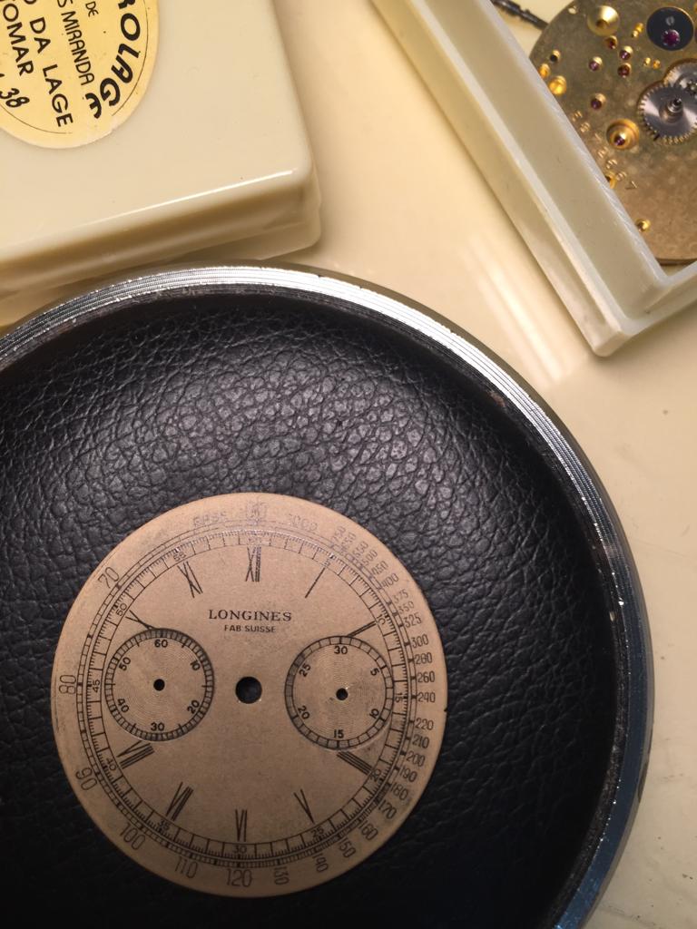

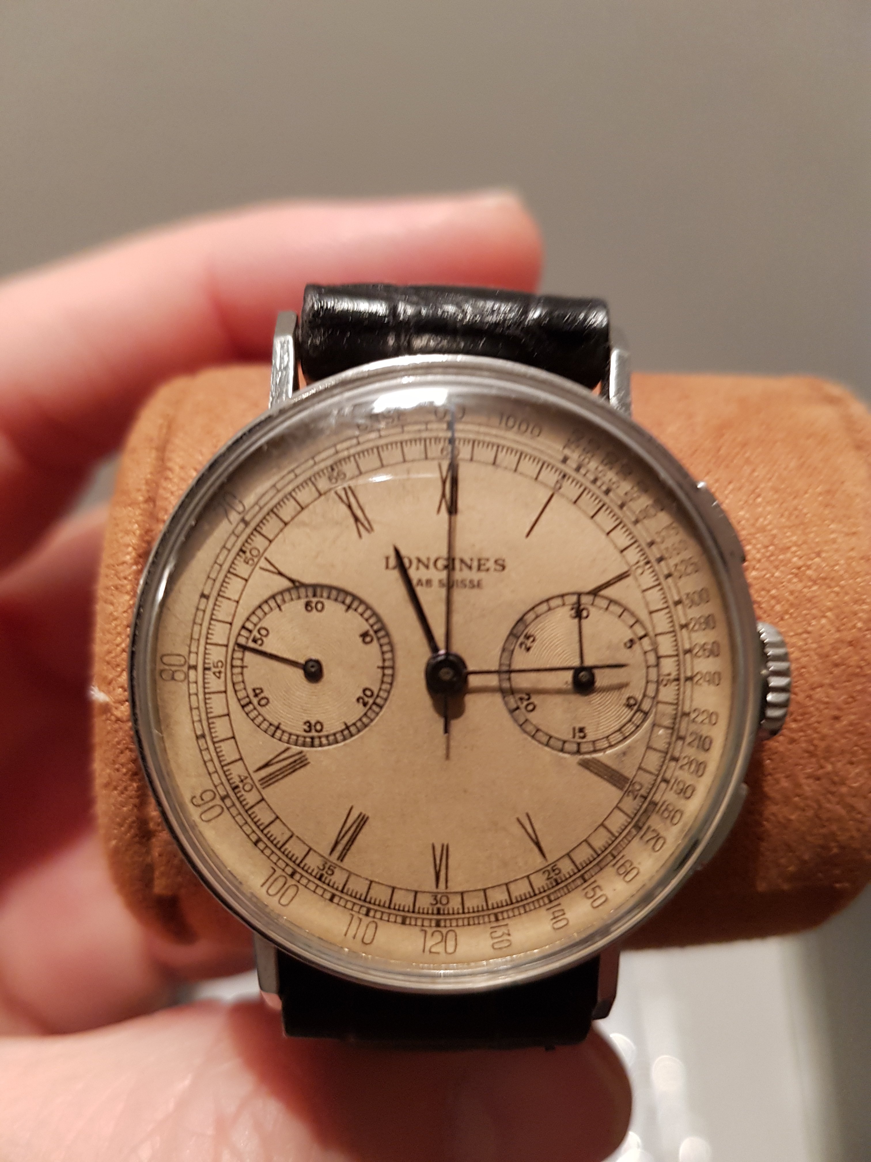

Hi guys, thanks in advance for your willingness to share such valuable opinions. Although there is a similar dial in Goldberger's book, not sure about the one in the photos I am attaching, could you please advise?
81
405
redial
Ok, thanks. Could you please drop a couple of lines on why?
590
1,225
For me the entire printing looks "off" compared to other Longines dials, particularly the logo and the subdials
