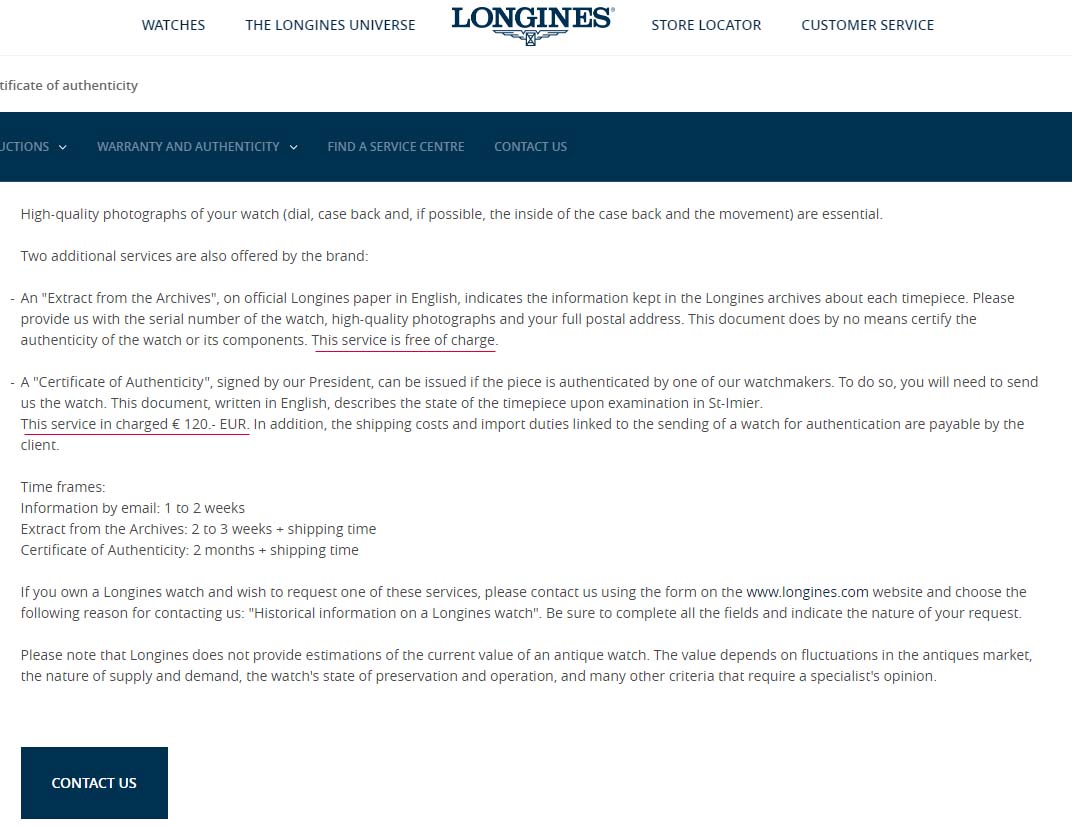

Yes - surely it was. As well as this one:
To be clear : Longines' Certificates of Authenticity do not guarantee that dials are un-refinished.
I was disappointed to find out, considering they now charge 120 CHF for the service which used to be free.
But the certificates on their face do not say the dials are unrestored, and when I inquired about that Jennifer's reply was:
"le certificat atteste l'authenticité (à savoir s'il s'agit de pièces Longines ou non) des différents composants de la montre (boîte, glace, bracelet, cadran, mouvement) sans entrer dans leur degré de restauration. De plus il compare la physionomie de la montre à la date T par rapport aux informations contenues dans les archives au moment de sa production. Les informations qui figurent dans le certificat, ou qui ne figurent pas, ont été mûrement réfléchies".
My translation: "the certificate testifies to the authenticity (ie whether they are Longines parts or not) of the various components of the watch (case, crystal, strap, dial, movement) without getting into their level of restoration. Furthermore, it compares the make-up of the watch on the day it is examined, with the information contained in the archive at the time of its production. What information figures in the certificate, vs which doesn't, was thought out carefully".
I have to infer that with that, Longines deliberately chose to keep out of potential disagreements (and/ or litigation) over dial originality or modifications. I also have to notice the hands do not appear in the list of components being certified. Will update if I have any further info on that.

I thought, an "Extract from the Archives" is free, but a "Certificate of Authenticity" had always cost some money. Is that wrong?

The Certificate of Authenticity was free too until a few months ago.
By the time I asked for one in August 2018 it had just recently become a service for which they charge.

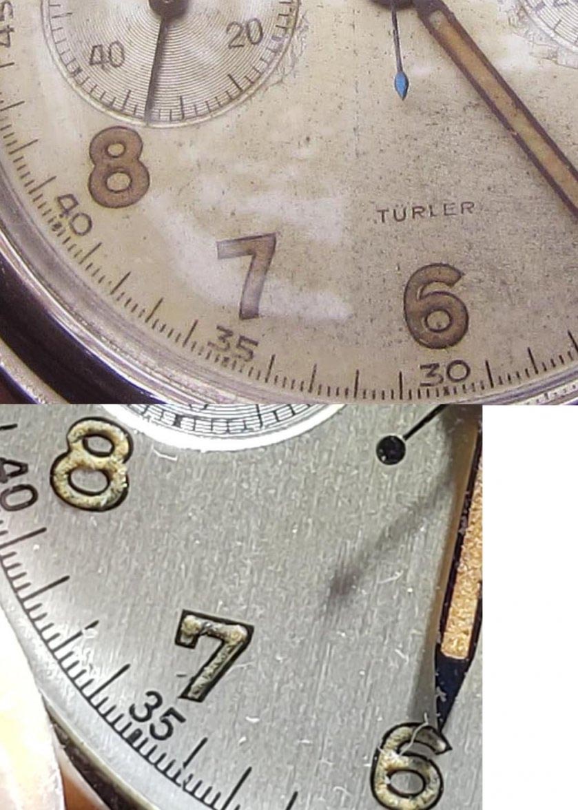

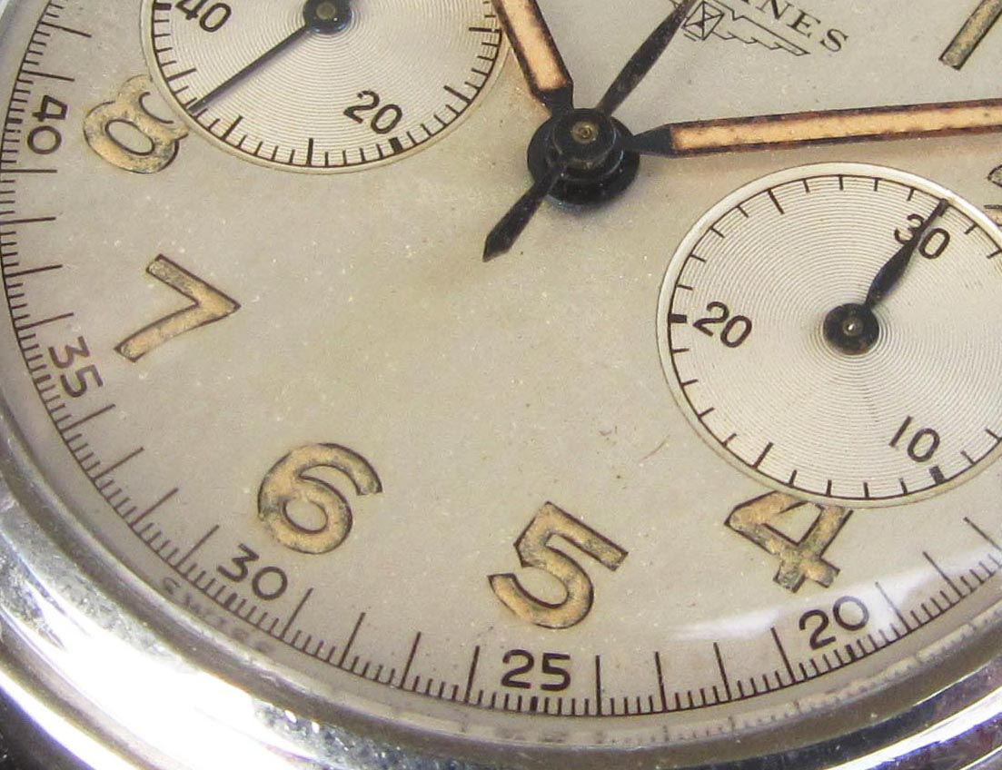

So I repost my comparison of an original Longines radium dial and Seiji´s; it seems clear to me that this kind of radium application is not like it was usual during the thirties and the fourties (or later) - no matter if you are watching a Longines, an Omega or any other radium dial. And that´s only one point I´d like to mention regarding that dial and it´s authenticity.
I´m collecting Longines watches for a longer time and I´m definitely of the same opinion as DirtyDozen12 and TinyClown.

Better photographs, other watches to compare to, visit to St. Imier, meeting John Goldberger, meeting Bernard Portal, conversation with Adriano Divadoni, meeting and showing watch to other world class collectors, purchase of other 13zn similar dial parts.
Tell us about your qualifications. Written a book lately? Are you responsible for authentication of Longines? Buy and sell a $5.9 million watch? Until you qualify yourself, you have no credibility. If you're going to St. Imier this week, I will enjoy showing you the watch. Are you one of the "Sixteen"?

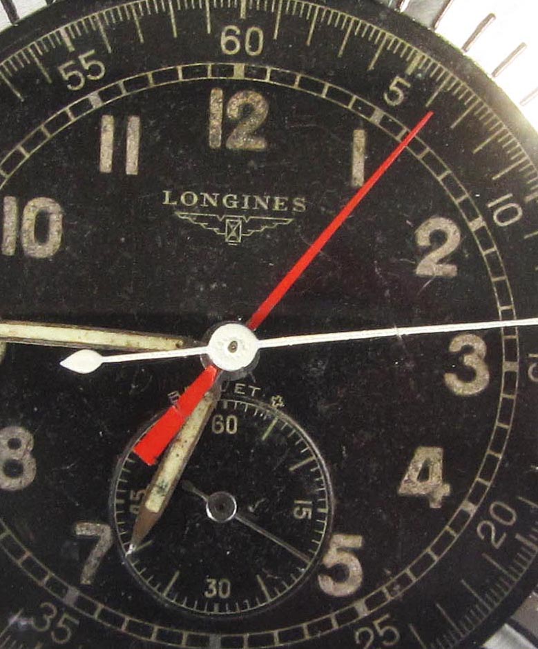

The inverted numbers (15 and 20) on the right subdial are incorrect. Longines didn’t issue 13ZNs with inverted numbers. Case closed
PS: I just looked at every single watch in the 13ZN and 30CH sections of Goldberger’s new book. NONE of them have an inverted 15 or 20
