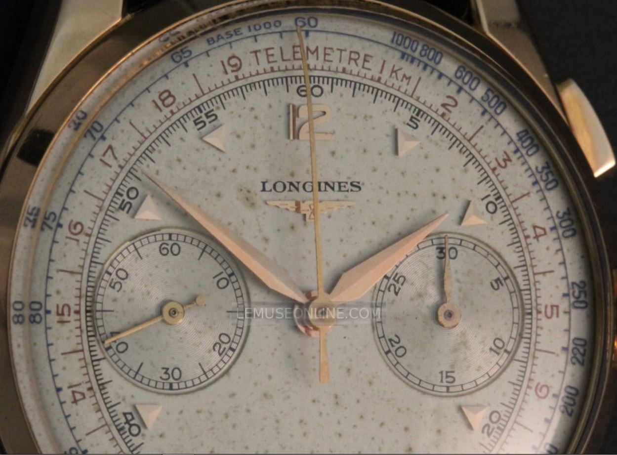

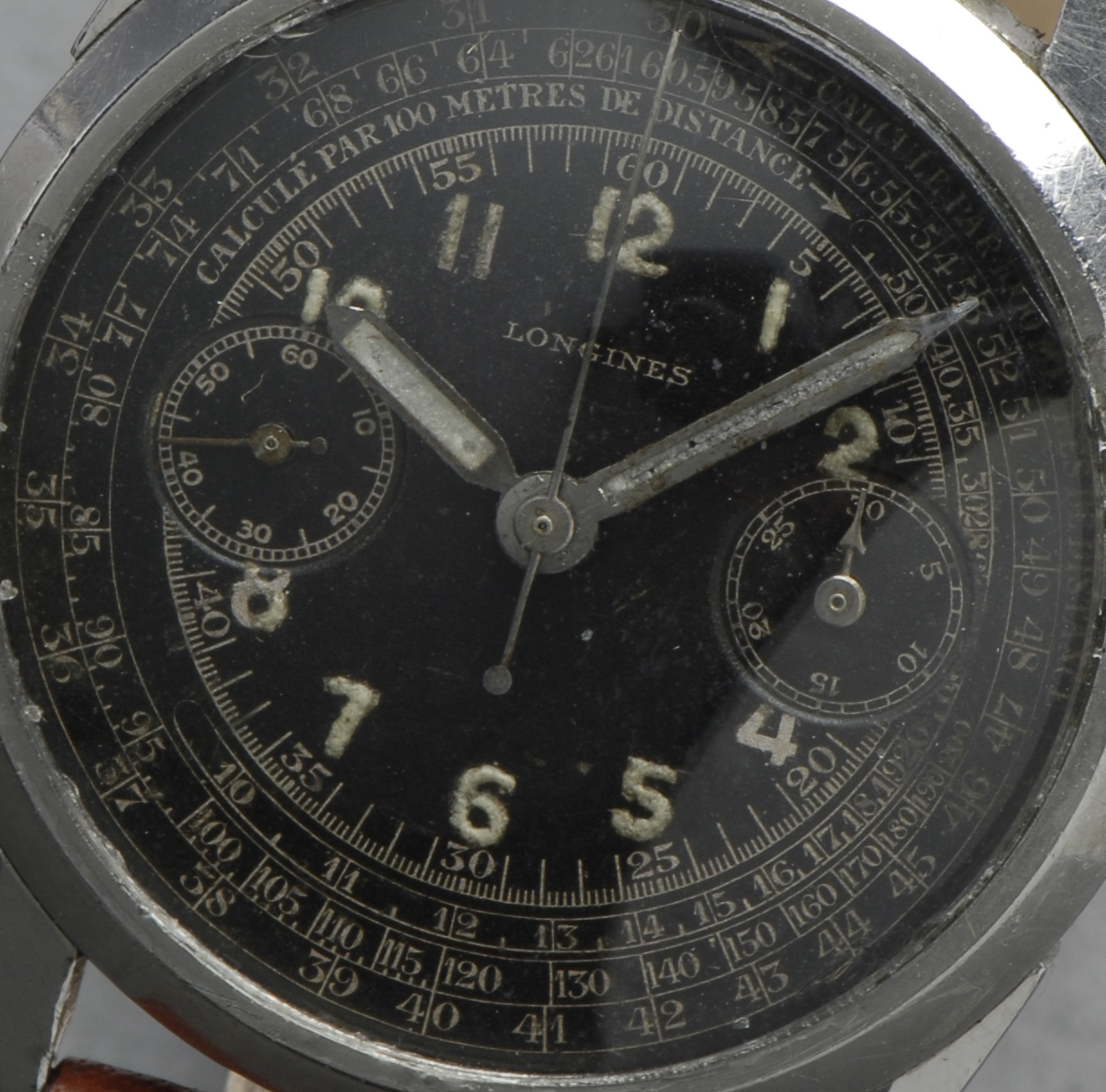

My god, this is just horrible. How could they pass this off as original?
590
1,225
Also sad that it's going to be featured in the upcoming fero book. Wtf?
590
1,225

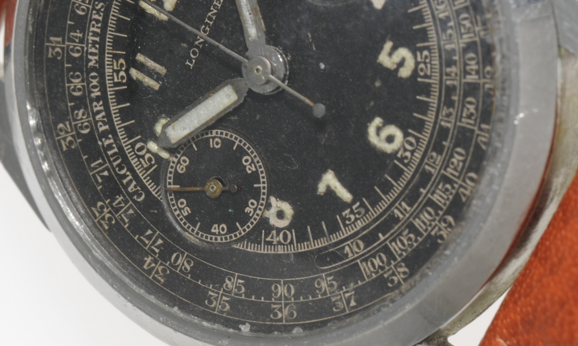

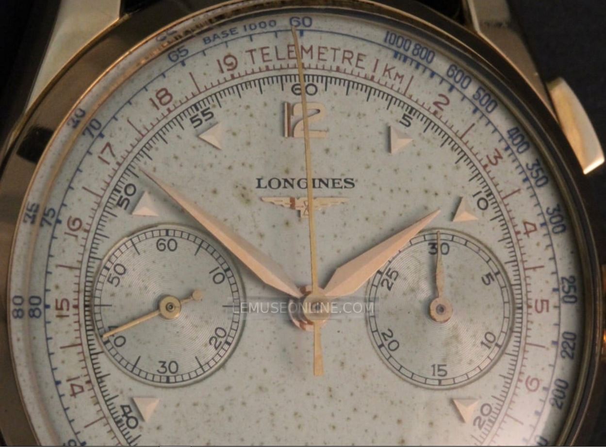

So I went to the London preview for Phillip, but they didn't have the above two Longines watches on preview.
2,829
4,948

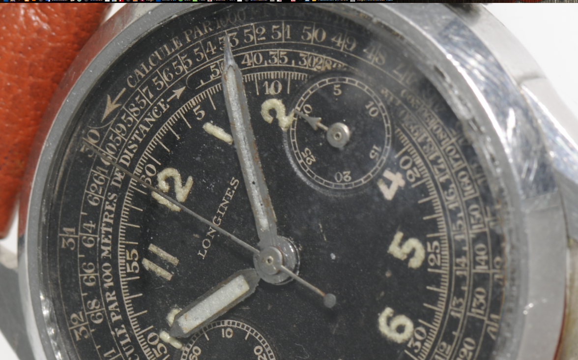

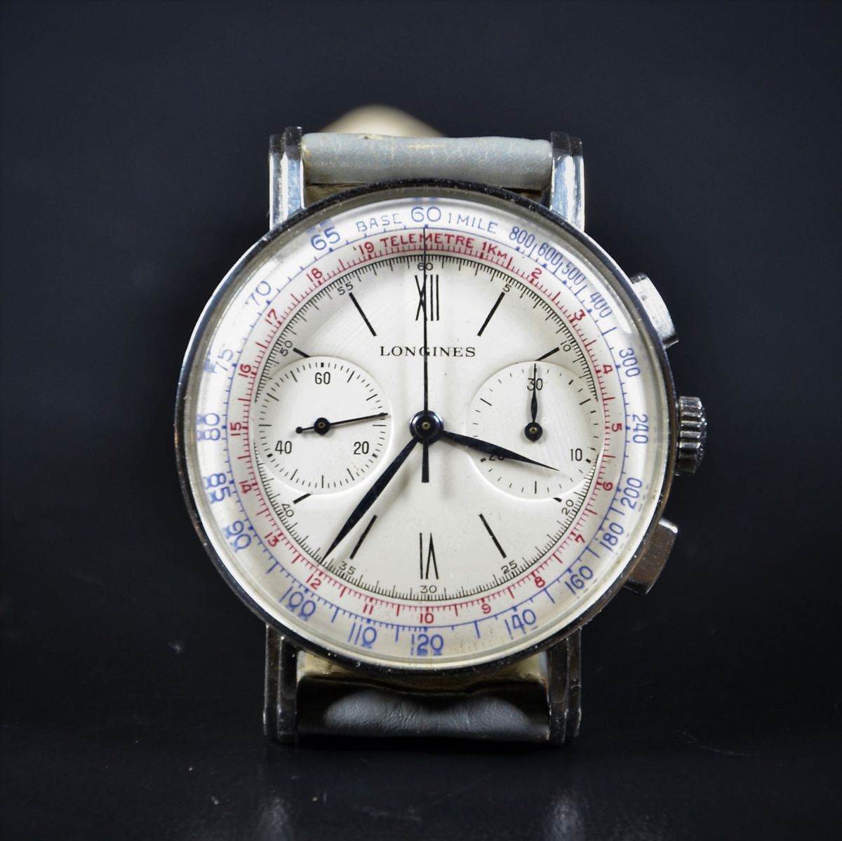

Below is a typical 6595. The handset is the same as the one above but the minute hand reaches the minute track, as one would expect.
1,180
4,233

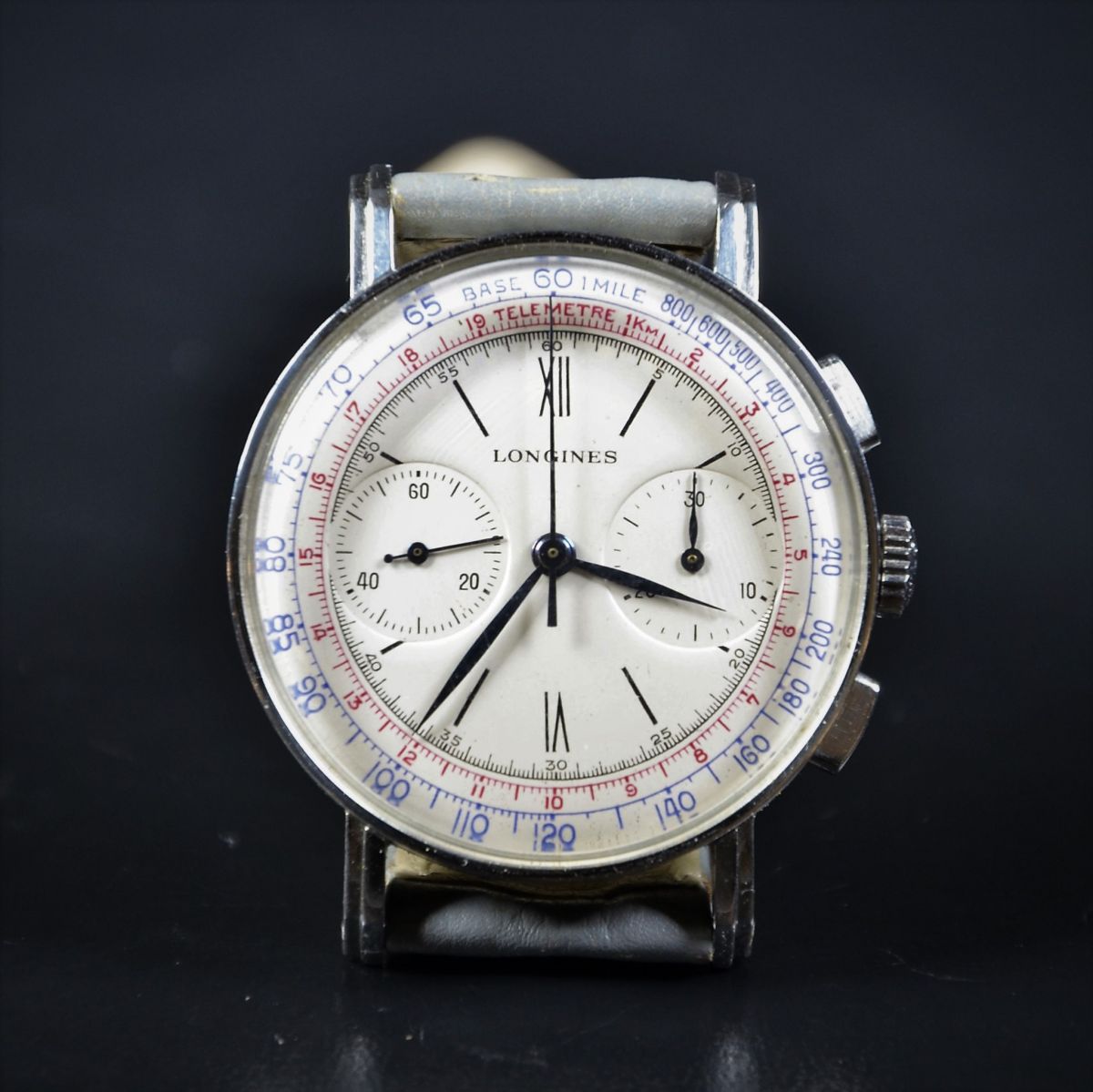

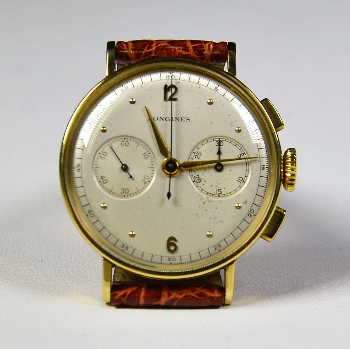

Hi!
the seller claims that this one is new old stock. However, the subdials make me doubting...
Unfortunately, my knowledge of Longines' 13zn is quite limited.
Any thoughts?
Thanks in advance!
2,829
4,948
Hi!
Any thoughts?
Thanks in advance!
Awful redial. Stay away.
7,690
22,055
Me three, blatant redial. Yuck. Those sunken subdials are a dead give away of a repaint job.
1,180
4,233

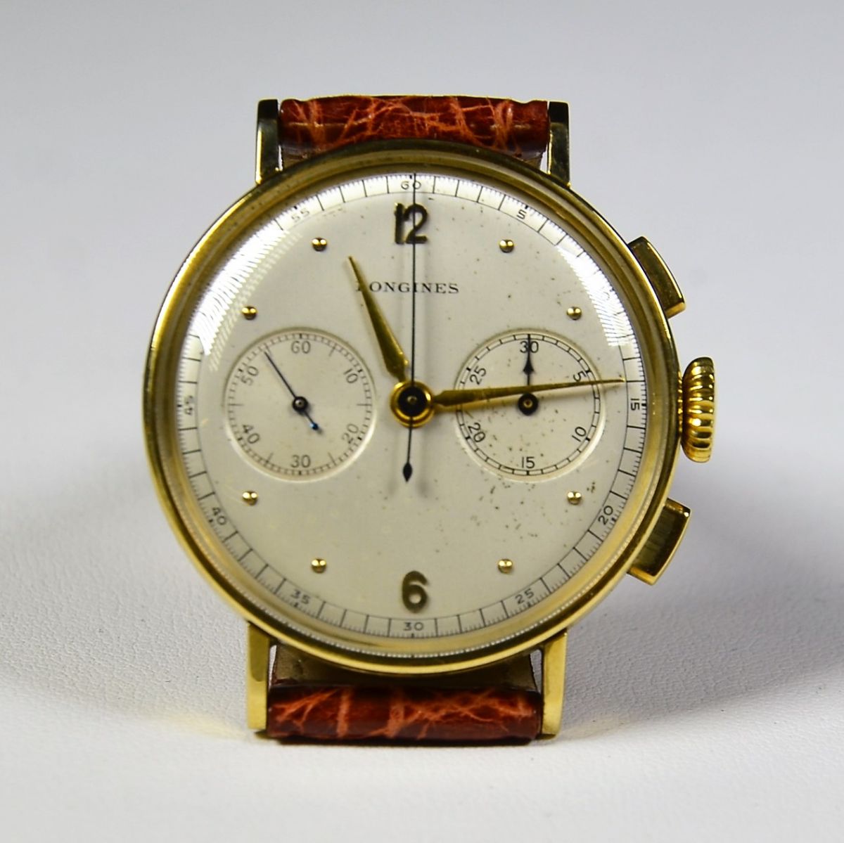

thanks again!
I have another one that looks better (in my eyes). Am I right?
Unfortunately, no other pics. Starts at 5600$.
2,829
4,948
Firstly, quite a few of those hands look unusual. Secondly, this is not a common dial variant. Though the general appearance of the dial looks good, better photos of it, the movement, and the case-back would be necessary to properly assess this watch.

Many thanks.
Unfortunately, I will hardly get other photos.
7,690
22,055

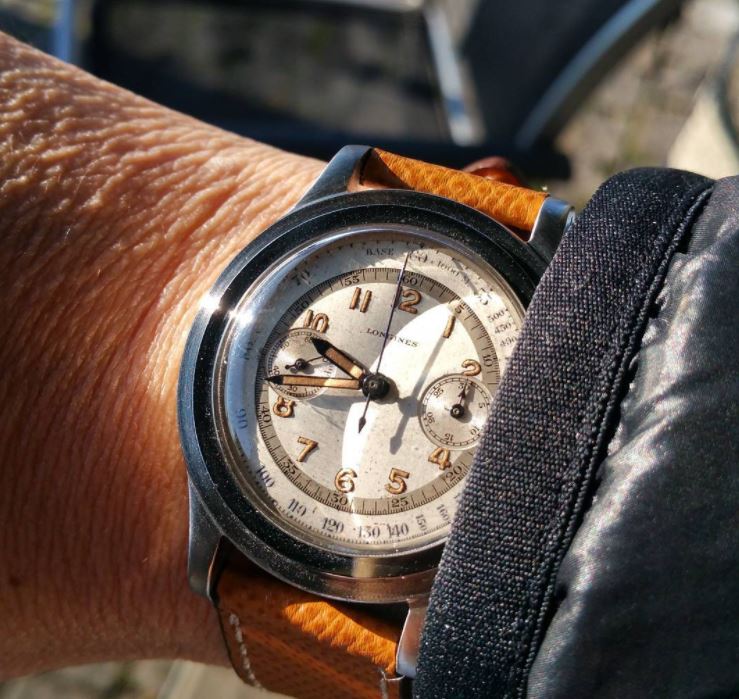

First Longines sold for 6500$ plus premium. Should be around 8000$.
2,829
4,948

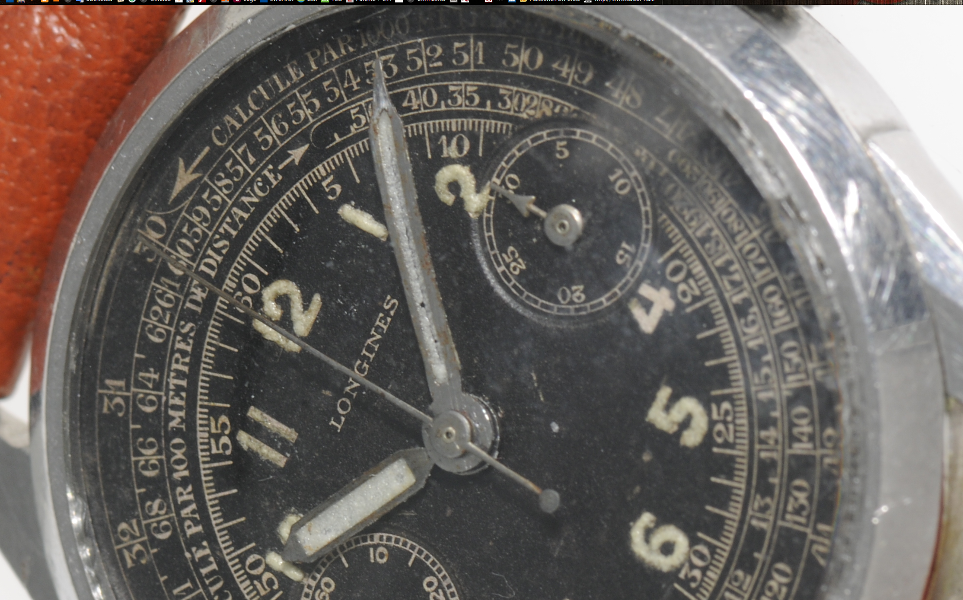

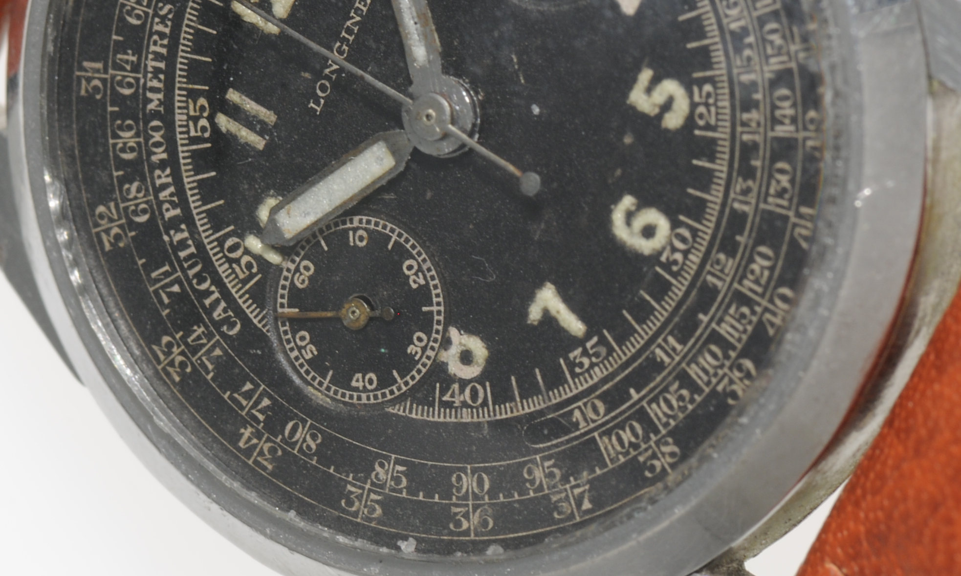

Lume does not look original, nor does the minute hand. Not sure about the hour hand. The mismatched sub-dials have me puzzled. Below is another example of the phenomenon. Given the style and execution of the dial, I am leaning towards original. An unusual, early 13ZN.
590
1,225
Thanks. Crott claimed that the subdial was original. Without seeing it in person I was skeptical.
