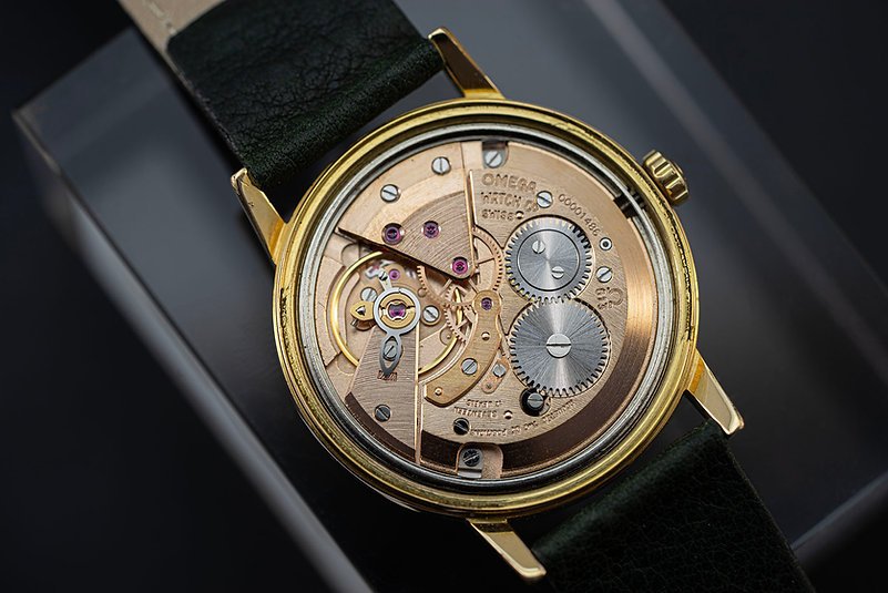

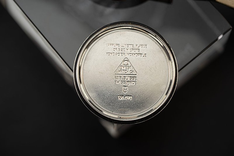

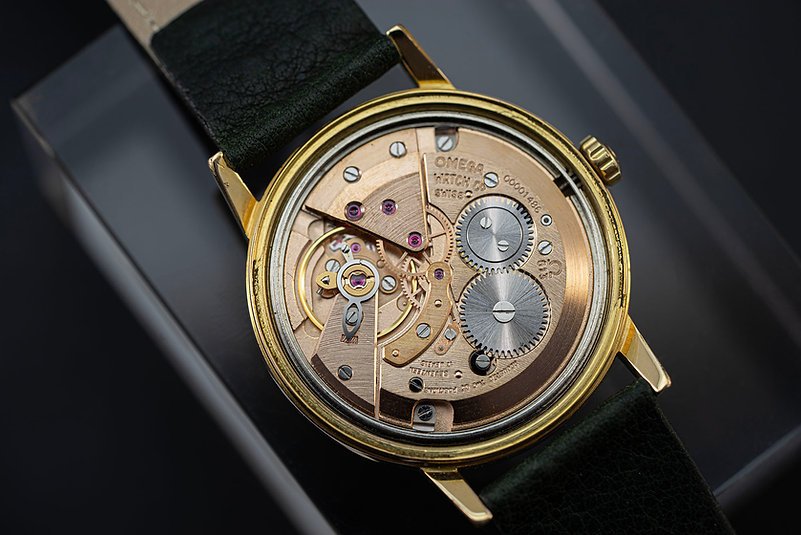

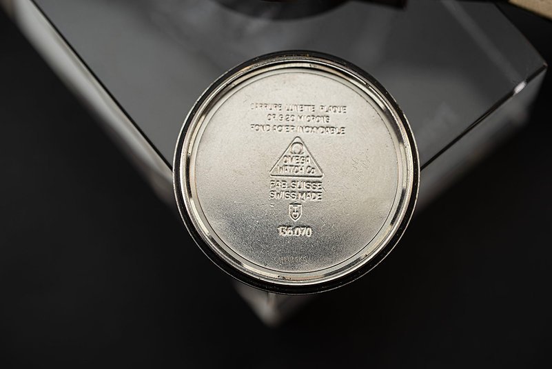

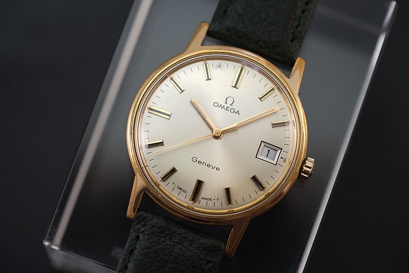

Hello,
I recently purchased an Omega Geneve from what I believed to be a reputable watch store, www.vintagewatchstudio.com. Upon inspecting the serial number of the watch, I discovered that it reads "00001486." From what I understand, Omega serial numbers typically do not begin with zero. Does this suggest that the watch is counterfeit, or could it indicate that it has undergone servicing and received new parts? I find the watch to be exceptionally beautiful, and I'm puzzled as to why someone would go to such lengths to create a replica and engrave such a significantly deviant serial number. I would greatly appreciate any assistance in resolving this matter. I have attached some images of the watch.
Best regards,
Martin
13,492
31,811
Since the main plate on this caliber contains the serial number it would appear to simply be a service replacement. Nothing to be concerned about.
13
Hello and thank you very much for the quick response! I've recently taken an interest in watches and placed an order for this Omega watch earlier today. Therefore, I only have the pictures to rely on. Am I correct in understanding that there is another serial number engraved somewhere on the main plate? Is it challenging to access? I'm curious about the year of manufacture, so it would be fascinating to see the actual serial number. 😀

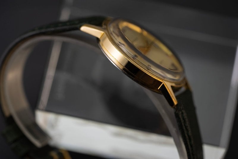

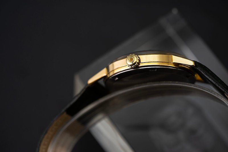

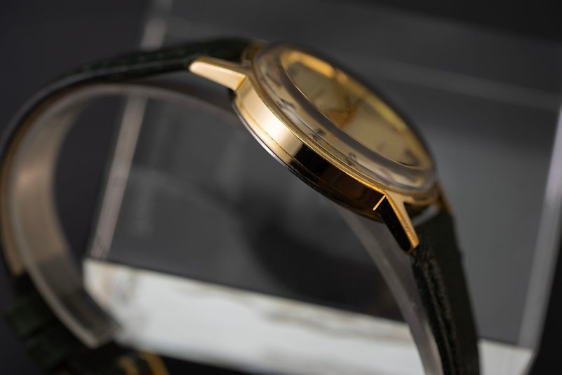

If you can cancel the purchase I would highly suggest doing so. The watch case is in really poor condition with significant wear clearly evident on the lugs and edges of the case.
There is no second serial number.

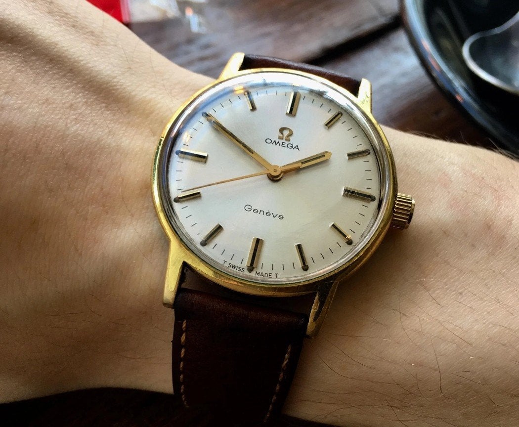

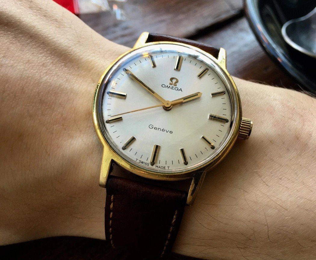

I've just graduated and I would like to buy a nice Omega watch in gold, similar to the one in the attached image.
However, I don't have a lot of money to spare at the moment, so I thought €525 was a fairly reasonable price for a watch with some marks. Do you think there are better options within the same price range? I could consider adding €100-€200 more, but then my first paycheck will be gone unfortunately.

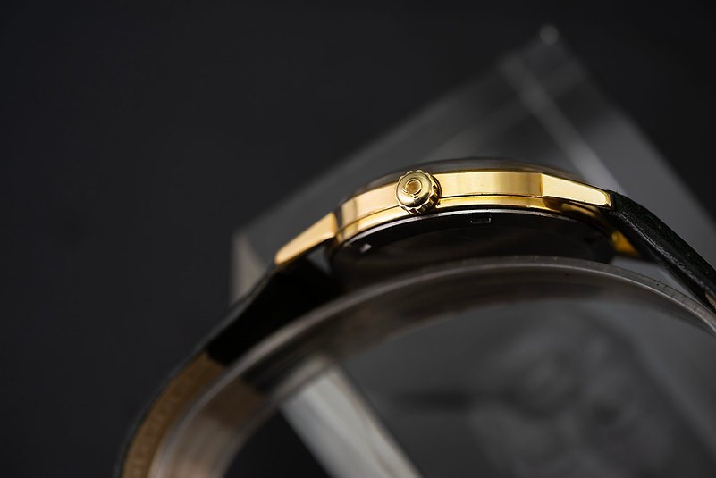

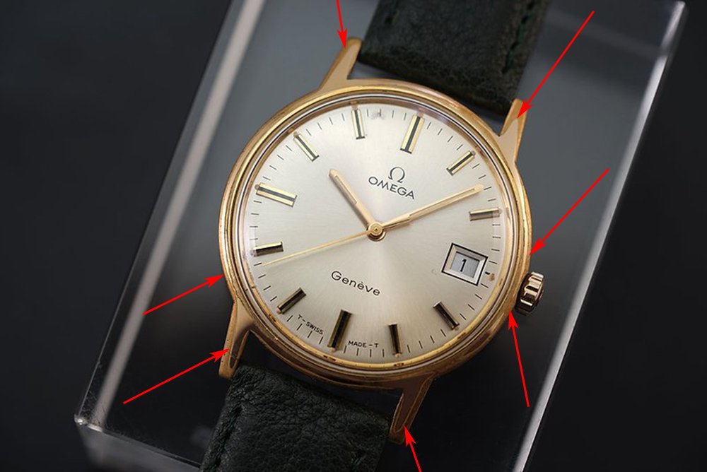

So here is what we were seeing. The arrows indicate the contrasting toning of the gold, the darker parts on the edges show where the gold plating has been completely worn and or polished away leaving the brass base metal of the case exposed. This will only get worse with time.
As others have noted with a little patience and guidance one doesn't need to compromise on a starter watch.
It's easy to get excited and jump in head first, we've all been there, glad you've decided against this one.
Did I say be patient?
Good luck on your hunt, you've come to the best place on the net to learn, enjoy the journey.

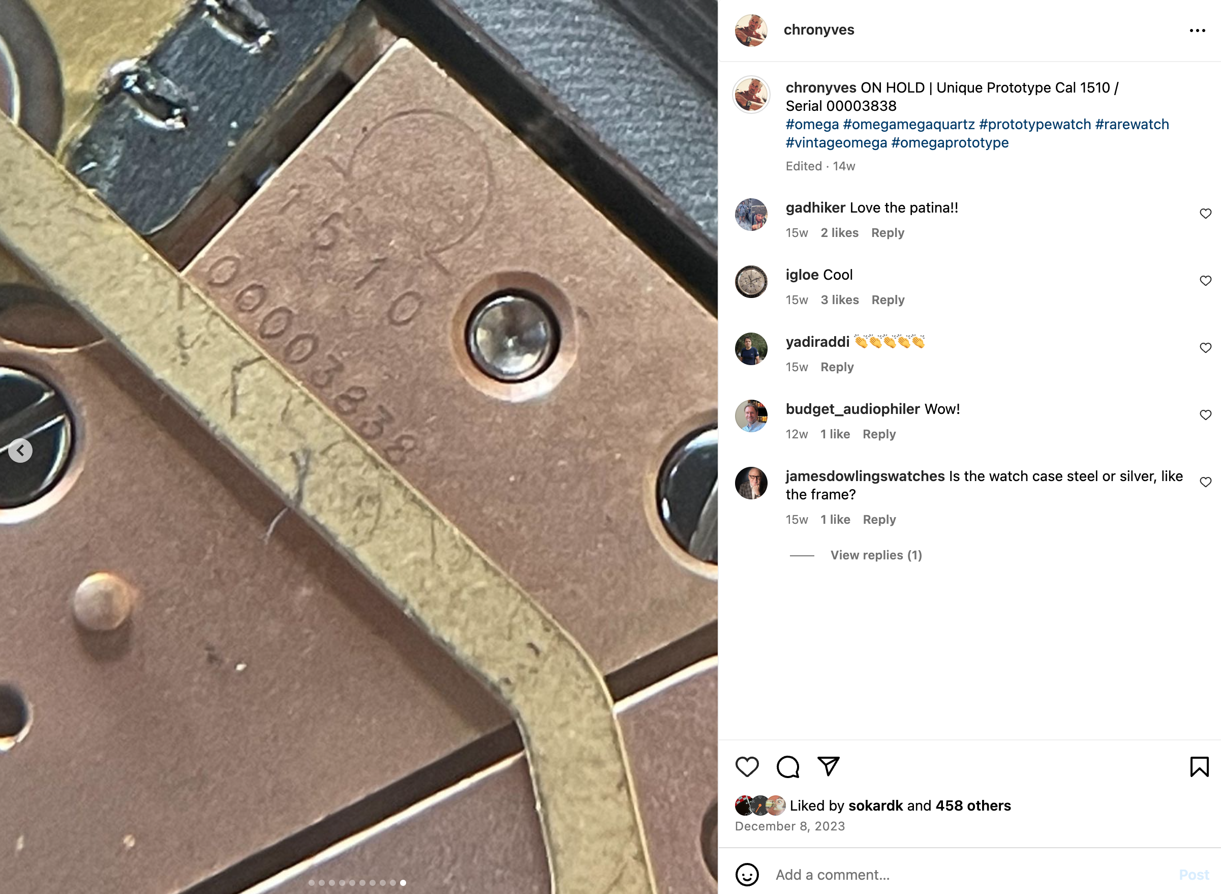

I personally think absurd serials increase value, prototypes and special watches have special serials as well, but this doesn't look any special
This is a 550 series family movement, the 550 series service bridges have R01231 like serials (as far as I observed) - I wonder why this 613 didn't follow the same format

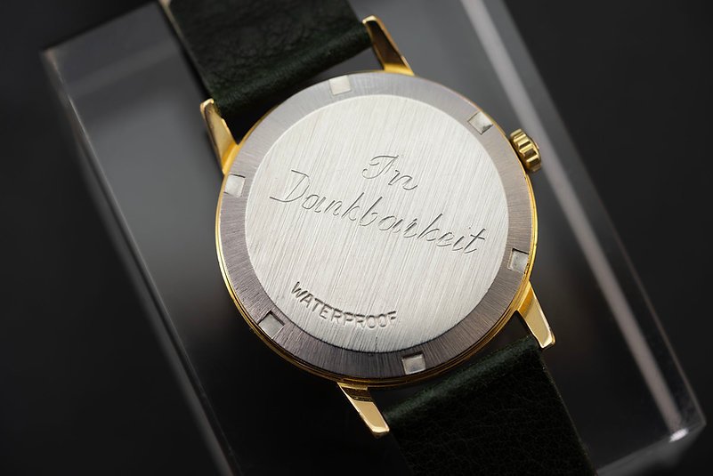

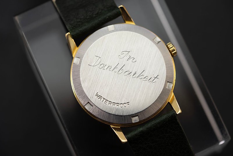

What does the inscription say?

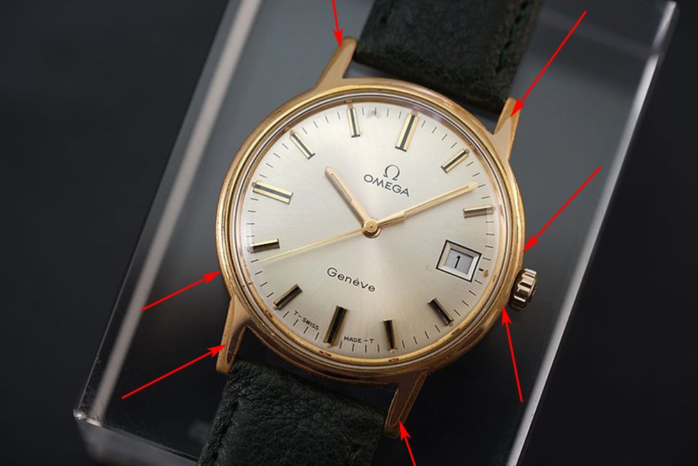

Yes, it's quite interesting. The inscription is German for 'in gratitude,' I believe.

Perhaps we can get @Archer to chime in on the serial number on OPs watch?
30,274
78,128
Typically replacement movements of this era have the R prefix to the serial number. I’ve not seen any information related to serial numbers starting with zeros...
