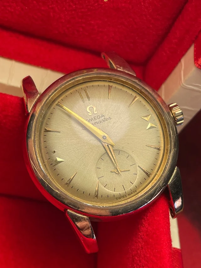

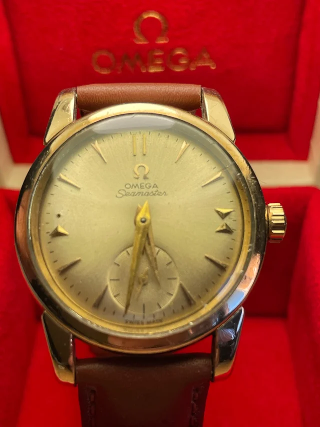

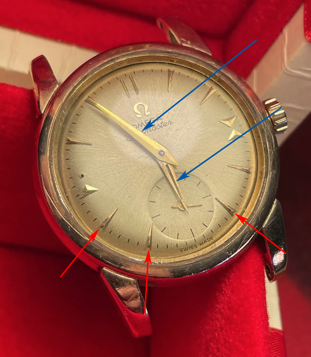

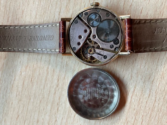

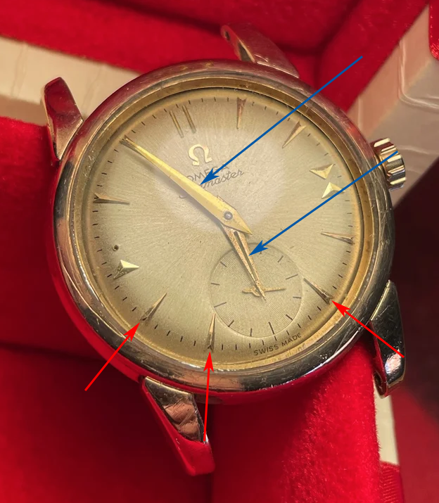

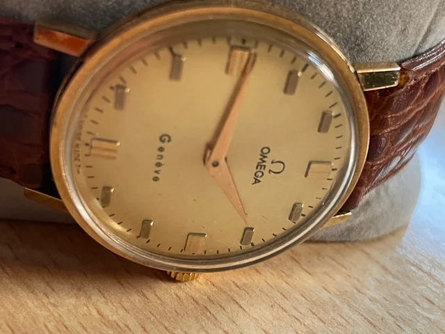

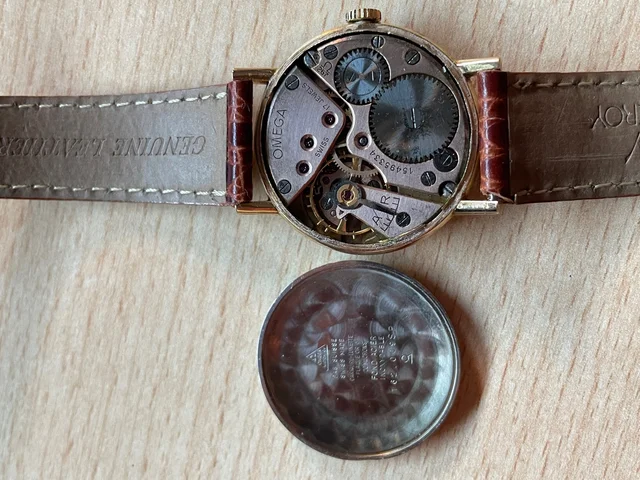

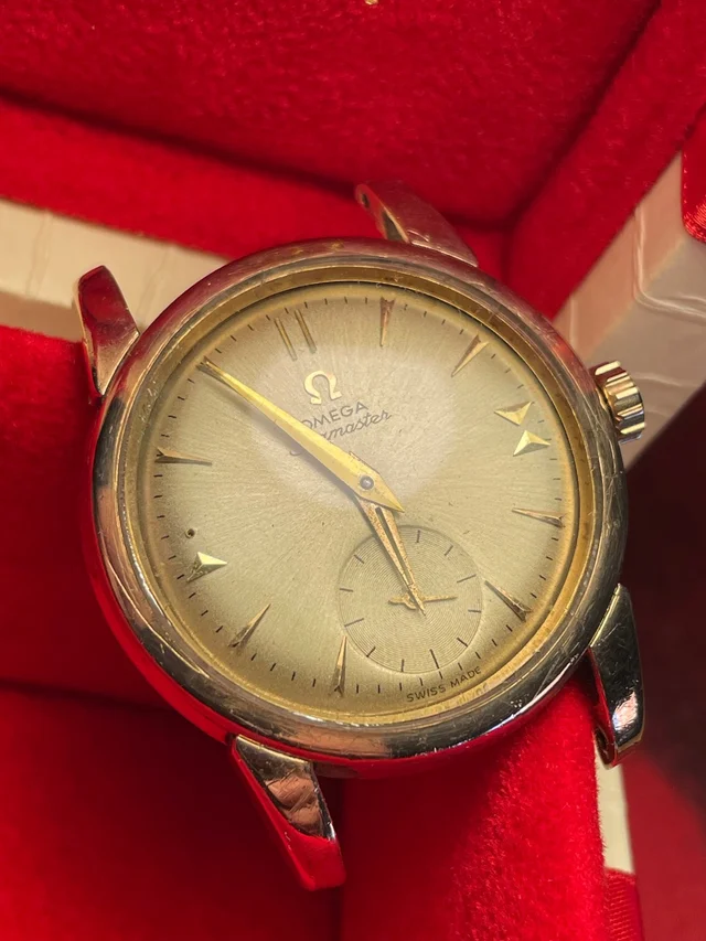

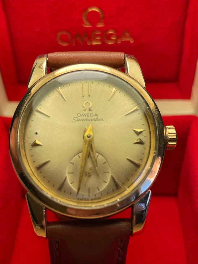

J Posts 4 Likes 1 javolimor ·Dec 8, 2023 Hi everything nice to be here. I need help with my two watches, are them real or fake? I can't find the model of them. Seamaster: Geneve: Thanks and best regards. i3450457768.jpeg - 76.7 KB i3450457777.jpeg - 65.6 KB i3450457678.jpeg - 42.4 KB i4629949359.jpeg - 119.1 KB i4629949336.jpeg - 37.6 KB i4629949350.jpeg - 66.2 KB i4629949302.jpeg - 41.1 KB

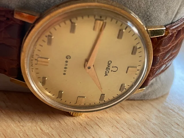

Posts 3,595 Likes 13,551 MtV ·Dec 8, 2023 Both are "real". However, both are also redials in pretty poor shape. Stay away.

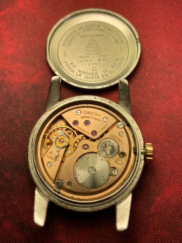

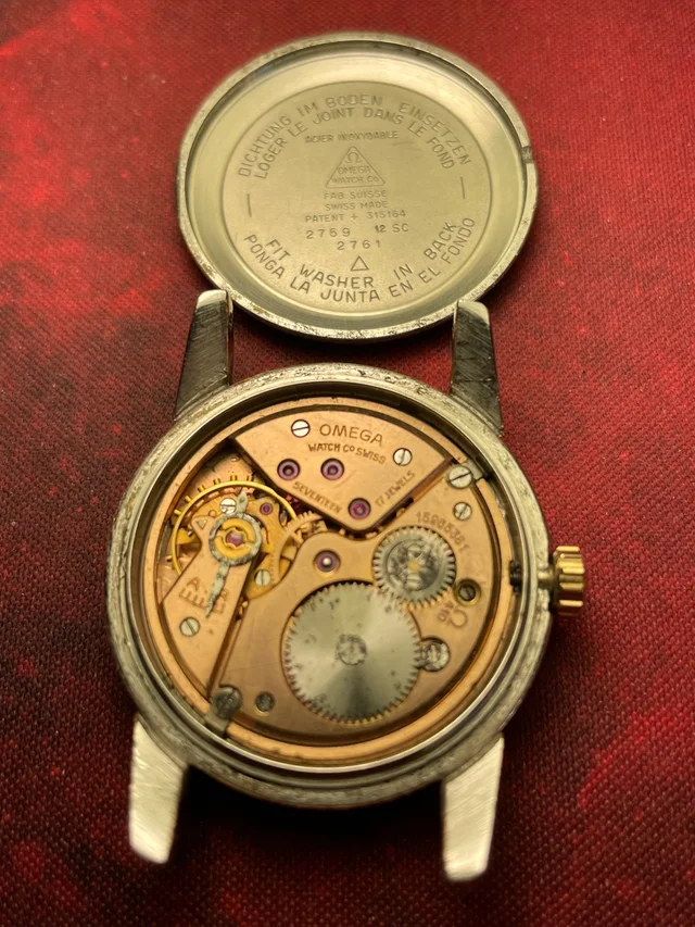

Posts 10,804 Likes 16,814 padders ·Dec 8, 2023·Oooo subtitles! I’m not sure the Seamaster is a redial but the dial is a mess with missing and incorrect markers. The Geneve is just a mess with a repainted dial, mid 50s movement yet 60s tiny case. Here’s the info for the the Seamaster https://www.omegawatches.com/en-gb/watch-omega-seamaster-omega-ck-2759 Edited: Dec 8, 2023
J Posts 4 Likes 1 javolimor ·Dec 8, 2023 Thanks for the answer, I am new in Omega's world, I was thinking that the seamaster is beautiful.
Posts 3,595 Likes 13,551 MtV ·Dec 8, 2023 padders I’m not sure the Seamaster is a redial Sunburst dial on a mid-50s 2759 isn't a thing I'd say. Plus the sunburst structure looks too rough.
Posts 10,804 Likes 16,814 padders ·Dec 8, 2023·Oooo subtitles! MtV Sunburst dial on a mid-50s 2759 isn't a thing I'd say. Plus the sunburst structure looks too rough. Fair enough. It’s a hot mess whatever, markers and second hand are wrong. Look at the applied logo feet! Both are put together I reckon.
Posts 13,492 Likes 31,811 X350 XJR ·Dec 8, 2023·Vintage Omega Aficionado padders I’m not sure the Seamaster is a redial Missing lume pliots. And mismatched hands as well. As others have noted they're both a mess.
