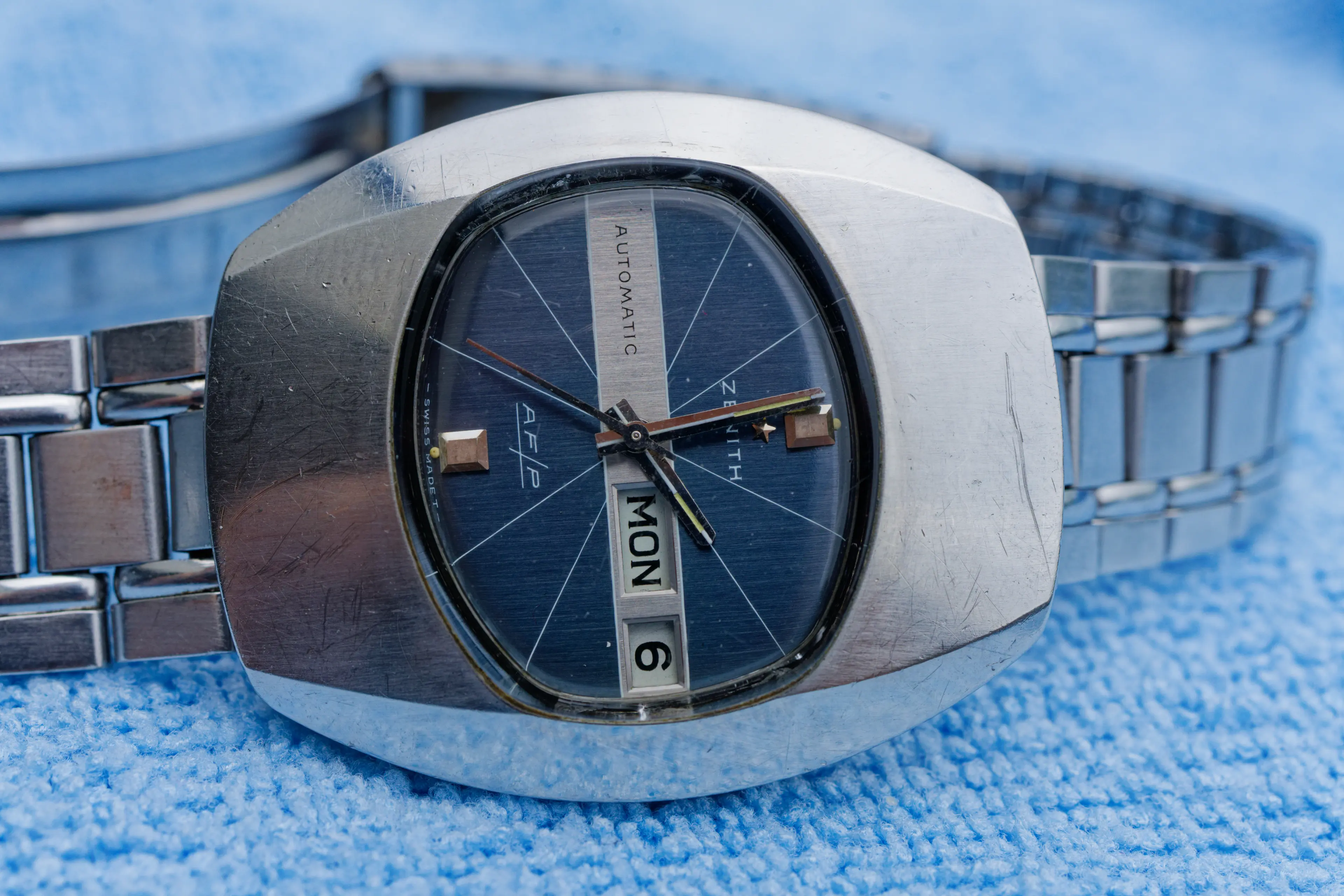

I've assumed that AF/P (Alta frequenza & precisione) on Zenith dials is similar to 28800 which Zenith used to indicate movement, or rather it's vph. And thus AF/P would indicate Zenith Cal. 405 (day,date) or 408 (date) 36000vph hi-beat movement which Zenith sourced from Movado, and potentially a more expensive version of the watch model.
I recently had a conversation with an another watch enthusiast where his thinking was that AF/P is it's own model or sub brand. And certainly when you google for 'Zenith AF/P', very few Defy AF/P's or Respirator AF/P's or Captain AF/P's come up. And thankfully no Surf AF/P's. 😅 Indeed, there are several posts on OF that use AF/P in a 'model-like' fashion.
I wanted to put this out here for people with more knowledge in this matter to weigh in. Is AF/P a model variant, or it's own model? Or can both be true at the same time?

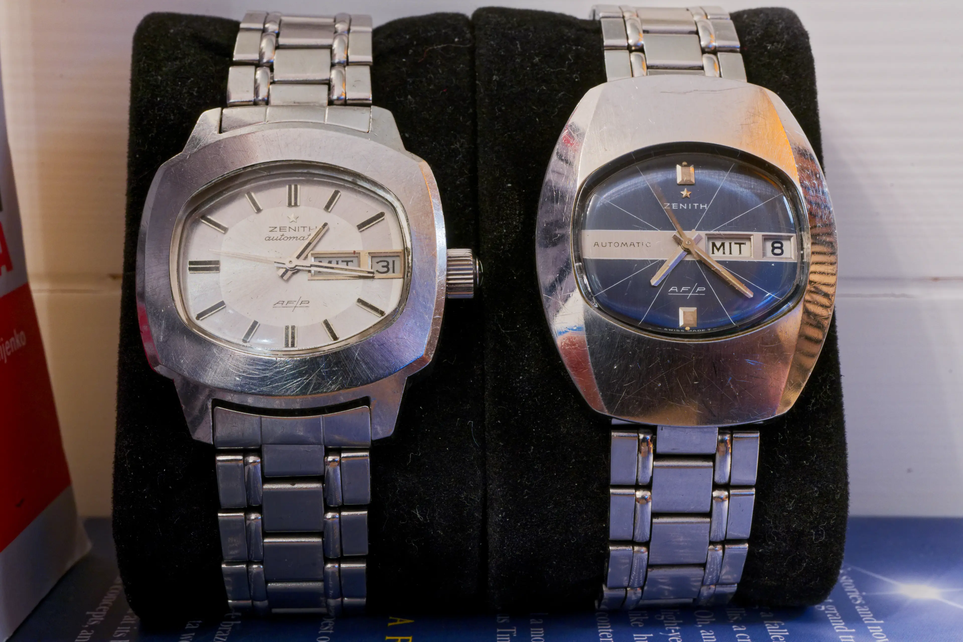

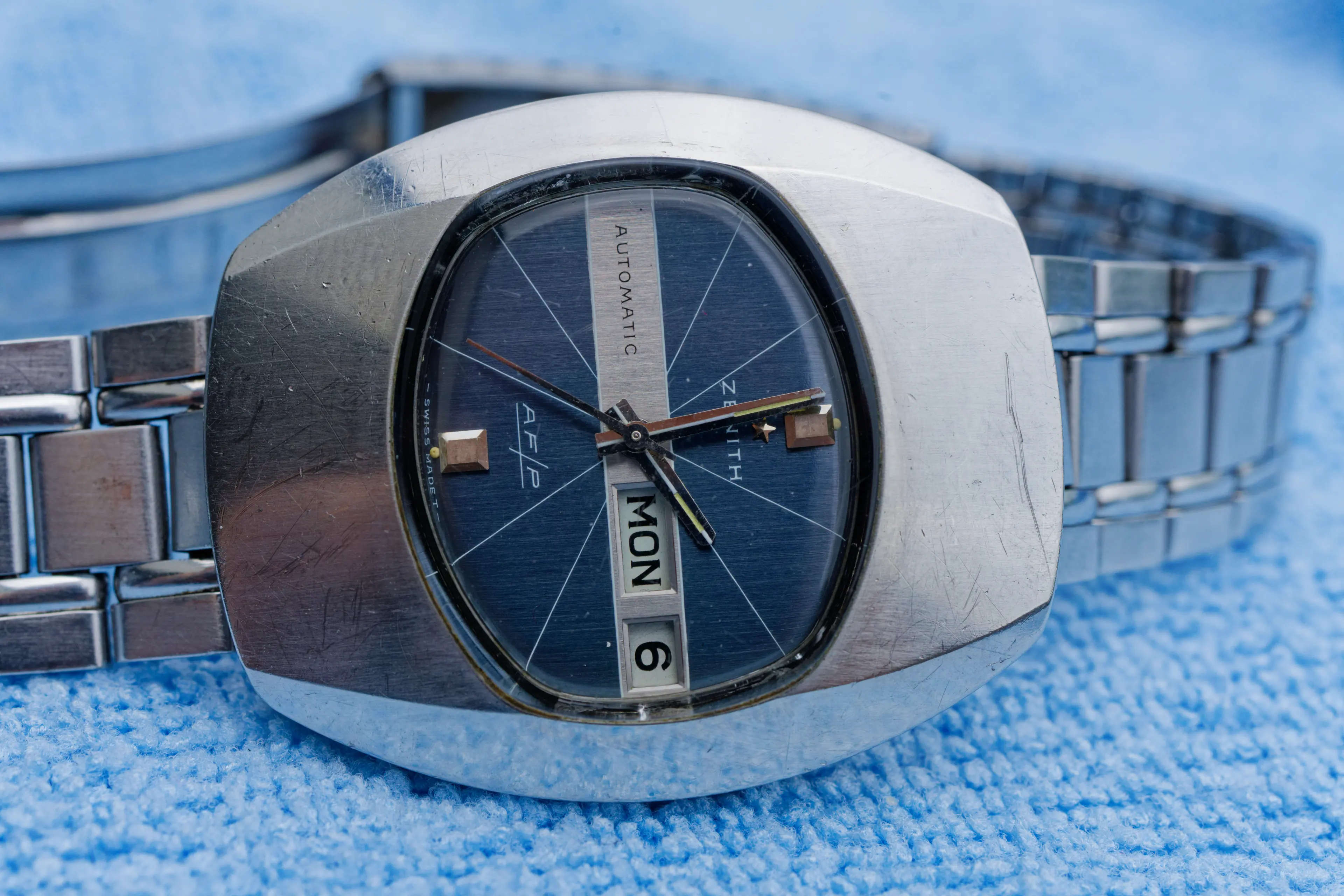

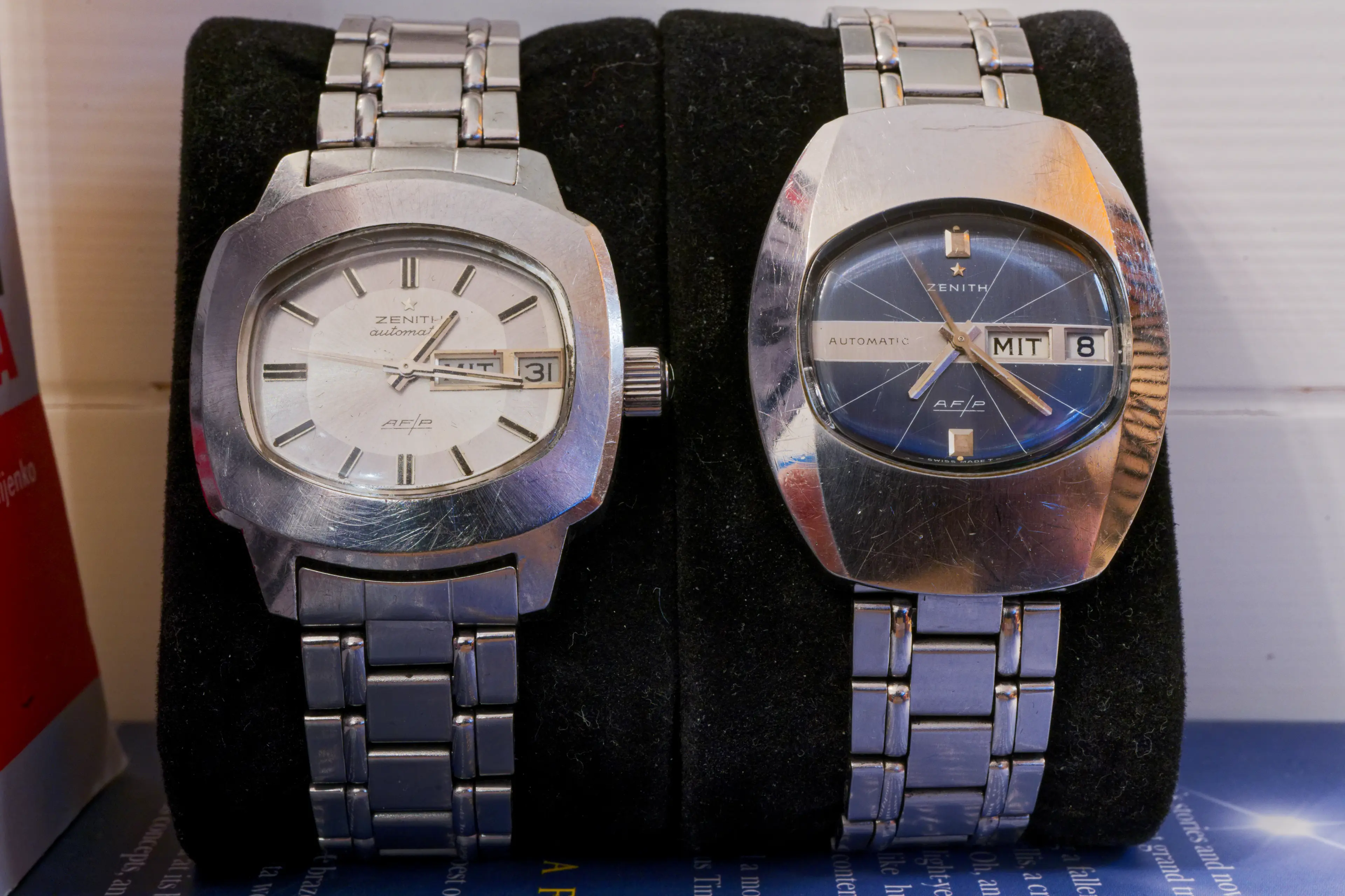

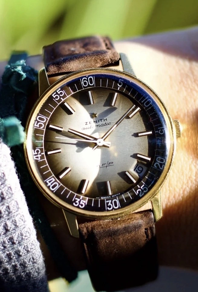

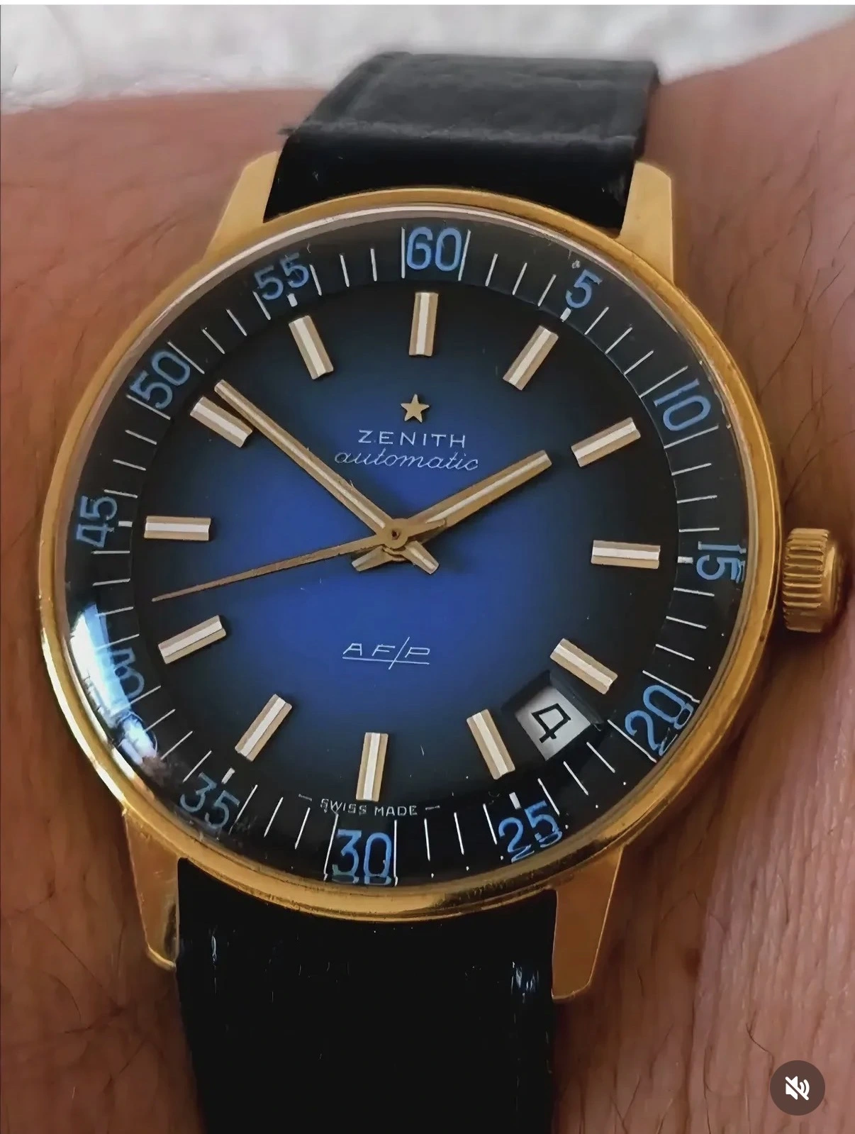

Below is an image of a pair of (in my opinion) Defy TV AF/P (A792) and Spaceman AF/P (A791) watches that got this conversation started. I'll follow with links to forum posts and such where AF/P's have been mentioned to collect various 'sightings' etc. in one thread.
Image from [1] that is occasionally seen on forums showing Defy Spaceman and Defy TV next to their AF/P cousins (that are listed for a slightly higher price tag). I suspect having seen this image at some point set my mind to think that AF/P is a variant of the 'base' model.

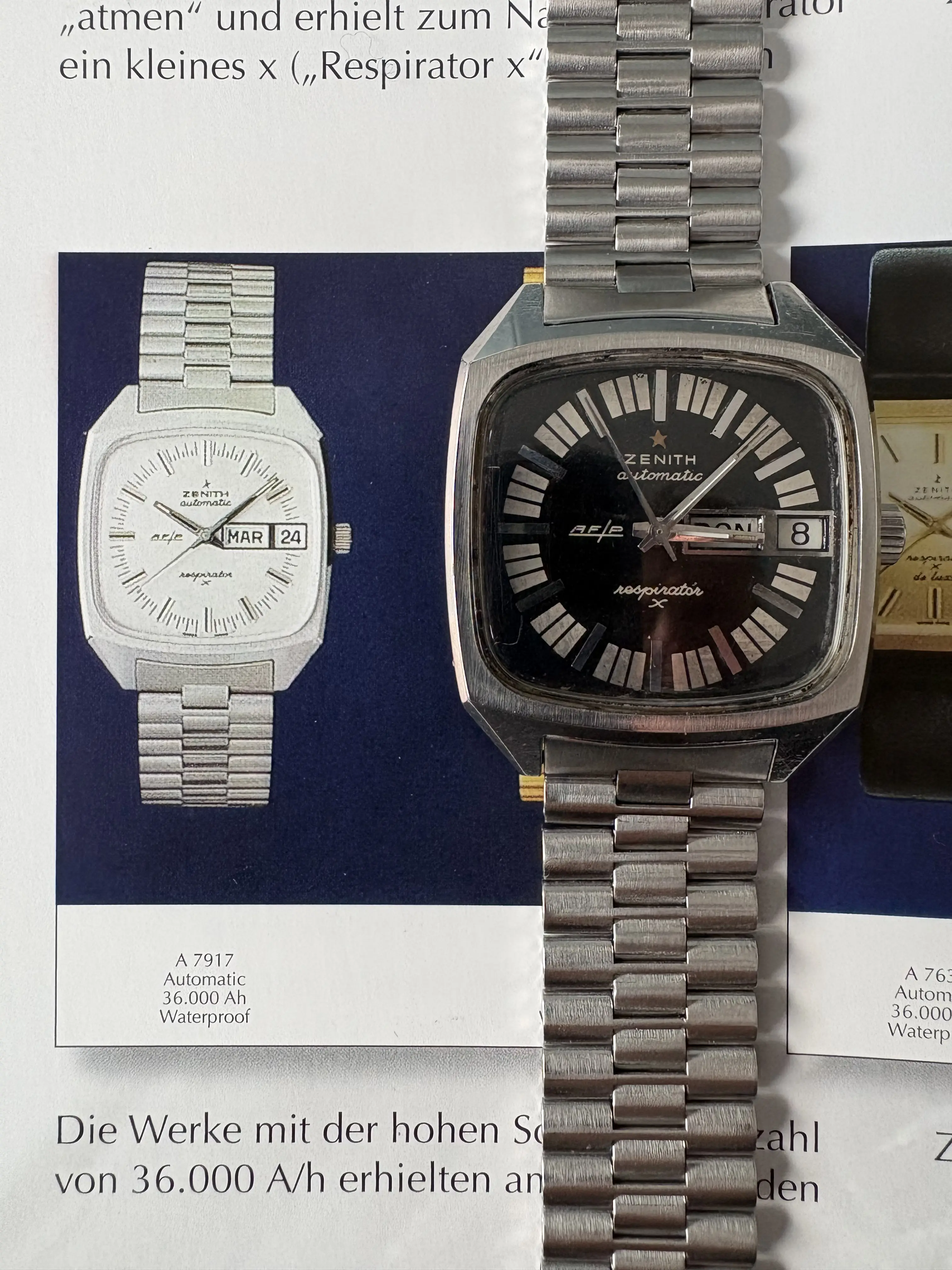

Local library has a copy of Rössler's Zenith book and although I can't say for certain, I think AF/P is only mentioned on two pages in the context of 'Herrenarmbanduhr Modell Respirator AF/P' [German edition, pages 148-149, ISBN 3871881031]. Books caliber list also lists 405 and 408 movements, which also indicates cal 405 and 408 were manufactured only between 1969-1971. If this is correct, then I would assume that all AF/P Zenith watches would be from around this period, plus maybe a year or two. This relative short period would appear to somewhat limit models that were produced and available with cal. 405 or 408.

I am proposing that there will be a rather finite number of different kinds of Zenith AF/P watches and it would be fun to collect them in one place. I'll start and post (better) photos of the two I've got shortly.
