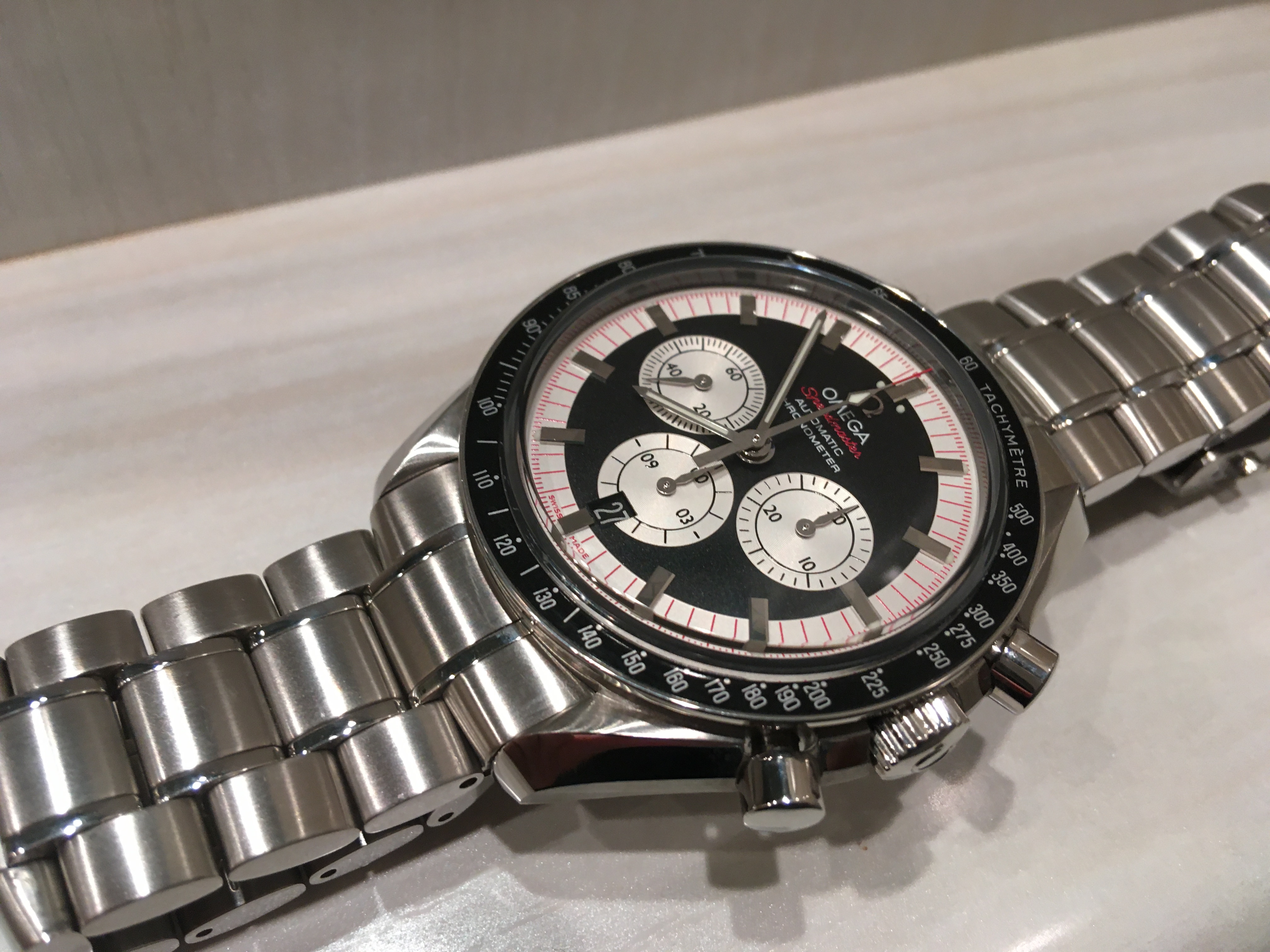

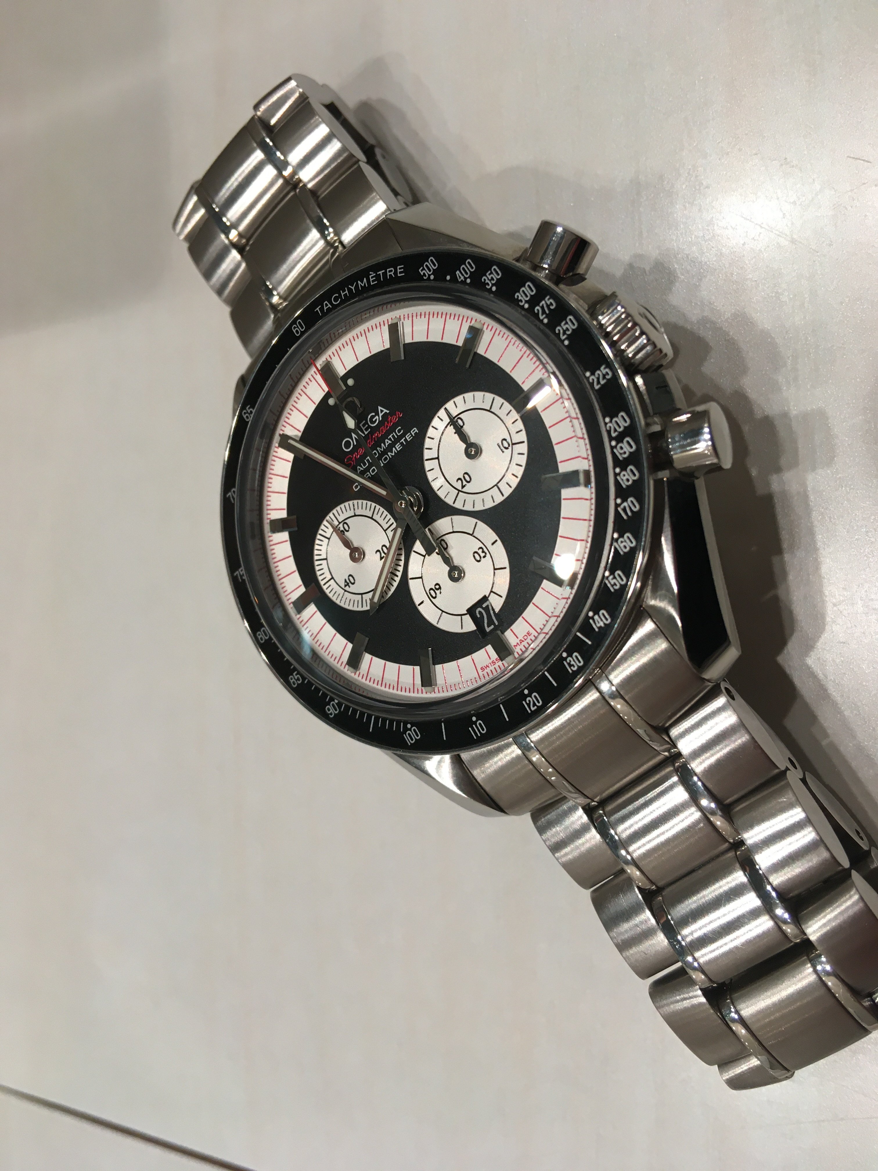

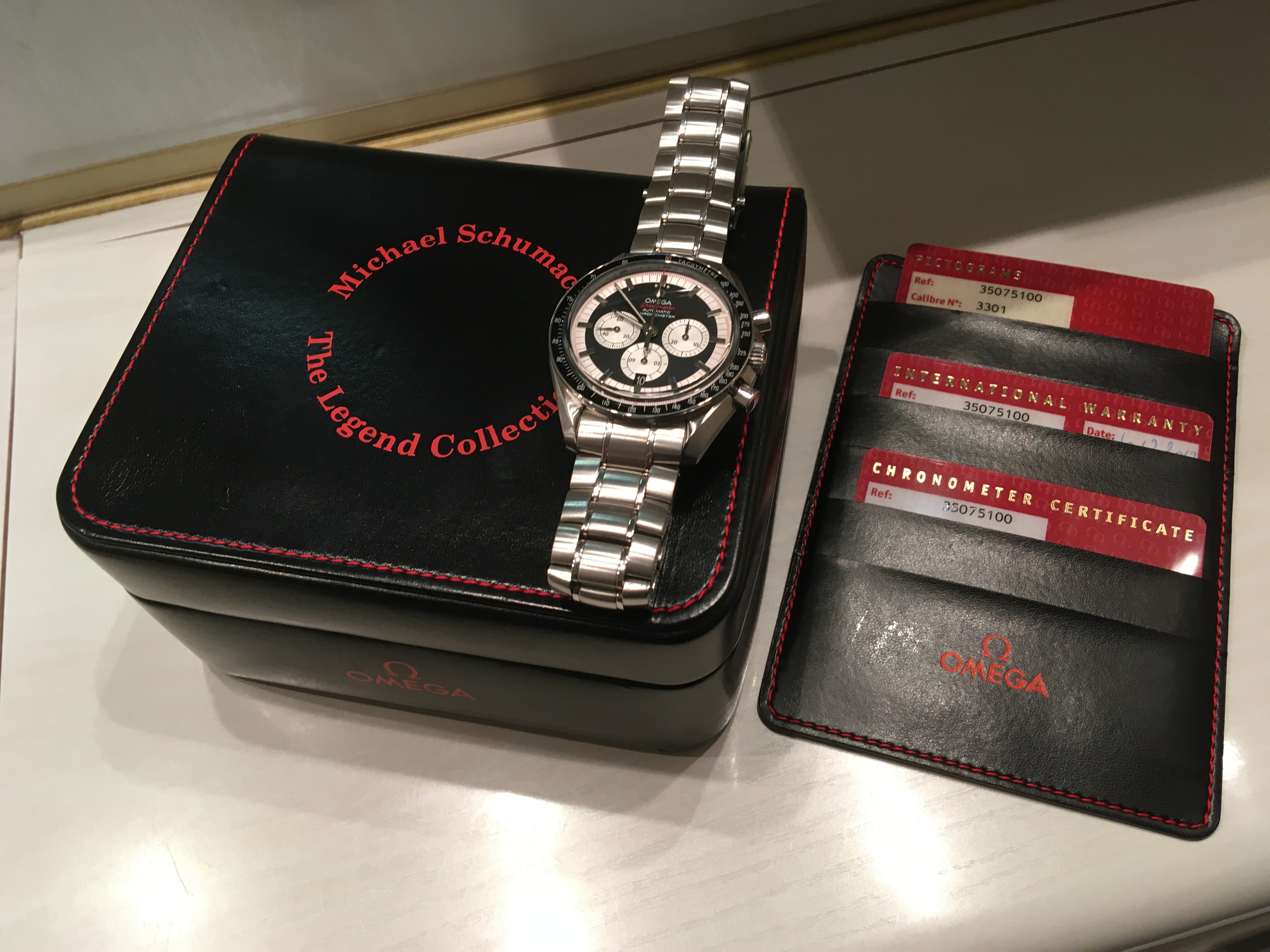

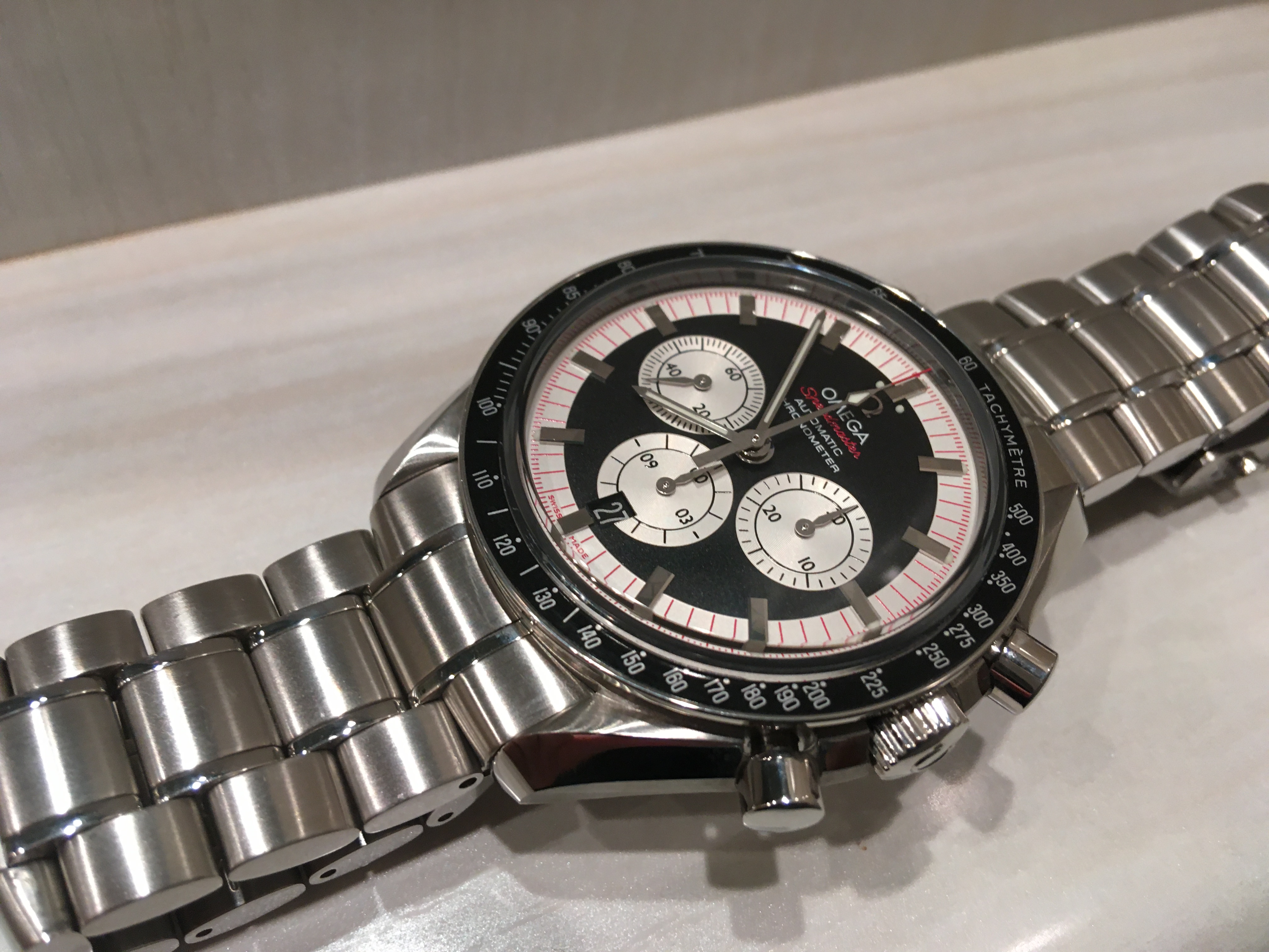

Your thoughts on Speedmaster The legend Schumacher Edition
453
605
I think it's a super looking watch, especially the first one you posted. Now you've heard from a certified Omega expert on how dependable the movement is, what's holding you up. Beautiful watch.
903
1,085
I like the first one. It looks great with the bracelet that it's on. The red is a bit too much.
1,530
3,595

Thanks for taking the time to post the info. on the movement.

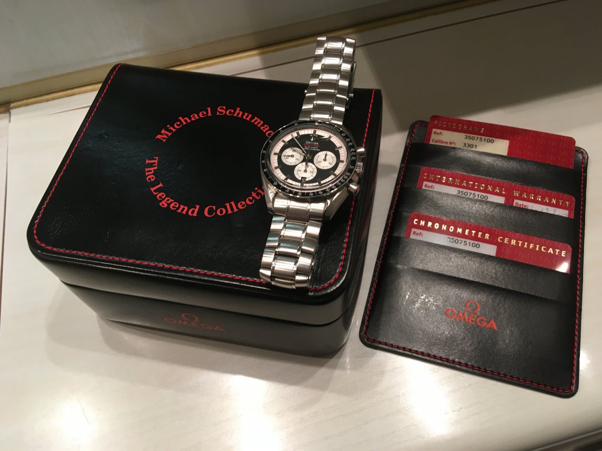

For some reason I was convinced the two watches the AD had were the red version and the cream version, but that was 5 months ago. Anyway fast forward to today and things were slightly different from what I remembered, yes the red version was there and the other one was purchased after a small negotiation.
1,530
3,595
It certainly was good info. the watch came with a two year international Omega warranty so if anything does go wrong I can always send to Omega to have it repaired.
453
605
SWEET! Very nice Christmas present to yourself. I like the black bezel a little better than the shiny bezel, it's easier to read.

Speedmasters and cars.... Manual or nothing.
I know many will feel that way, but I have owned that watch before but was fairly underwhelmed by it.
903
1,085
Nice catch there Mom, congrats!
And @STANDY, I missed your earlier post, but partly agree with you on that - always manual when possible on my cars. Problem is, it's getting tougher and tougher to do, especially here in the states.
1,530
3,595

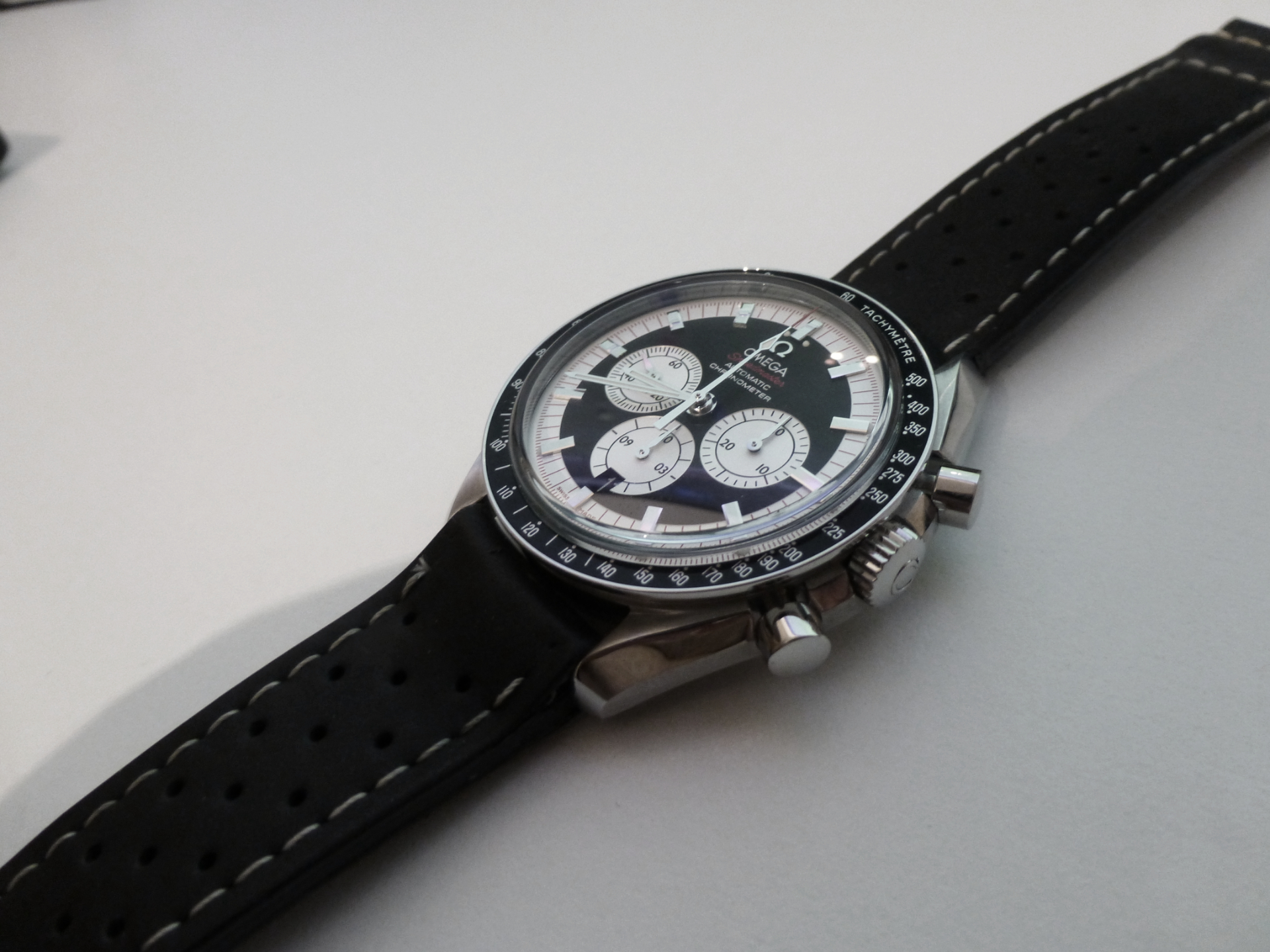

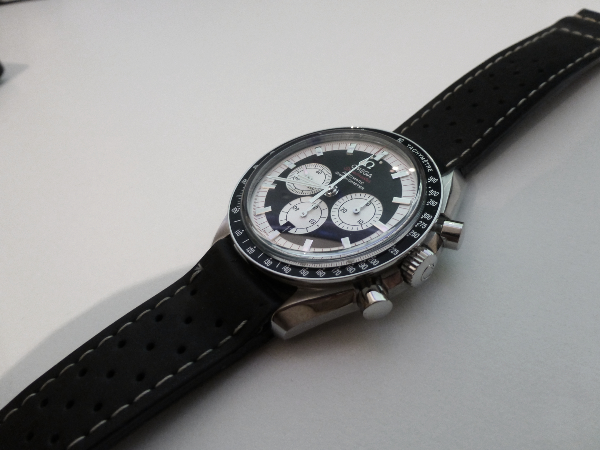

Is it brand new or second hand it looks stunning
The watch has been sitting in the AD for several years unsold, so it is new old stock, but the important thing it came with the paperwork stamped yesterday, so I believe that Omega should stand by the warranty if I ever need it.
Also, I tried it on a strap today and it looks good imo.

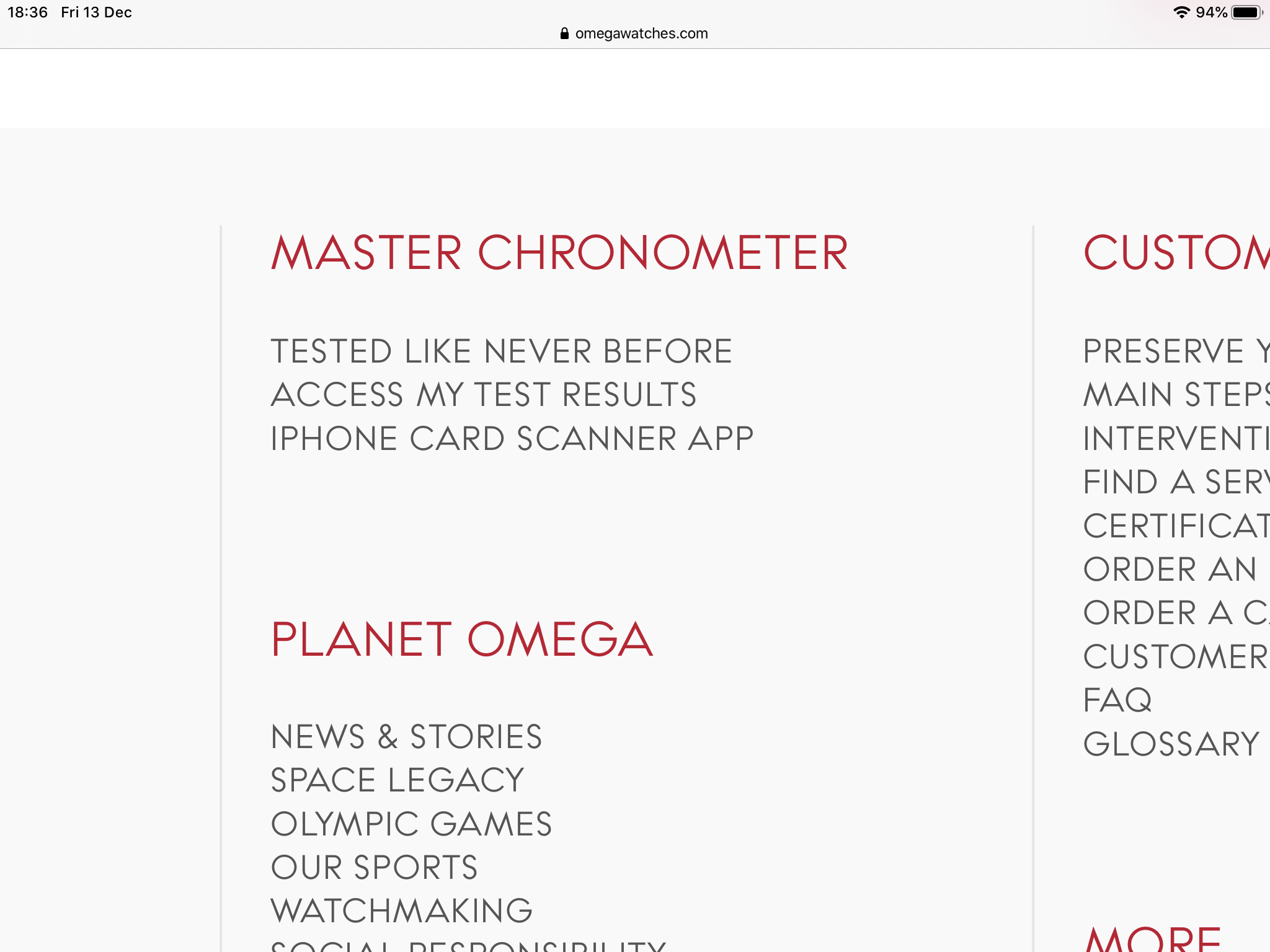

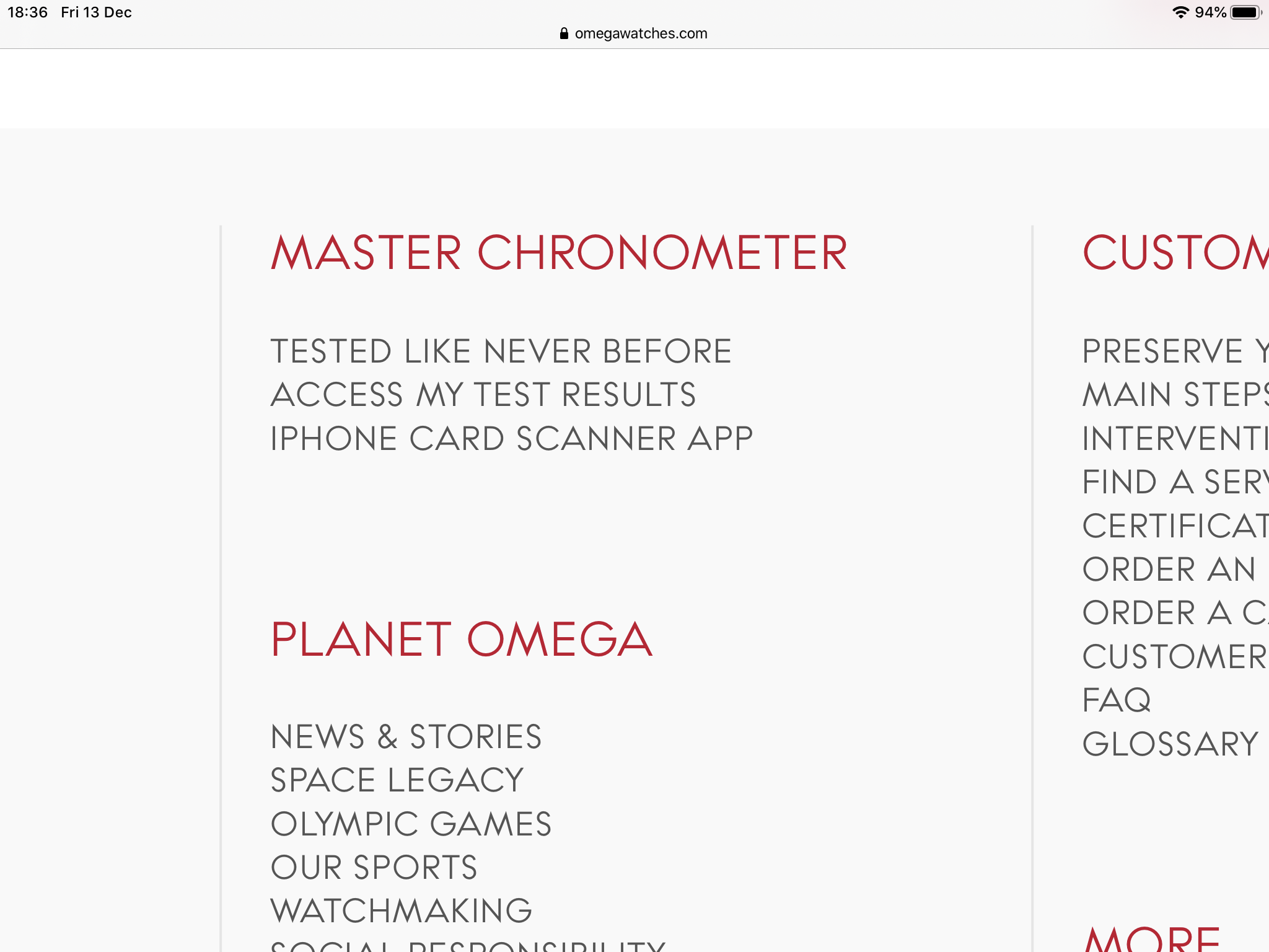

I've had a look on the Omega website today, but I couldn't see anywhere to register the watch, is this something you have seen before?
225
284
When I got my bond watch I could register on line and see the test results for the watch but I had to give name address etc
1,530
3,595
Perhaps they have changed this as I couldn't find anything about it on the official website.

I'm not sure if you have to register it to get that warranty. I recently bought a NOS Seamaster and was told it would be covered for the full 5 years because I had purchased it new from an AD after July 2018, even though the watch was built in late 2017. From the website:
GUARANTEED EXCELLENCE
OMEGA has continuously been able to raise the boundaries of watchmaking quality through revolutionary innovation. Only watches having successfully passed the most stringent quality control earn the right to reach your wrist.
Our quest for excellence has allowed us to extend the international warranty to 5 years, on all of our new timepieces purchased as of July 1st 2018.
