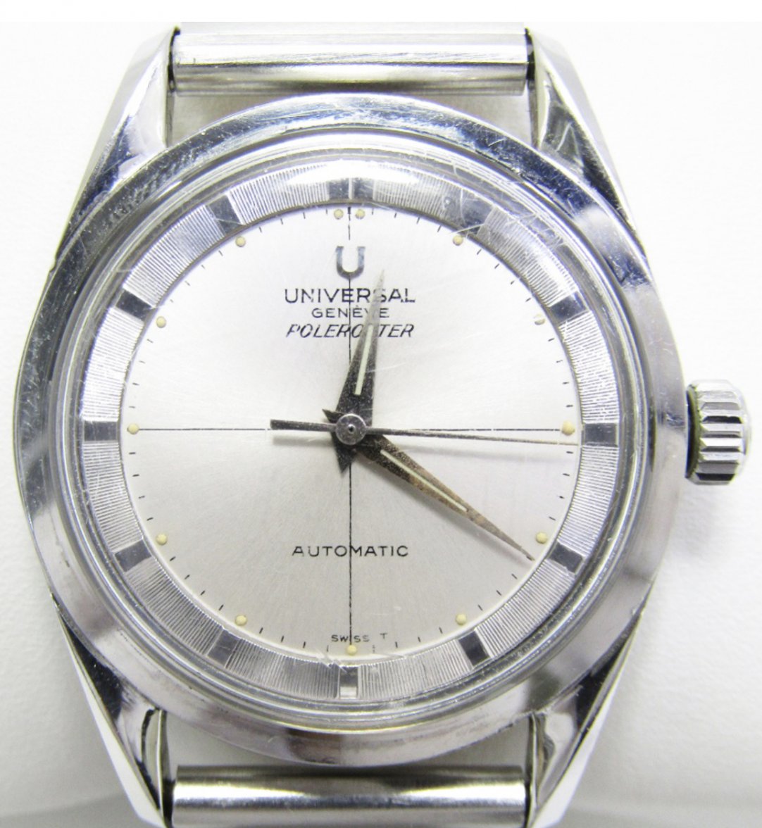

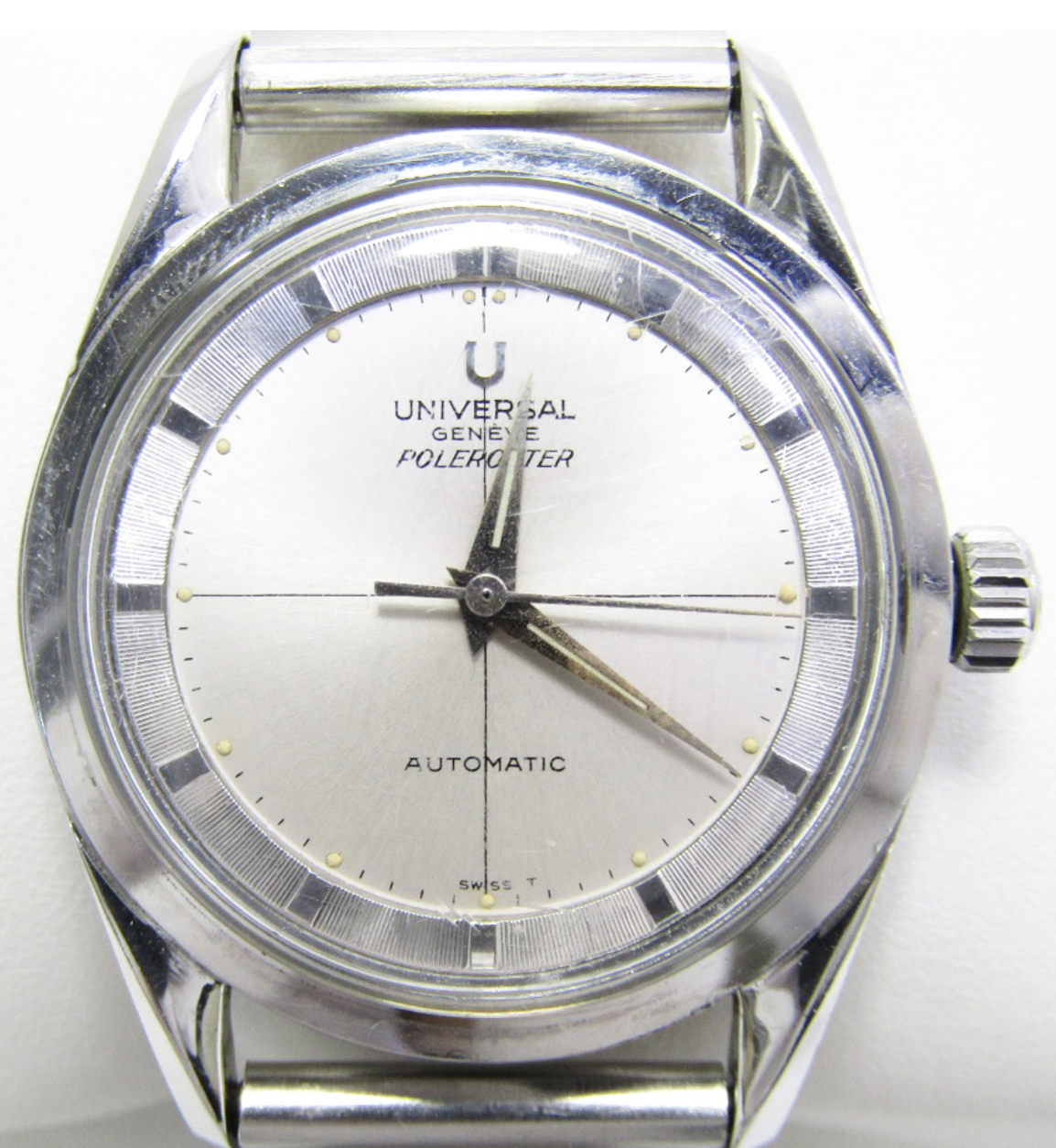

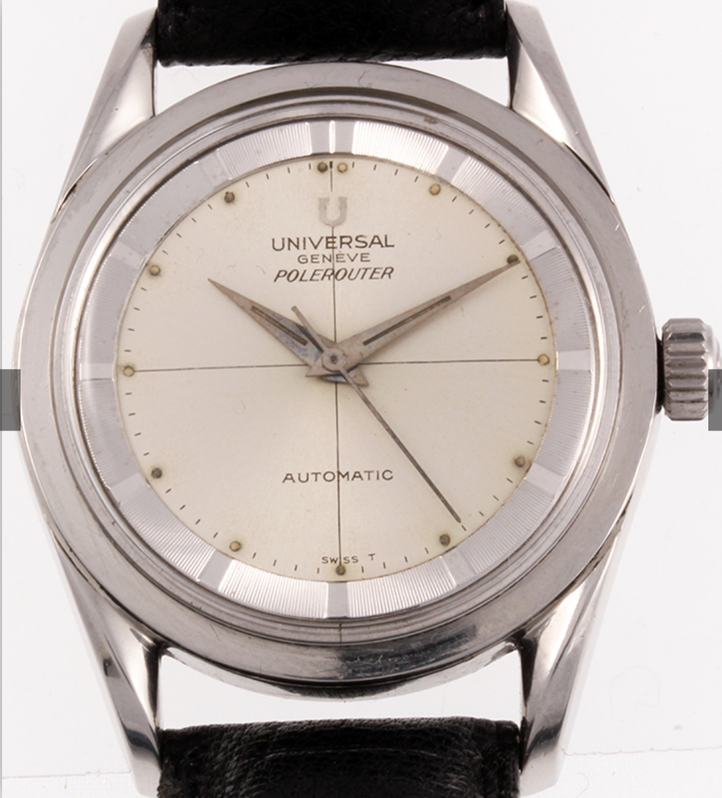

Hello,
I have come across a polerouter and wanted your insights about it 馃榾
Here it is :
It is a reference 868108/02 - 2325977

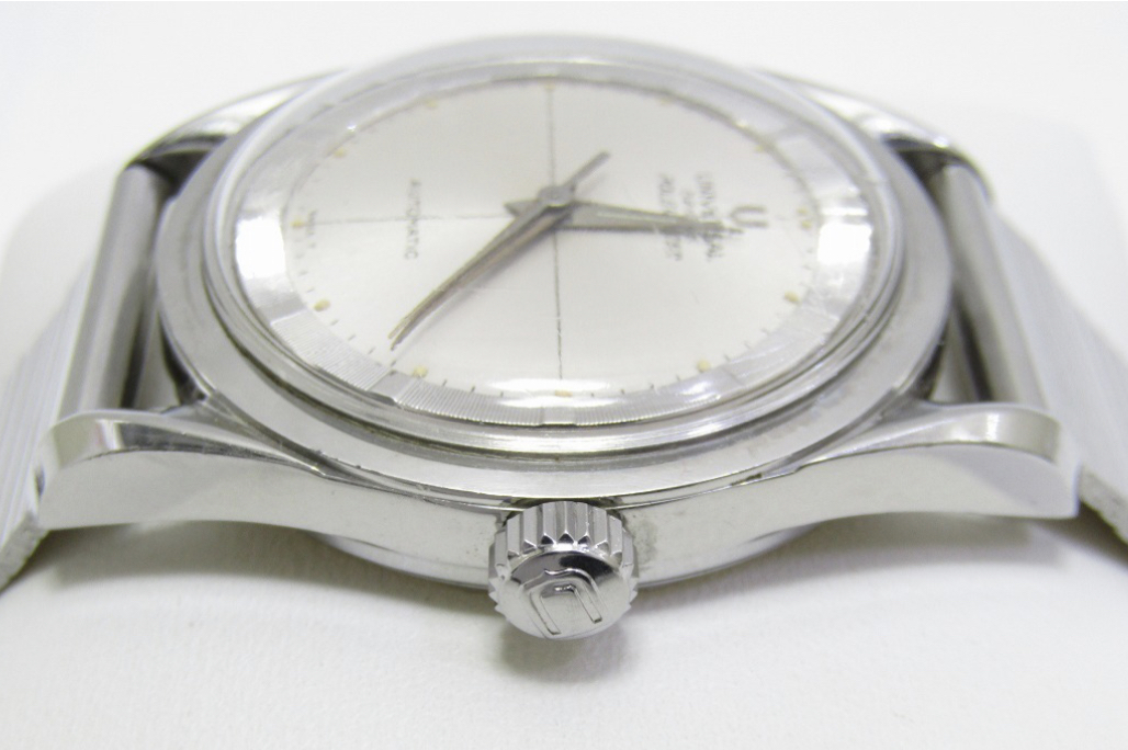

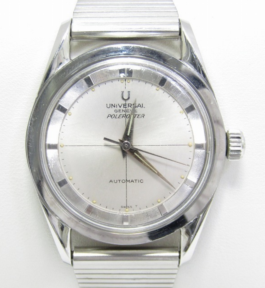

In my opinion the dial seems good, crystal is in bad shape, the crown is correct.

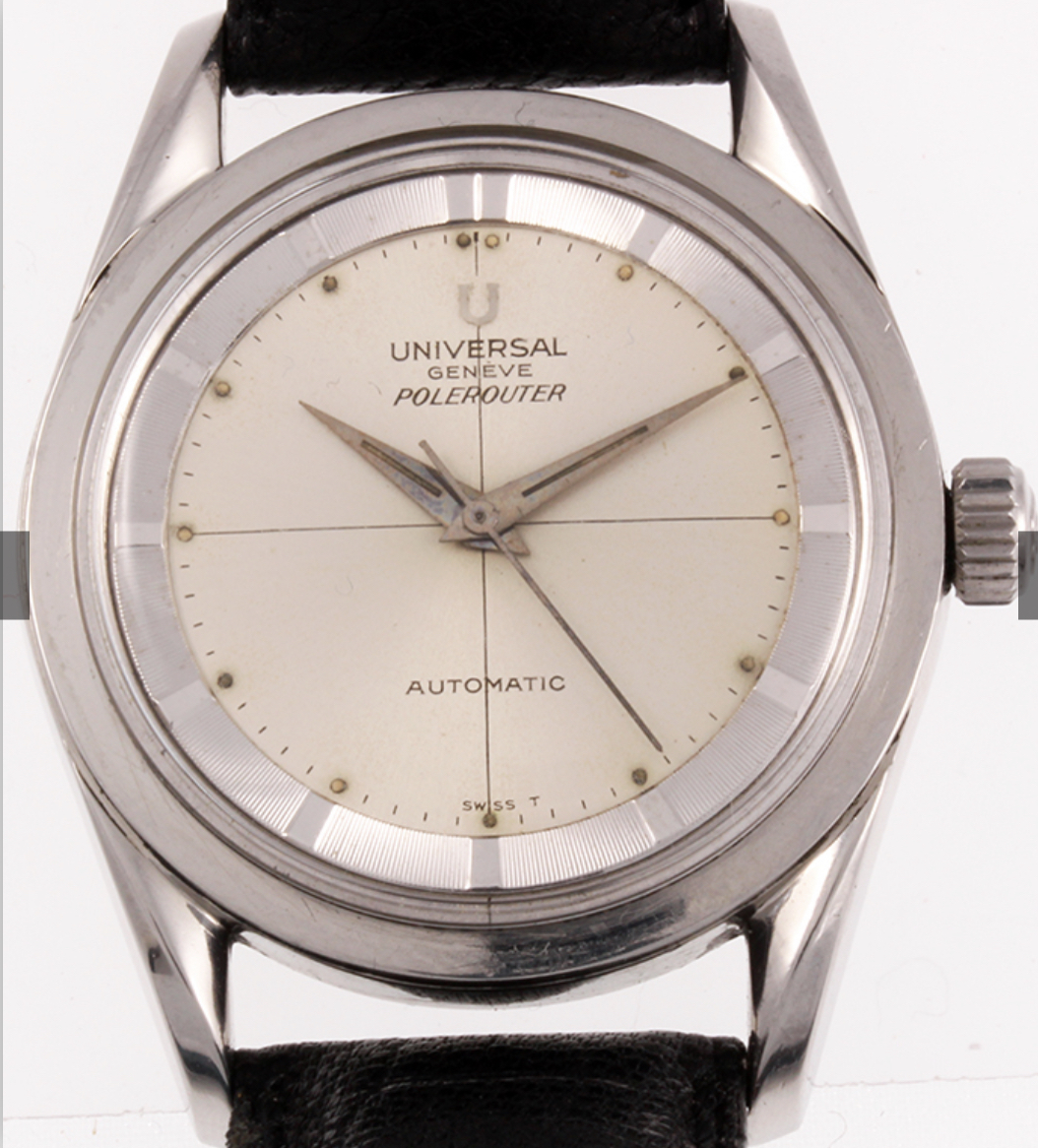

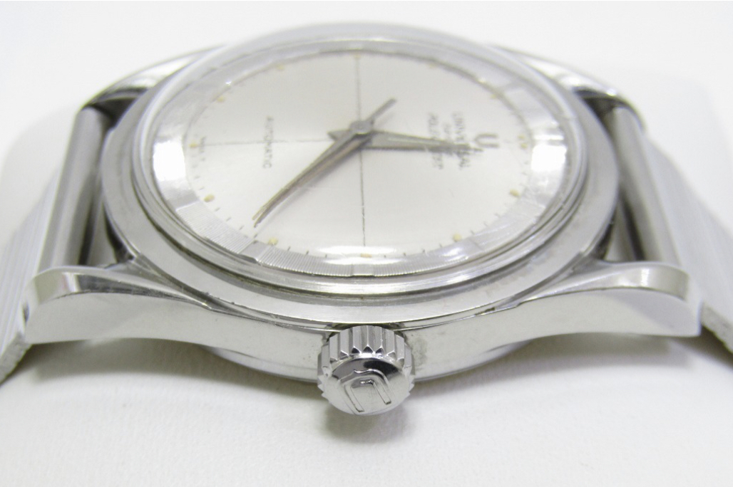

But here comes my doubt about it : it is the case, especially the bottom lugs which look bizarrely polished, almost flat in the first photo whereas on the example below found on the marvellous universal geneve polerouter site (https://universalgenevepolerouter.com/galleries/20366-polerouter-microtor/), they look more rounded
So is it me or does it look weird to you as well ?
Many thanks

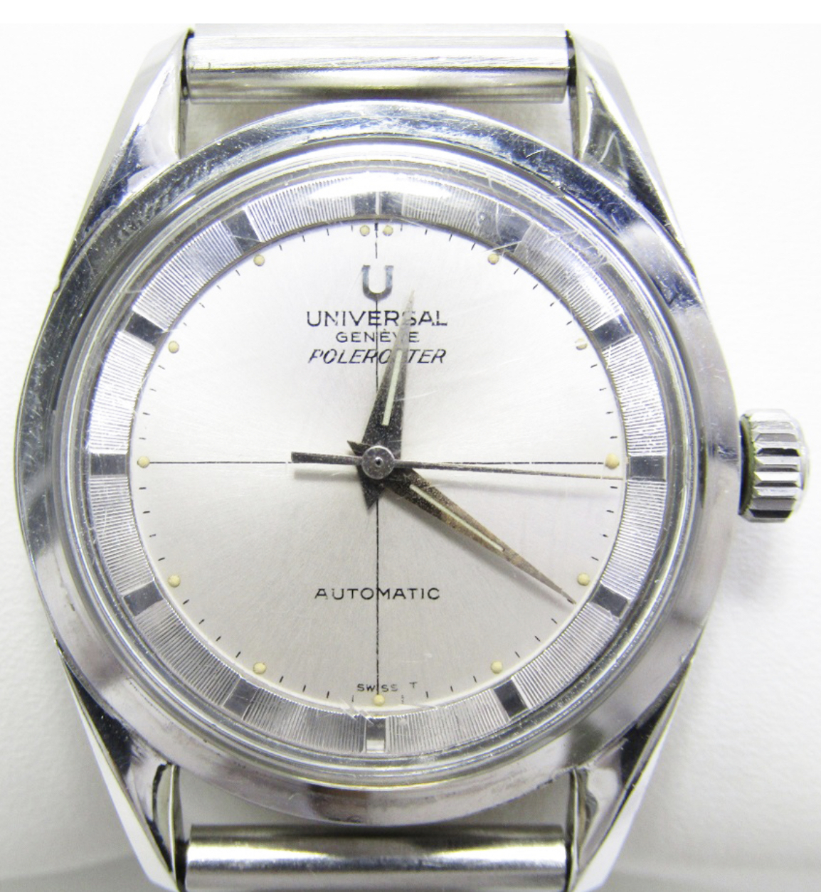

1,211
3,071

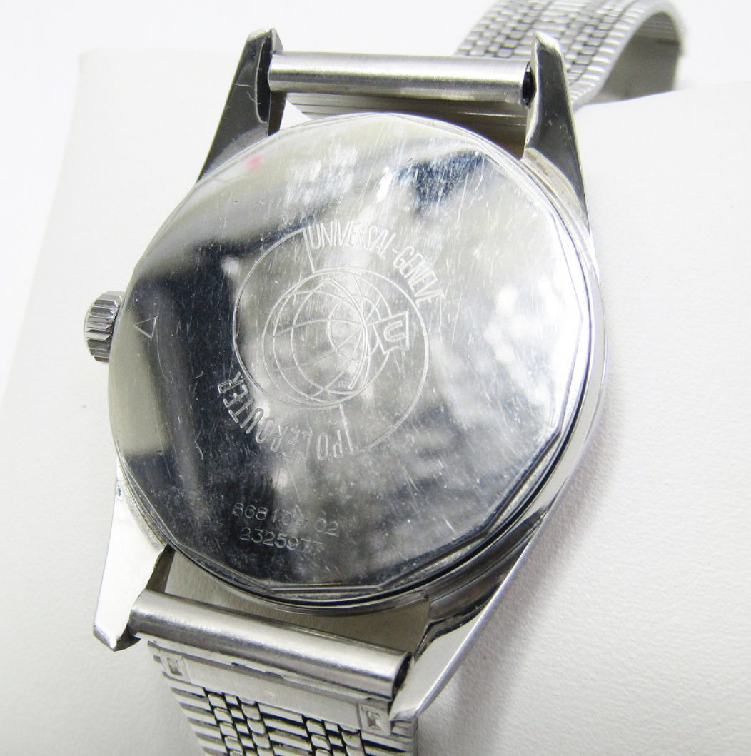

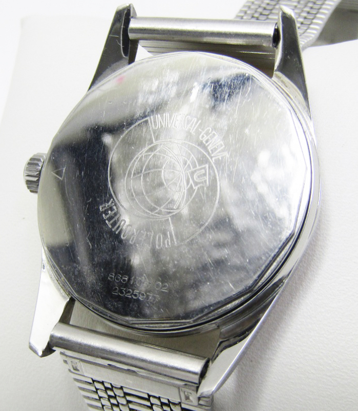

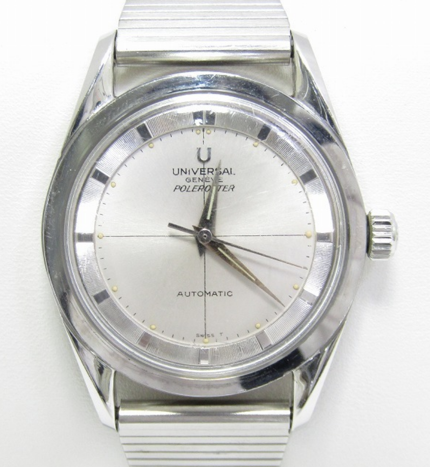

In my opinion, the watch for sale is an absolute belter.
Photos can sometimes be deceiving. The photo below from another angle shows no evidence of polishing in my opinion and with the caseback looking as sharp as this, I'm not sure the dreaded polisher has ever been near this watch.
If you don't buy it, I might 馃榾

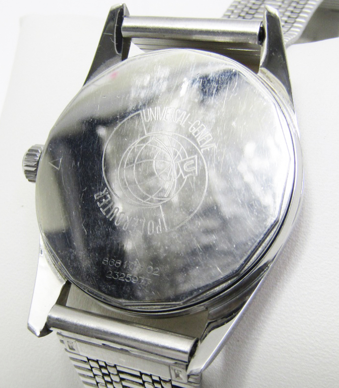

3,715
8,550
I was going to say, that鈥檚 one of the best case backs I have ever seen

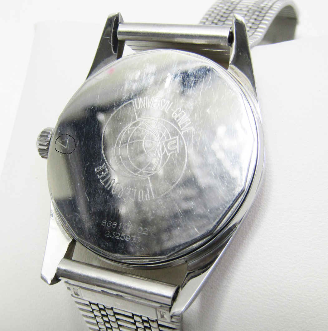

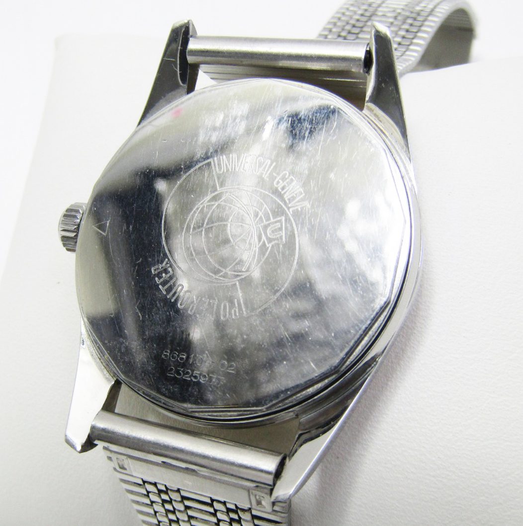

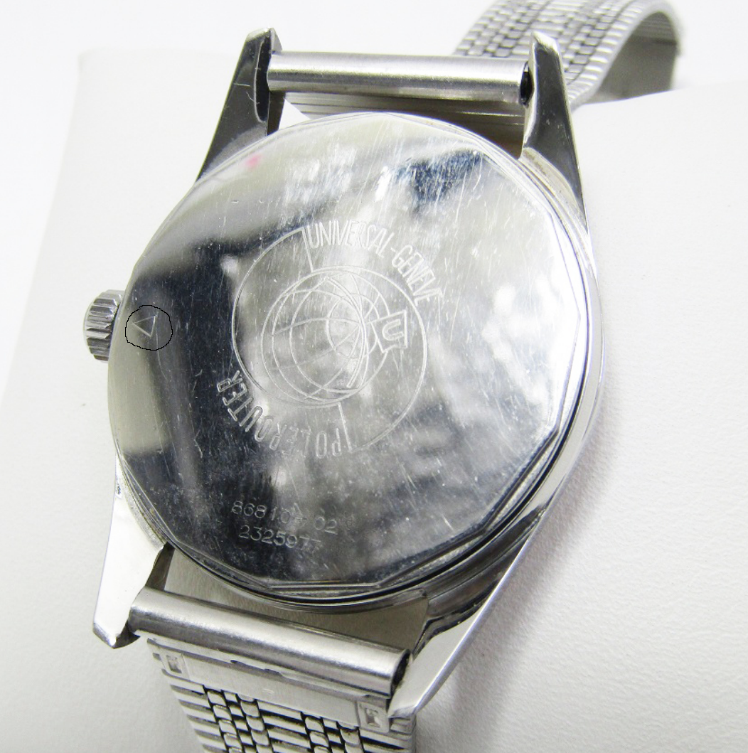

180
1,008
Has anyone ever seen this arrow on the case back of a Polerouter before? I've never noticed it before, unless it is specific to this reference?
411
1,076
Don't recall seeing it before.
Hard to tell from the photo whether it looks factory or by a watchmaker - at least to me it doesnt look to have been done carelessly either way.
886
2,414
Ive seen those arrows on poleroter sub casebacks every now and then. Forgot if there was an explanation..
129
642
Nice piece. The dial is extremely crisp. No or hardly any corrosion on the hands.
Looks like a great buy.
411
1,076
Do you remember which sub references they were?
(if if you can find them again... 馃榿 sounds interesting!)
24,836
55,255
I'm not specifically familiar with these case-backs, but sometimes an arrow like this is associated with a bayonet case-back closure, such as on Enicar cases. So the arrow indicates the open or closed position.
411
1,076
Is the arrow associated with a bayonet case-back closure?
These are all screwback "compressor" cases.
24,836
55,255
Actually, I just did a quick search, and some definitely appear to have bayonet cases, which seal with just a 1/4 turn. Obviously I have no idea if the OP watch is in this category, since the photos are incomplete. Here is one:
https://www.vintagewatchcollective.com/product-page/universal-geneve-polerouter-date-glossy-dial
In fact, on this forum, @bgrisso posted about his in a different thread (https://omegaforums.net/threads/post-your-universal-geneves.40710/page-62)
411
1,076
Ah, if thats what you meant by "Bayonet". 馃榾
In that case, yes, they all have this style of caseback. 馃憤
Edit: There is a summary on some (Piquerez) compressor/supercompressor cases here:
https://wornandwound.com/guide-super-compressors/
and a copy of one of the original patents for them:
https://universalgenevepolerouter.com/documentation/case-piquerez-patent-317537-swiss/
(i.e. theyre not "bayonet" in the same way as the thread you linked to).
1,211
3,071
I've seen lots of these arrows on Polerouter cases.
As noted above, they were on the compressor cases.
24,836
55,255
I am not the one who said that super compressor cases are bayonet cases. This is all very well known, please do some research before posting. Some EPSA cases are bayonet and some are not. Enicar specifically used bayonet EPSA SC cases, and they have a different Brevet number. I'm sure you can find many references on these cases.

3,715
8,550
I鈥檝e seen plenty of these arrows as well
1,211
3,071
The guy spends all his spare time researching in order to put together a Polerouter reference site for everyone's benefit and for no personal gain and you tell him to do some research before posting 馃榿
