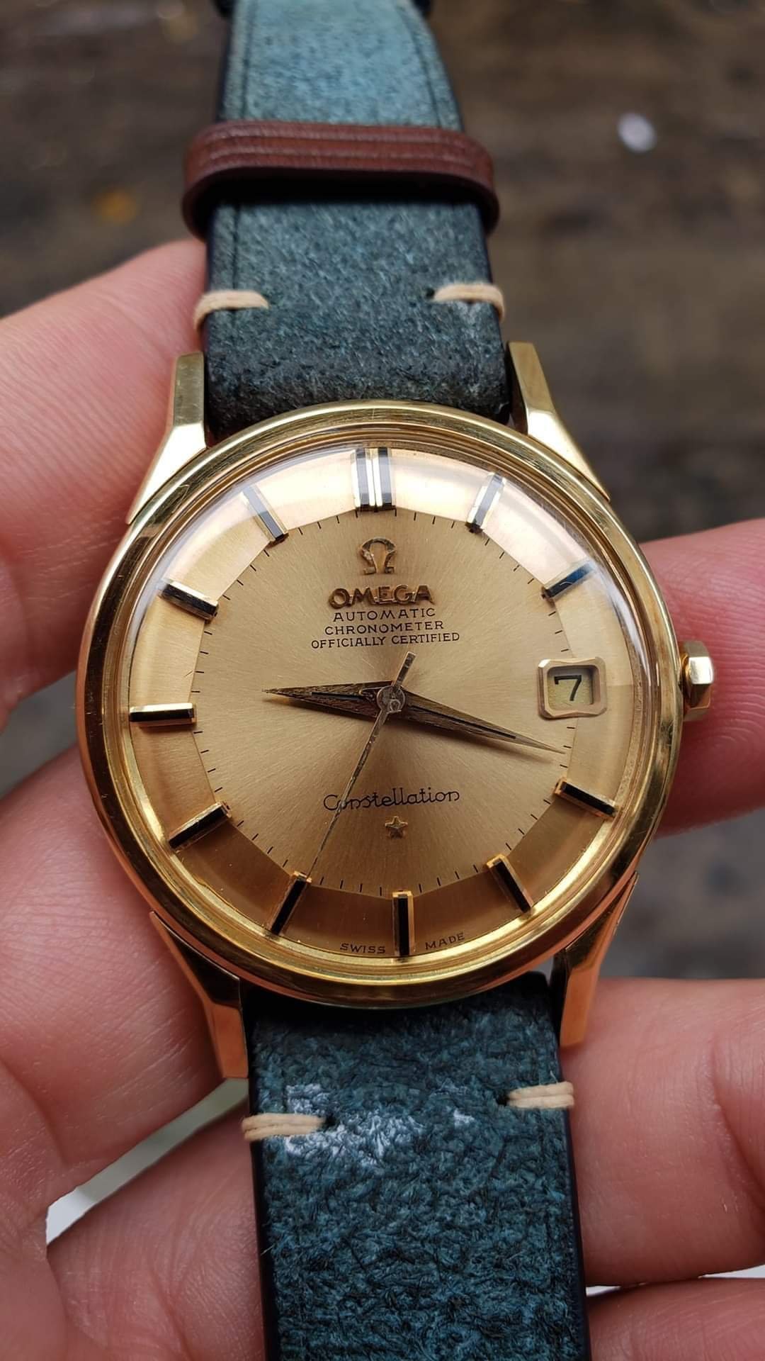

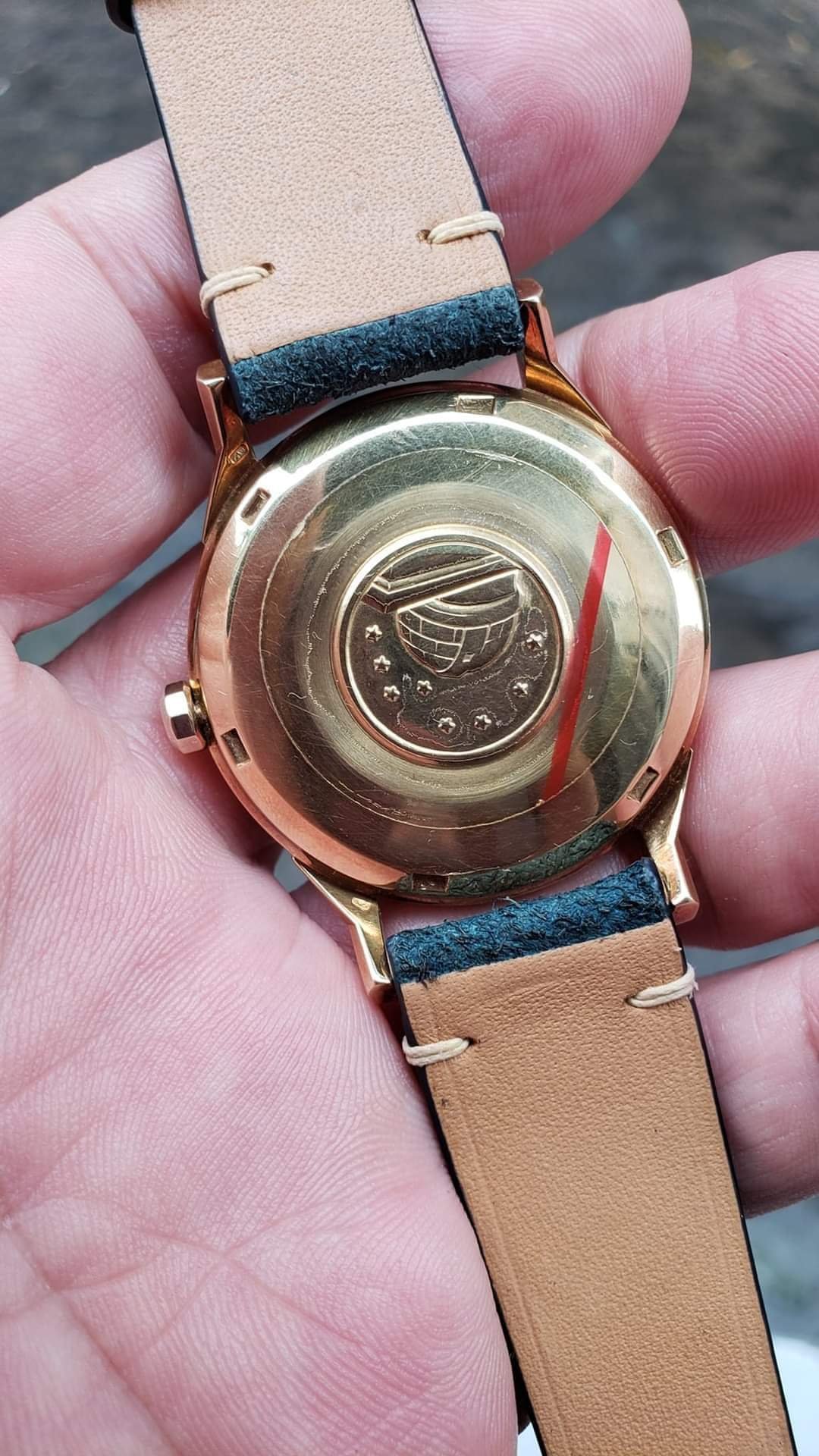

A seller I know has this one for sale. At first, I liked to call it a redial but after looking carefully at it, I am in doubt, now it is your call. Look at it and tell me what you think.

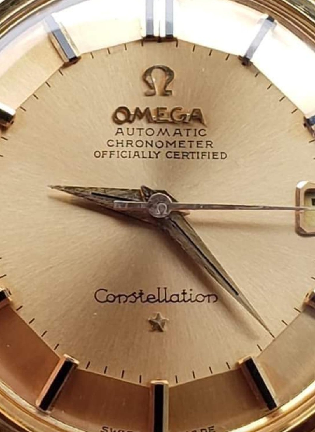

I'd put my money on redial
Edit: apart from the funky font the minute markers seemed weird to me as well

Also think it's a redial. It's got serifs, but the proportions of those serifs aren't correct.

+1 for redial.
Never seen (authentic) fonts like that on any Constellation.

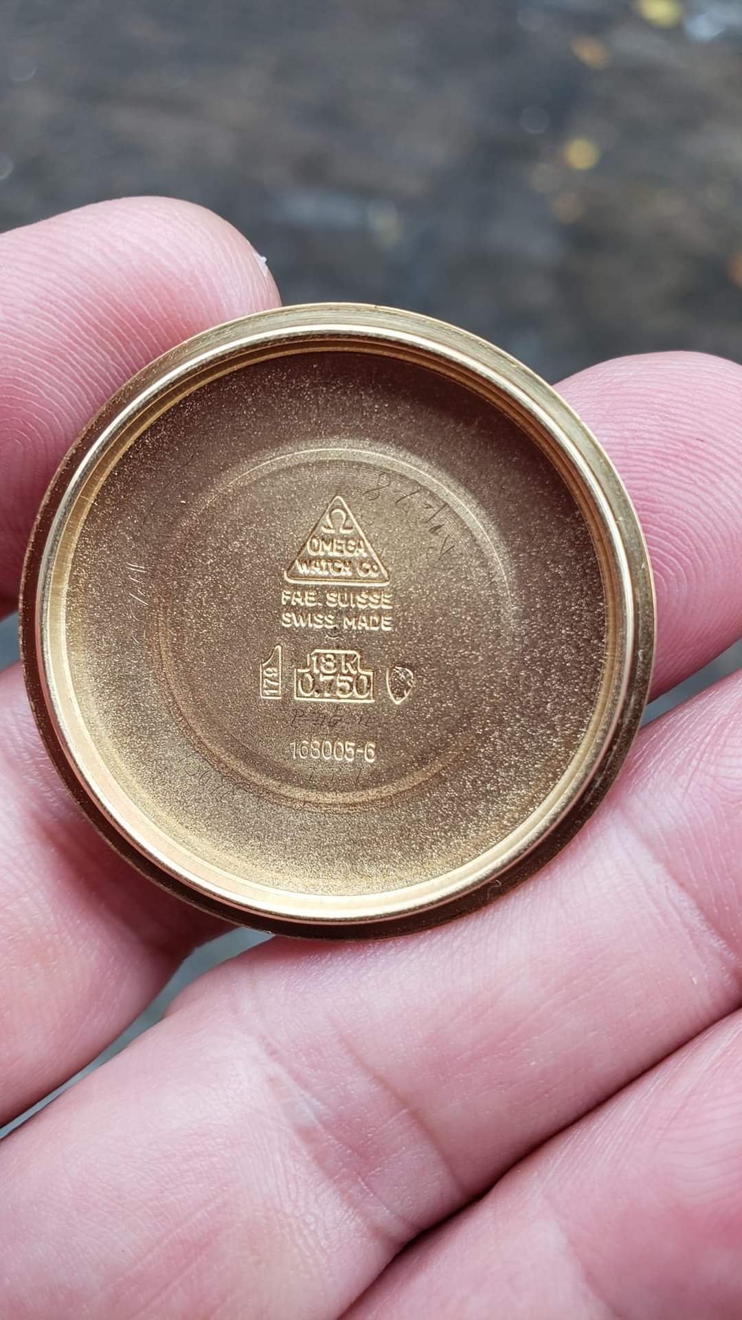

Like @gatorcpa I’m also slightly thrown by the inner case back engravings - but that might be explained away ( unlike the fonts)

I’m gonna say a redial. The text isn’t quite right and the ‘E’ in certified looks a bit wonky.

I‘m also in the redial camp. Crossed t‘s on a dog leg Connie is the tell tale IMO. The font in generall looks off.

I would also expect there to be printed markers at each of the hour markers

In my experience 168.006 usually don't have those. But lots of inconsistencies with the dial, as said above. Crossed t's I have never seen before on a 60s Connie, and the final n in Constellation looks wrong. I am also for redial, it is a very pleasing one though.

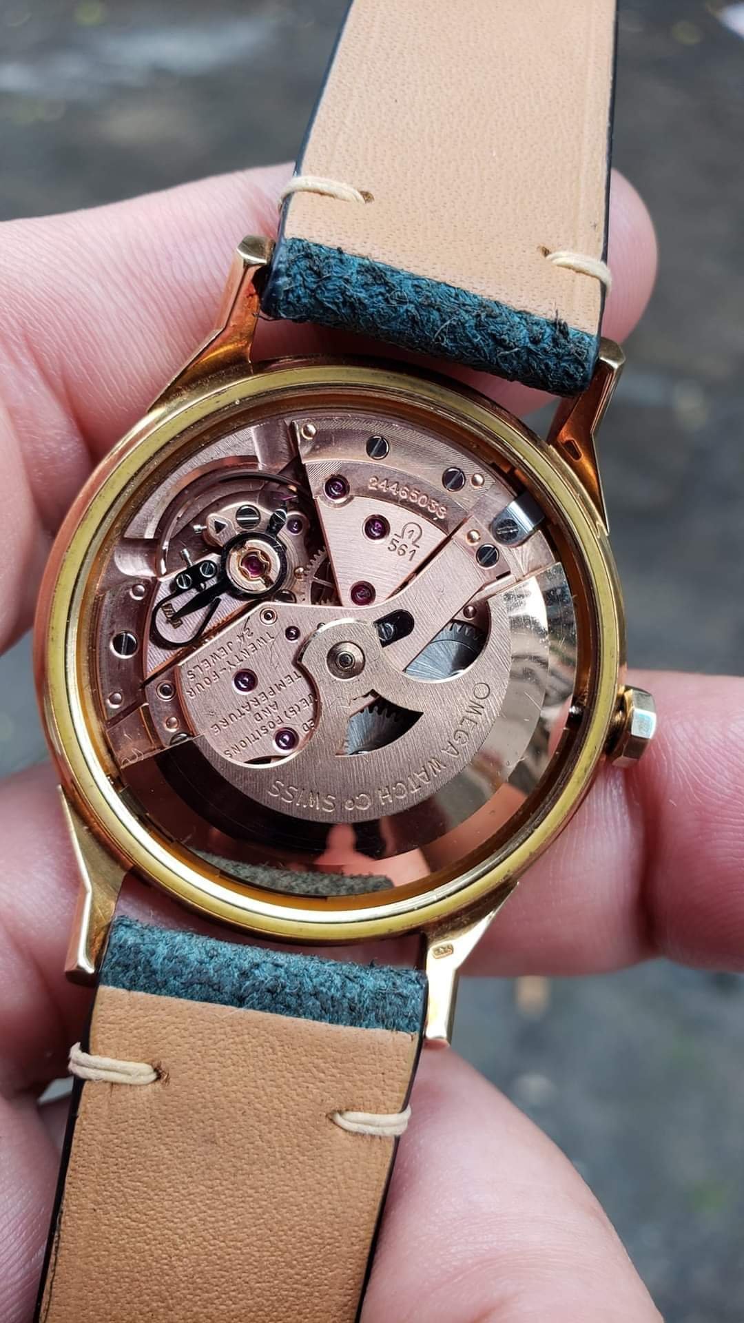

The case back bears the maker's mark for La Centrale, so the different look may be due to that, since most 006 cases were produced by Serva SA. But I don't buy the "original" yellow gasket with as many as at least three watchmakers' marks on the case back. I also think that the serial is somehow suspect, I would have expected a 168.006 to have been fitted with a 564 movement if it was produced at the end of 1966/beginning of 1967, as the serial 24.465.XXX seems to indicate.

my money on redial, the Ts and the e on Constellation look weird. But this is one of the good one, I think.

The letters "I" look different in word Officially and Certified.

I concur with @aprax regarding the case markings. I've seen a number of 168.005 cases by La Centrale and this one shares the same style/depth of markings.
Regarding the dial and not being familiar with this model, I see it as a very nice example but I'm unable to pass judgement on originality.
The thing that stands out to my uneducated eye is the "O" in officially, it looks too round, most I've seen tend to be slightly elongated (vertically).

Redial, the "n's" in CONSTELLATION are off(too identical on the radius of the curve)
They all do have hour markers but are mostly covered over by the longer indicies.

Not so sure... Even the gasket looks original, no moisture inside, clean case. Not afraid of some small inconsistencies in a small production gold dial.
The only way to be sure IMHO is to look at the back of the dial and see if the indexes have been removed and put back. What is the return policy?

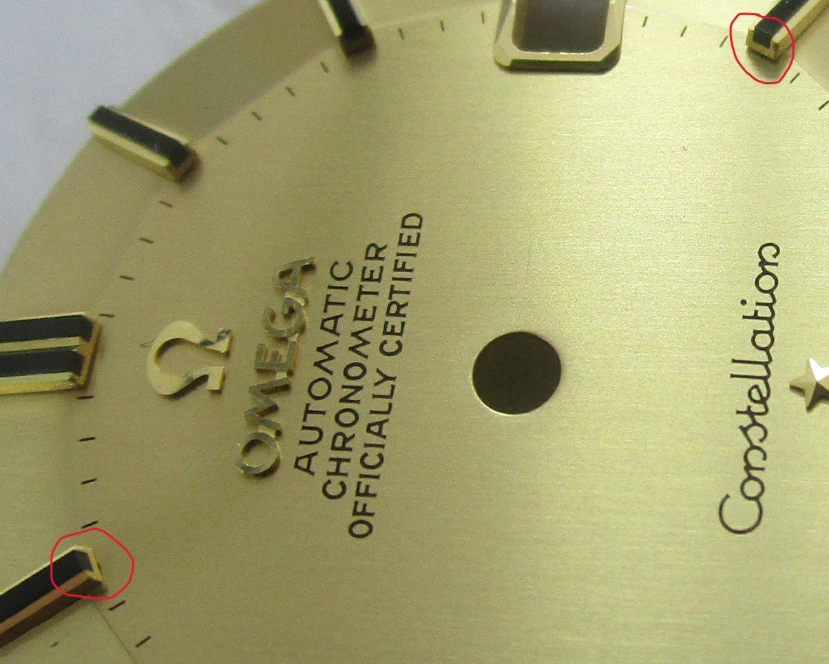

I had not realized that, you are correct. Here is a closeup of my 006 dial, and there is indeed a whiff of those markers visible.
(... and BTW, that is how the e in Constellation should look like.)
(The above photo was taken by WatchGuy https://watchguy.co.uk)
EDIT: To add that the hour markers are also visible on the first pic of the OP, e.g. at 10 o'clock. That is a bit unexpected for a redial...
