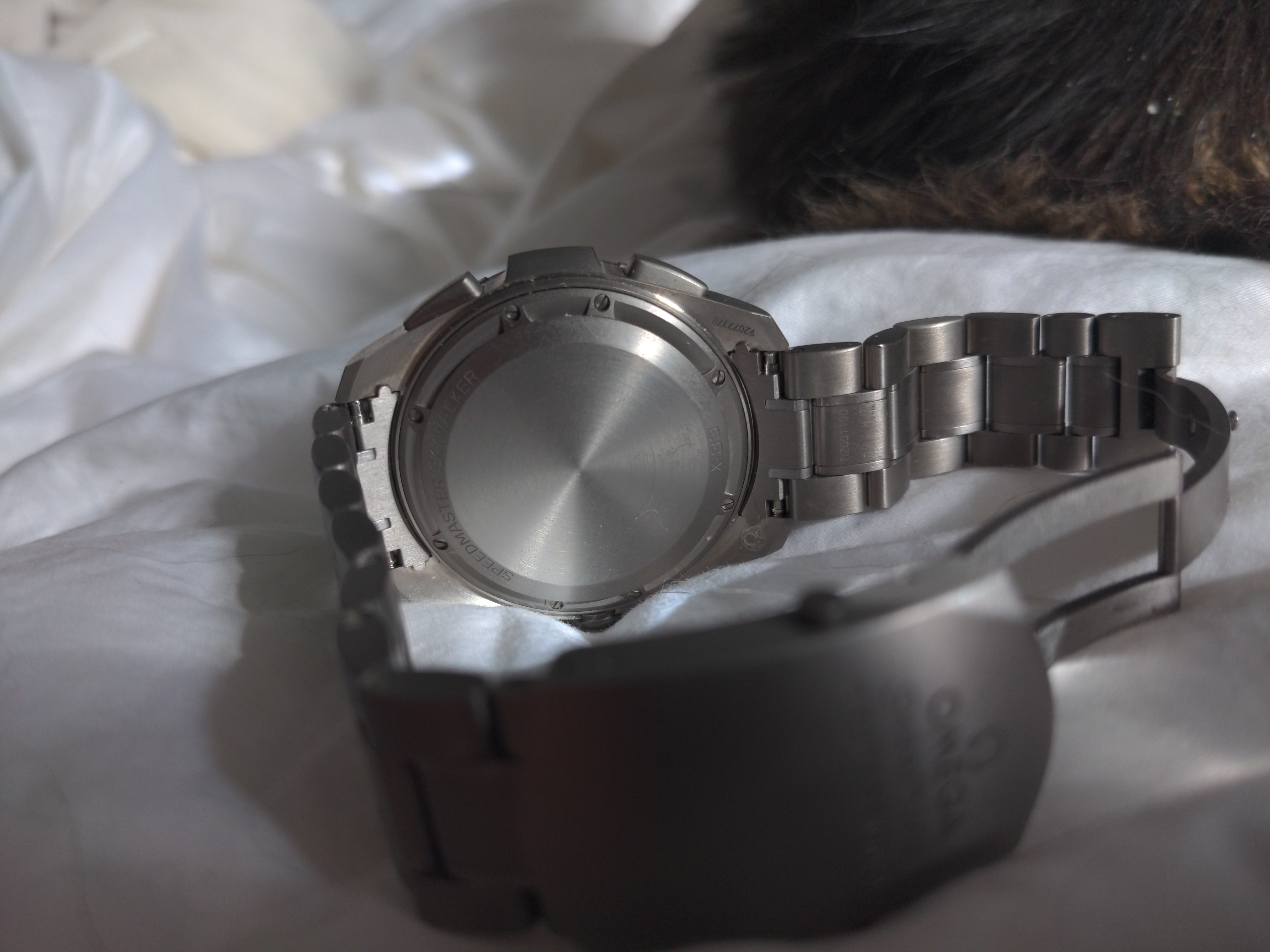

Hmm, my new x33 is a plain case back with neither qualified nor certified, did they stop making the engraved ones?
oh, pic?
10
5
oh, pic?
Maybe I should throw it into a vacuum chamber to check out if it's still qualified even if the case back doesn't say it...

So strange... Never saw that before... Maybe a very limited edition!😲
10
5
I looked around on chrono24, and it seems the "new" listings all have this plain case back whereas the used/unworn ones do not, which makes me think this is a recent thing.
I have some pictures of this style case back but can't share them. Both American and ESA astronauts have this case back on their Skywalkers but in the middle it's engraved with the NASA or EAS logo with their name and missions added. Same engraving around the edge just like yours. This engraved case back is usually added to the watch post mission to personalize the watch.
10
5
Oh that's cool to know! I wonder how the AD in Japan got a hold of one though. One of the projects in my lab is in collaboration with nasa... Maybe they'll engrave it for me when I'm done with it XD

Did you buy from an Omega AD or boutique ?
How about functions, everything normal and working, card stamped etc ?
Trying also to figure out what this is. I sent an email to omega with a reference number and no answer so far...
Cheers
Bought from an AD in Japan on chrono24. Card seems fine, stamped with the correct date and seller, all the functions seem fine too. I've been using the timers, all 3 alarms, all 3 PETs with MET, and the power saver alignment mode without any problems.
The only things amiss are a very slight wobble on the perfectly aligned bezel, the minute hand being slightly loose - sometimes it gets jumped forward a bit too at the 30 sec jump and gets out of alignment (fixed by tapping the case so it goes back, will try to get it fixed properly at the first battery change) and a bit of paint from the omega logo on the box has rubbed off to the inside of the cardboard cover.
Found another listing on chrono24 that's 9 serial numbers off mine with the same case back so makes me think it's a batch thing.
