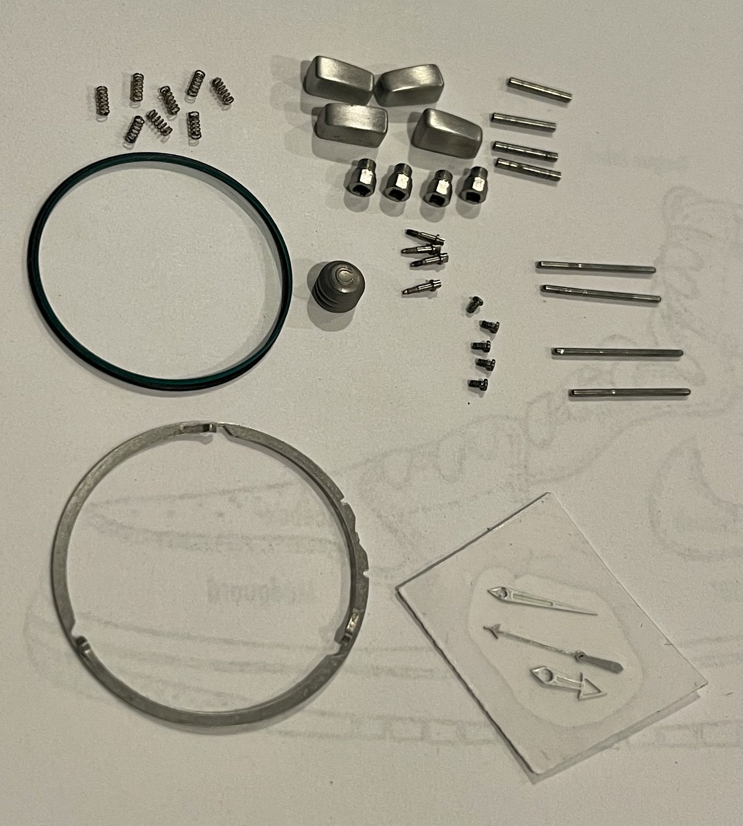

Interesting that Omega would send the parts back on a sketch of a Jordan 1. Potential collab? Moonshoes?!?
OP: My expectation is they sent the watch out for repair and there really is no info until you get it back. I would expect the same of any location that sends it in for warranty work, that's just how it goes. To me, it is not the sign of a poor shop, rather, poor comms. back from the Omega mothership.
Funny you mention the shoes. I was working on a Nike “Space Force Ones” design.

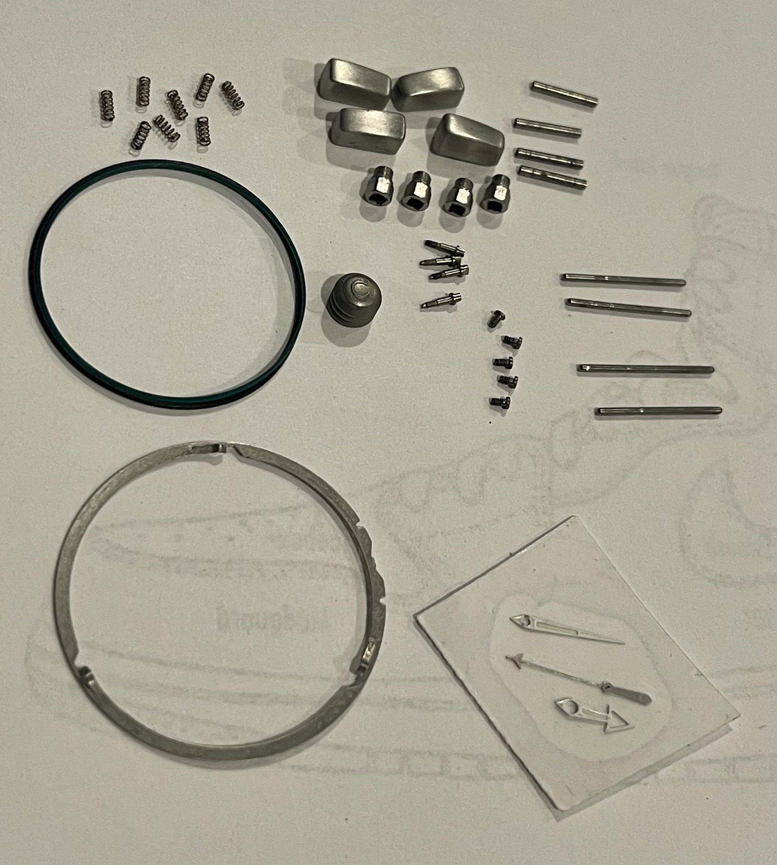

When my Skywalker came up for a battery change it was sent off too. It took several weeks. I live in Houston.

Here is what Omega replaced in case you were curious.
plus the complete movement - which I have been told they recycle. 👍
Having had a couple of these bags of bits back - I do wonder if there’s mileage in them offering customers an option to agree those components are recycled too… I’m not sure how much use I have for baggies of worn out parts.
6,491
31,966
Aren't there 2 services, one only pushers and so on for around €290 (pictured in the @Omega-Q ?) and second with a movement swap (if necessary) which costs around €600+?
8,855
28,095
I could be wrong but as I understand it:
battery service - seals, pushers, crown, battery, screws.
movement service - all the parts omega-q shows plus the complete movement.
6,491
31,966
Yes, that was my thought too, there's also a possibility to only have battery and seals replaced if you have it serviced locally ie. independent OSC or via an OB technician.
