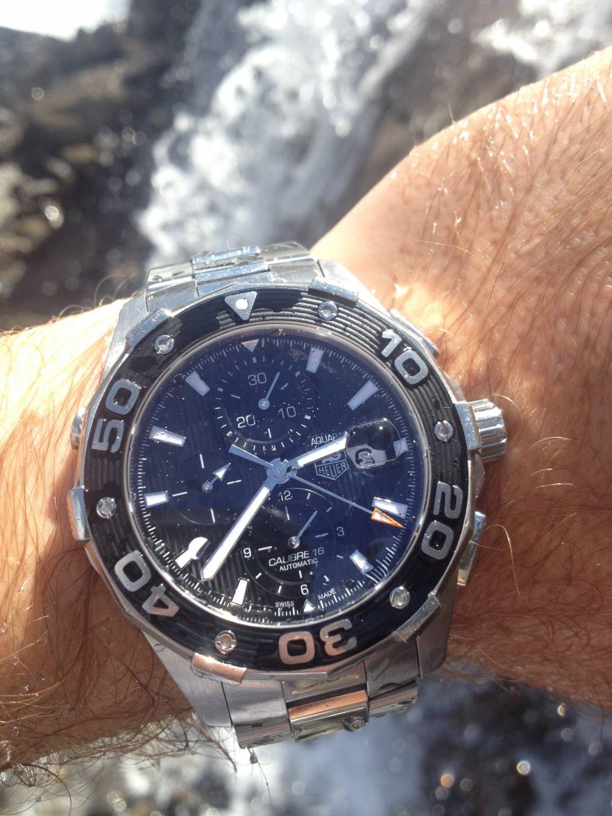

My Tag Heuer Aquaracer 500m Chrono recording a hike in Banff National Park

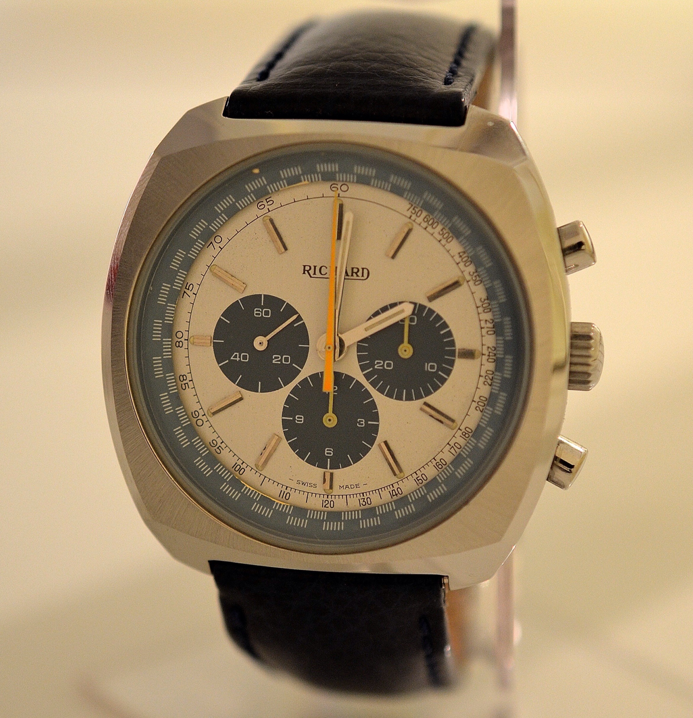

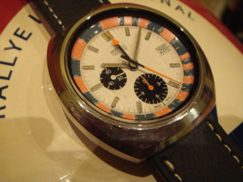

Must be cousins, surely?

I think there may be more to the cousins thing than you think. I have been trying (unsuccessfully) to find if there was a link between August Reymond SA and the Richard Watch Company, but I think there must have been one.
When you bought your Richard, I thought it might have been just a standard product that Lemania sold to both companies for them to add their own branding. However, a few weeks ago, I spotted an Arsamatic on eBay. This has a Lemania 1340 movement and that particular one has an oscillating weight marked RICHARD. I think that it is too unlikely to be mere coincidence that a watchmaker needed a weight for an Arsa with a 1340 and just happened to have one kicking around with Richard on it, so I believe that there must have been a tie-up between the two companies.
