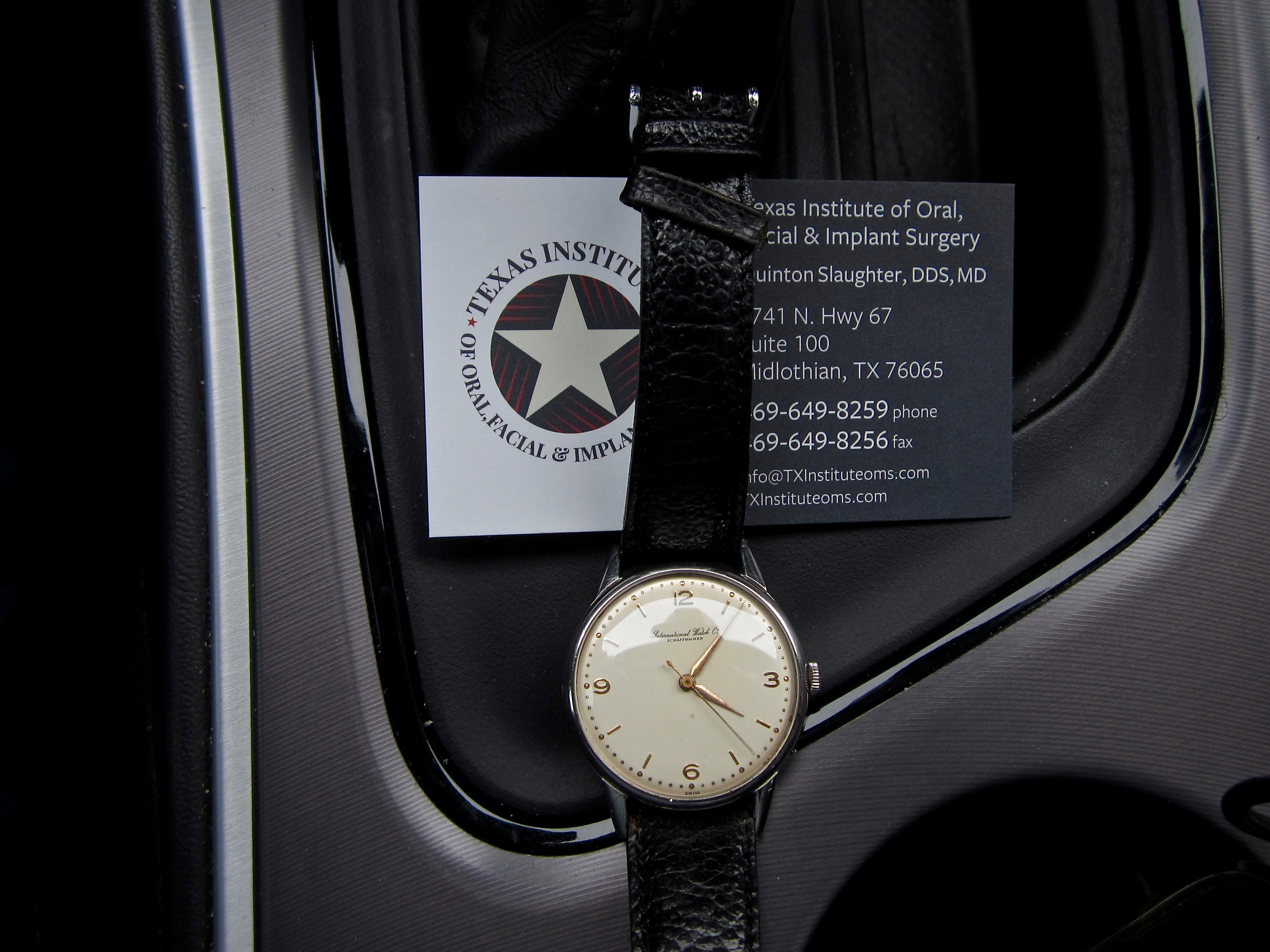

Would you want to go to a doctor with a last name of Slaughter? Would you wish to pay the equivalent of several fun vintage watches for an implant?
Me either. But, them's th' breaks.

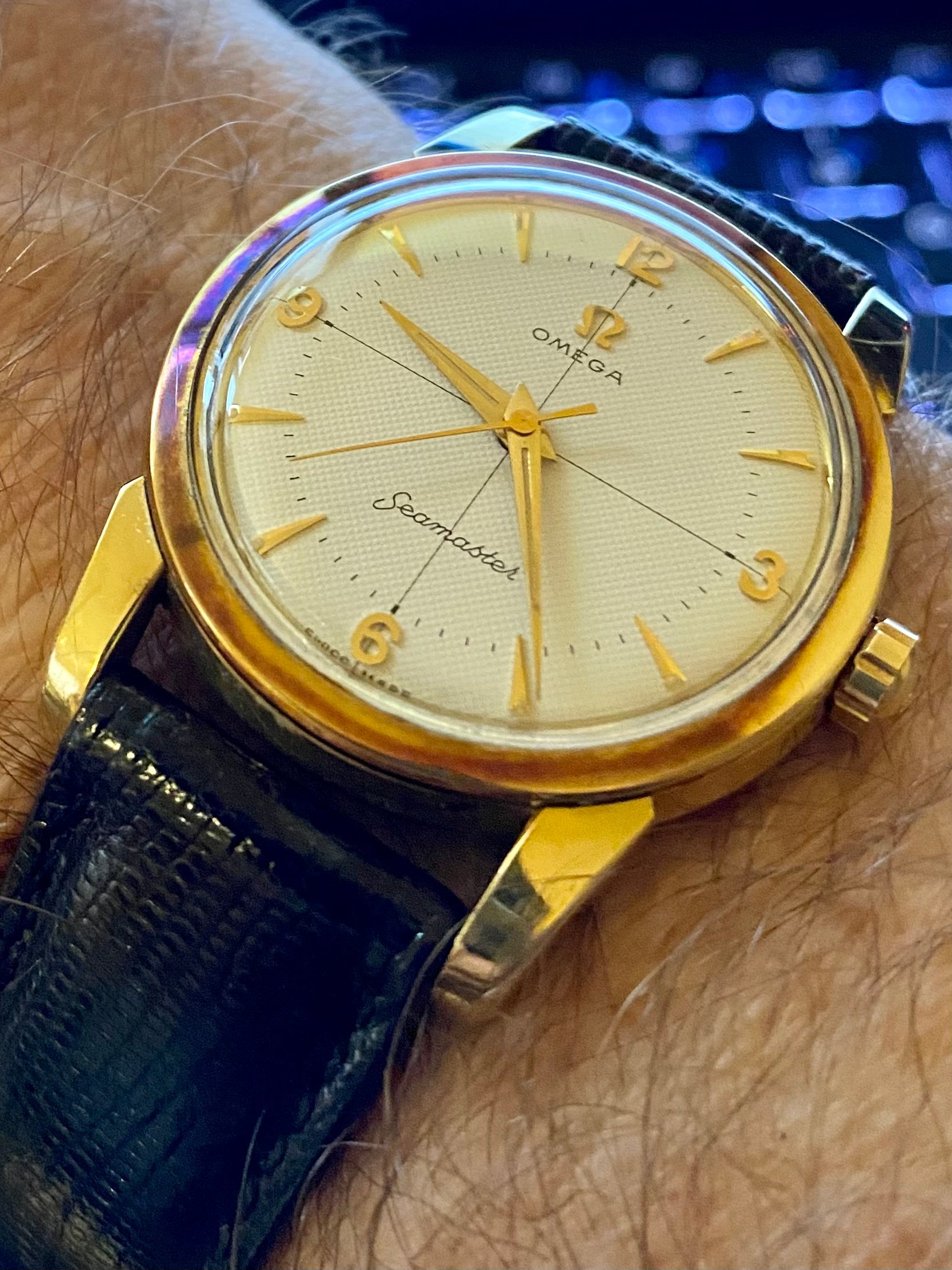

Within the last week, I showed a picture of this mid-50s bumper automatic which I rarely wear. At the time, I boasted about how good a performer it has been, and how reliable. Later that day, it cratered! I hadn’t serviced for about 30 years, so today, I stripped it. This is an A Schild 1161 bumper automatic. It has a two-piece drive pinion with attached ratchet feature that is the final drive pinion in the automatic winding. But it is also involved in the manual winding of the movement. The two parts of the ratchet pinion had parted, so the watch was not winding either automatically, or manually. Today, I repaired the pinion and conditioned it. Back on the wrist.
