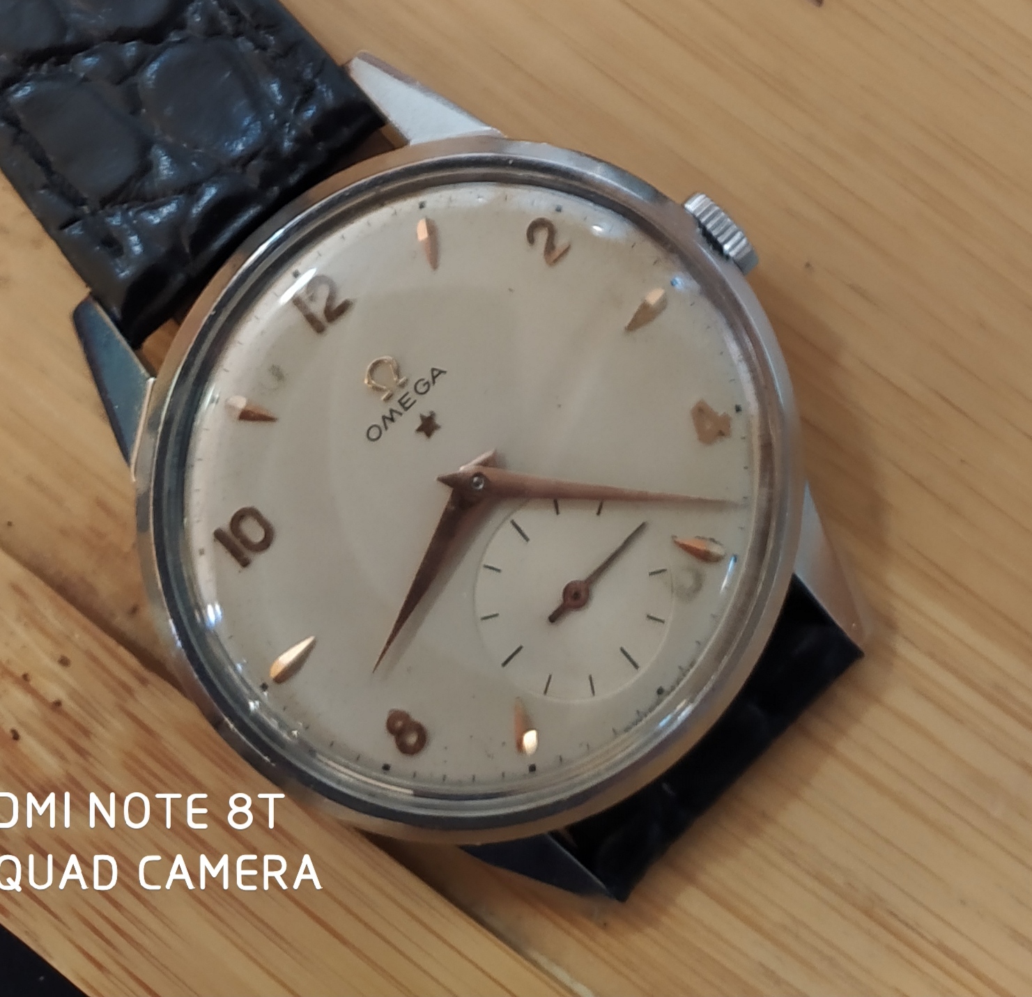

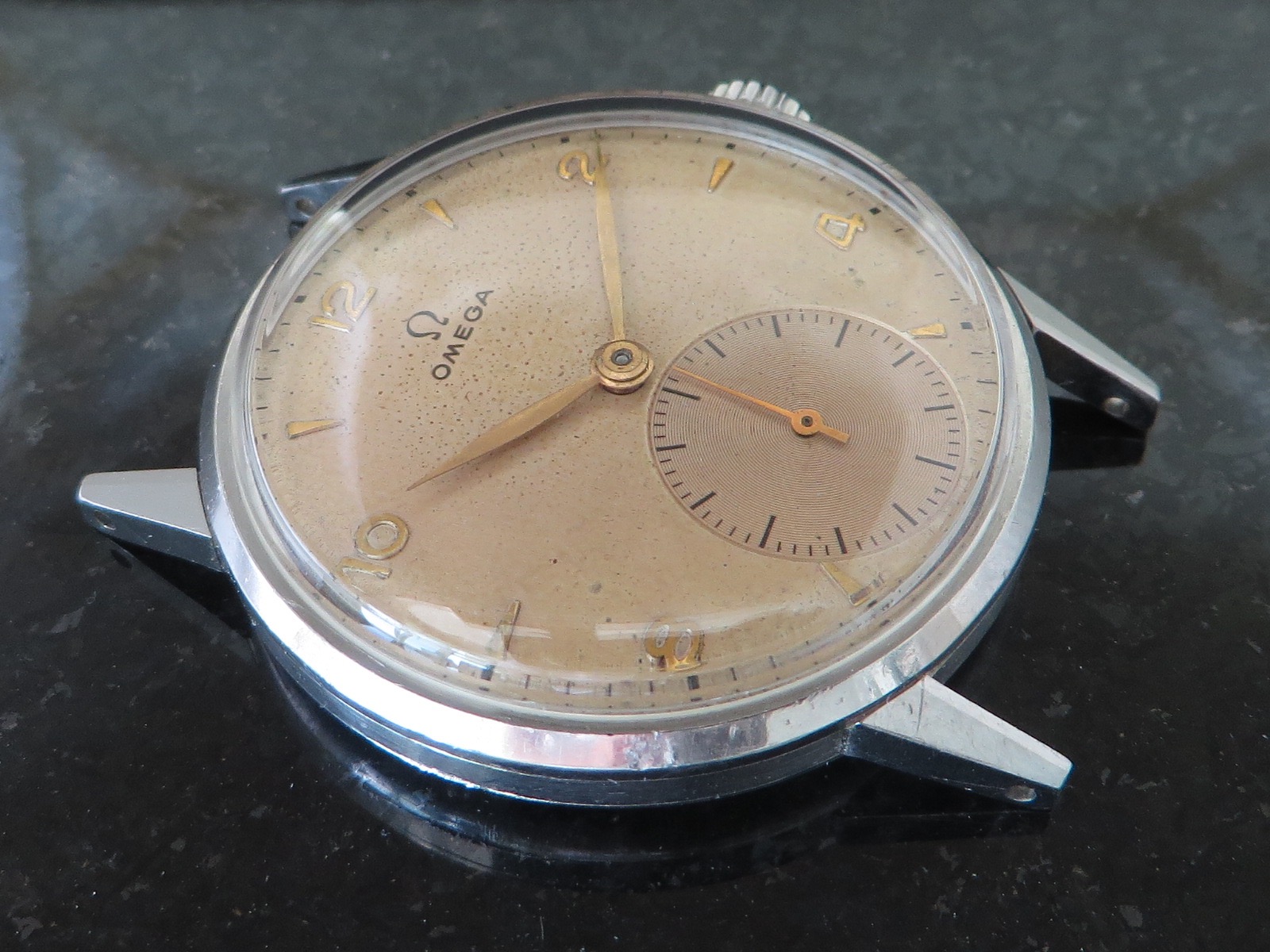

Hi everyone, I'm being offered this Omega Teddington. The case and the movement are what they are supposed to be (cal. 265 and ref 2271), but I'm not sure about the dial. The dealer insists that everything is original, but I can't find this specific dial anywhere on the internet. Can somebody help me with that? Thanks!

Since there were a lot more 2271s which were not Teddington's, without an archive from Omega or some real provenance to support the claim, I wouldn't pay a premium over a typical 2271 in similar condition. BTW, there were likely dozens of dials offered on the 2271.
More large clear photos might help especially the movement and dial.

Thank you for your reply! The price for this watch is 500 euros, so I wouldn't say that I'd be paying a premium. Unfortunately that's the only photo of the dial I took, I've seen the movement and it's definitely a genuine 265. What worries me a bit is the different distance between the "E" and "G" and the "G" and "A". It could be a sign of redial.

I could see from that one picture people of moderate to above average experience calling it both ways. There are aspects that lead me to believe it’s authentic and a few things that I would want to clear up.
the picture is not helping. Need a straight on shot.

If I may ask, what makes you doubt?

The Omega logo and I cannot check the alignment printing around the dial.
If it was a full on shot and I could see the consistency of the hash marks around the dial and sub dial I’d feel more comfortable with the Logo.

The hash marks look quite evenly spaced to me.
I've inspected it in person and it's a wonderful piece, dial included, I'm just a bit unsure because I could't find the exact same version online and I was wondering if something could be off. Maybe the OMEGA writing is a bit weird, the letters don't seem to be evenly spaced...

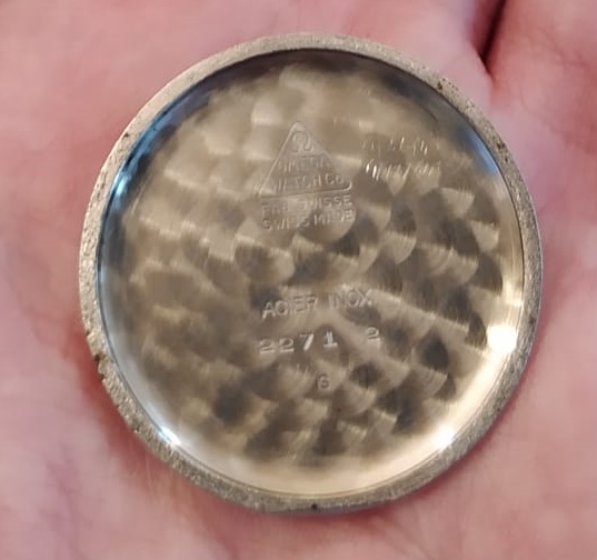

I have seen similar dials on watches of around 1952
I think ref 2271 -2 must be much earlier than the dial - I would like to know the movement serial#

the movement serial is 13139705

1952: This movement would match the dial... but the case seems to be earlier.
Maybe the movement was swapped?

Actually AFAIK the 2271 is the standard for a Teddington, they were produced from the early 40's onwards, I've seen some watches with that ref from the end of the 40's. It doesn't seem weird to me that a watch from 1952 has it after all.

I am not sure if you understood my statement correctly... a -2 version of the case should be early 40ies when they started to build the 2271 while movement and dial are from around 1952 about ten years later

Oh all clear now, sorry my bad. So that might be something to worry about in your opinion?

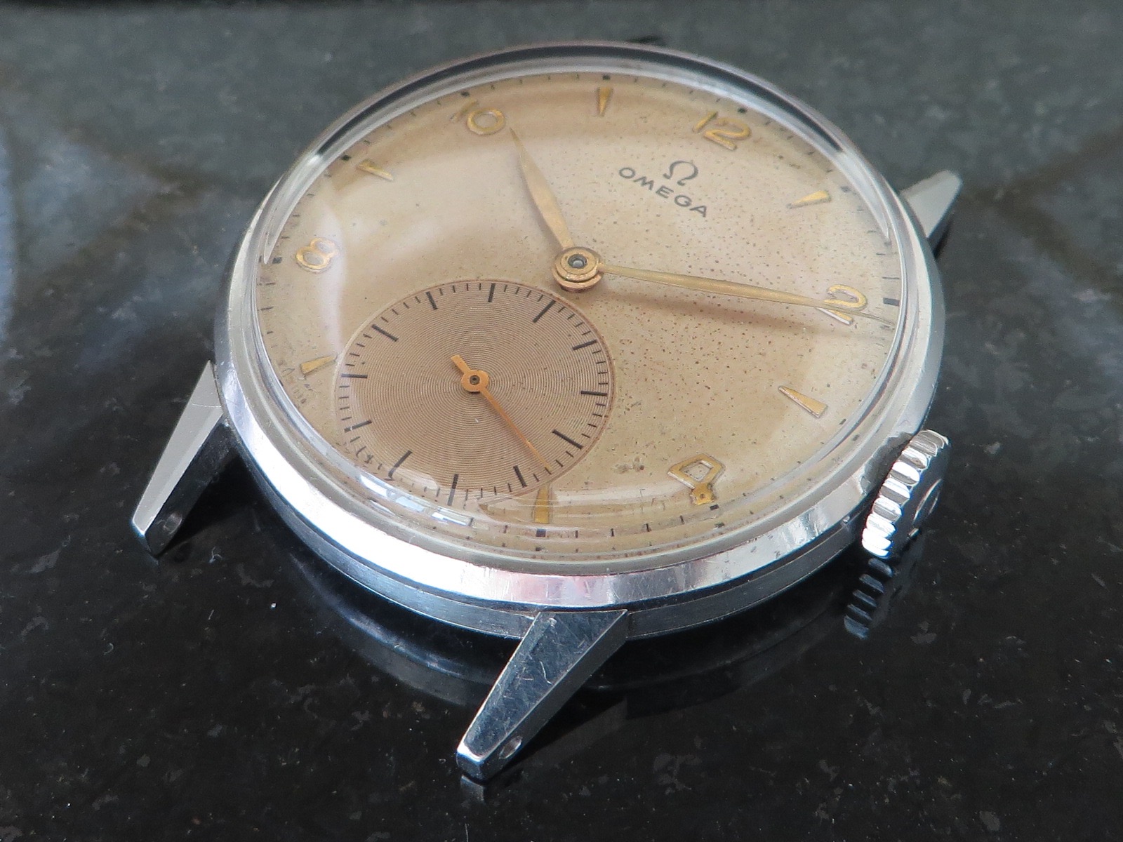

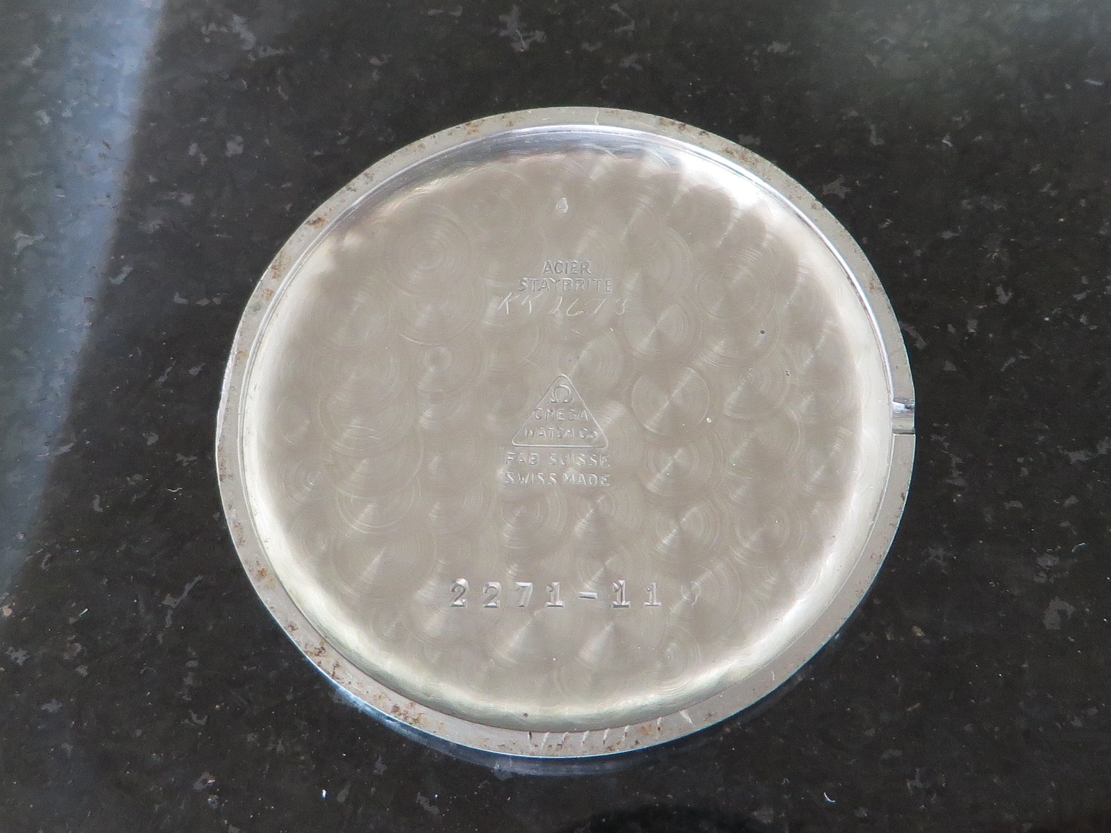

FWIW, here is a 2271-11 I sold here a few years back.
It looks very similar in many ways... The watch is probably legit and it's a dealer in my town who owns a phisical shop, I guess I'm going to go for it and if something wrong pops up I will complain in person.
Yes, comparing to the example above it is not unlikely that all pans out well.
