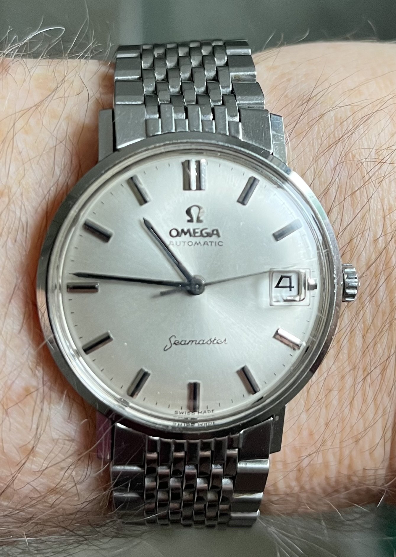

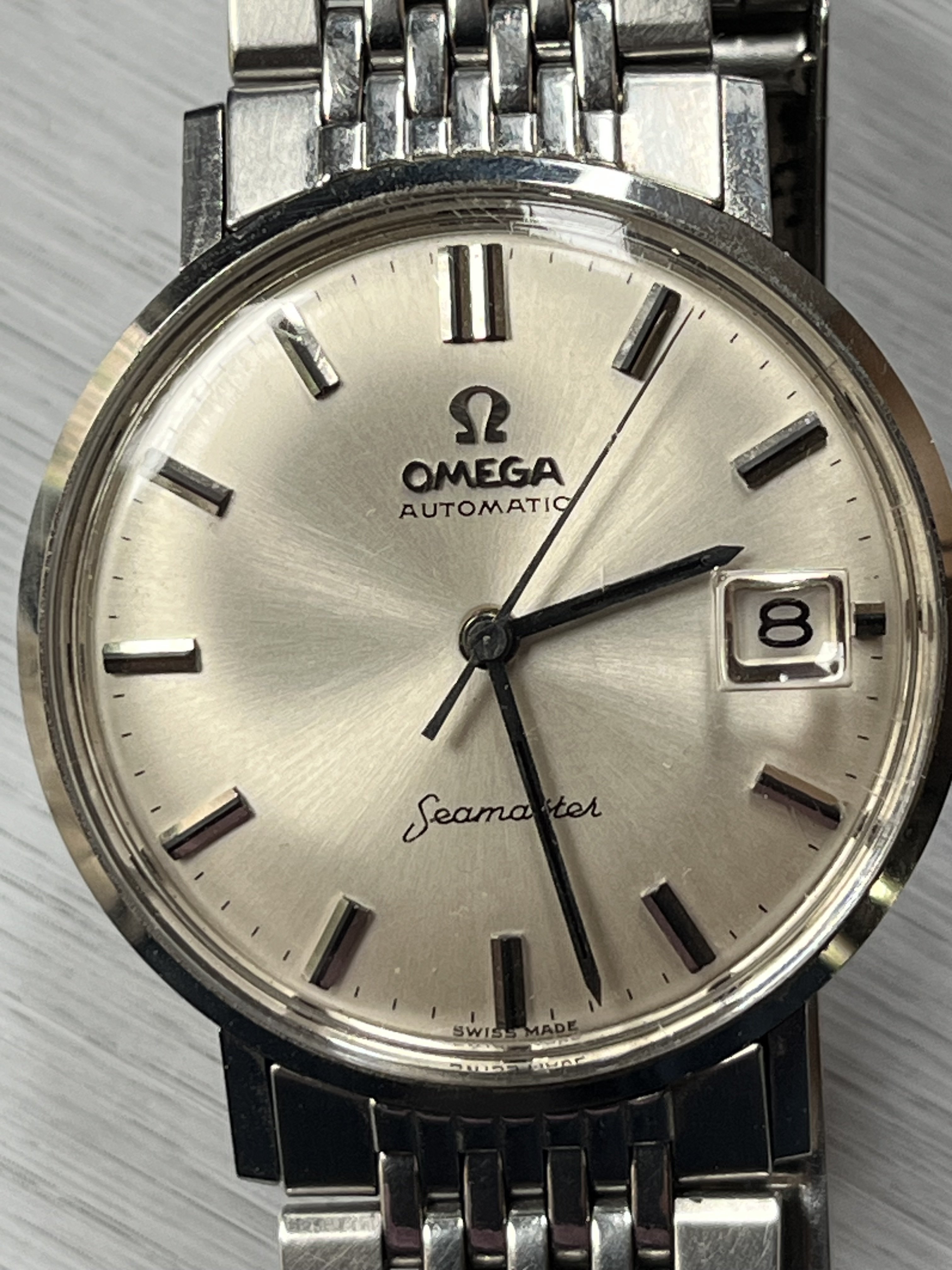

I was recently given my father’s Seamaster by my mother. He died two years ago. I was hoping someone might recognise the likely year it is from. Here is photo. It looks very similar to two Constellations I saw on the forum debate about Seamaster v Constellation.

The font style of "Seamaster" indicates that it was likely mid-1960 or earlier.
34
9
As in the year 1960, not the 60’s?

I’d say it’s around 1963 give or take a few years.
As others have said, that ‘coat hanger S’ seamaster font was early to mid 60’s.
It’s a unishell case so doesn’t have a caseback. The movement is accessed by removing the bezel and crystal, separating the two piece crown, twisting the movement and removing it from the front.
This case design is fairly robust so it’s not uncommon to find them in good condition.
Very nice original example and perfectly suitable for frequent wear of regularly serviced and kept away from water.

When it goes in for service, you can ask the watchmaker to tell you the movement serial number. Then you can use the Omega serial number chart to look up the year that it was manufactured. Until then, early 60s or late 50s will have to be sufficient.
You con't have to wait to receive your other watch back before sending it for service. In fact, by wearing it daily, you are just creating more wear to the movement parts.

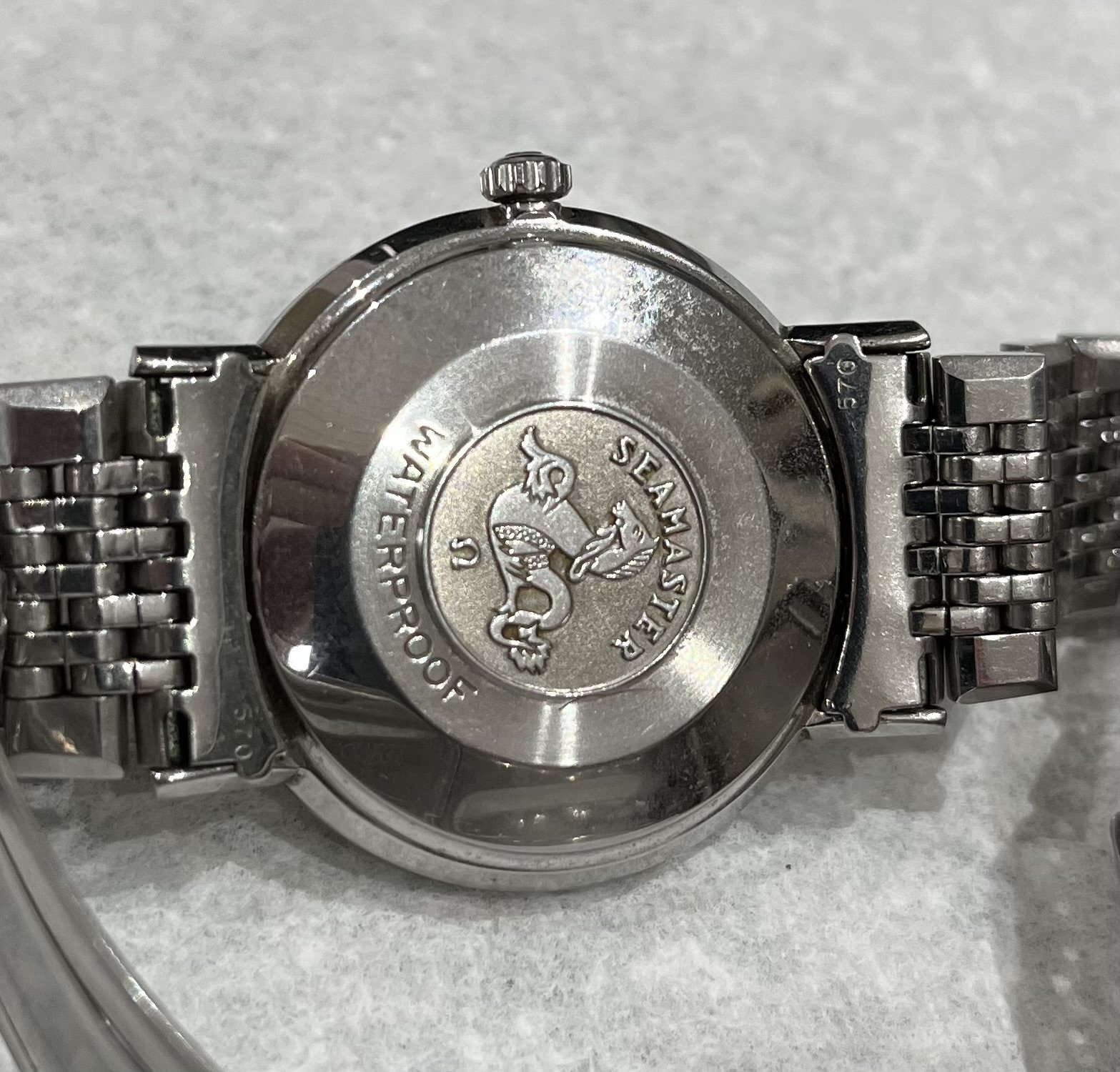

That’s very interesting. It does say waterproof on the back.
The Seamaster was a "waterproof" model, obviously. But over time, the seals deteriorate and these watches are often damaged by water. So you should not risk exposure to moisture until it is serviced.
