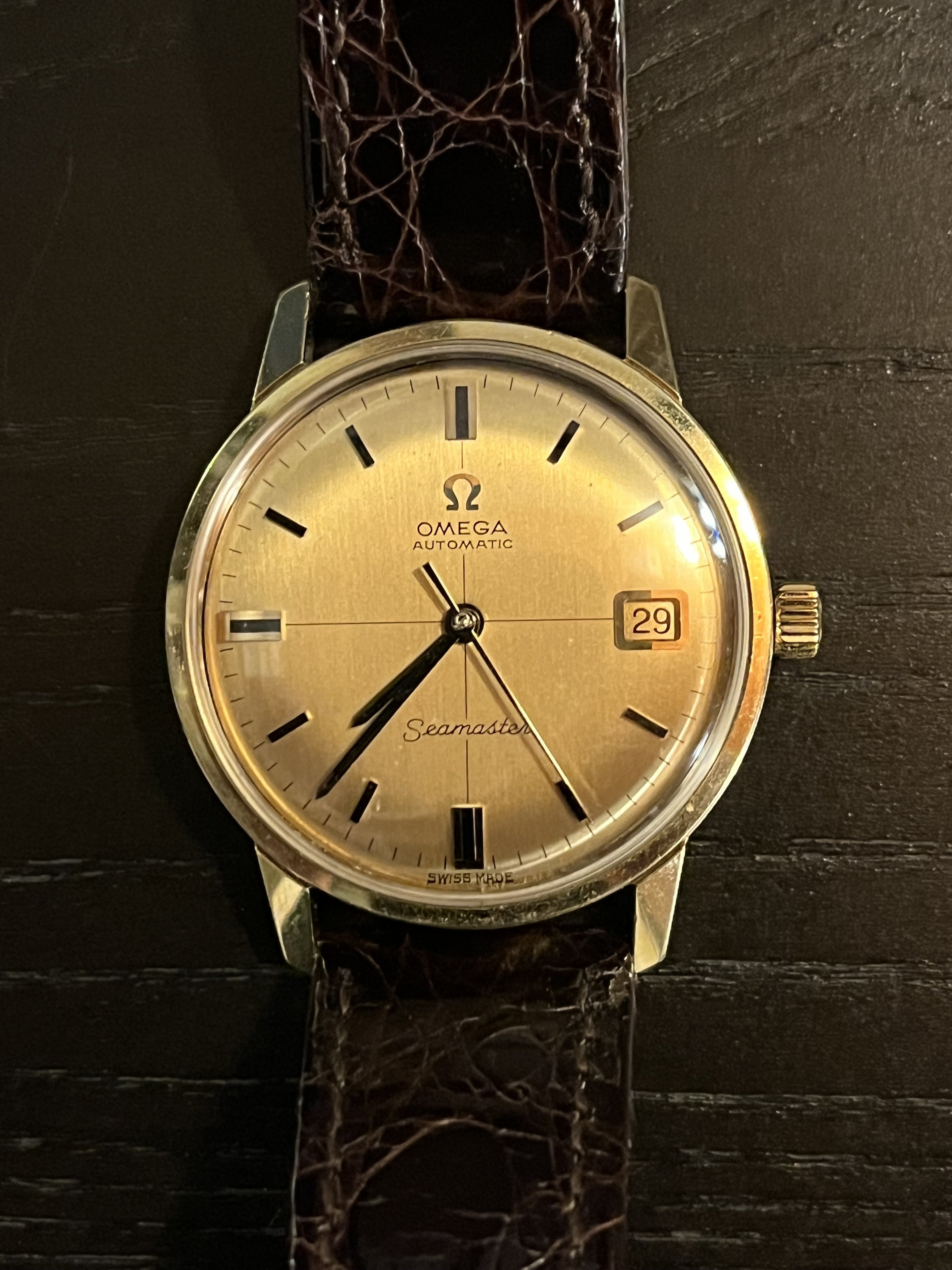

In the meantime, my 1967 Seamaster has returned.
Now the hour has gone back I assume I have to wind forward 23 hours and then dial through the dates!
34
9
Here’s a question about my 1967 Seamaster which recently returned from being fixed under warranty by STS.
Working very well and then I allowed it to run down while wearing another watch. Wound it and set the time and date, and still keeping excellent time, and then stopped around 11:00 at night. I reset it and then it stopped around midnight, and then, next morning found it had stopped around 1:00. I’m wearing it now and it has been behaving perfectly and not stopped. So I’m wondering if it stopping is connected to the date change? Also, I have to say that the crown seems stiffer since I got it back.
Any thoughts? It is under a two year warranty since August.
34
9
Just keeping an eye on the watch as it gets closer to midnight. As the second hand reached 10:00 it stopped moving. I shook the watch to start it ,Then a couple of minutes later when it was in line with the minute hand it stopped again. It is happening every minute after that. When it lines up with the minute hand. Then at 10:05 it wouldn’t move when shaken, so a gentle turn of the crown to wind it once started it moving again.
34
9
Once it reached 10:08 the second hand works as normal. I’ll see if it behaves the same at 11:00.
