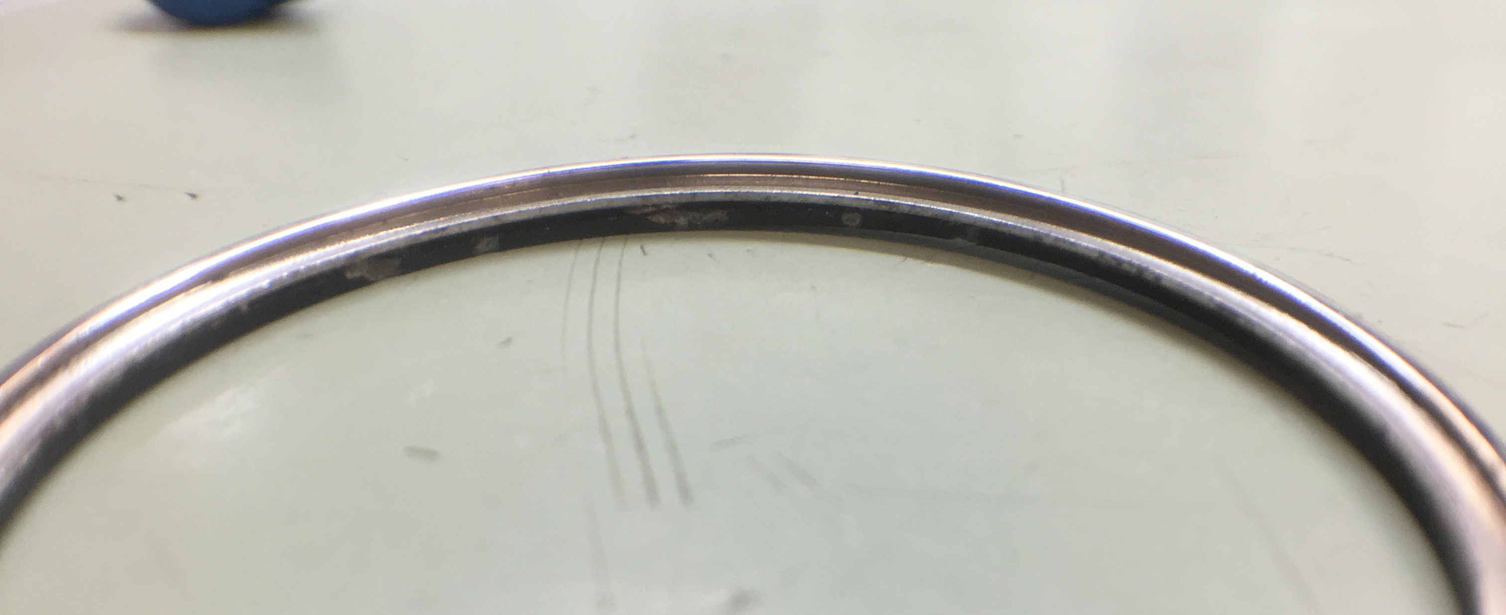

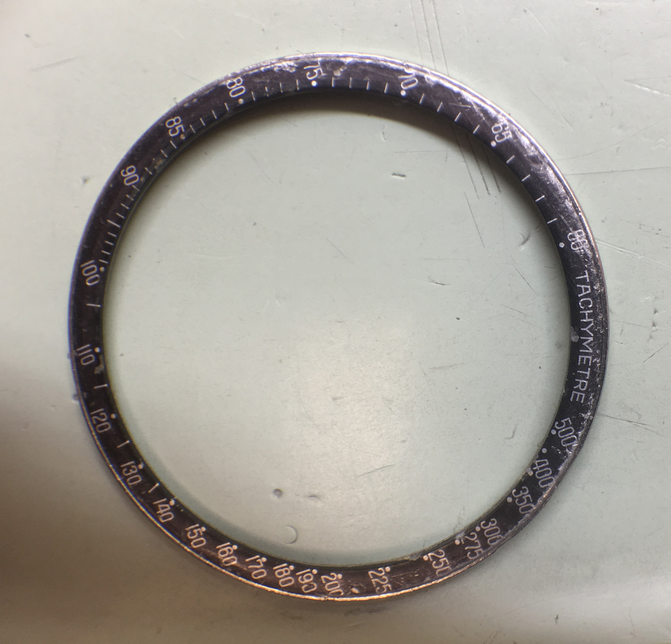

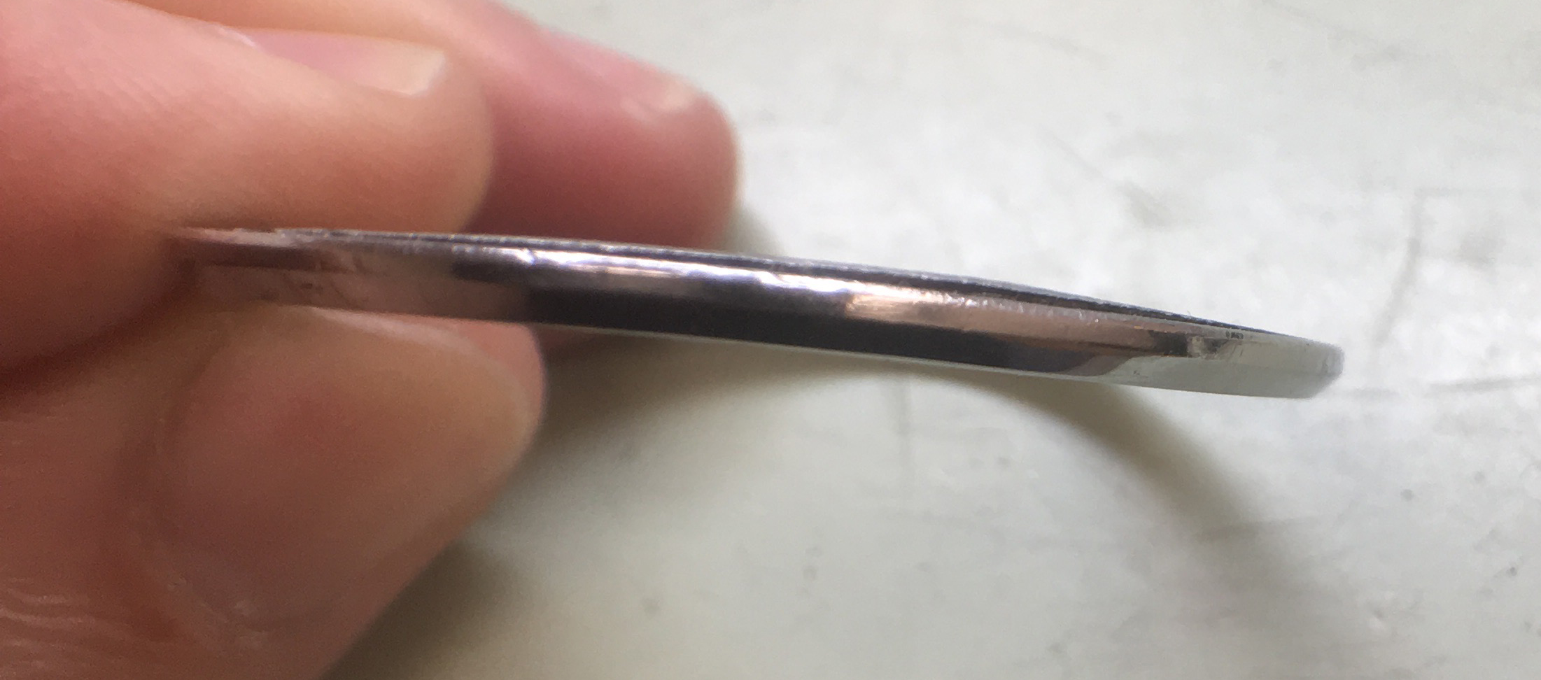

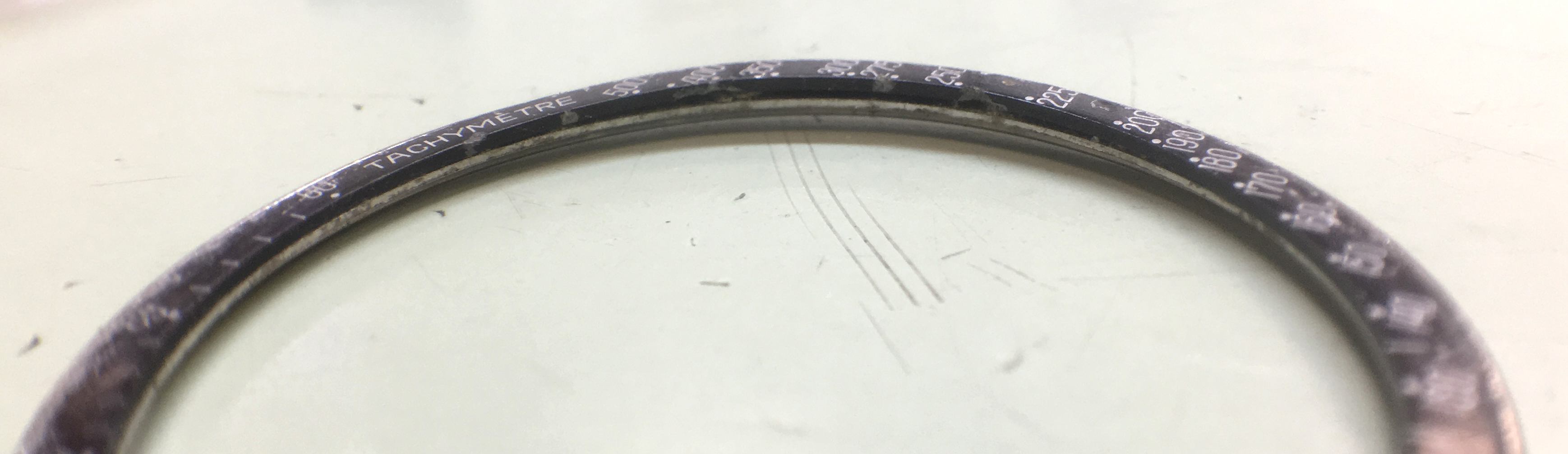

So my watchmaker is currently working on one of my Speedmasters with DON bezel. However, there is a slight problem with the DON that I would like to check with you guys if you know how to solve.
As you can see in the images the insert has lifted and dirt have entered in between the insert and the bezel. So my watchmaker does not feel comfortable to clean make any adjustments to the bezel.
Has anyone had a similar problem, and if so how did you solve it? Were you able to extact the insert, clean and put it back in?

Grab a snall knife or a cutter, carefully go between inlay and bezelring ( from inside )all the way around, lift of the insert, remove all dirt, debree etc from the bezelring, clean it with alcohol ( single malt will do 😀)glue it back in. done.
Thanks, that was my initial thought as well. Have you done it yourself?

Easy fix, no need to get all wound up. Remove as stated above with a thin/sharp exacto knife. I'd use epoxy to glue the insert back onto the bezel. Make sure to stay away from super glue as i) residue will leave white marks on insert ii) not as strong on metal as epoxy.
