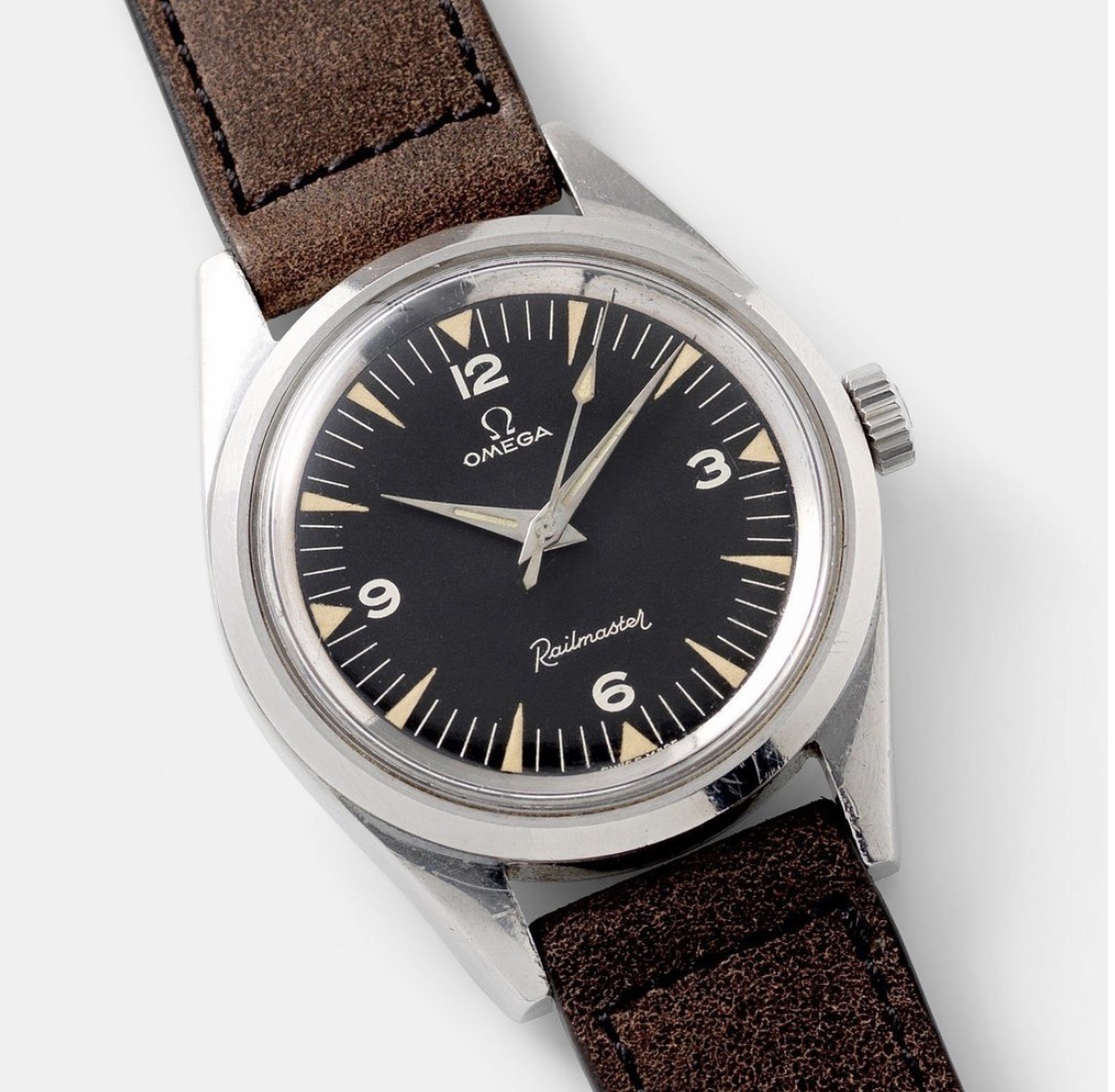

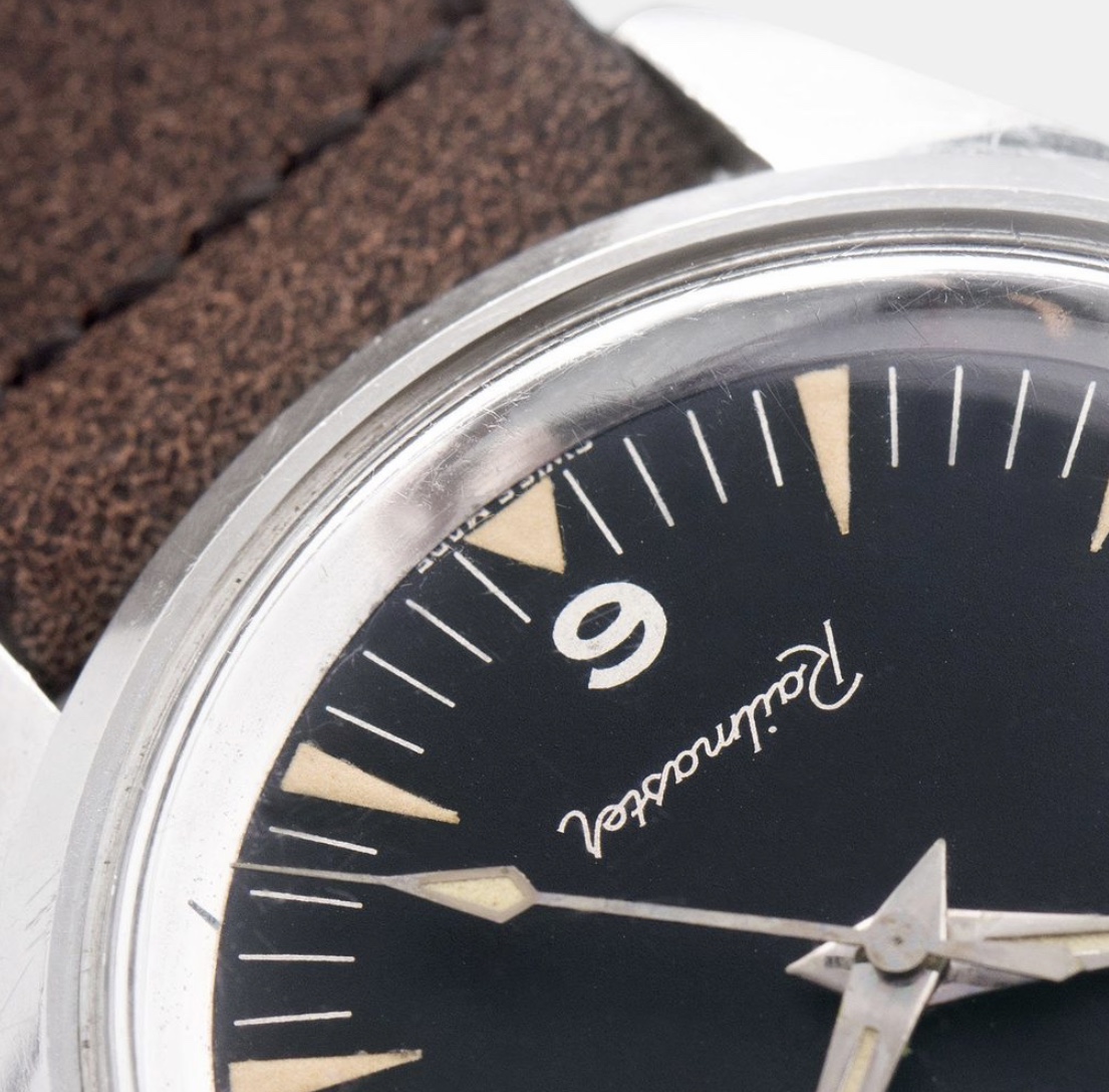

The vintage Railmaster is my favorite vintage Omega. I love the design. I’m also a Rolex junkie, but the Milgauss doesn’t hold a candle to the Railmaster, in my opinion. This one is being offered at Bulang and Sons for about 12,000 euros. At first glance, it looks beautiful. Any red flags?

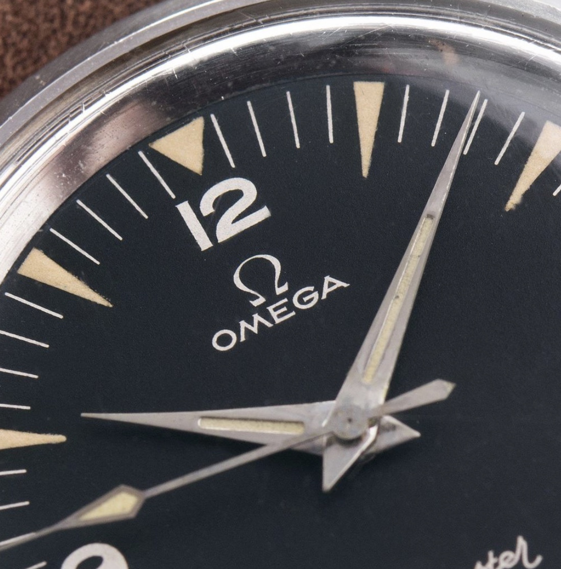

I’m no expert on these, but I find it strange that the Swiss made is half covered. It would be worth comparing with other examples.

I saw that too but assumed it was the angle of the photo.

The hands are a different color from the dial lume.
Is it me or is the lume a little sloppy? I’d love to see a UV shot and macro of lume plots.
Could all be kosher...I’ve never owned one, so don’t have my weight here.

I am also not an expert on these, but just based on what I have seen with other references, I suspect that the SWISS MADE being cut off is associated with a replacement rehaut, which is not really a big deal. Much more important is that the dial is original.

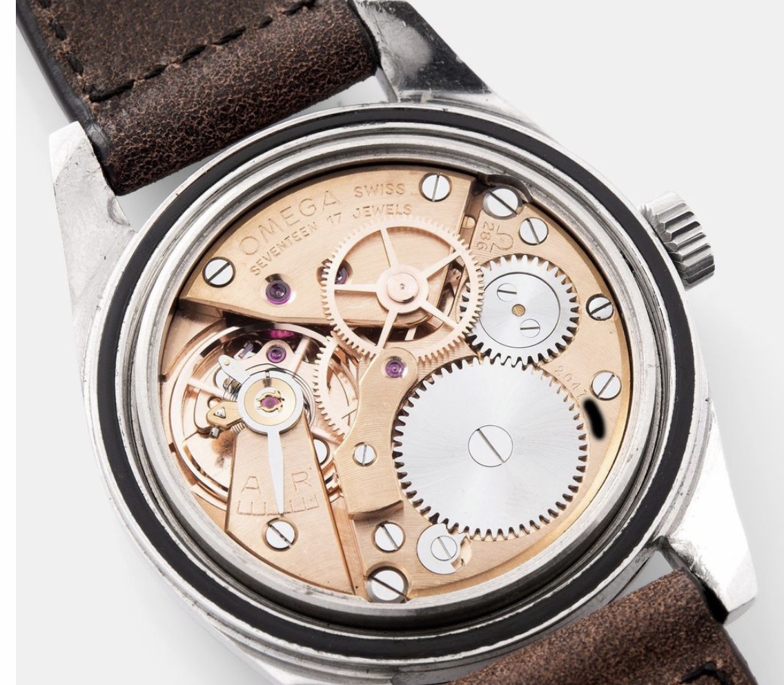

Here is a link to a very similar 135.004-63 RM that @abrod520 sold 3 years ago. Also caliber 286, 20474xxx movement number, same handset, with extract.

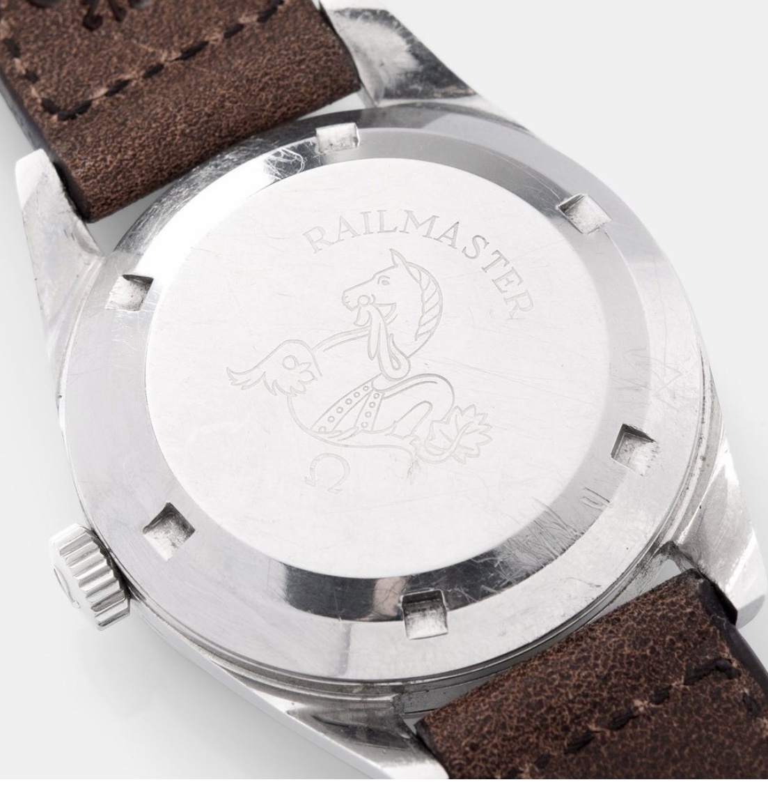

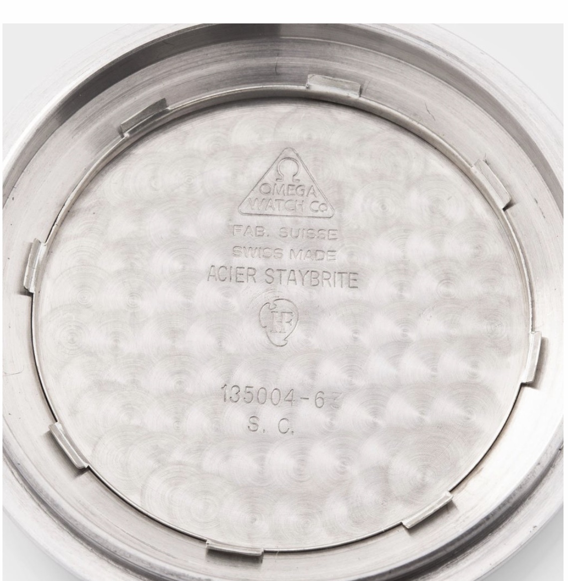

I think the OP example is fairly legit. Most 63’s have tritium lume even thought TT (or sometimes a single T) are not always present. The dial has the proper layout and recessed lume wells. I’d be concerned about the hands and dial being relumed as the lume is very uniform in color and bright. Also the lack of a pic of the mag cover needs to be addressed.
Thank you for the response. The lume appears too good to be true?

Dial lume is about the right color, though it’s maybe a bit too tidy? I’d want to see this in person because I have a feeling the photos might not be revealing some texture on the dial and lume. Otherwise, everything does check out
2,086
2,899
Looks like a very nice and well preserved, original example. The "SWISS MADE" being cut off is as it should be, so the rehaut / tension ring is correct.

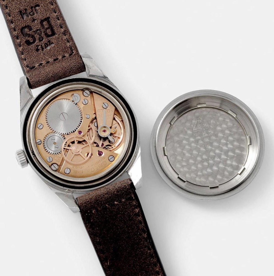

When I zoom in on the photo of the movement on this watch, it appears as though it’s the cal 285 movement, or are my eyes deceiving me? This should be the cal 286, which would be period-appropriate. It is advertised as a 286 movement in the writeup.
Looks like 286 to me:

hands being a different color is very common in vintage watches, no red flags there. L’ultime always look “sloppy” closed up, that’s normal as well.

Beautiful watches will always command high prices. I’m willing to pay more for an exquisite specimen. Donny Bay is the dealer at Bulang, and I have heard from other sources that he is reputable. The watch market does feel to be cooling some, so there is likely room for negotiation here. The audience for Railmasters is not large.

It looks really nice. It’s normal that there is a little difference in the color of the lumen between hands and dial. I have once been told that it has something to do with the oxigene. That the hands are getting oxigene on both sides, and the dial only get’s from on side (the top). That’s why the lumen develop differently. I dont know if this is the correct explanation.
