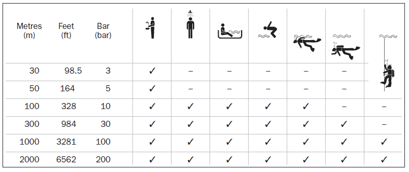

OMG, so sorry for you. Were you able to salvage it? However, this would be consistent with my understanding of water resistance ratings. So, 50m water resistance with crown unscrewed means splashes of water from rain showers and hand washing only. See table below and my reference link:
https://thewatchmaker.com/water-resistance-101/
