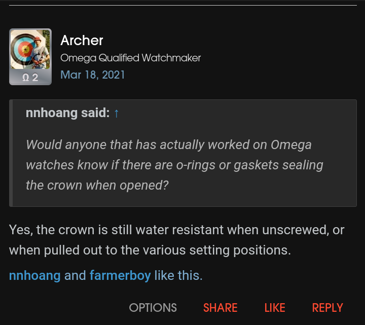

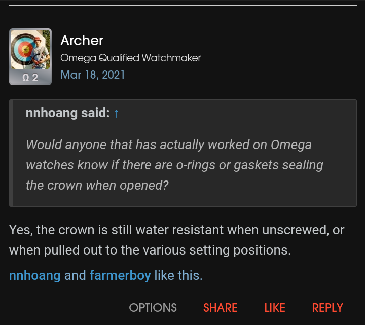

"Even if the valve is unscrewed, and we strongly recommend that the valve remains screwed down whenever the watch is immersed in water, the watch is still water-resistant to a relative pressure of 5 Bar (50 metres)."

Did yours pass a WR test in the past year as this is what @Archer has posted regarding an unscrewed crown;
