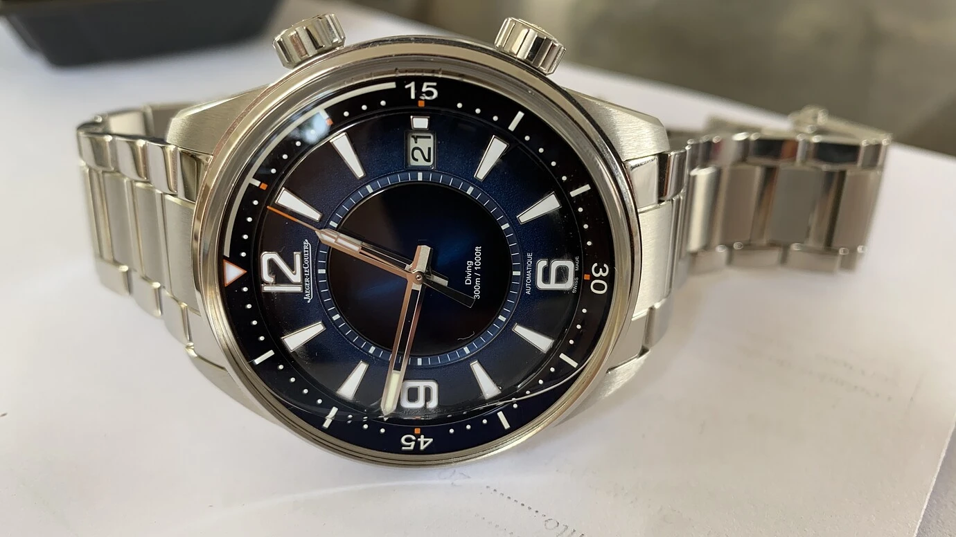

If they don't forget, this one (not mine) which was sent to the JLC service center to have the seconds hand changed, was posted on a local forum:

Yikes, that's scary

Big oooooof.

Was that the US service center?

Yes, it would have had pressure testing done to it if it was a proper Omega service center.
