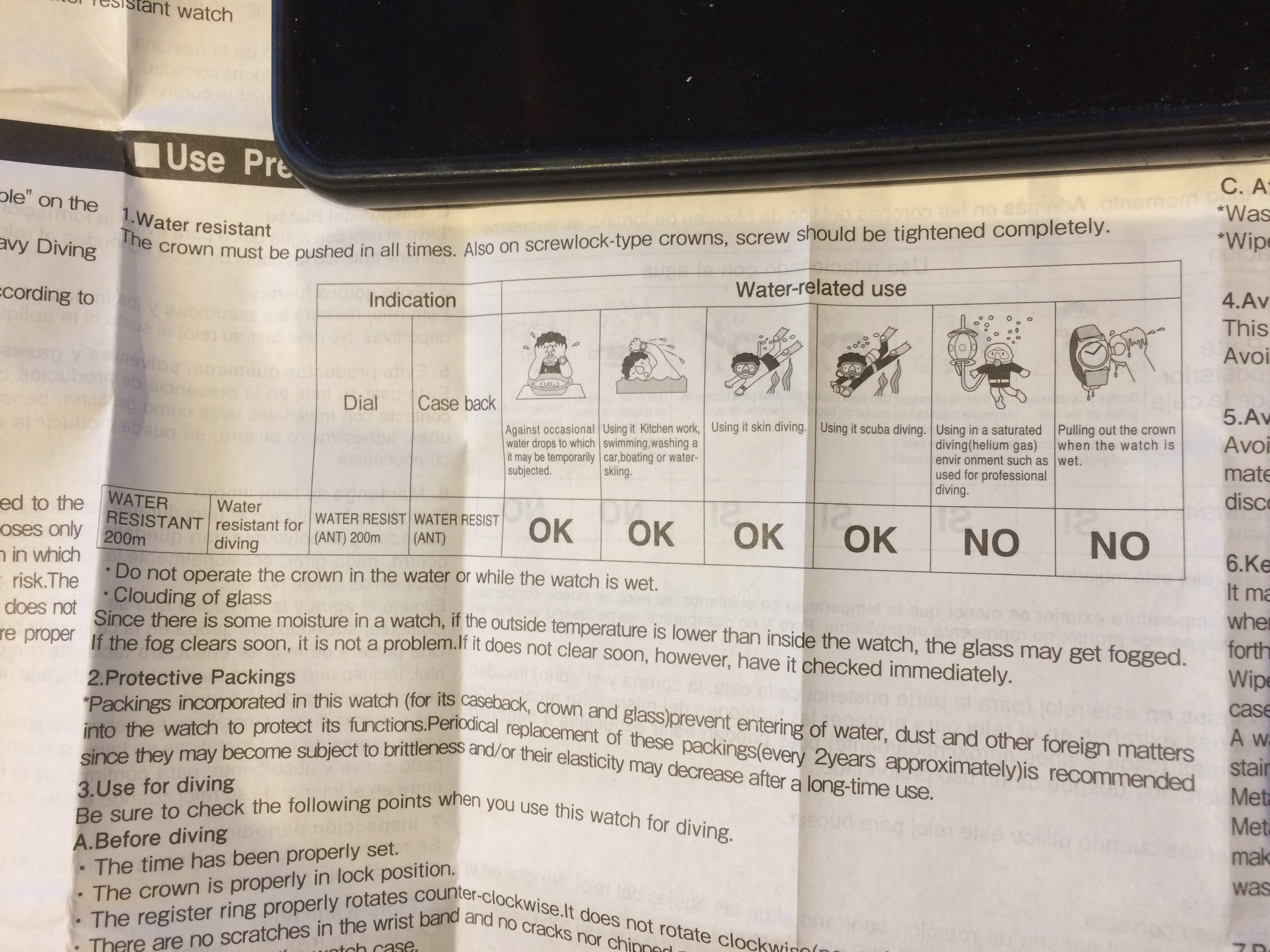

They're not very consistent, because I'm currently reading the instruction leaflet on my new Citizen diver, rated at 200M, which specifically clears it for scuba diving. What model are they advising can only be used for snorkelling?
One from 20+ years ago but then my memory could be wrong. Probably is 😀 I recall thinking, "200m is loads, why can't I scuba dive with this? What rating do I need then Citizen?"
572
754
Or they just changed in 20 years, which is more likely. In case it is interesting, here is the guidance from my Fugu (2019):
