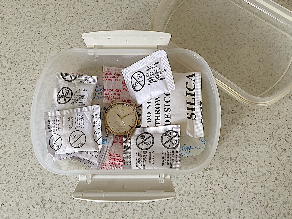

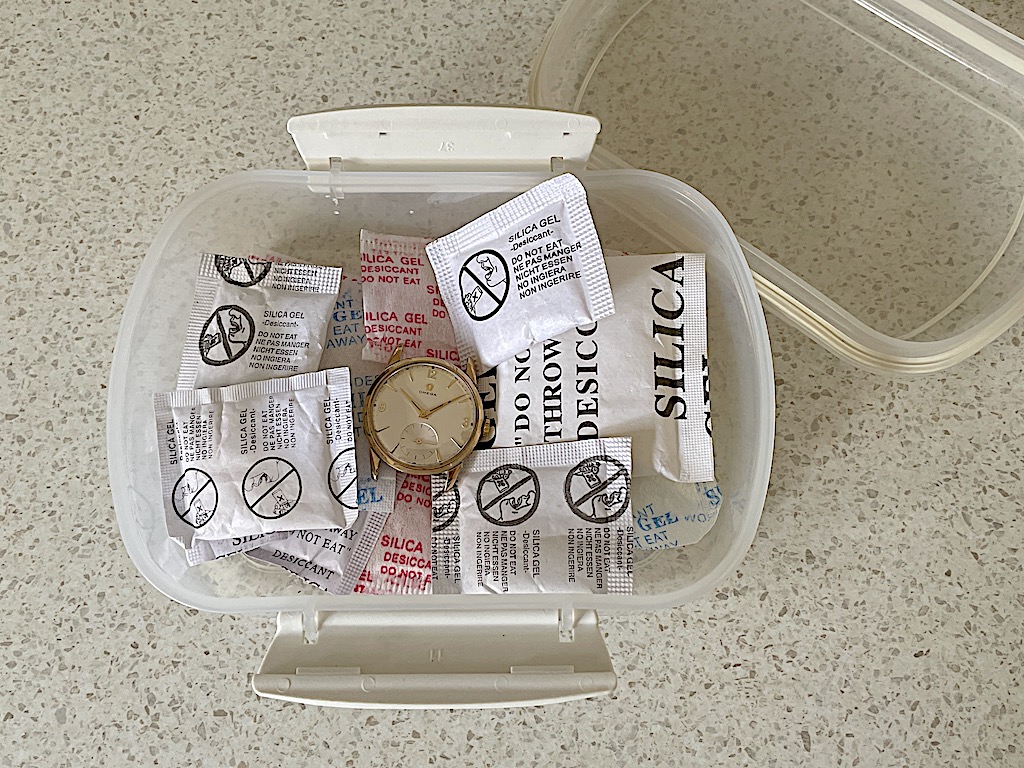

WARNING
It's EXTREMELY important to not use Damp Rid.
It's based on Calcium Chloride and is highly corrosive to metals.
Good to know!
Would it be OK if the Damp Rid doesn't touch the watch? I meant (but did not explain) to put both items into a larger sealed container, just taking the top off of the Damp Rid container and not putting the watch into it.
18,840
39,182
Good to know!
I wouldn't recommend it. Get some silica gel instead.
If you have some damp rid, put something metal (nails, small washers) in a sealed container with a damp rid tray and see how it goes.
Silica Gel is easy to get and keeps for ages in a proper container.

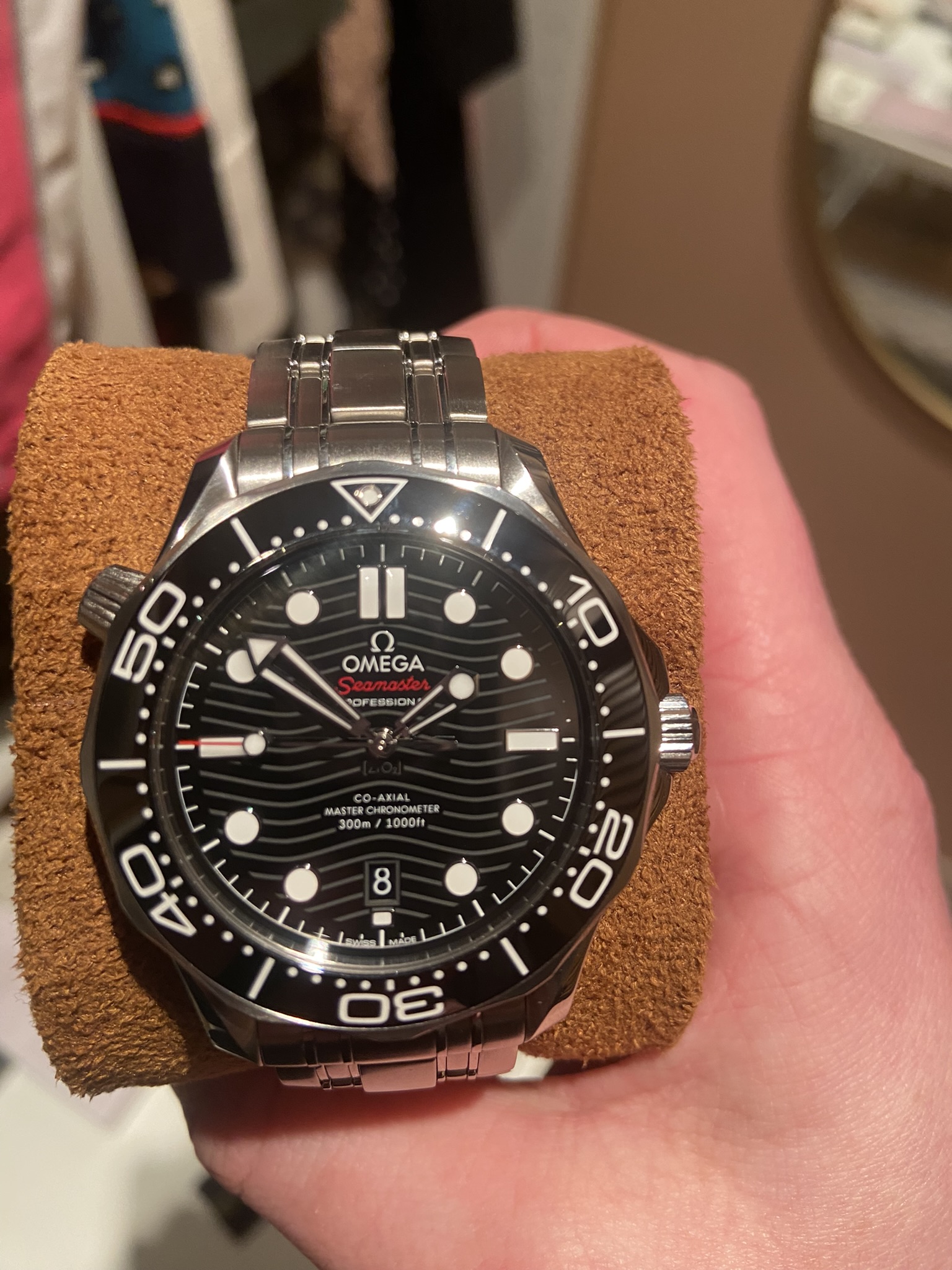

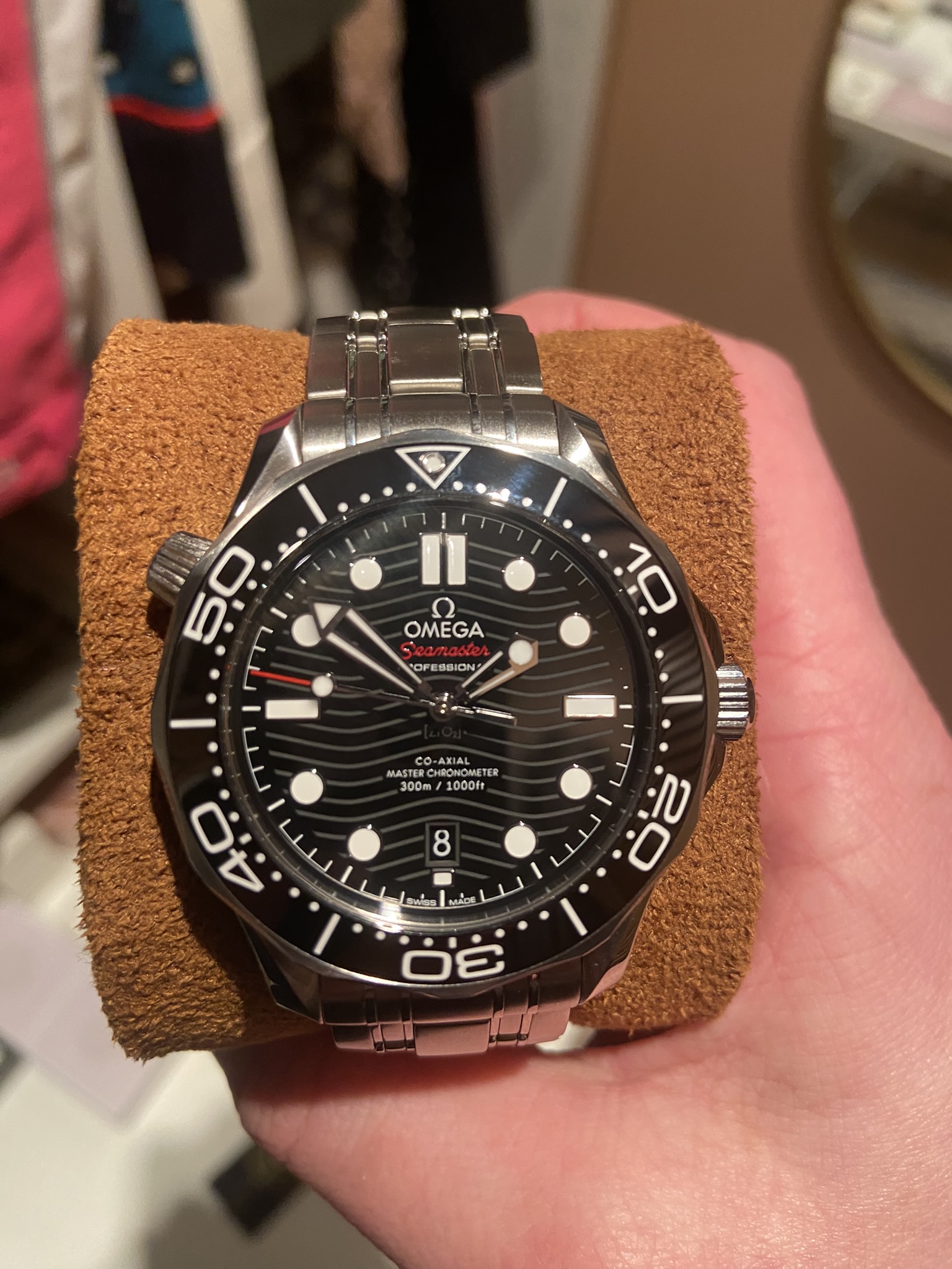

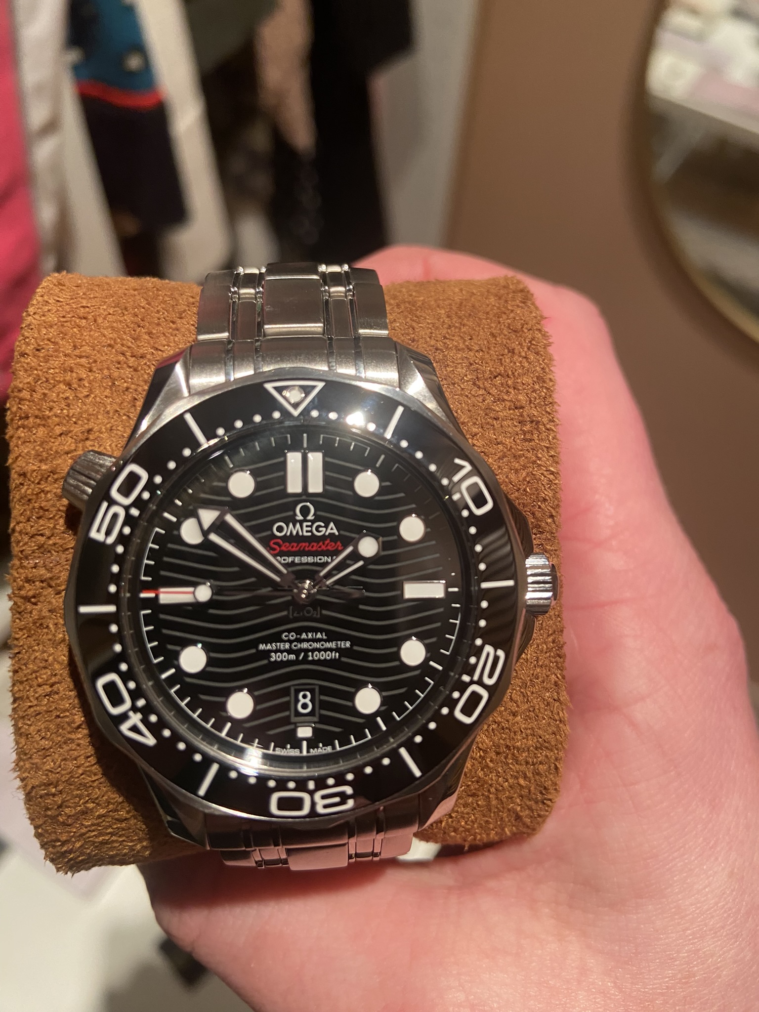

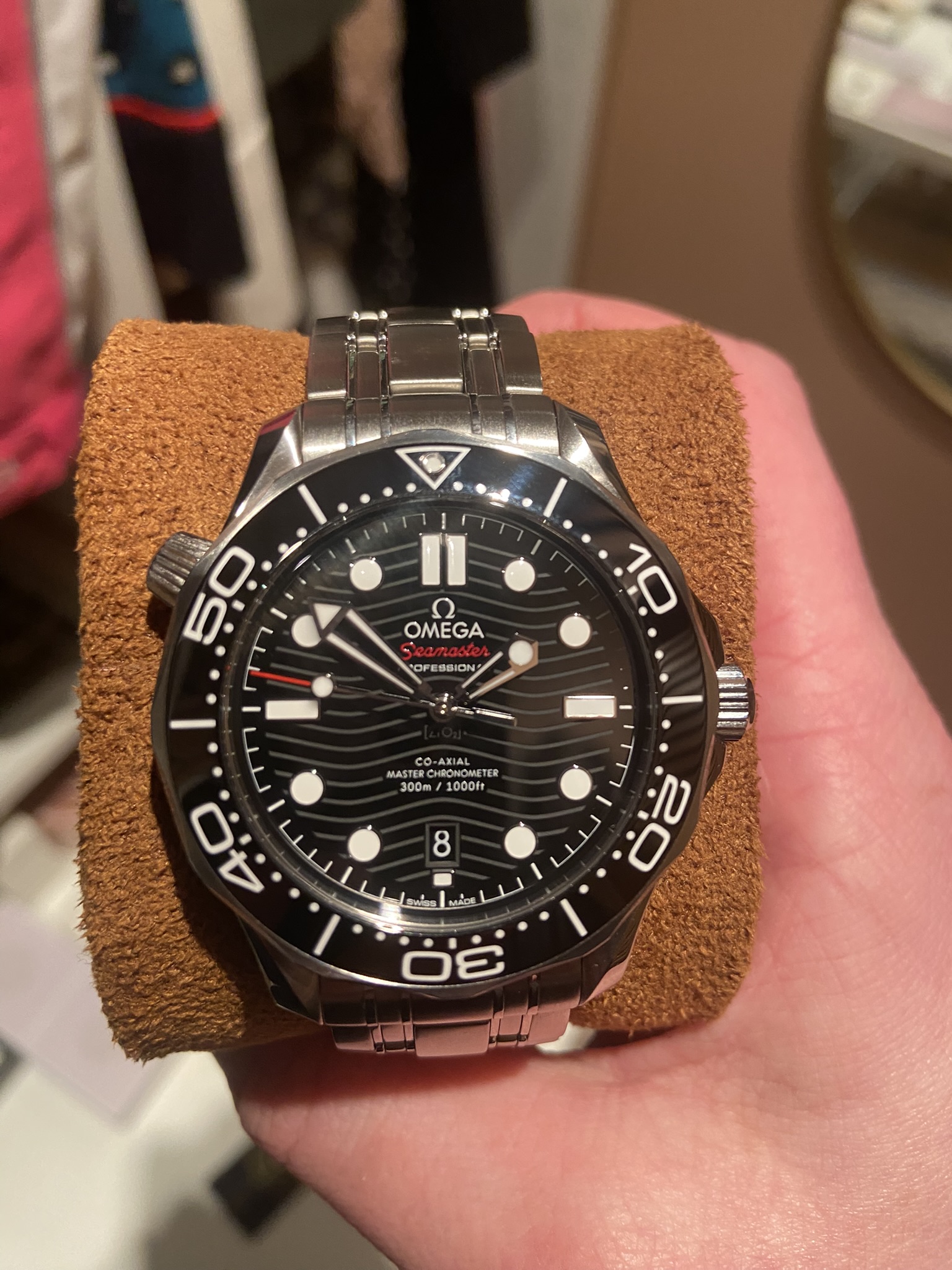

Anyone came across this before ? Face has completely went off centre. Bought May 2022 predicted time to get it back 12 weeks which is over a quarter of the time I’ve owned it…
30,285
78,163
Did the watch receive a shock? Usually this is the cause of this sort of thing.
3
No, omega shop examined it and said there is no sign of damage on the outside and have never saw it before
