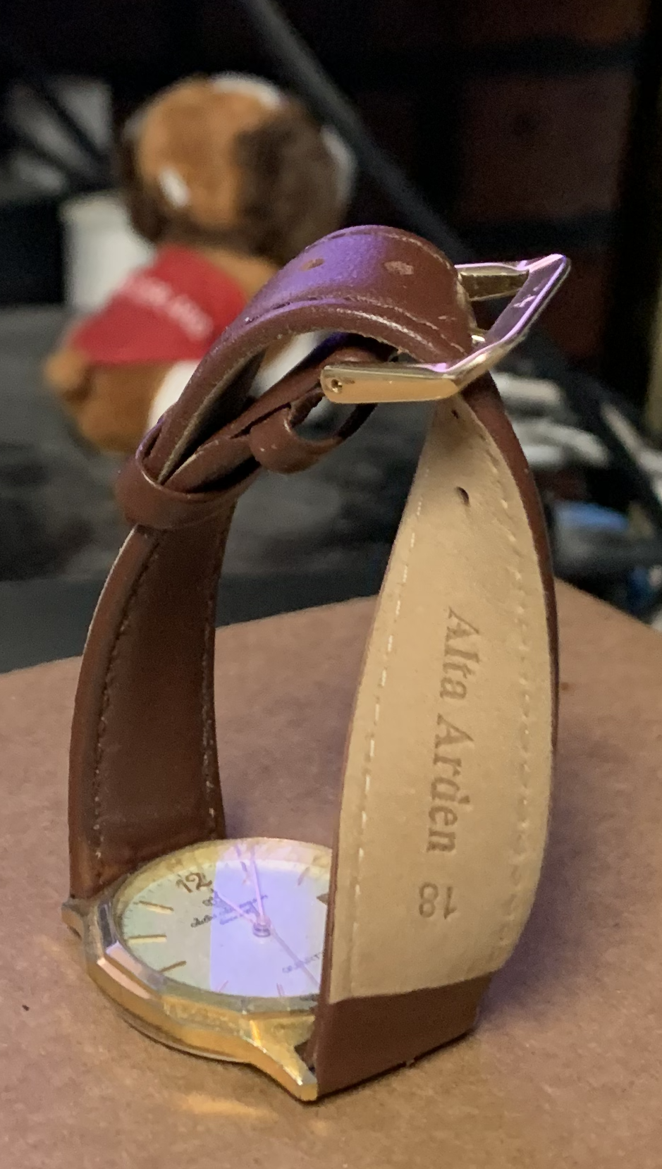

I would think that Damp-Rid or any other dessicant is better than raw rice.
WARNING
It's EXTREMELY important to not use Damp Rid.
It's based on Calcium Chloride and is highly corrosive to metals.
For emergency drying, the safest stuff is silica gel which can be obtained from many sources. I use packets of it in my safes and in my camera cases and have never had any corrosion issues.

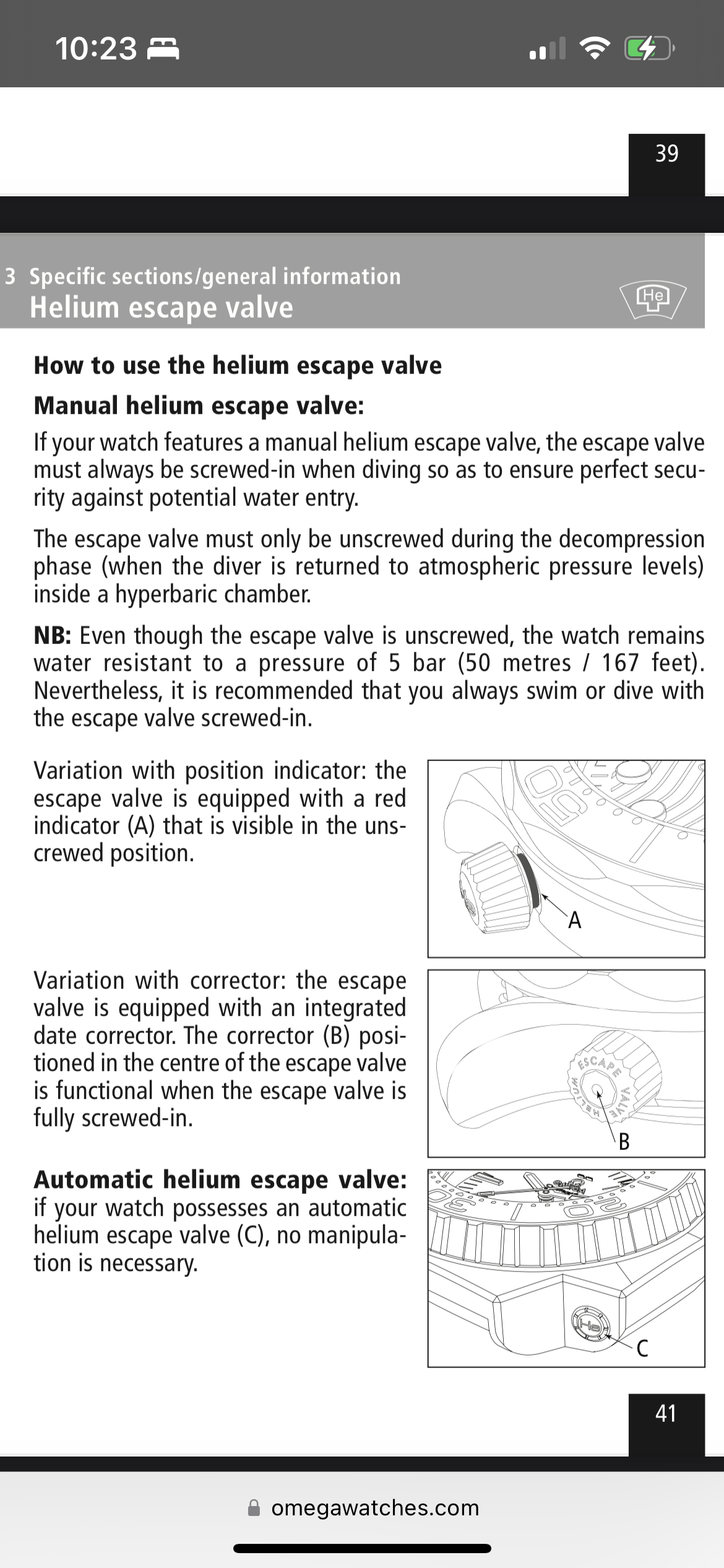

Even with the HEV crown unscrewed, the watch has 30m (or is it 50m?) water resistance unless internal pressure unseated the relief valve at the same time the watch was being rinsed. Or the watch is past due on service and a seal failed in the interim. Unfortunate, if so, but I would open it up and let it dry out while booking a service immediately. I'd be contacting every watchmaker I could and not just rely on Omega, my AD, or a boutique.
I think the 50 meter water resistance in the helium escape valve is unique to the most recent models, only.

When I’ve had soggy watches, I always take of the case back immediately, either put inside a window with the sun on it, or if it’s a shitty day in a room with a dry heat source such as an reverse cycle air- conditioner or failing that an electric fan heater will do (not directly blowing on it but across it close above) should buy you time until it can be dealt with properly.
Back when I used to do a lot of marine work, people would bring in outboard motors that had either fallen of the back of the boat, or got drowned when the boat had sunk, to their horror, the first thing I’d do was wheel it out to the jetty, attach a chain to it, and throw the bastard into the lake until I’d get around to working on it.
It was better off in the water where the corrosive effects of oxygen exposure were greatly lessened.
Now don’t do this to your watch as you most likely only have a very small amount of water ingress ( there’s on point getting water into where it hasn’t got yet)
I only really mentioned this so as to point out that you need to act quickly and if that’s not possible then you need to adopt a harm minimisation strategy…. Damage control if you like.
Sometimes you need to do something counterintuitive to solve problems.
Best of luck
I'm pretty sure not. The valve isn't even open unless there's internal pressure. The HEV crown is just a positive assurance.

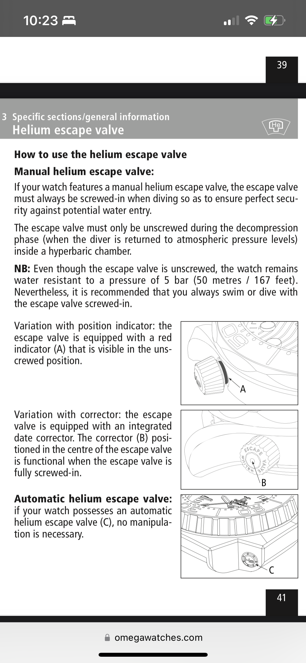

the OP’s watch looks pretty current.
here’s the section in the Omega manual about the helium escape valve, it states the watch will still have a 50m water resistance.
