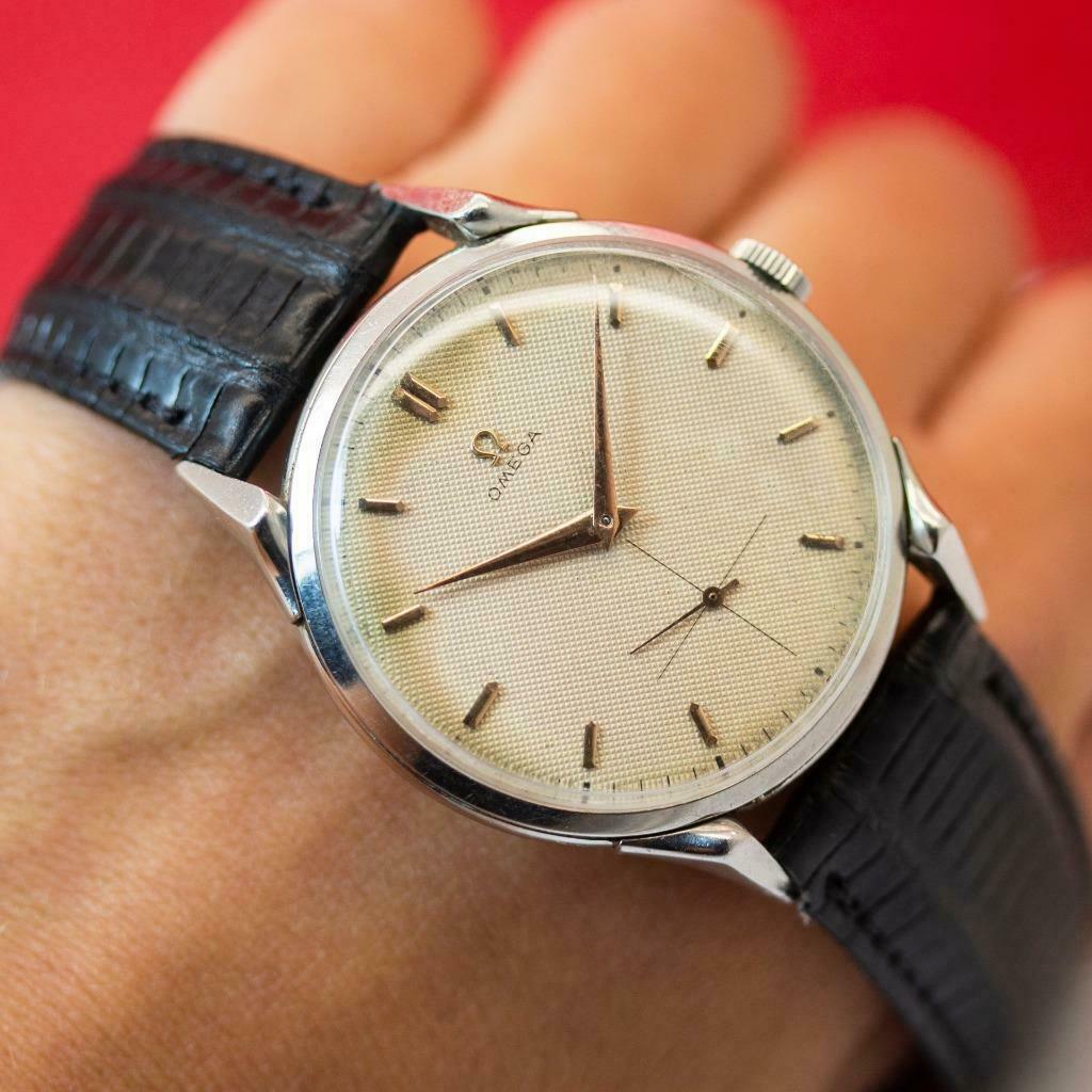

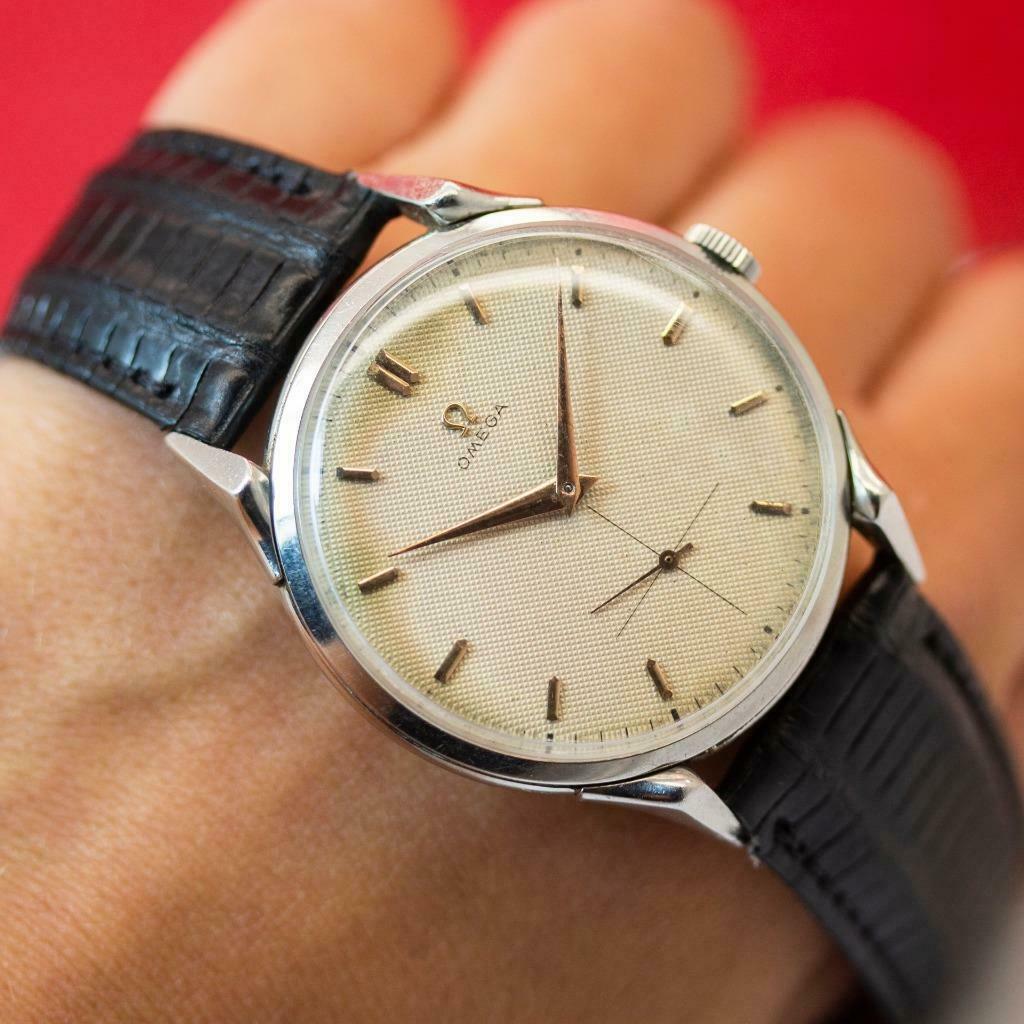

Here is one of the watches I have coming.
