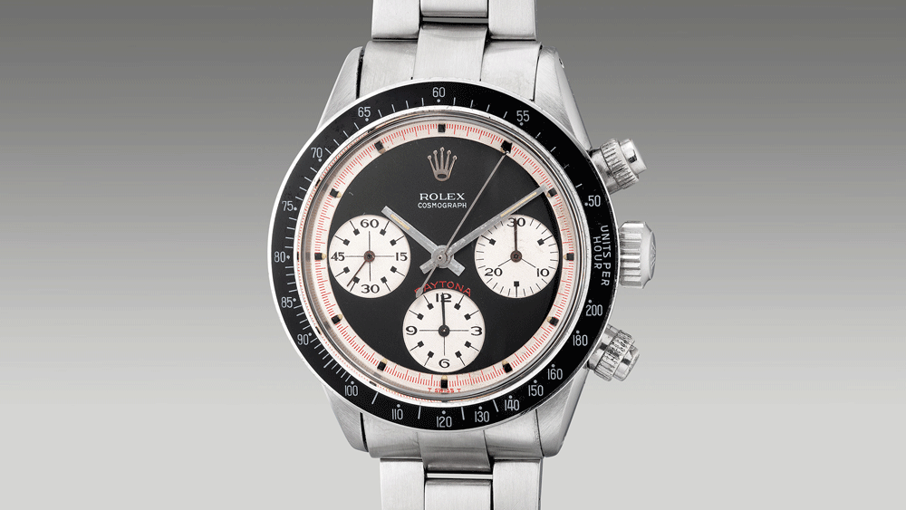

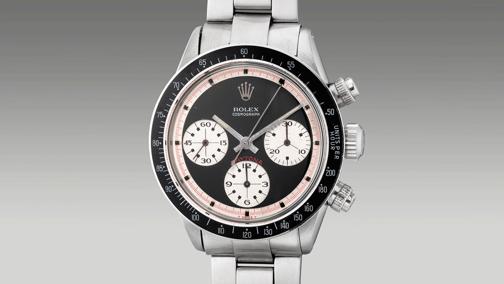

I was trying to make a point and perhaps did not use the best reference example of a Paul Newman...the 6239 is water resistant, and I found this brief article from:https://malalan.eu/over-17-million-dollars-for-rolex-daytona/
"Paul Newman supposedly got this watch as a present from his wife in 1968; the timepiece has the reference number 6239, and is engraved on the back side with the words: “DRIVE CAREFULLY”. He wore it for several years and used it to keep time on various races in the USA and even at the 24 Hours of Le Mans race. He also wore it while swimming, performing, working and generally wore it on his wrist most of the time. In 1984, while building a treehouse, Newman asked his daughter’s boyfriend about the time and because the man didn’t have a watch, he gave him his Rolex Daytona. Paul Cox wore the watch with great pride for over a decade and didn’t realise until the 1990s that a true collectors’ cult has formed in horological circles around his particular timepiece."
So perhaps to make the point that one shouldn't swim in a very expensive vintage watch I should have used the Paul Newman reference model
6240, sold for over 350,000 USD in 2018 at Phillips, which was depth-rated to 50 meters or 165 feet.
Image from Robb Report

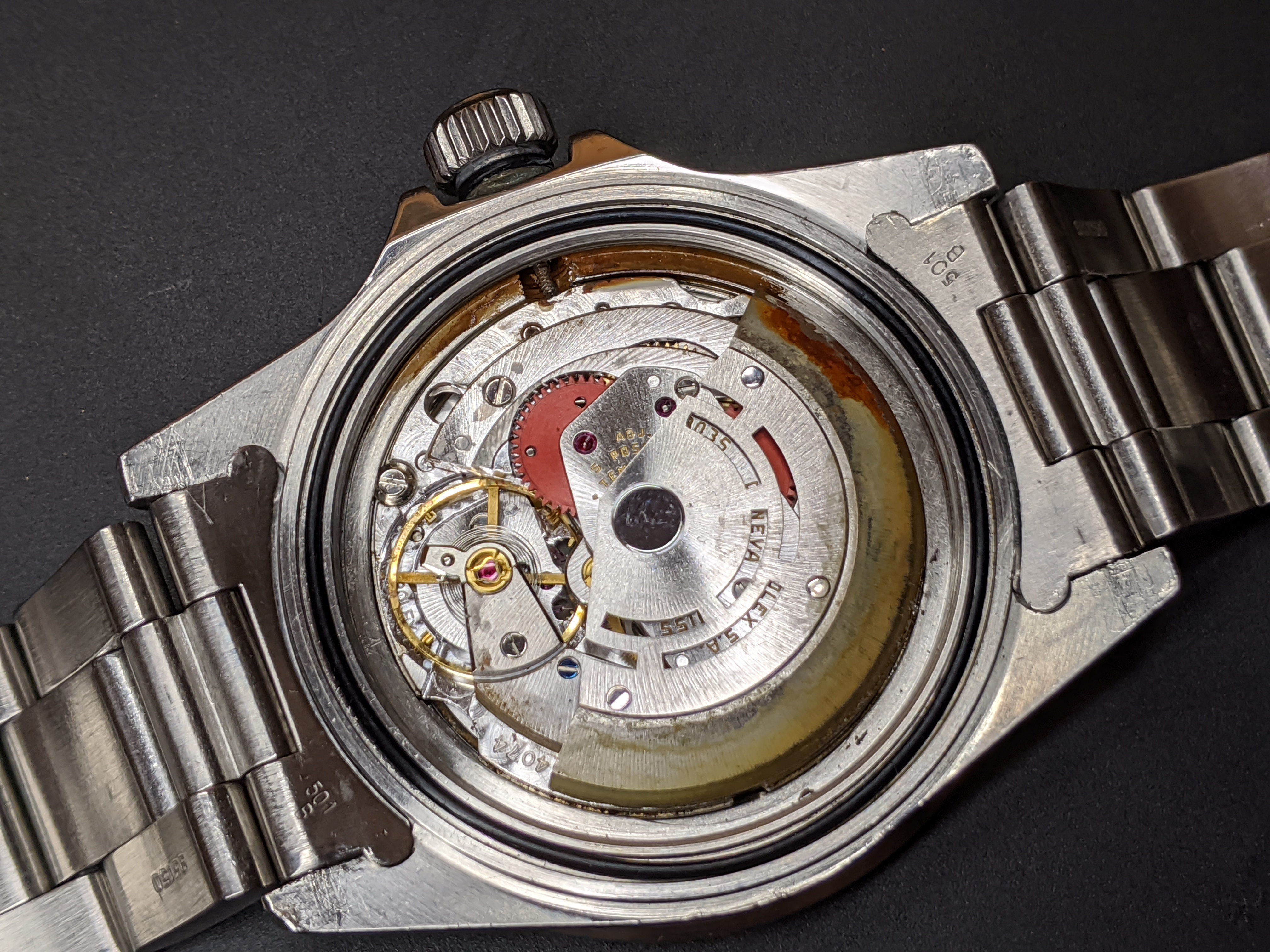

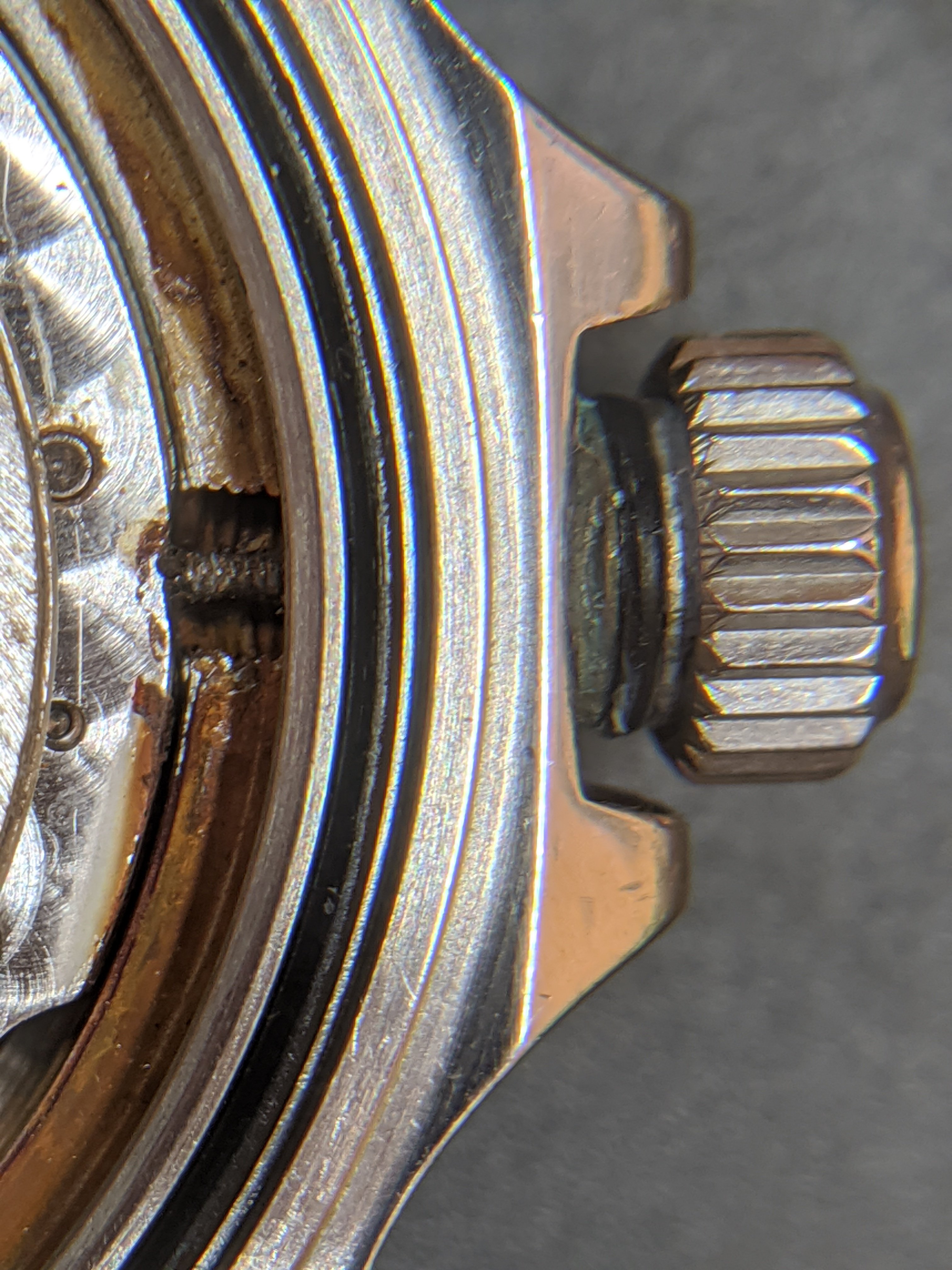

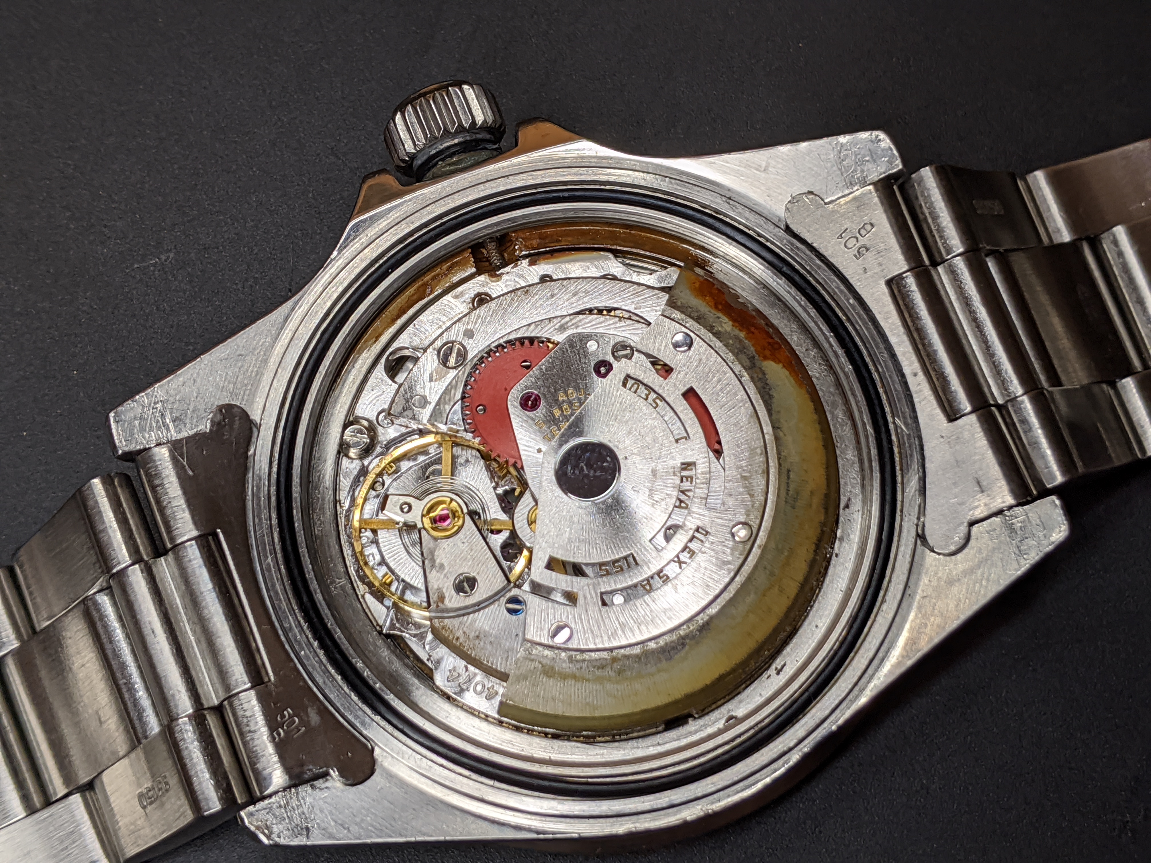

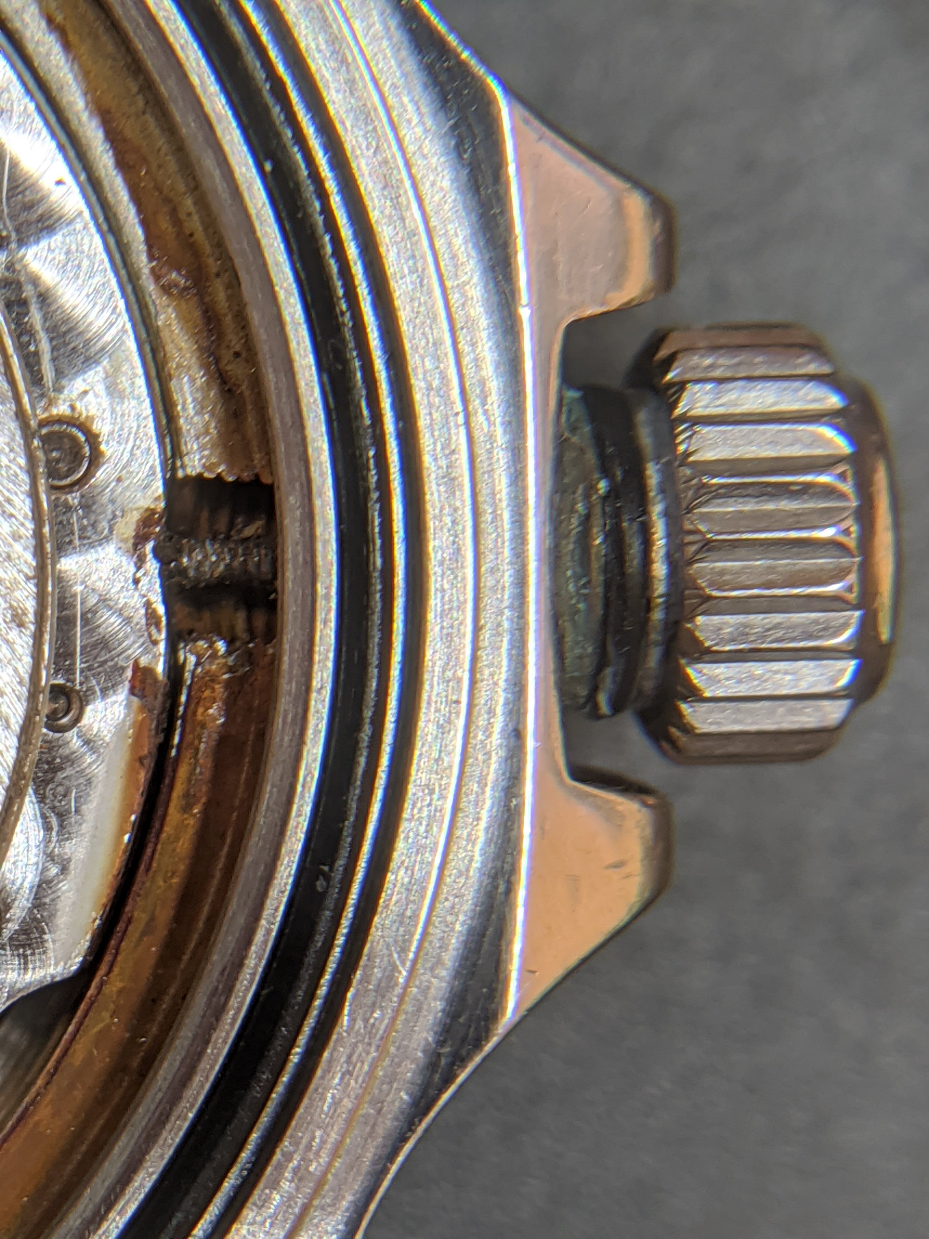

The latest on this saga......
I sent the Sub to Simon Freese who very kindly took a look and sent me the following report and photos:
The water has entered via the crown, and has caused extensive rusting to the movement components. The seals on the crown and the case back have been changed, but the tube and crown have not. In order to provide adequate protection to be submerged in water, this watch would have required a new crown and tube, both components are in worn condition, this can be seen in the attached image. It is likely that the watch would pass a basic pressure test with the existing parts, but not provide the level of water resistance required for water based activities such as swimming or even bathing.
Simon is unfortunately not able to repair the watch as he's not an accredited Rolex watchmaker so it's now been sent to Steven Hale (Simon's recommendation). I'm waiting for Steven to give me the bad news....
I have a couple of questions:
1) I hold the original watchmaker responsible for this as they told me that they are (a) Rolex accredited and (b) that the watch was good for swimming. It would be good to know what others think about this? Getting them to pay for repairs won't be easy but I do think I should at least try. Once I know the cost, I'll also consider making an insurance claim.
2) I'm starting to doubt that the original watchmaker is really Rolex accredited. Are the forum members aware of a way to check this? Would Rolex tell me if I asked?
Anyway, thanks again for all the help I've received in this thread. It has definitely allowed me to progress things faster than they probably would. It will cost me a bit but hopefully I'll have a working watch back in my possession before too long.
thx
Fergus
To me, that photo shows convincing evidence that the crown tube was not changed recently. It's bad that they didn't do this originally (or at least they should have suggested it). I guess it really depends on what you communicated to the watchmaker originally. If you indicated that you wanted to preserve all the original parts, they may have tried to do the best they could without changing parts. But if you indicated that you wanted the watch to be as water-tight as possible, the fact that they failed to change out the tube and crown could indicate that they don't have a Rolex parts account. As I mentioned previously, very few watchmakers still have that account.

I hope you have in writing from the watchmaker that did the original service.... “ watch is water proof and good for swimming”... something along those lines.
Have you discussed any of this with the previous watchmaker now that you have proof that tube and crown were not replaced and thus the cause of the damage?
It will be a costly repair. Insurance might be your best course of action, but, I’m curious what the watchmaker will now say instead of the initial... “ you must have left crown open”
I'm guessing he's going to stick with the "crown open" theory. But it would still be worthwhile to send him those photos so he realizes that you understand the full situation.
