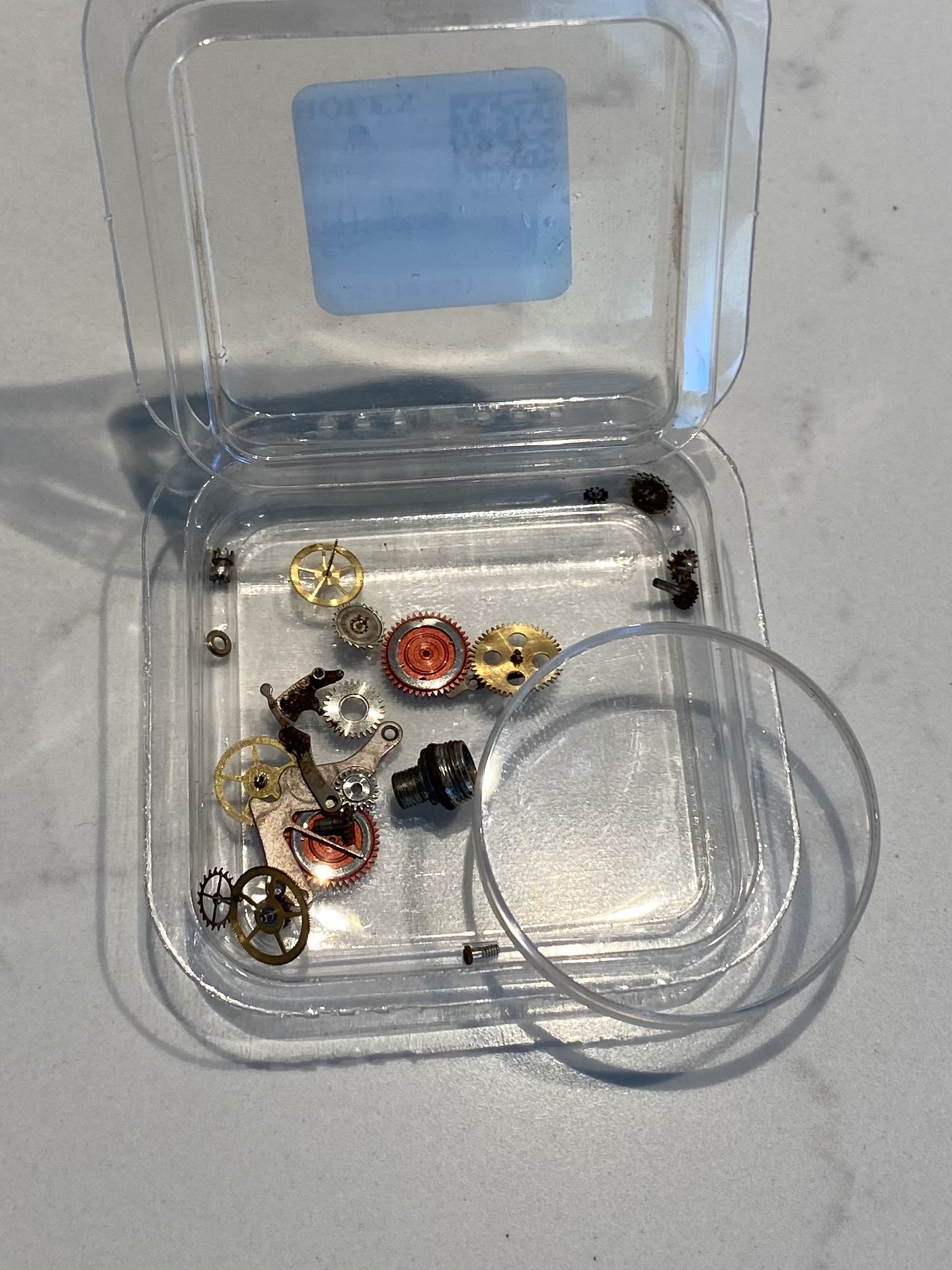

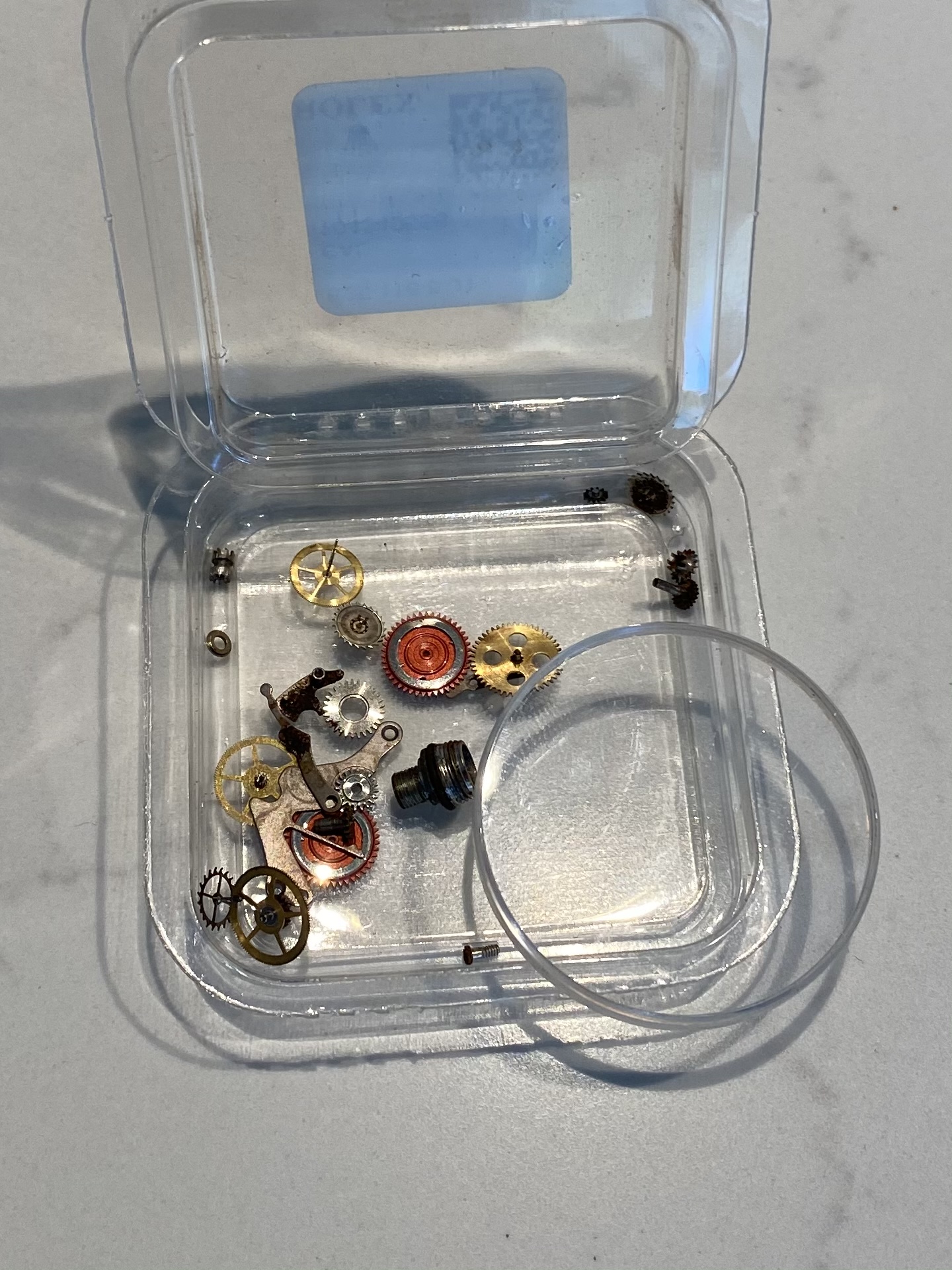

Hi - I wasn’t sent a list but quite a few parts were returned to me (see photo).
Unfortunately the original watchmaker refused to take any responsibility at all and I paid for the repair in full. This was disappointing given that it was discovered that the crown gasket hadn’t been replaced during the original service. It had started to disintegrate and this is how water probably entered the case.
Lesson learned to be very careful when choosing a watchmaker in future!

It's unfortunate that the original watchmaker would not take any responsibility. Looks like water made it quite a ways into the movement, but the good thing is the balance was okay - that's often the big ticket item when there's water in a watch, at least in terms of the movement.
Also good that the dial and hands came through it okay!

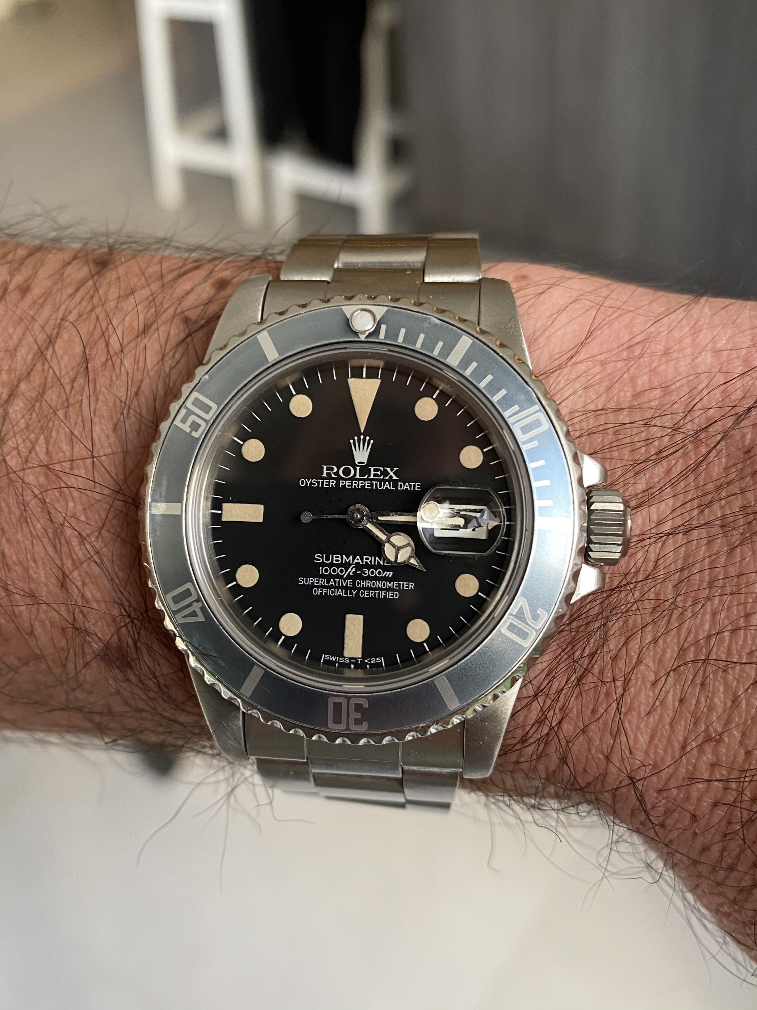

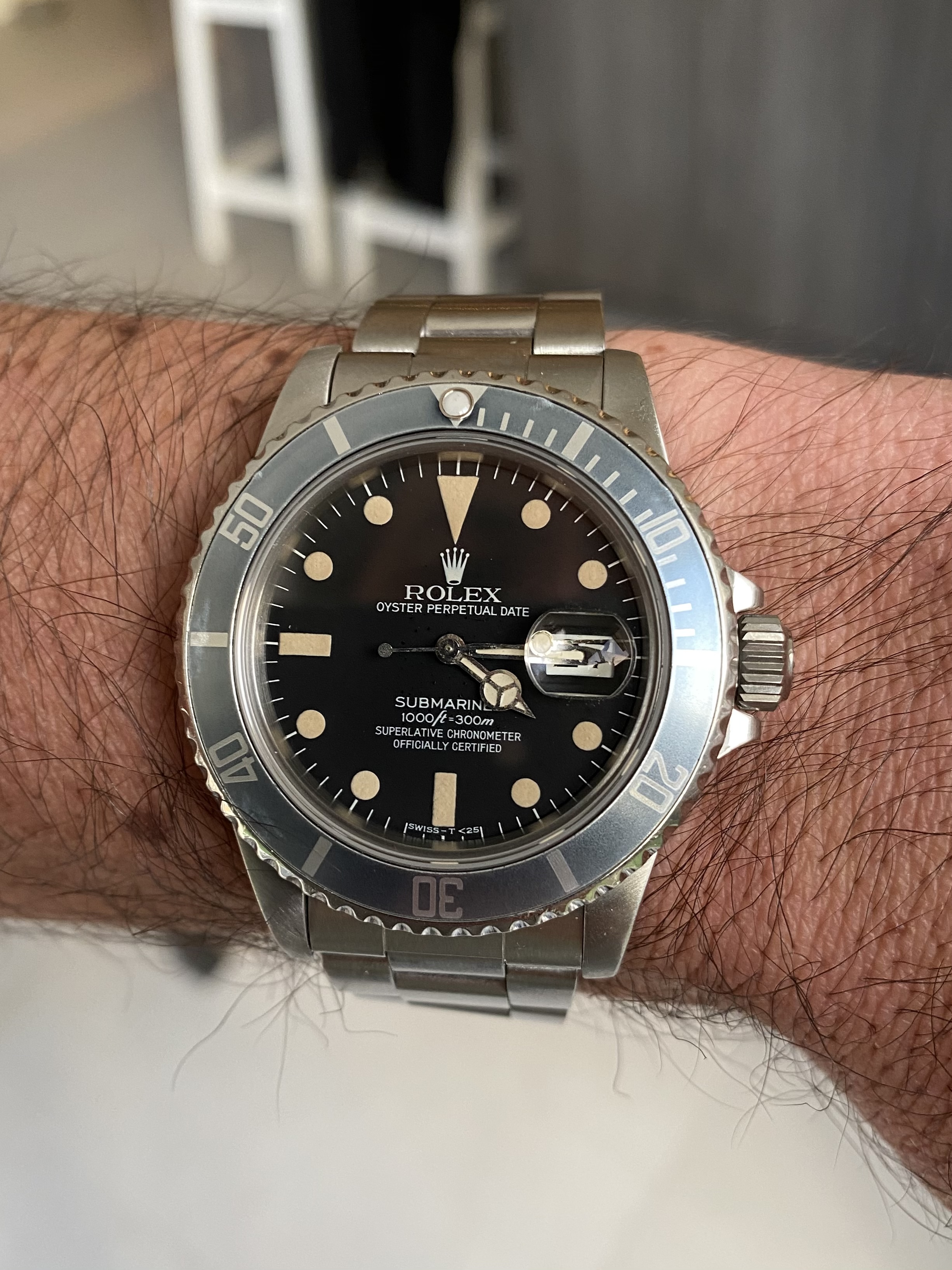

I hadn't been wearing my beloved 16800 much so decided to have it serviced last month and bring it on holiday.
First day at the beach and after a little bit of splashing about with the kids, this happened...
I called the watchmaker who told me to unscrew the crown, pull it all the way out, and leave if somewhere warm for 24 hours. I followed his instructions and now the watch has stopped working completely. It's stopped running and if I try to wind it, the crown spins with no resistance at all.
I've put the watch away and will bring it back to the watchmaker on Monday as I'm still away from home. Can anyone give me any idea of what has happened and should I trust the watchmaker to work on the watch for a second time. First time, they replaced the gaskets and pressure tested the watch so I'm not sure how it could have failed just a few days after being serviced. Or should I bite the bullet and find someone else to carry out the repairs?

From the photos you posted with the case open the watch looks like it has been sufferings from moisture entering the case due to long overdue service. Too bad the first watchmaker wasn't more upfront about just how much would be required to make the watch as best as it could be. What you got back was not really a full service. Another issue is Swatch group and Rolex and others makers, won't sell parts anymore to independents. I hope you got things sorted now. It is too nice a watch to give up on.
