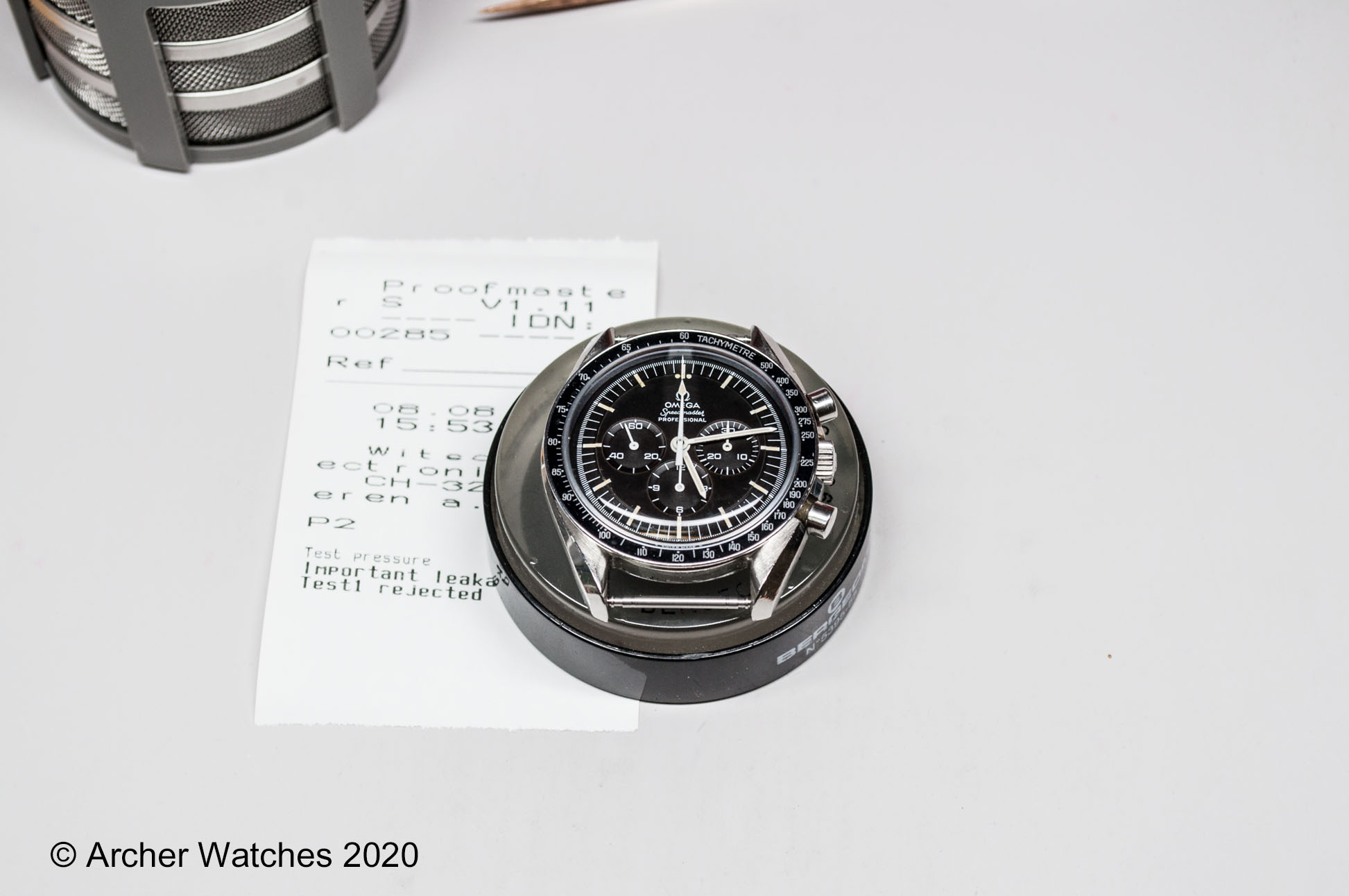

Were you given any evidence of a pressure test, like a printed strip of paper, that might look like this perhaps (left of the watch):
If not, was anything given in writing that it passed?

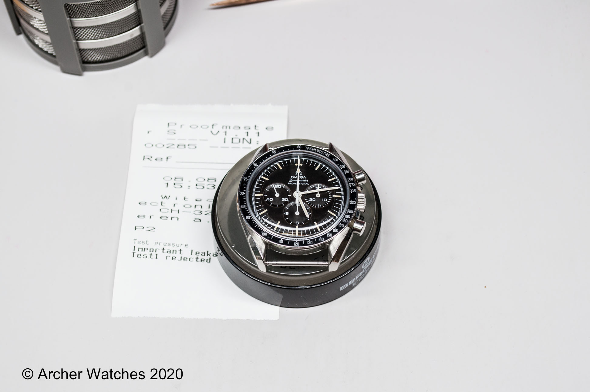

Thanks again - this will allow me to ask some more pointed questions. All I have is a WhatsApp message that says it passed the pressure test. I’ll ask for some documentation like the example you gave me.
