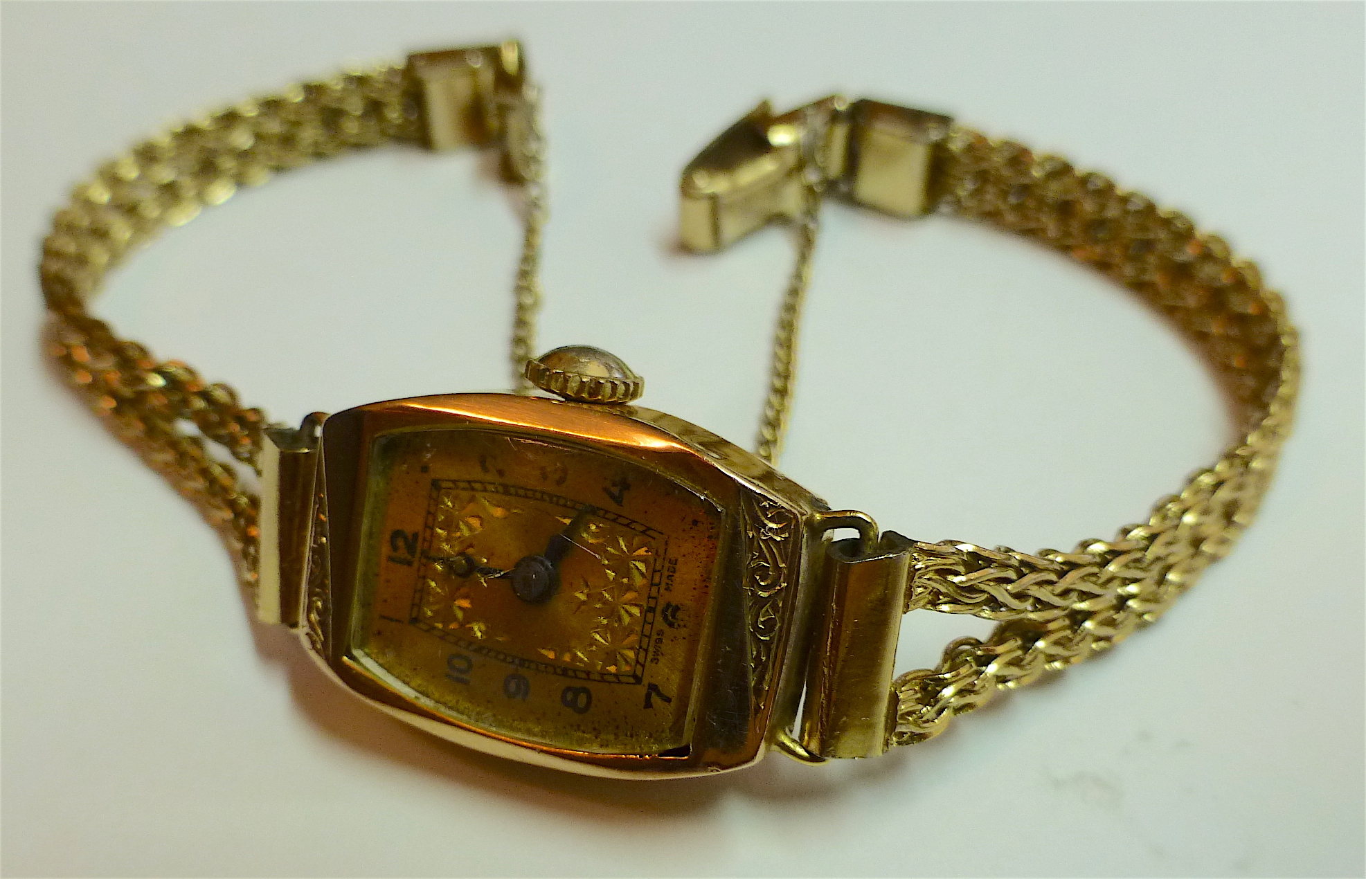

The previous watchmaker (or whoever touched it last) was a scoundrel. The dial feet screws had been lost and substituted by some putty like goop, the setting lever screw was broken and there was one barrel bridge screw missing. It took me about three hours of stripping old movements, measuring the items, doing extra cleaning and checking the fit, lucky I kept all that junk!
So it's finally all cleaned and assembled and running like a ............., well, you know.

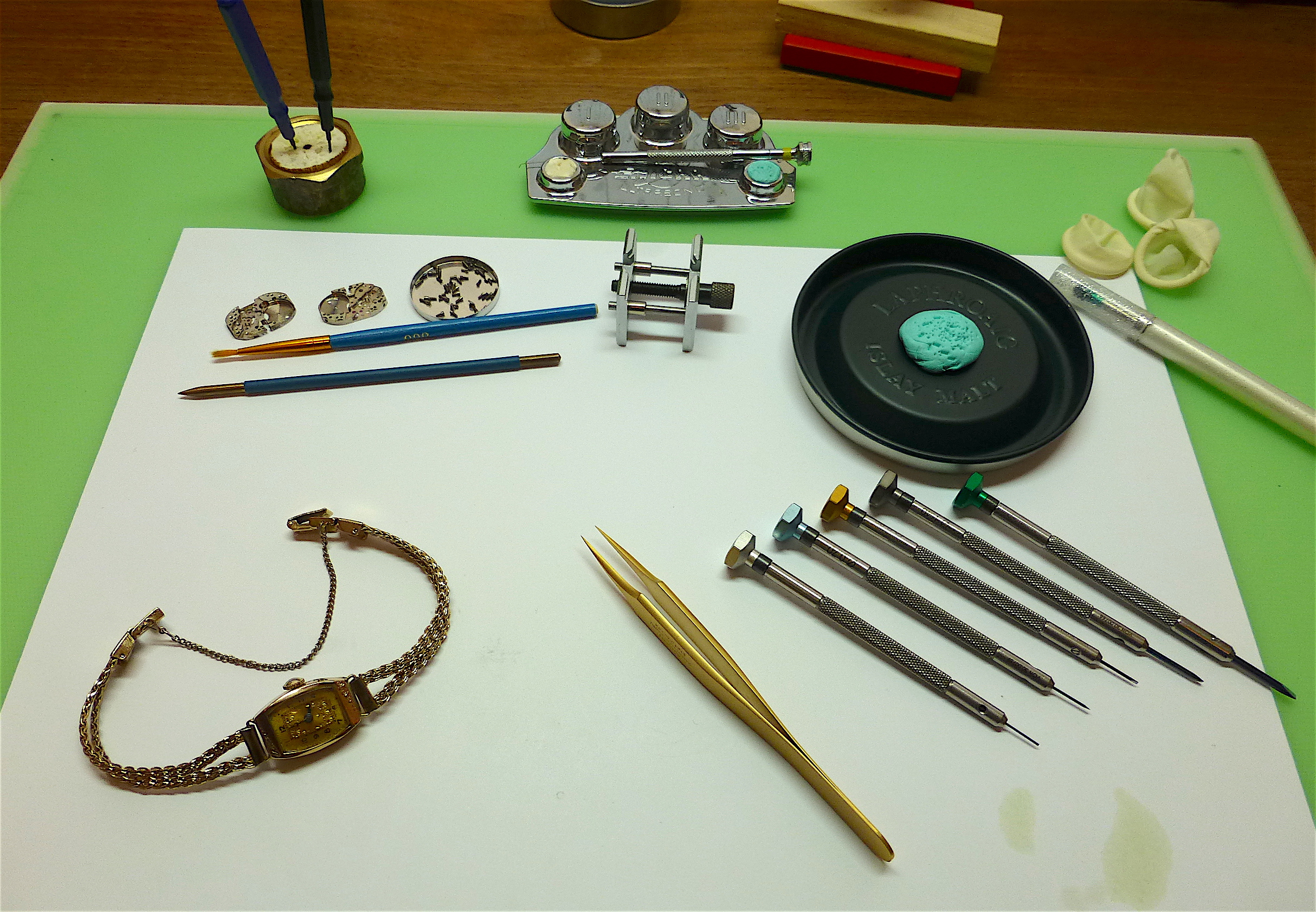

Aside from one big screwdriver for the ratchet wheel and crown wheel screws, everything else was 0.60, 0.70 and 0.80 and the concentration required for those tiny little things was mind numbing, I had t take a break after about 30 minutes sometimes.
Anyway, here it is on the bench with some of the tools that got the job done (the jewel picker upper being my favourite at the moment 😉.
And the finished item, to be kept safe and sound and well away from water!

Awesome work Jim. Great you got it running again! Is the dial or the crystal discoloured? If it's the dial, from the looks of it that may be a type of dial and printing that will stand up well to cleaning if you so desire. This is a ladies watch I serviced a number of years ago - brand name Mars running a Champ movement:
Dial was heavily discoloured:
Some movement shots:
Main issue was the cracked mainspring barrel:
Strange construction - the brass ring with the gear was a separate part to the actual drum of the barrel - not an easy part to find, but I did find it eventually. But anyway back to the dial - these old silver dials with black printing that is almost recessed into the dial can be cleaned rather aggressively, so here is a before and after shot of the Mars dial:
Customer was over the moon as she had taken it to many watchmakers over a 20 year period, and all said it could not be fixed. Feels good when you can get something working that means so much to someone. Final shot:
So if it's that sort of dial, you can try cleaning an area that can't be seen through the crystal first to see how it cleans up. These didn't tend to have lacquer on them from what I have seen, so I think it would clean up fairly well like this one did. I actually used an eraser to clean this one - one of those Staedler Mars plastic drafting erasers.
