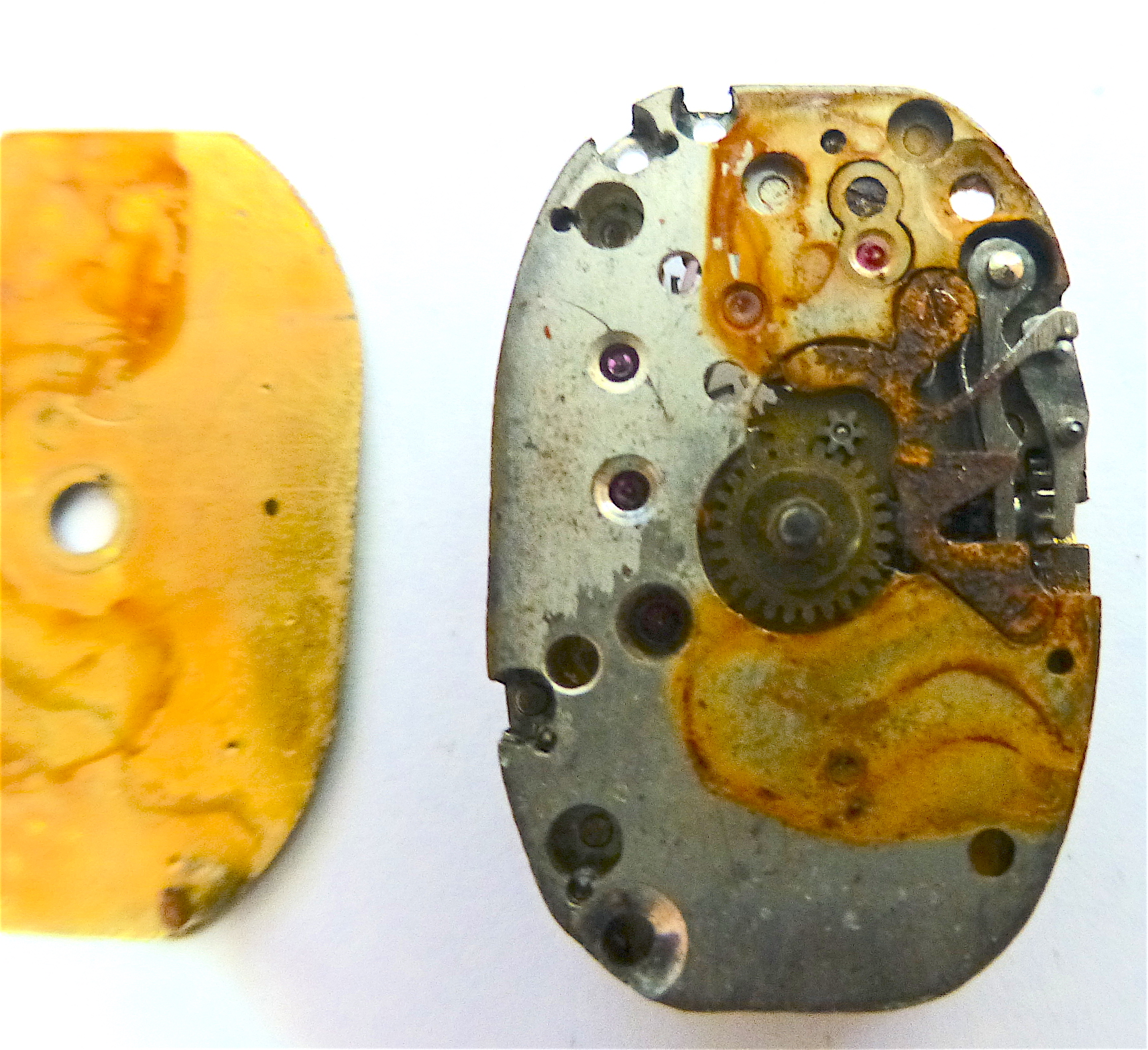

    I was asked to fix a few watched for my Daughter In Law, and as they were ordinary quartz ones I said OK. And then she bought out this family heirloom, purchased from a pawnbroker in the 1930s as a gift from her hubby.

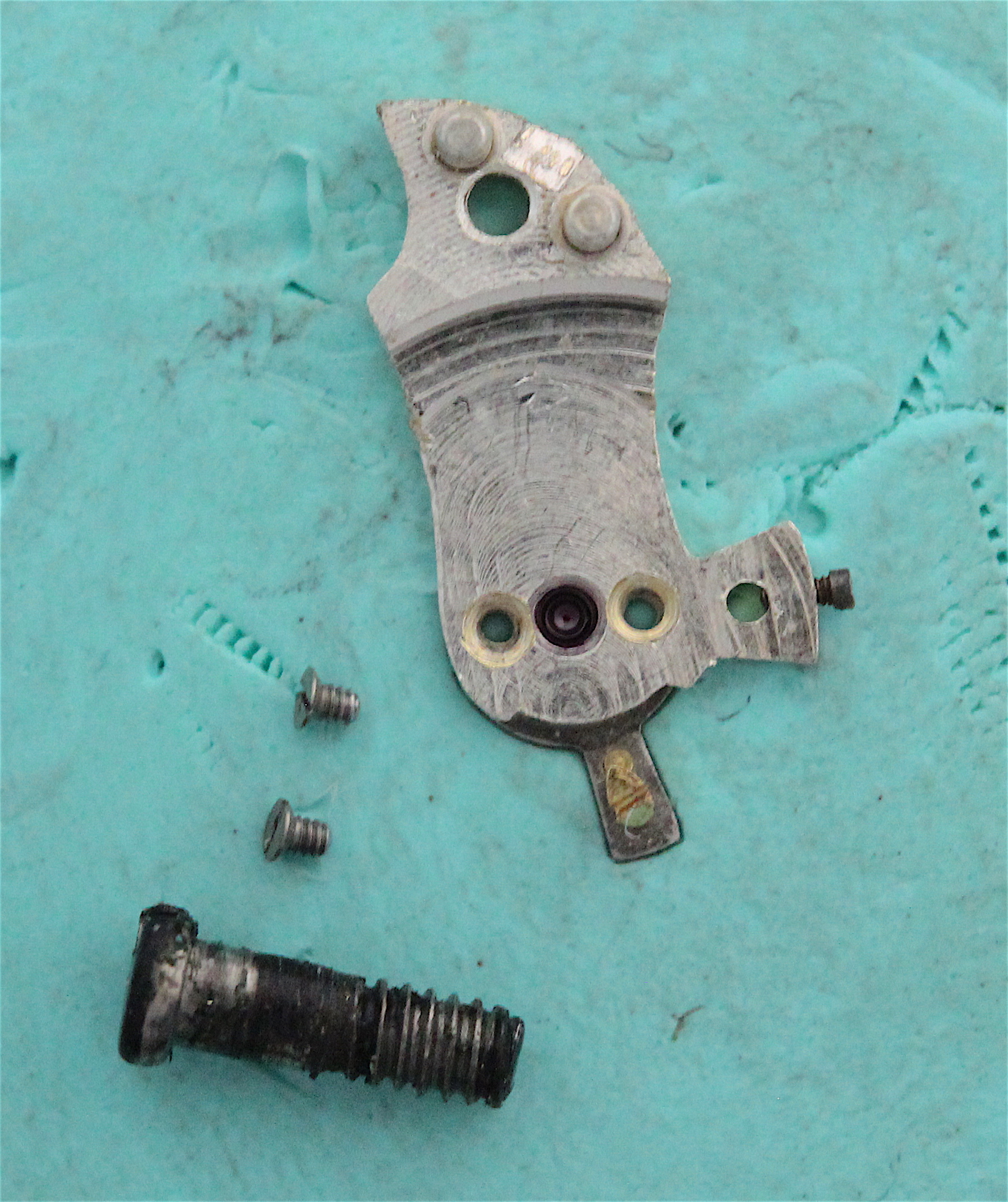

    It was water logged and wound as tight as a drum, I could hardly open the click to let it down but managed to strip it for cleaning except for the balance cap jewel. I has the impression that it had never been cleaned by previous watchmakers. Sooooo, I decided to go ahead and remove the regulator and cap jewel, but the screws were underneath the balance cock, so it meant removing the 6.4mm diameter balance to get to the screws.
    The hairspring stud required a 0.6mm screwdriver and the cap screws a 0.7mm one. Without a loupe they look like grains of sand.
    Anyway, all stripped now and ready for cleaning and then re-assembly. I'm sure I'm going to enjoy that :eek:.

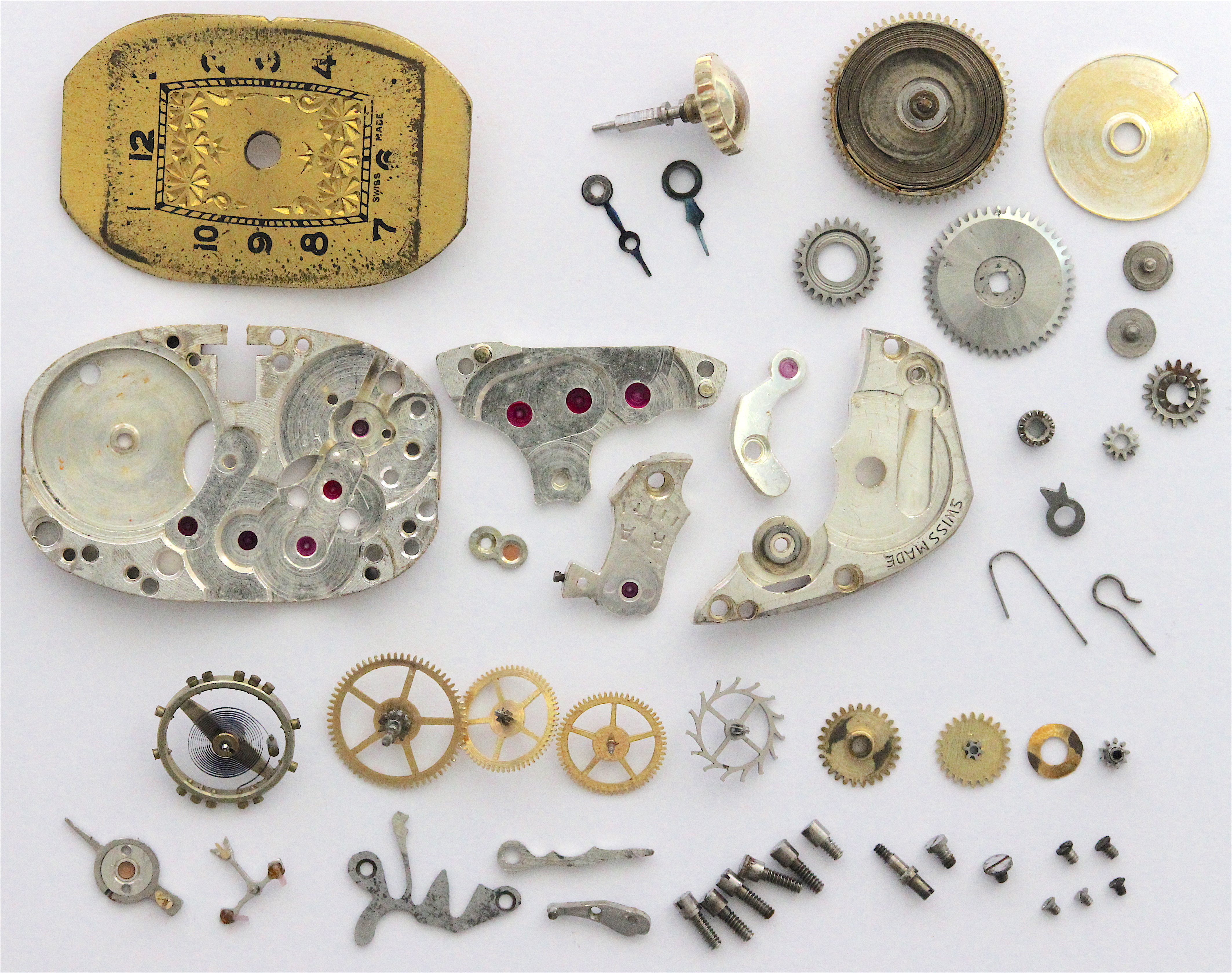

    This is what I started with.
    All clean now. Just need to inspect pivots, teeth, jewels and then it can all go back together.
    If this thread doesn't come to an end you'll know what happened :D.

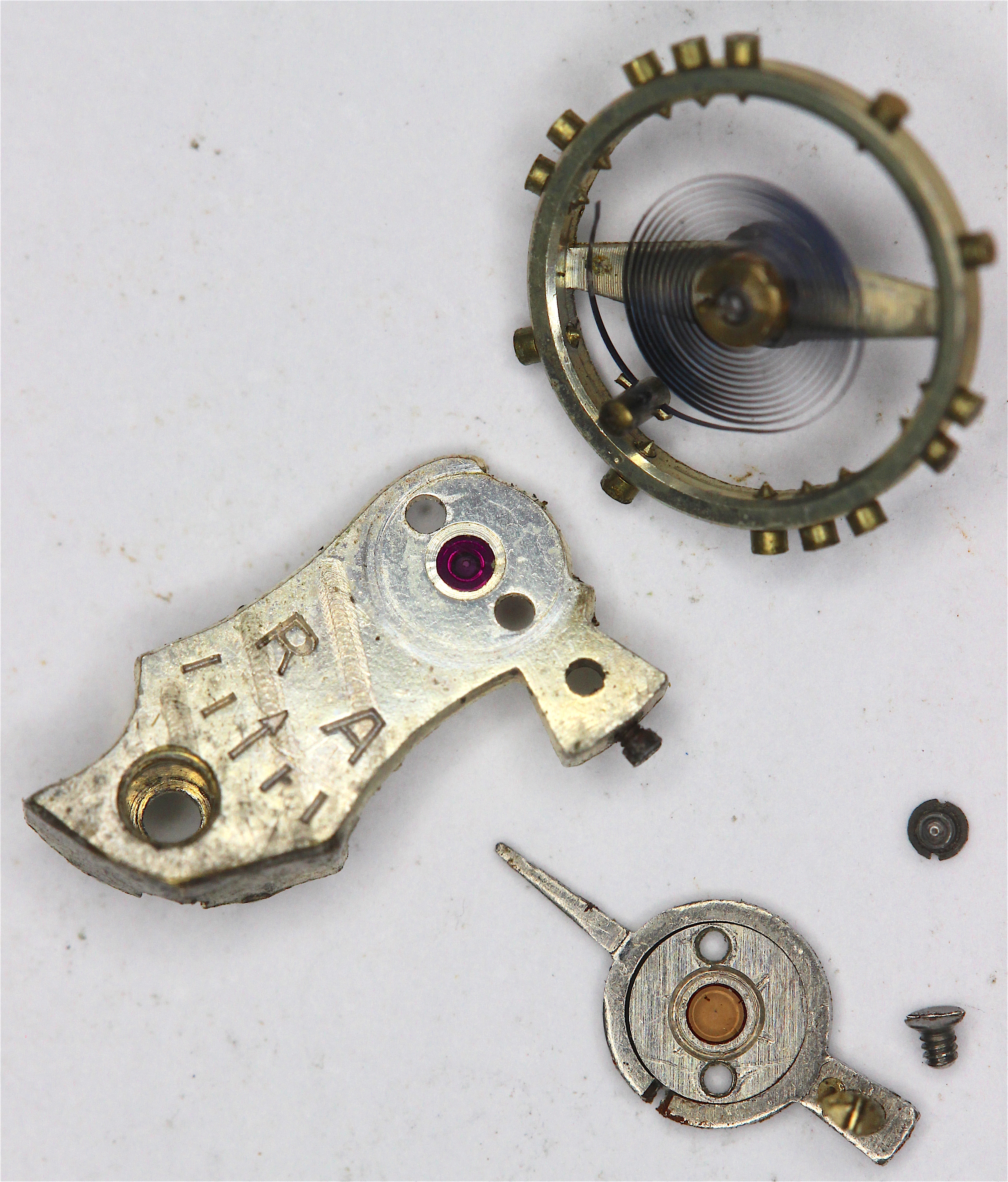

    Had to rely on Mr Rodico for assistance putting the cap jewel/regulator back together.
    Just for a sense of scale, the huge thing bottom left isn't from a car engine, it's the arm screw from a pair of spectacles (eyeglasses for USA readers).

    So Jim, the real question is, how are you oiling that cap jewel?
    GuiltyBoomerang likes this.
  11. JimInOz Melbourne Australia Jan 19, 2017
    15,488
    32,365
    Very carefully.
    I used my smallest oiler, taking the smallest amount from a bigger drop of 9010 I put on a flat surface. Onto the cap jewel with a nice domed drop. Then the balance cock was set over the top and screwed down.
    I may have to look at those pen oilers, I can see how much more controlled/simpler the oiling would be.
