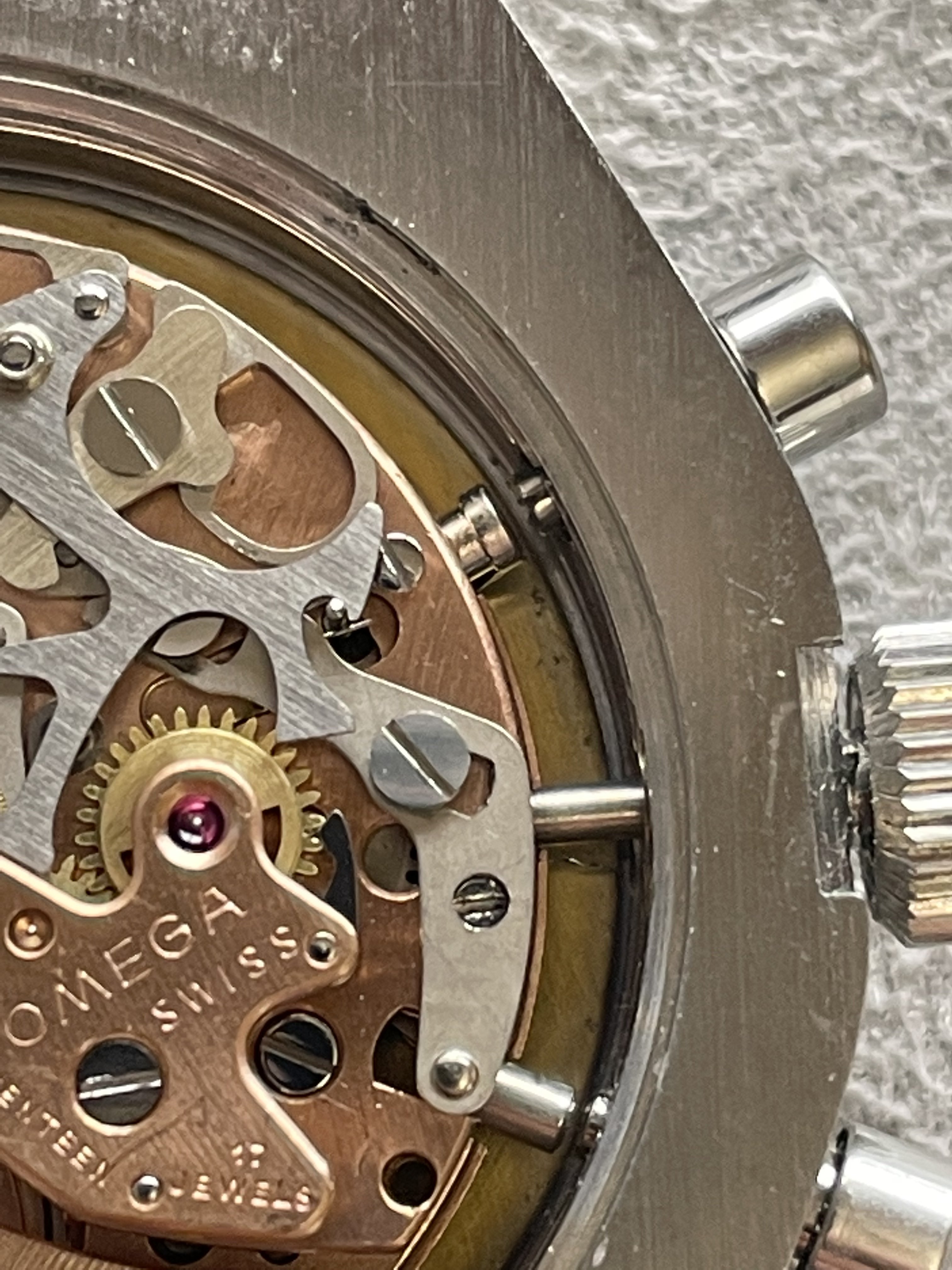

Hello, my little problem:
I have a stem with crown removed from a caliber 861, because I had the case of the watch laser welded (looks gorgeous by the way, pictures follow) in a different country and no watchmaker available at that time
Now I want to put the stem back inside, but I am facing following problem: The crown with stem slides into the movement, I can set the hour & minute hand but I am unable to wind the movement in order to „charge it“. Furthermore I have the impression that the stem is not completely back in the movement (maybe 1-2 mm )
I’ve read about the common mistake to „overturn“ the screw of the stem , and tried to avoid this. Maybe I wasn’t careful enough?
Thanks for any advice

Just my opinion, you probably didn't screw the detente screw hard enough in. I think clockwise is to tighten. The overturn mistake you've heard about is probably taking the screw out completely via counter clockwise, which apparently you have to disassemble the whole movement to put back in.
To put the stem in completely before you tighten press gently on the screw and push the stem in (only if the screw is tightened already).
However it might be also that your stem is short or something.. not so sure about what else could be the problem.

Buy a new stem. Will be too short and needs wriggling and trying and.... New stem solves that problem. Just have to cut to the right lengths. Grip the existing stem with small pliers on the thread just under the crown and unscrew the crown. Cut the new stem a bit longer than your existing one, screw on the crown and adjust until fits. Kind regards. Achim

Remove the stem from the movement again.
When you are inserting the stem back into the movement, use the screwdriver that you turned the screw with, and push the screw down with it. Then push the stem in and it should go all the way in. Then you can screw down the detention screw.
You don’t need a new stem unless something else was changed, like the case tube or crown.

Thanks for you help guys so far!
But I think I have messed it up somehow.
I can’t turn the screw counterclockwise without more than light pressure (don’t want to break something, if I didn’t do so already)
The Chrono reset pusher won’t work, seems like it’s stuck plus the crown can be pushed towards the case and while doing so ä, makes a click noise.
I think I have to find a watchmaker?
Any ideas?

Never mind , just gave it to a watchmaker I was recommended. He was shaking his head and looked reproachfully at me, but seems to be able to fix it (by dismantling the whole movement)
Lessons learned (the hard way)
